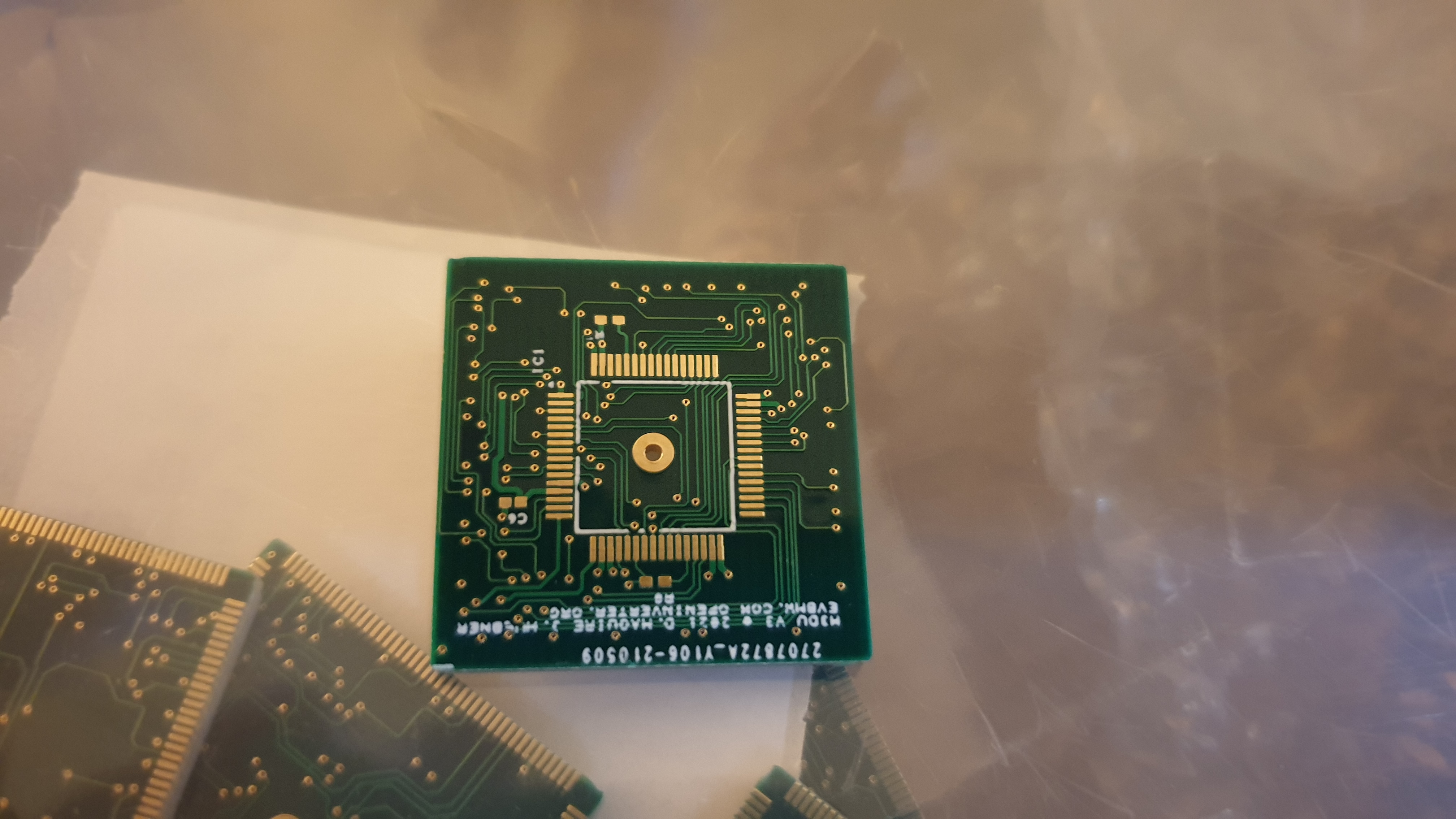

Damien, did you consider of a step in between?
First making a header modboard and giving the modboard it self the counter part? I hope we won't have many board iterations but it would make hardware upgrading/updating a walk in the park...
When we have all things done/running we could go 'weld on style'..

Exciting, next the black box in the middle?
That really reminds me of some old Athlon/duron processors.

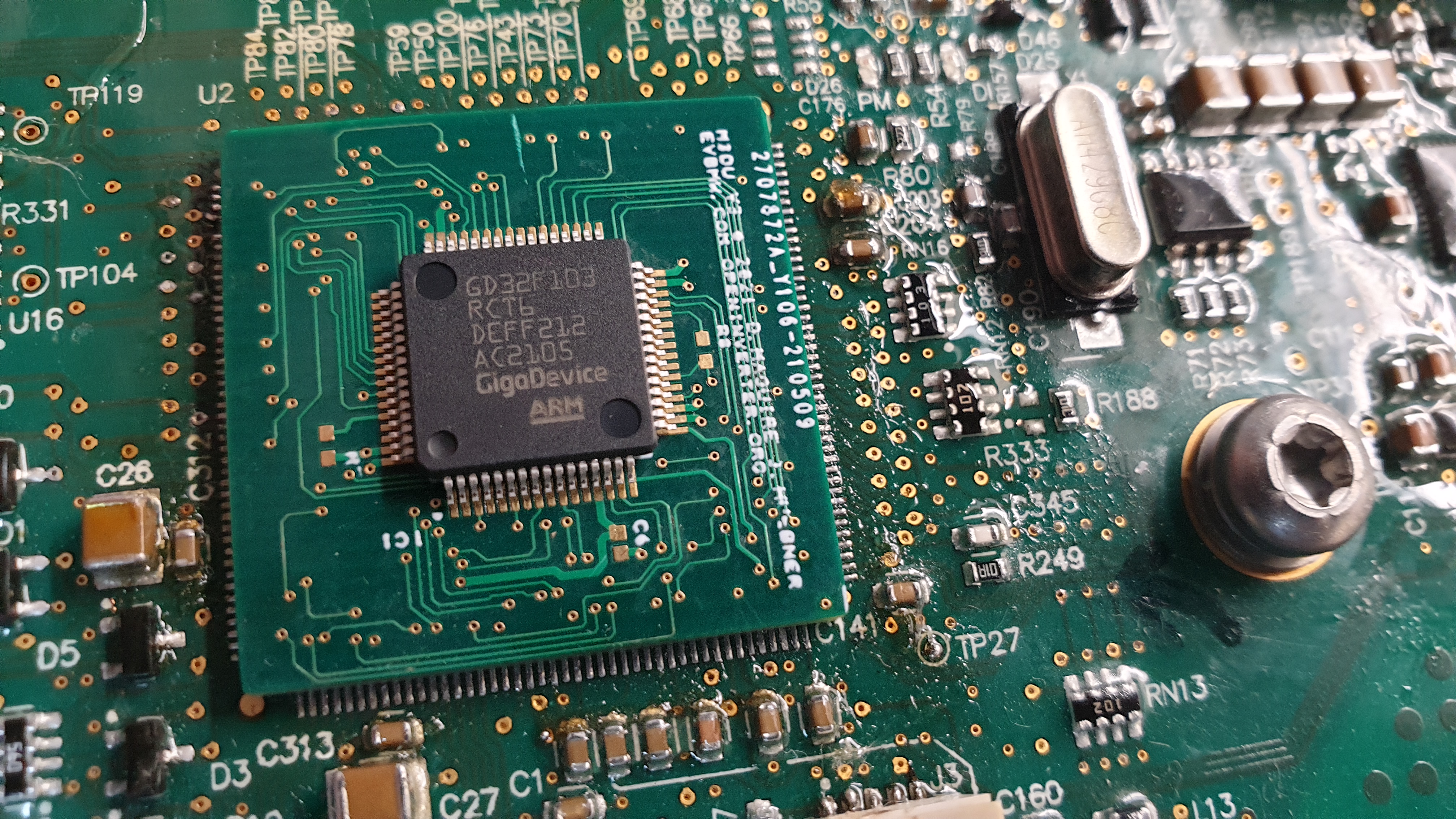

And its in. Quite anticlimactic in the end. Power rails, xtal and a few random tests show no shorts or non connections so far. Now to fit the BEAST of an mcu that this drive unit deserves:)
davefiddes
- Posts: 416
- Has thanked: 206 times
- Been thanked: 257 times
Exciting times. Hope it all goes smoothly. Looks like you've gone for a regular FR4 based PCB this time rather than the flat flex. Is this because you don't need the castellated edges? Do you need to do anything on the underside to stop vias shorting against the ground pad for the TI chip?

Just experimenting with the fr4 really. its a lot cheaper than the polymide so at least will let me find the mistakes:)
