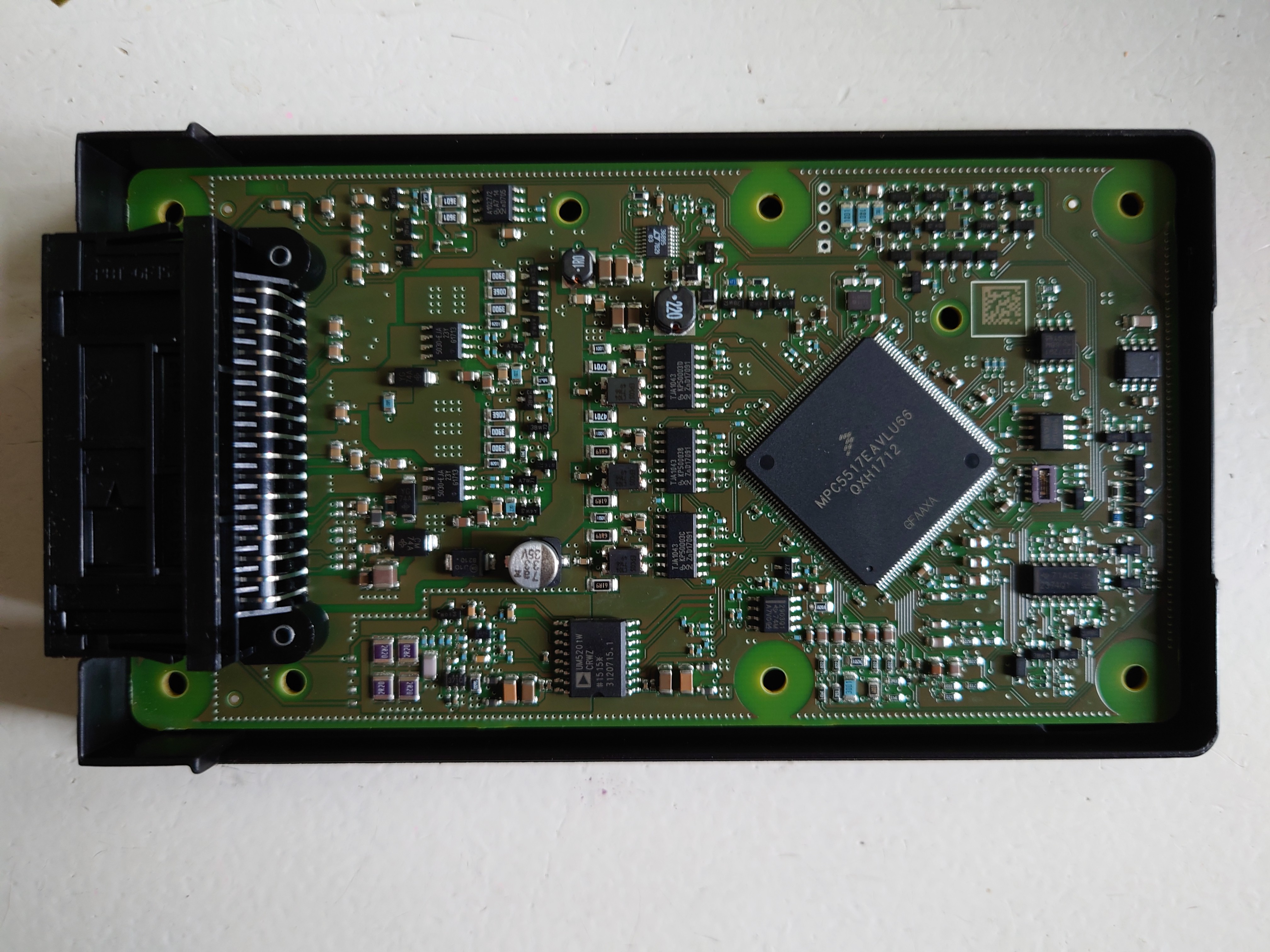

Hi Tom, any luck with VW balance magic?
Here is a E-golf gen2 BMC ECU

I have traced the BMC wiring and plugged in 5V to VW battery packs CAR side connector to see what happens. Nothing happened, except the board drawing 70mA of current. 8-) Oh well, I think I am missing some enable signal/wire/command maybe.
There is 2 CAN buses in the black round connector outside of VW battery pack. Only if I had a working E-Golf now to see how it should work.
I wonder about 4 the pin through hole section on board, on top of the MCP5517, there is +5V and GND (square) and 2 (data?) in the middle. Maybe I plug in serial there to see if it is that easy? :mrgreen:

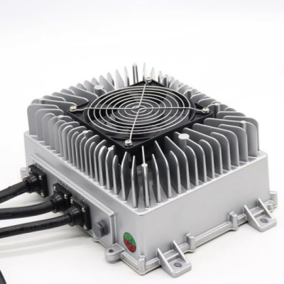

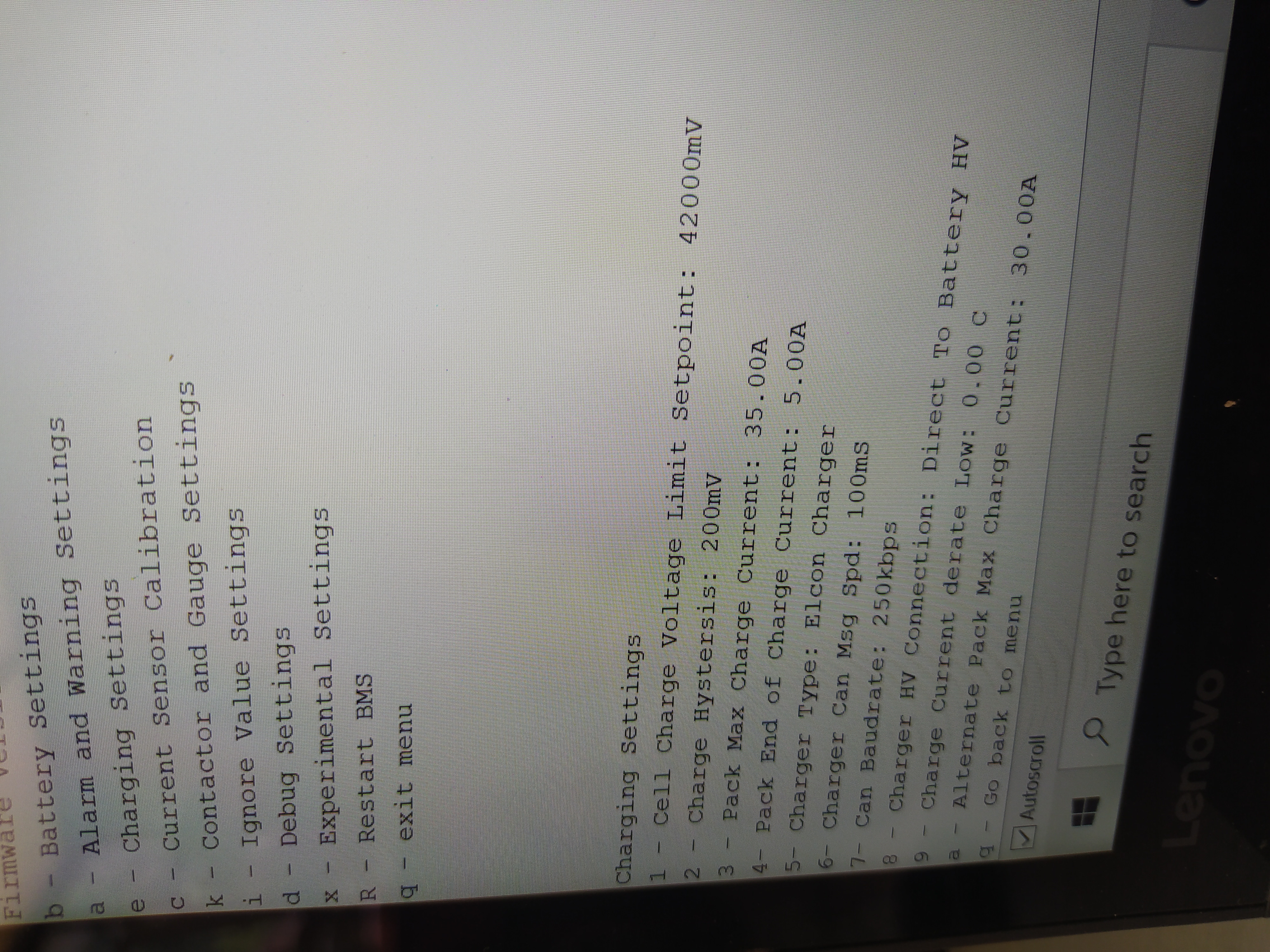

Got my SIMP communicating with my "elcon" charger. The charger flashes red and the fan kicks in but there is no output whatsoever... tested with clamp meter and is reading 0A also no voltage whatsoever. The simp is happy and believes its charging.
I ordered an Elcon UHF 3.3kw charger from evlithium and after 4 months they sent me out a knock off basically and refused to replace it with a genuine elcon charger. be careful of this company!!!..apparently the can comms is identical to the elcon and it is communicating. Evlithium aren't being that helpful, I presume it must be a fault with the charger itself perhaps an inboard fuse has blown ?
Modules are tesla x 4 serial. currently sitting at about 88v.
please see image charger, the information on it is terrible/non existent!!
Also my settings...
Many thanks!

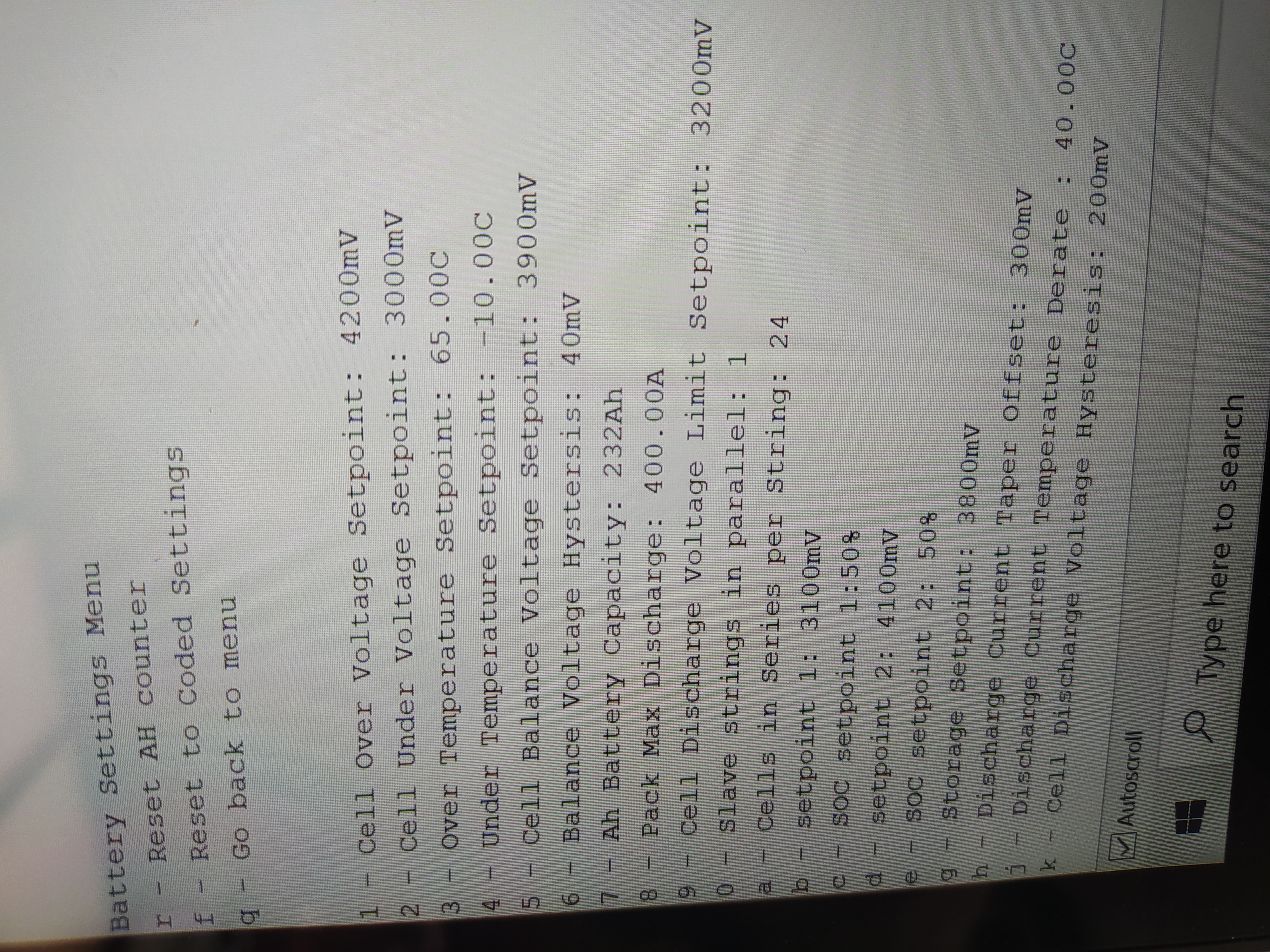

why is cell votlage limit set to 42000mV instead of 4200mV?
Jackk
Posts: 57
Joined: Thu Dec 17, 2020 6:29 pm
Re: Simp BMS
Post by Jackk »
tom91 wrote: Mon May 31, 2021 10:22 am why is cell votlage limit set to 42000mV instead of 4200mV?
not sure have put it to 4200mv now.
on the main screen its saying no charge current limit set but it is set to 35A on the charge setup...also the CP current limit is fluctuating quickly from zero up 4000A in a random fashion.
BMS Status : 3 Charge | AC Present | 24
Out:0010 Cont:0000 In:0010 Charge Current Limit : 1 A DisCharge Current Limit : 400 A CP Current Limit: 1800A No Charge Current Limit

Looks like a TCCharger, they should work fine.
This is a long-shot, but try setting param 6 Charger CAN msg spd to 1000ms (1 sec).
LE: is it flashing only Red? or combination Red/Green?
