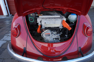

Thought I should show you all my 1964 Volkswagen Beetle which I converted to electric drive last winter.
Specifications:
Nissan Leaf EM61 motor.
Inverter with replacement controll board.

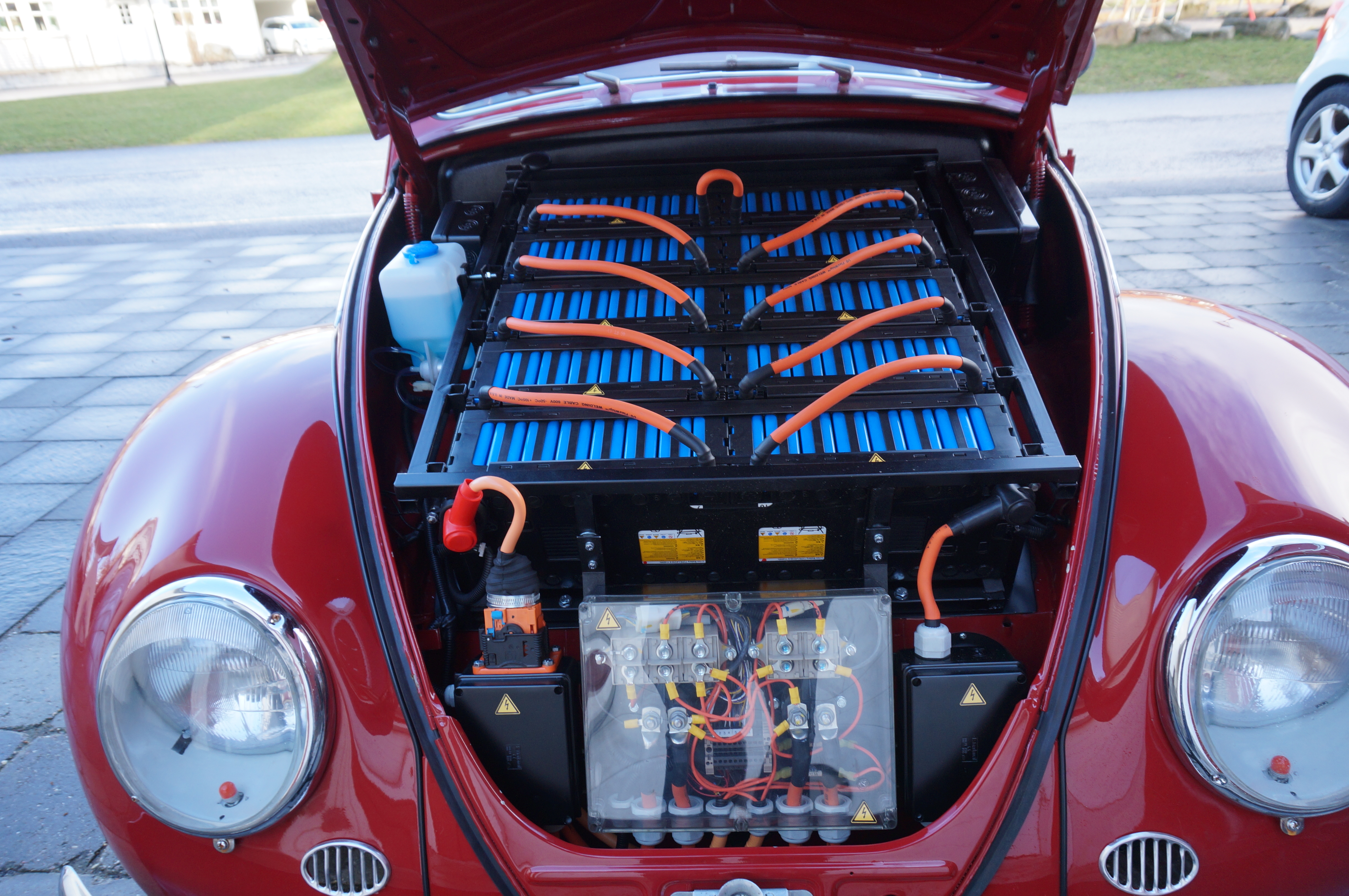

80 LEV40N cells from Mitsubishi Outlander PHEV.
SIMP-BMS from Tom de Bree talking over CANBUS with the modules.
Meanwell DC/DC converter.
Gigavac contactors for the main feed, Omrons for the charging and DC/DC feeds.
Homemade adapatorplate and coupler in aluminium and titanium.

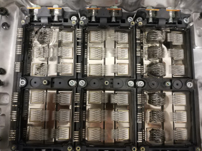

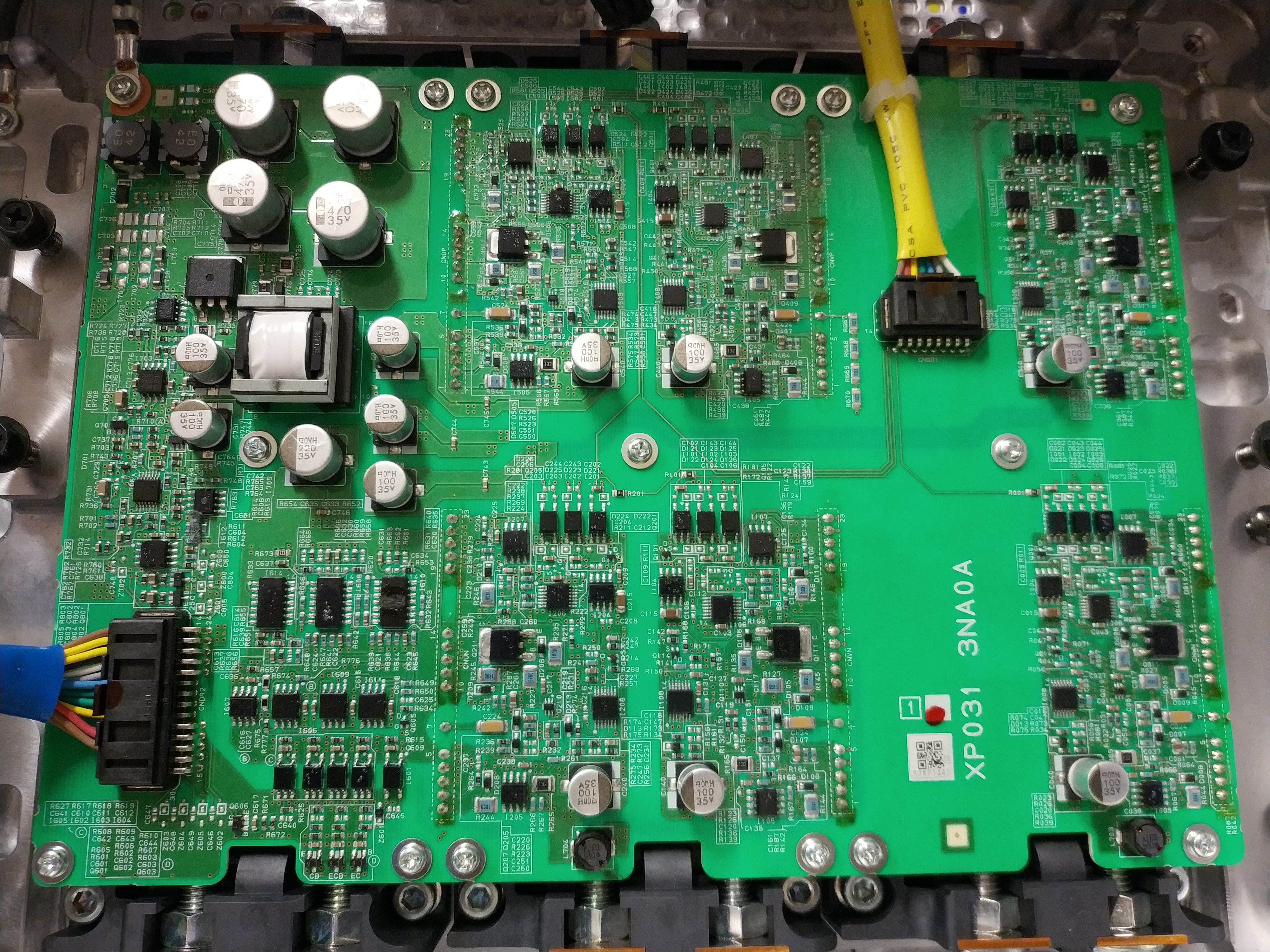

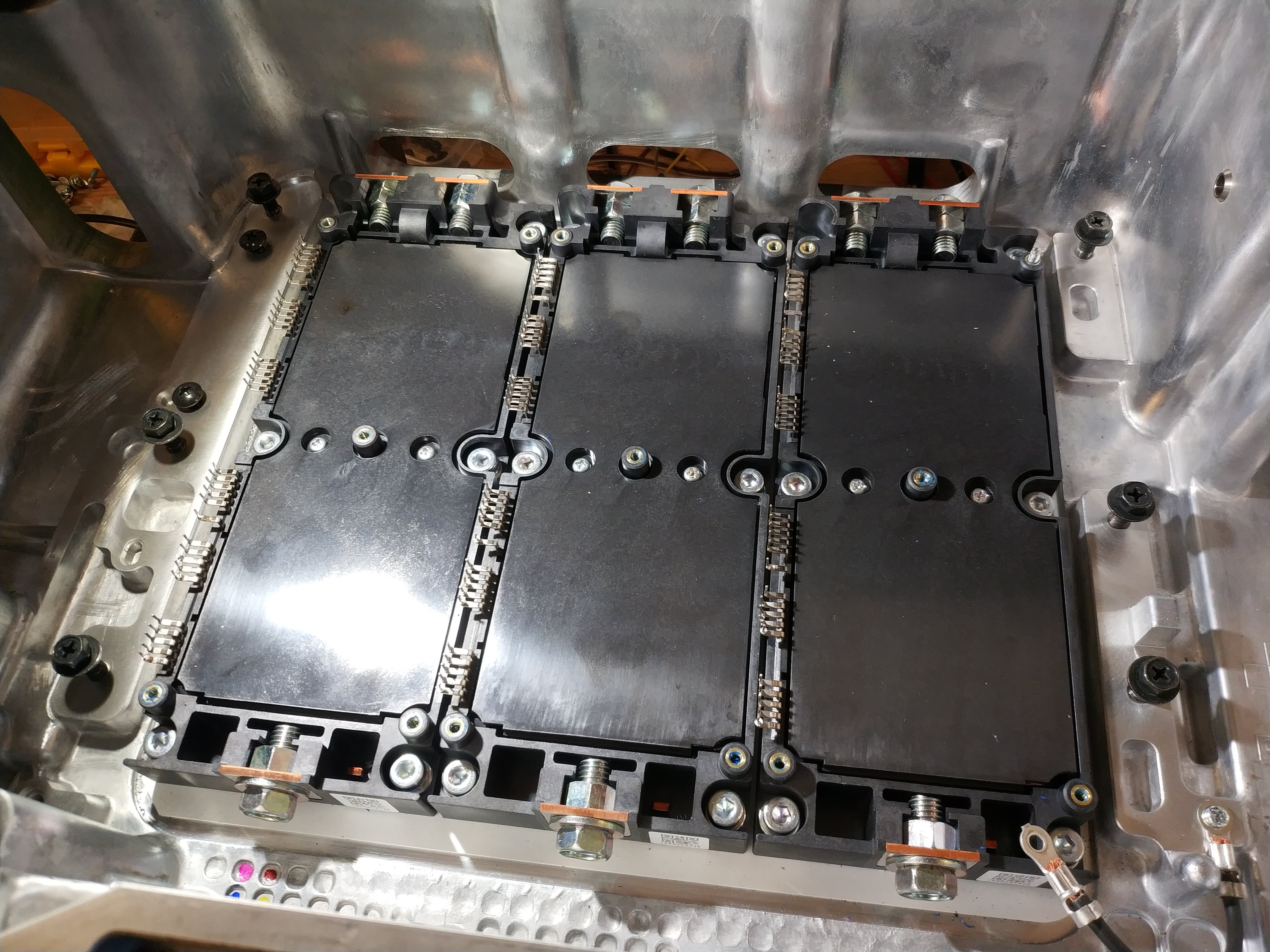

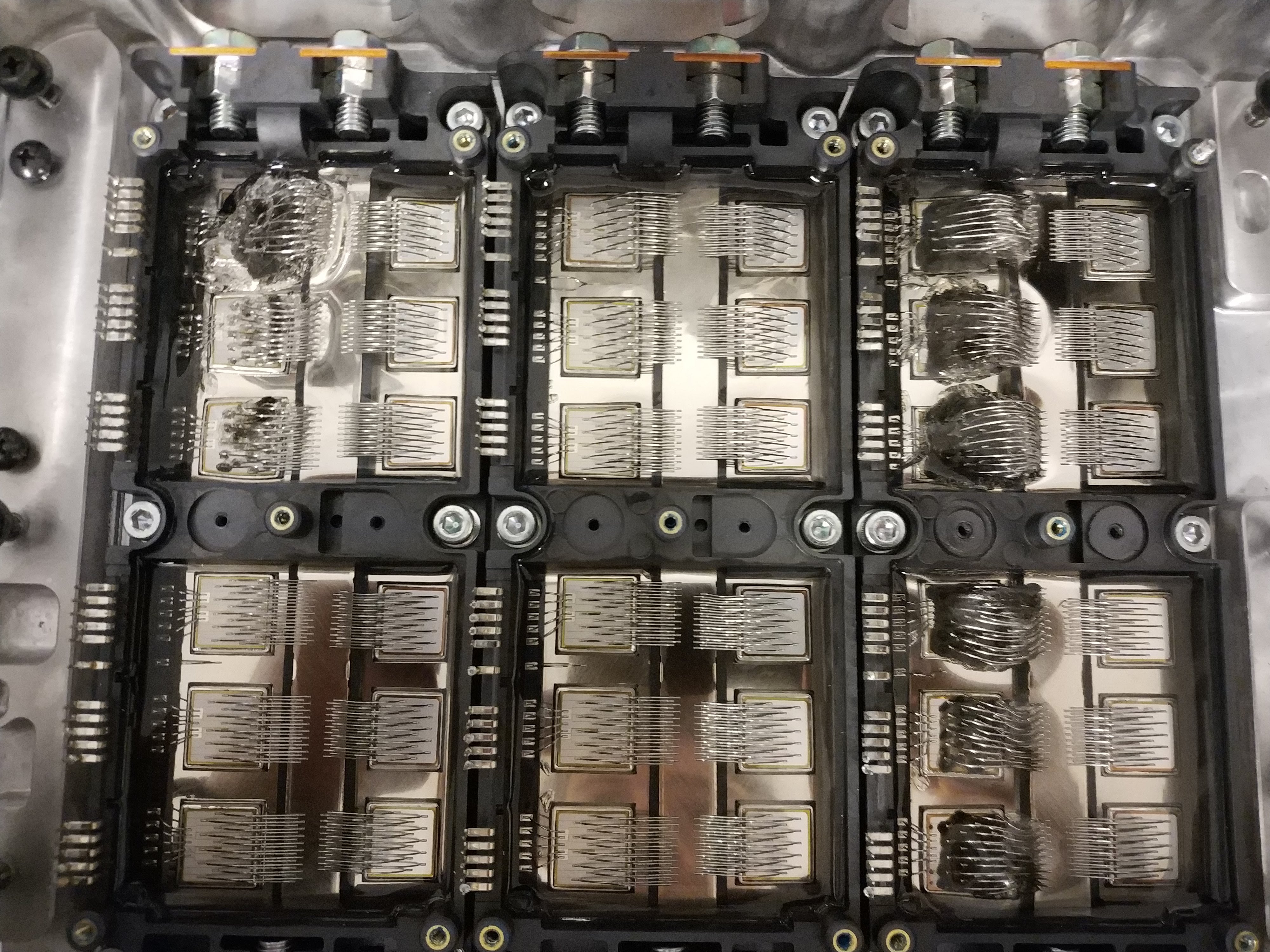

Because I've got a faulty inverter right now, something went wrong with the replacement board I had (not Openinverter), so plans is to put Johannes brainboard into a new inverter. Question right now is if I should go for a Gen2 inverter and use it with a Gen1 motor or should I get a new Gen1 inverter and put a adapterboard for that kind when it's avalible.
Current situation:
Right now am I trying to controll the original logic board of the Gen 1 over CAN-bus, have made it succesfully on a Gen2. Problem is the above mention broken Gen1 inverter I have at the moment. Will uppdate when I have new things to share ;)

Engine
Engine

Broken IGBT:s
Broken IGBT:s
With cover on
With cover on
Controll board that don't send voltage sense signal.

Thanks for sharing your build. I enjoyed the rear picture and seeing the motor and inverter fit in there.
Are you running a clutch?

mleebert wrote: Mon Aug 05, 2019 7:51 am Thanks for sharing your build. I enjoyed the rear picture and seeing the motor and inverter fit in there.
No I'm running clutchless direct-drive ;) have the understanding that the EV-motors in general aren't designed to have axial forces applied to their rotor which is what happens with a clutch setup.

Really nice conversion, how are the Outlander batteries performing?

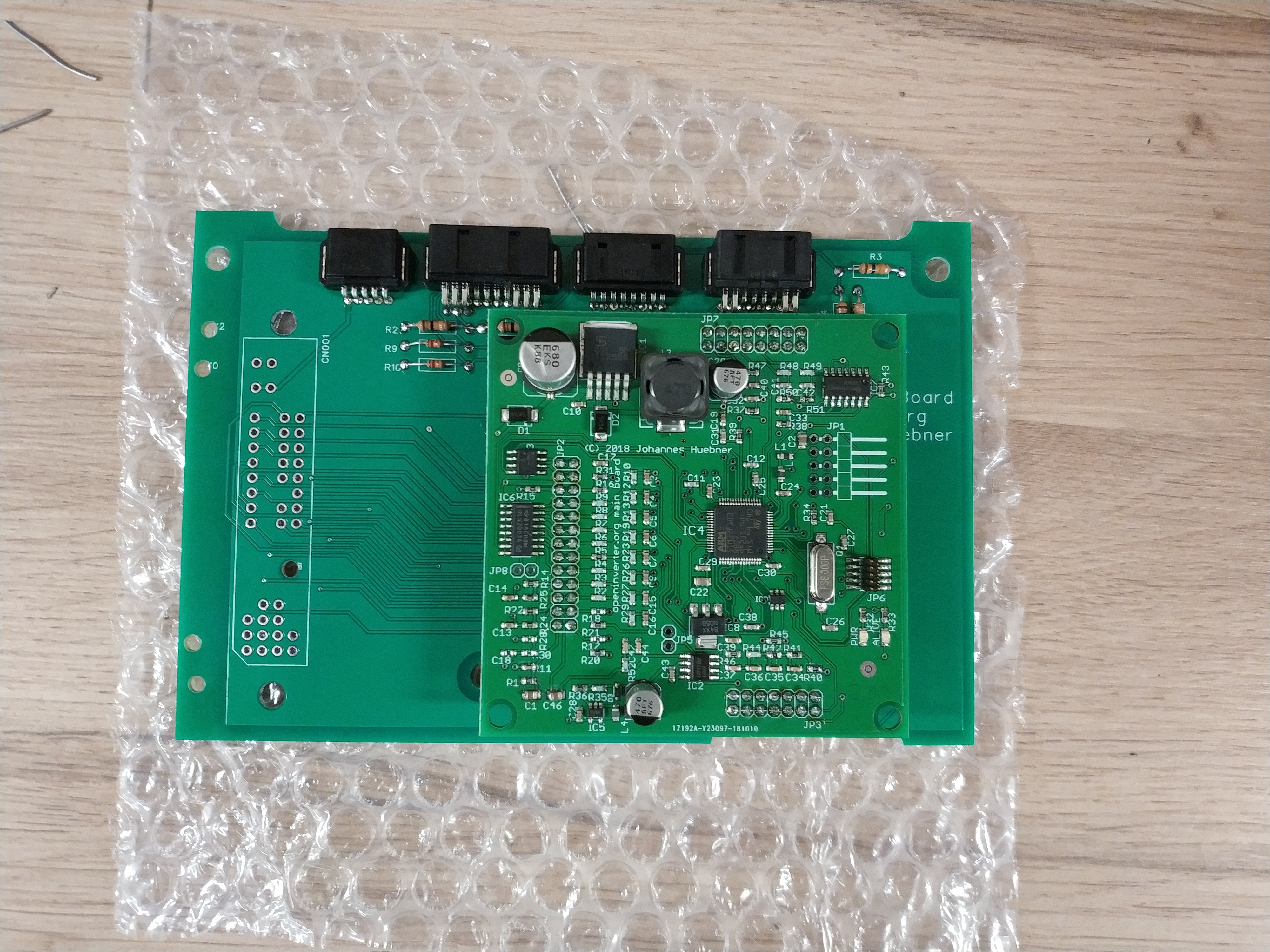

Got this from Johannes yesterday and soldered it together. It's for my friends Gen2, I've also got one loose brain-board for my Gen1 laying here at home now :)
Yesterday did I manage to got hold of a spare Gen1 inverter, it should arrive next week from Norway.

NIMMOEV wrote: Mon Aug 05, 2019 2:11 pm Really nice conversion, how are the Outlander batteries performing?
I've pulled 300A out of them peak and no problems what so ever yet. I'm charging them with 0,25C (10A) and balancing them with Tom91:s SimpBMS.

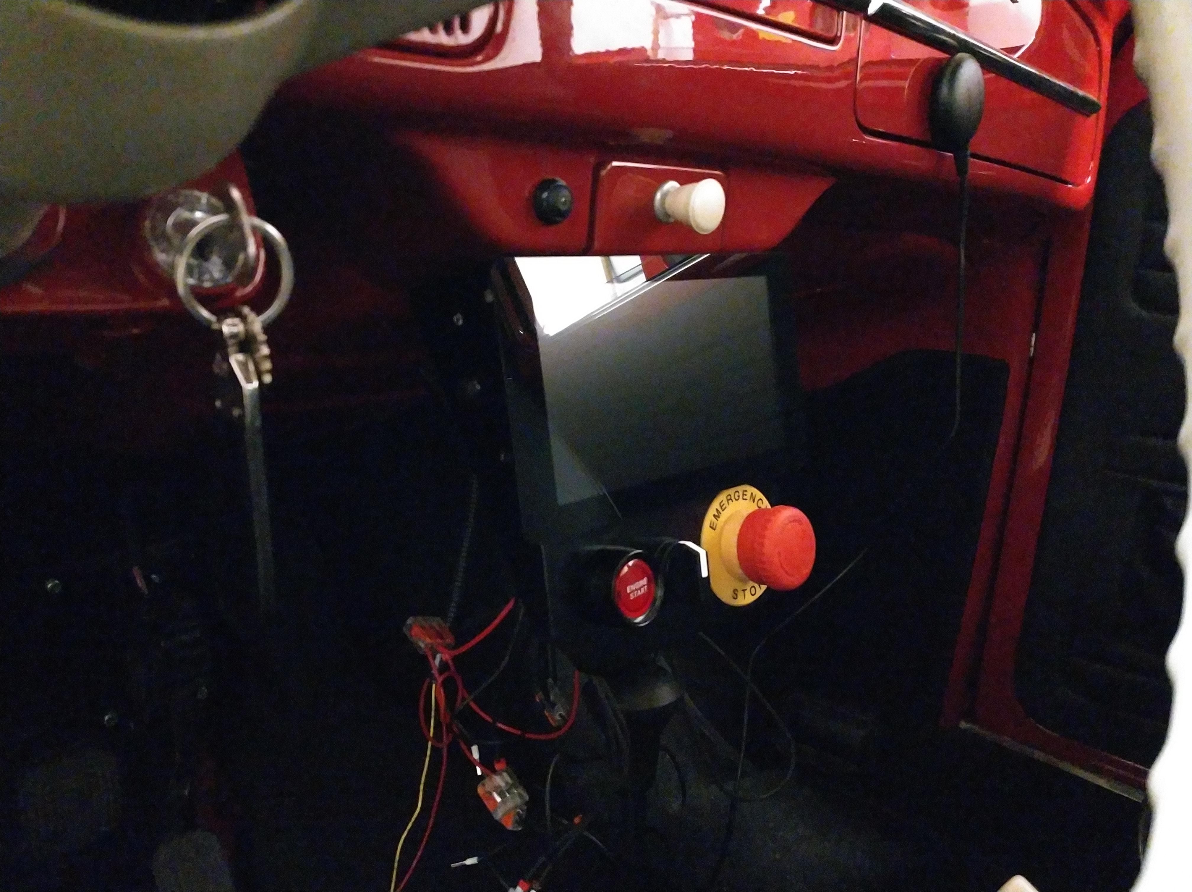

zippy500 wrote: Wed Jan 29, 2020 12:45 pm I like your digital display,
How and what is it ?
It's just an temporary 20x4 LED connected to an Arduino Uno with a CAN-bus shield.

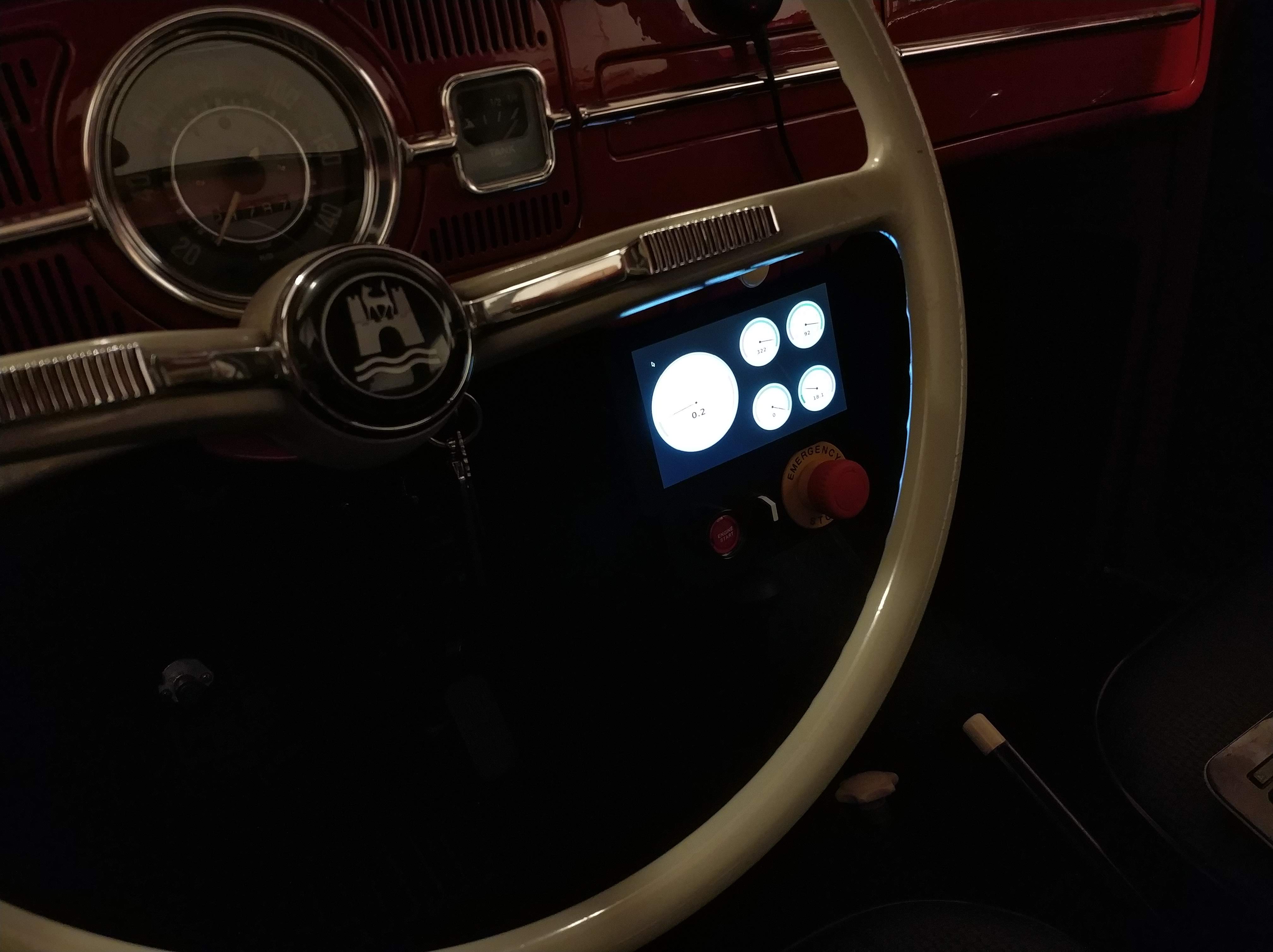

I also like your instrument display, did quick calculations on the Amps and Volts and it was around 80kW :D
Did you display the Amps and Volts gauge on a Raspberry Pi or Android? I couldn't see what the other gauges were.

mackoffgrid wrote: Wed Jan 29, 2020 9:15 pm Thanks Langoo

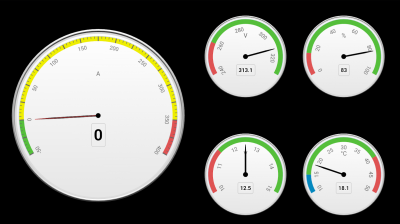

This is the display you mean? It's a raspberry pi with a 8inch display.
This how the GUI looked like. Amperage, voltage, SOC, 12V and batterytemperatur.

mackoffgrid
Posts: 94
Location: Brisbane Australia
Has thanked: 6 times
Re: Voltswagen -64 "Leaf powered" Gen 1
Post by mackoffgrid »
Yes, Nice clean display.
I bought the 7" Pi display.
Not a RPi expert and trying to decide / figure out how to do pretty much what you're doing.
I also want to switch to Reversing camera or GPS mapping as well. Thats just switching applications.
Did you code those gauges in Qt ?
