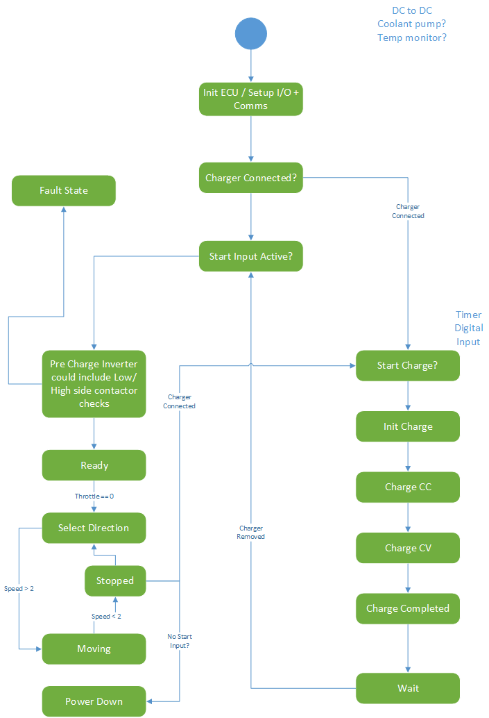

I wouldn't mind helping out, but i'm also thinking about how to make this generic for the various different chargers that people are using etc...
See attached my first attempt at drawing up a state diagram for the system including a charger.
