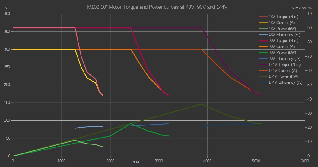

I put this together last night. I came across the data hereand thought it would be interesting to have it visualised.
It shows the same series-wound DC motor with different constant voltages applied.
I was surprised to see DC motor power curves peak and then drop off as the speed increases. I had assumed they would be like AC motors and maintain peak power as the current drops off. Is this universally true for DC motors?

WARNING: EDUCATED GUESS INCOMING.
Well you can't get infinite speed. Things like the bearing or brush drag, the internal air resistance cause a loss of power at those speeds. But most important is the brushes. They are set up ('advanced') in order to overcome the coil inductance as they move from coil to coil. However, as speed increases, that advance is effectively 'used up' so that at some speed the brushes are effectively too late. Then you get less torque.

Ahh that makes sense. Whereas I guess FOC on AC motors allows that hurdle to be overcome

Pretty much. The inverter takes the place of the brushes -- and because it's electronic rather than mechanical it is much faster, much more durable, and able to change more things. (Though you could probably make a mechanical inverter, that would be really cool.)
FOC is simply one algorithm which can be used to achieve those goals with an inverter. There are others which have their own merits too.
