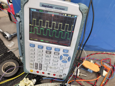

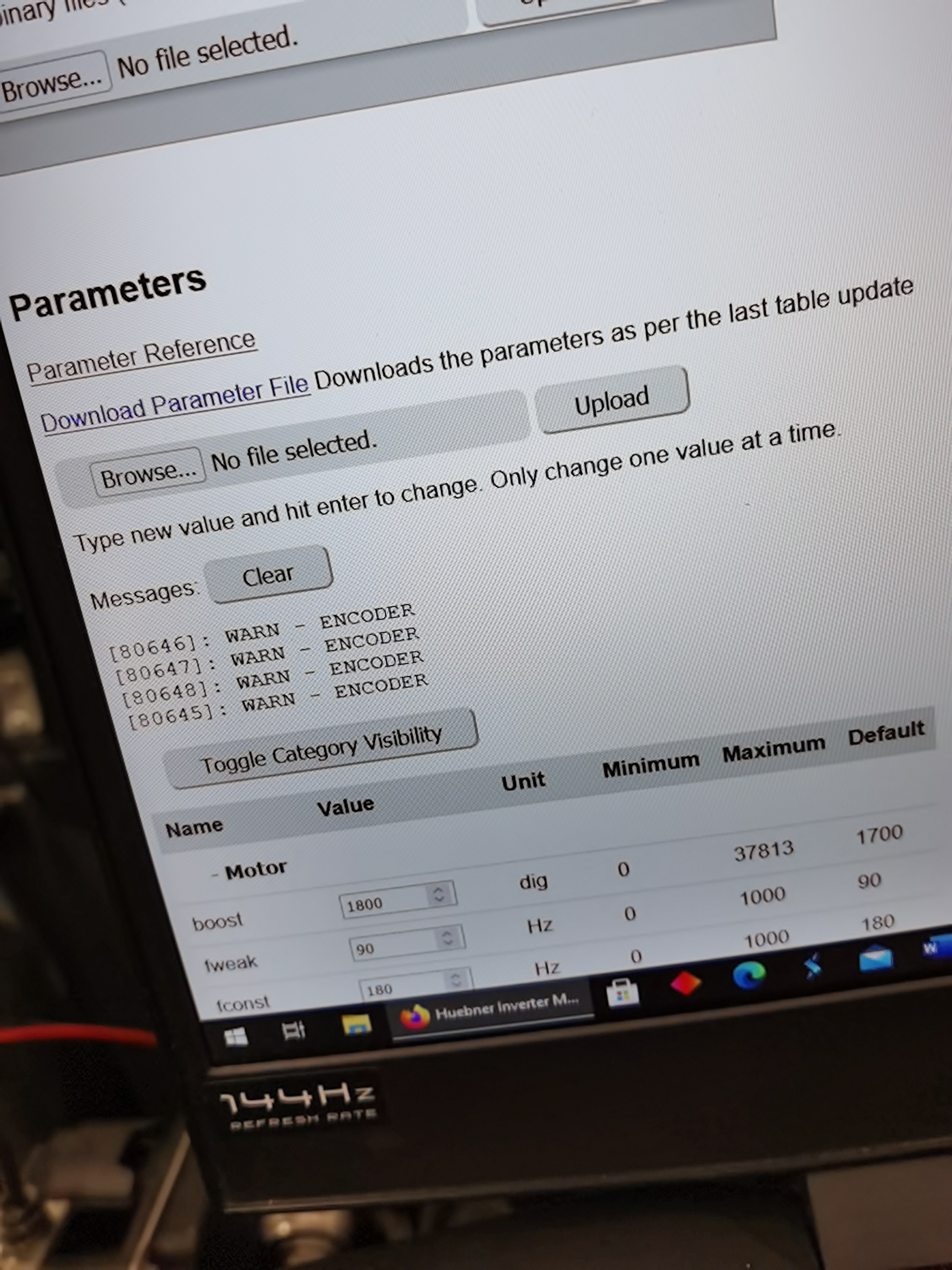

Hello
Got my motor going after the big igbt blowout. :D
Tested and spinns really good, just tested up to 300rpm
New battery bank this time, 72v agm @200ah

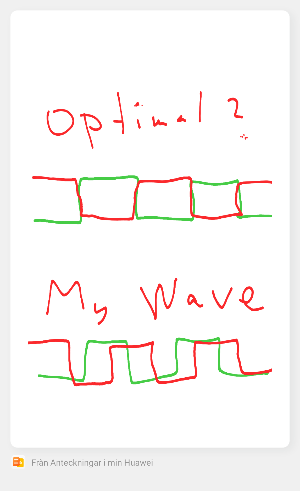

Just one problem, I think my encoder is bad, constantly warns, (warn - encoder) Nice Square wave but not 100% in synk with each other, have you got any saved scopecapture?
A and B should be displaced 5v - 0v every other time?
Picture of my case, just powered by 5vdc and gnd.

fredd90 wrote: Wed Jun 09, 2021 10:26 pm IMG_20210609_233228.jpg
The picture you labeled "optimal?" isn't. What you're show is A and A_BAR (Inverse of A). Dual channel encoders do not look like inverse image of each other. They look like the same signal A and B but displaced in time. Whether B leads or lags A tells you which direction it is spinning.
I shamelessly swiped this image from the internet:
Posts: 6735
Has thanked: 378 times
Been thanked: 1559 times
Also if you get ENCODER warning you have set it so "Single" mode where AB recommended for Tesla motor. That said, single mode can mask out swapped encoder wires, so changing to AB might get you a rattling motor which you can then fix by swapping A and B wires.

collin80 wrote: Thu Jun 10, 2021 12:42 am
Okay, then my encoder is probably correct, it is displaced different in time regarding which direction its turning.
johu wrote: Thu Jun 10, 2021 4:17 am Also if you get ENCODER warning you have set it so "Single" mode where AB recommended for Tesla motor. That said, single mode can mask out swapped encoder wires, so changing to AB might get you a rattling motor which you can then fix by swapping A and B wires.
I will test that this afternoon, when i revealed encmode the sensor was in single mode but i thought I've read that it then was in AB mode?
Tried both modes and it runs very smooth up to 300rpm.
When I repaired my inverter I swapped out all control electronics, can this have something to do with, the new igbt driver? My igbt failed previously, resulting in a shorted igbt driver circuit.
Or should that have left a new fault code?
"Warn - encoder" Does this just refer to encoder fault? I know that some codes can be triggered by multiple sources.
/Edit: I have attached a parameter file if someone want to dig in =)

I've kept searching for errors, Now I have managed to get encoder input measured on microprocessor.
I think my chip is bad, due to the good signal entering the ic.
Maybe replace ic or buy a new controller board
