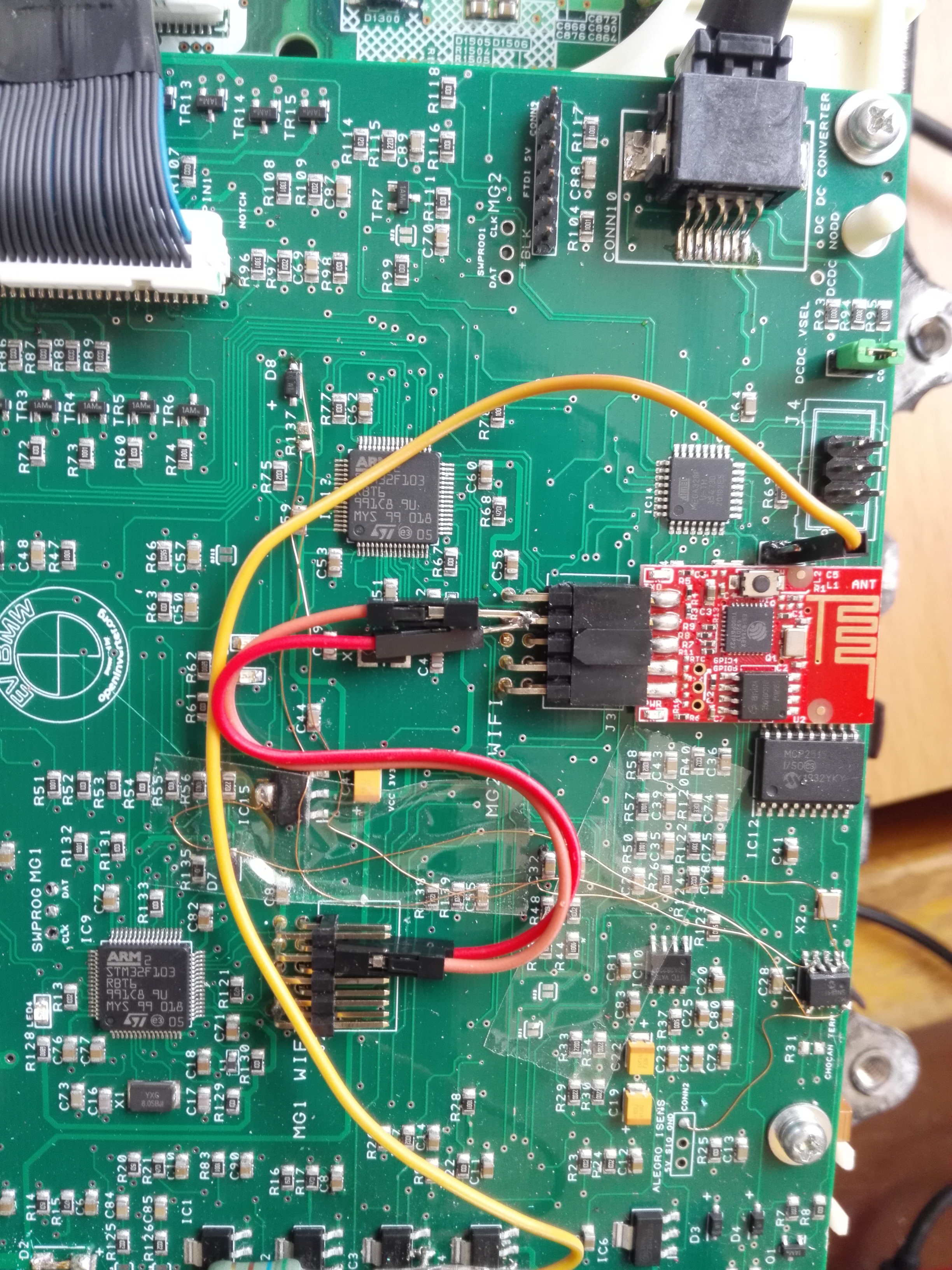

My inverter blowup meant I could take pictures of my board mods:
  1. Barely visible: 560R resistor to 12V pulling up IGBT. Also connected to precharge FET meaning IGCT is low at startup and thus DC-DC converter off
  2. Single wifi module mod
  3. CAN transceiver for MG2 CPU. Sits on top of the Atmel one. Not sure if this would work simultaneously with the onboard CAN to MG1. Have deleted that.
I never wired up PB9 to the DC-DC converter for setting voltage via user PWM.
Would these be mods for the next revision? Is this even the right place to discuss?

What have you done to blow this inverter?
Posts: 6754
Has thanked: 382 times
Been thanked: 1574 times
Re: Prius Gen 3 Dual Motor Logic Board Support Thread
zilion wrote: Wed Sep 01, 2021 2:07 pm What have you done to blow this inverter?
viewtopic.php?p=31165#p31165
