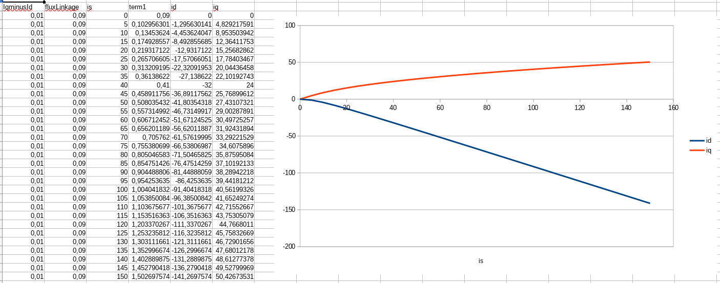

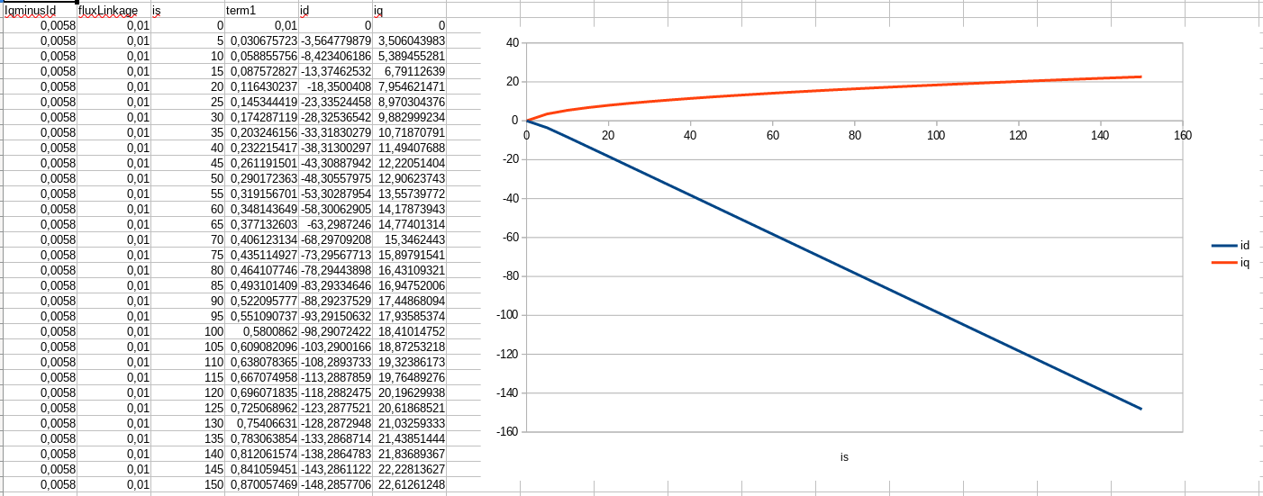

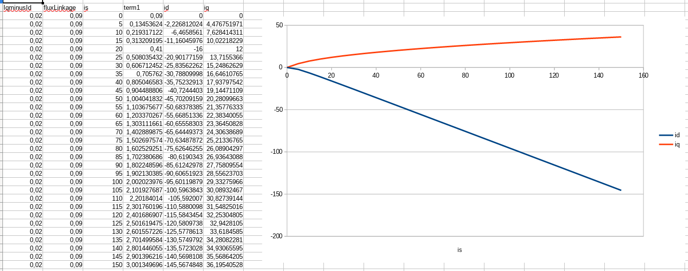

Post by bexander »
So testing something like this might be a good idea.
1) Start with setting lqminusldSquaredBs10 = 0.03445.
2) Test with FluxLinkage = 0.01.
3) FluxLinkade back to stock (0.09) and set lqminusld = 0.02 and lqminusldSquaredBs10 = 0.4096.
Any other ideas?

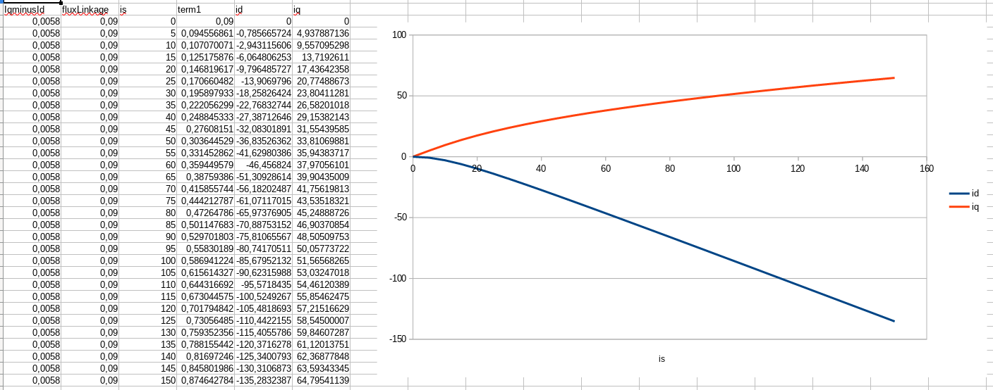

Re: Halved current during field weakening
Post by bexander »
celeron55 wrote: Sun Jun 13, 2021 9:08 am Why isn't lqminusldSquaredBs10 = lqminusld^2? It seems to be the value of lqminusld^2 / 2, i.e. half the correct value. My calculator is telling me lqminusldSquaredBs10 should be 0.03445, not 0.01722. 10-bit left shift equals multiplying by 1024, right?
Making that change will cause slightly less Id and slightly more Iq, so it obviously isn't a solution to this problem though.
I get different result when I tested in LibreOffice. I get increased Id and decreased Iq, which is what one would want, right?
Stock IdminusIqSquaredBs10 = 0.01722
Corrected IdminusIqSquaredBs10 = 0.03445
Been thanked: 1918 times
with the "corrected" one it's a bit too much id for my taste. Didn't think this should ever exceed iq.

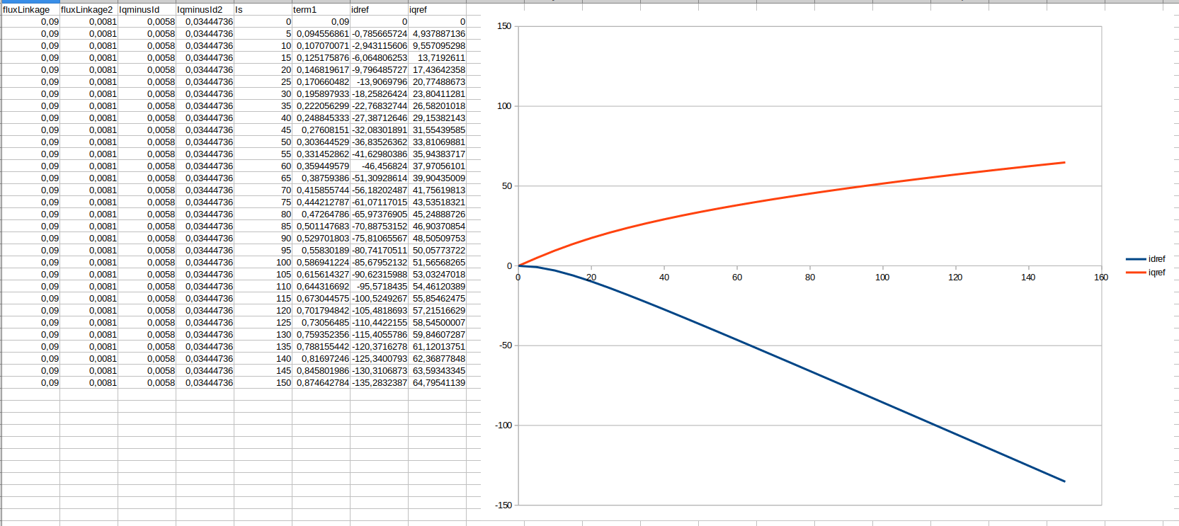

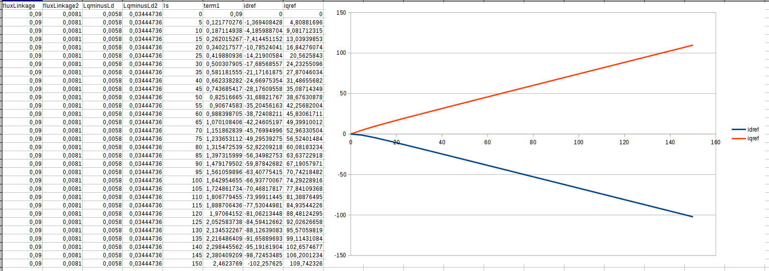

The equation presented by johu is equal to the one I found and linked to in my above post.
Anyway, results
According to SW
According to SW
According to Equation
There are differences so I guess the SW can be adjusted.
Looking at the plot according to the equation, Id is always lower than Iq but compared to SW Id is increased.
