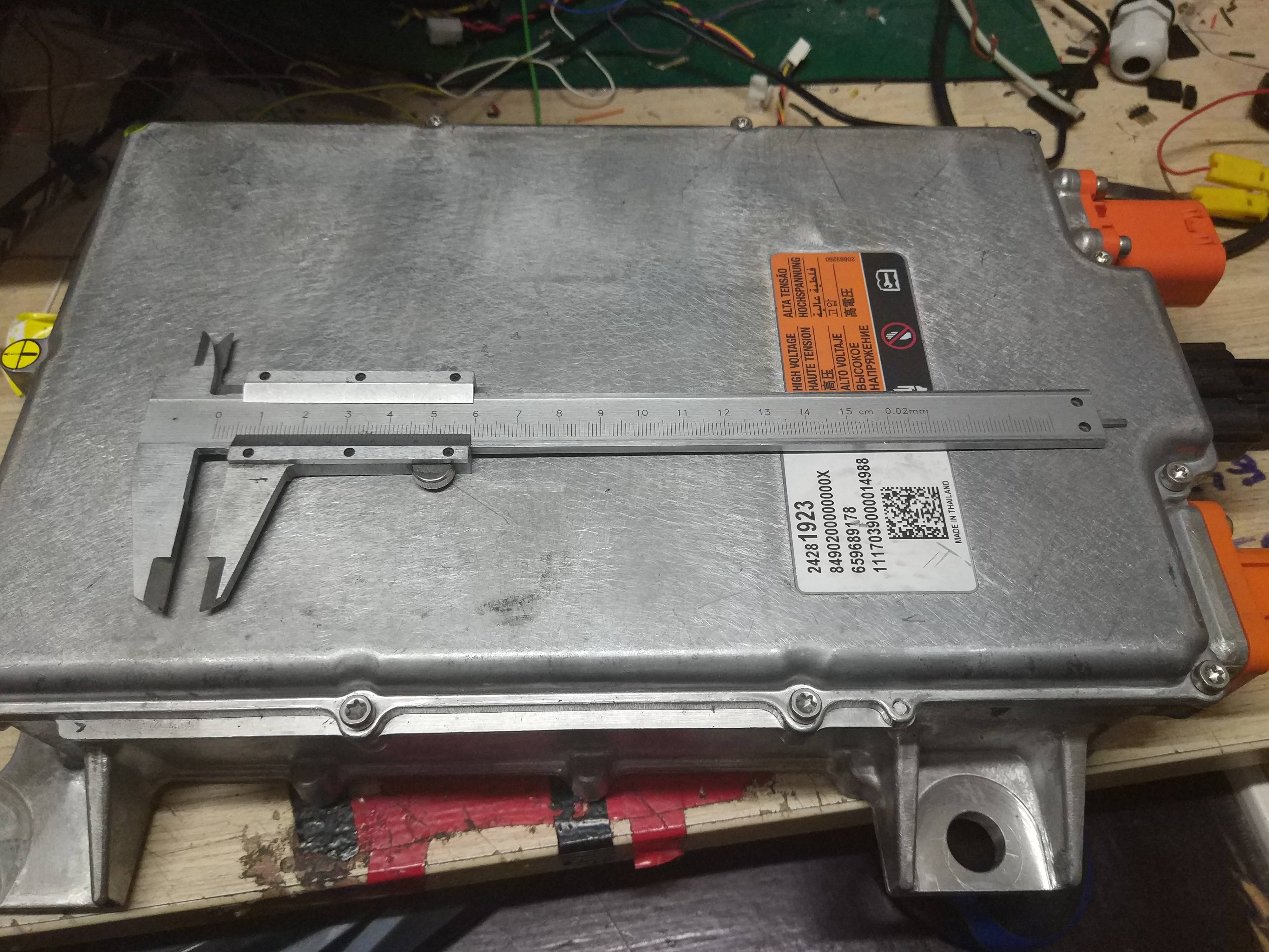

I just got one of Volt gen 2 chargers. It is a cute little unit with impressive 3.6kW power rating. Liquid cooled of course.
Immediately i tested every connector that i had available.
1. LV control connector is Molex MX150 P/N 33472-1201
It uses 6 pins out of 12. Pins are Molex MX150 F 18-20AWG P/N 33012-2002
https://www.molex.com/molex/products/fa ... tor_system
2. I am fairly certain HV battery side connector is TE HVA280 P/N 2103628 Key A 2 pole connector
https://www.te.com/usa-en/product-YHVA2 ... rce=header 3. It seems this is Delphi or Aptive HES 6 Way Device Connector Type 103. P/N 13879048
Pins are P/N 13783301
https://ecat.aptiv.com/product/13879051

I took TE HVA280 Key A 2 pole connector with wires from my broken Volvo/Eltek charger. It is the correct key and directly connects to the charger DC side. I also found a kit YHVA280-2PHI-4MM-A here:

Testing success!
I couldnt let it rest and i connected charger AC lines via some fastons. I connected HV to my test battery and LV control connector to 12V and my PWM pulse generator. I got good steady 9A of charging at 366Vdc! Control is really simple 100Hz with duty 25% to 90% varying current at an unknown rate.
After 90% duty charger drops out and if i lower it below 90% i get 9A again.
Charger has rather low thermal mass and can heat up quickly so any testing at full power is limited if not liquid cooled.
Later on i will add another module to my battery to test if this charger works with more than 400Vdc.

YA! I got Aptive HES 13879048 connector and female pins 13783291 from Mouser. Crimp pins are perfect fit.
13879048 turned to be 2 + 2 connector. 2 pins being power pins and 2 signal pins. For my use 2 pins had their cavity blocked.
Connector still fits though. I made short work of the stops and drilled out the plastic. I was a little afraid pins wouldnt fit, but it works perfectly. There is also a rubber seal inside which will protect connector from moisture and dust.
I am not sure 13879050 would be any different...
EDIT: I also tested charger can work with PWM from 90Hz to 108Hz.
