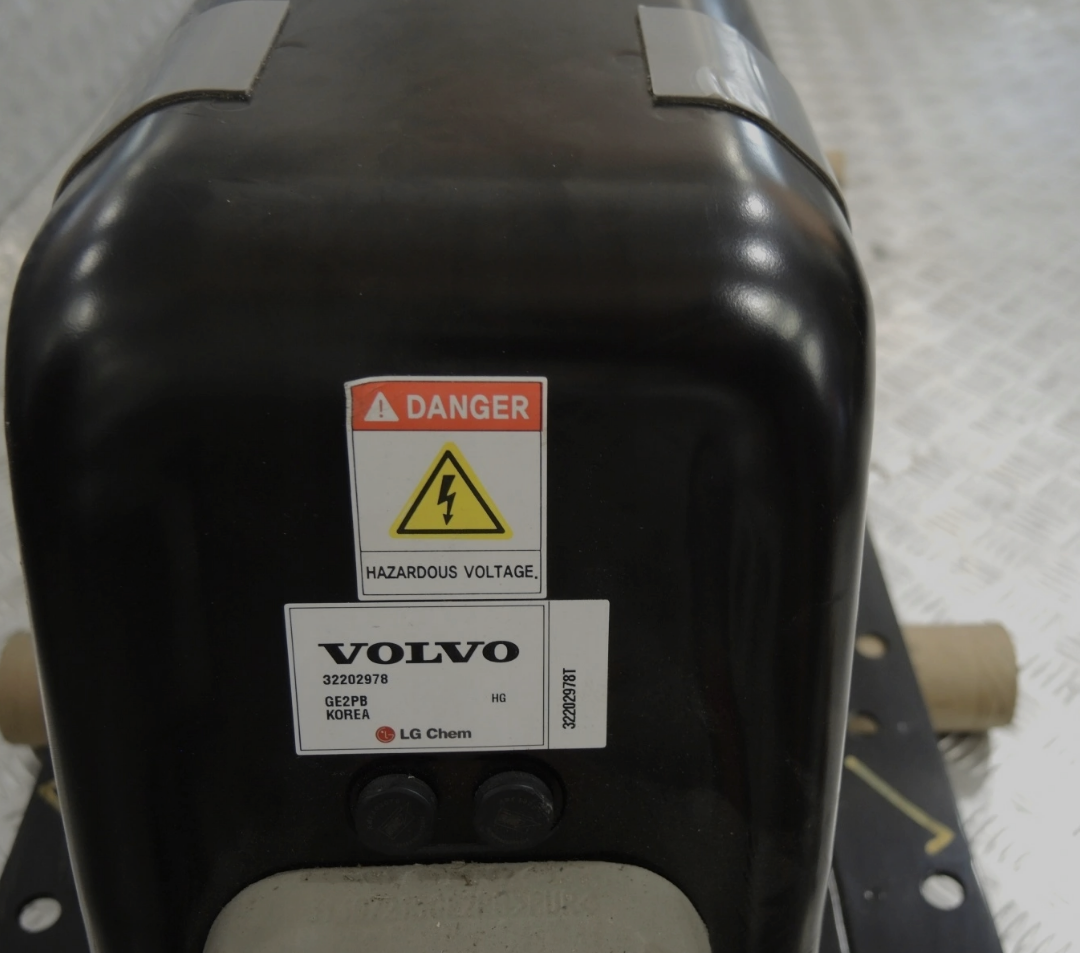

Anyone dissected this patient?
This one is form Volvo hybrid XC90.
Volvo XC90 battery pack

Thanks DarkwingDuck.
So from the video:
Chemistry: pouch Li-NMC, nom: 3.65V, max: 4.2V
Capacity: 12kWh
Voltage: 350V
Construction: 6x16S with liquid cooled plates in-between
weight: 16S = 13.6kg so whole pack = 81.6kg (with case and jewelry about 90-100kg)
Contactors: 450V 150A
So from the video:
Capacity: 12kWh
Voltage: 350V

Re: Volvo XC90 battery pack
Any pictures of the modules and their BMS/CMC?
You can see in the video.
There is no BMS, only BMU.
