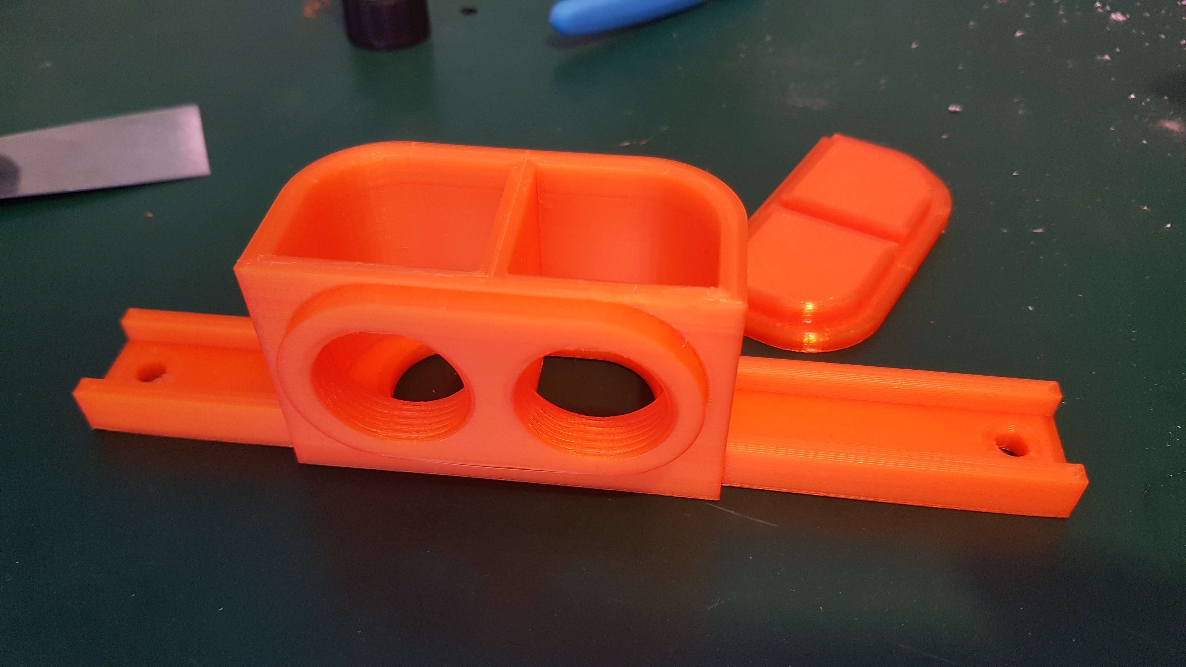

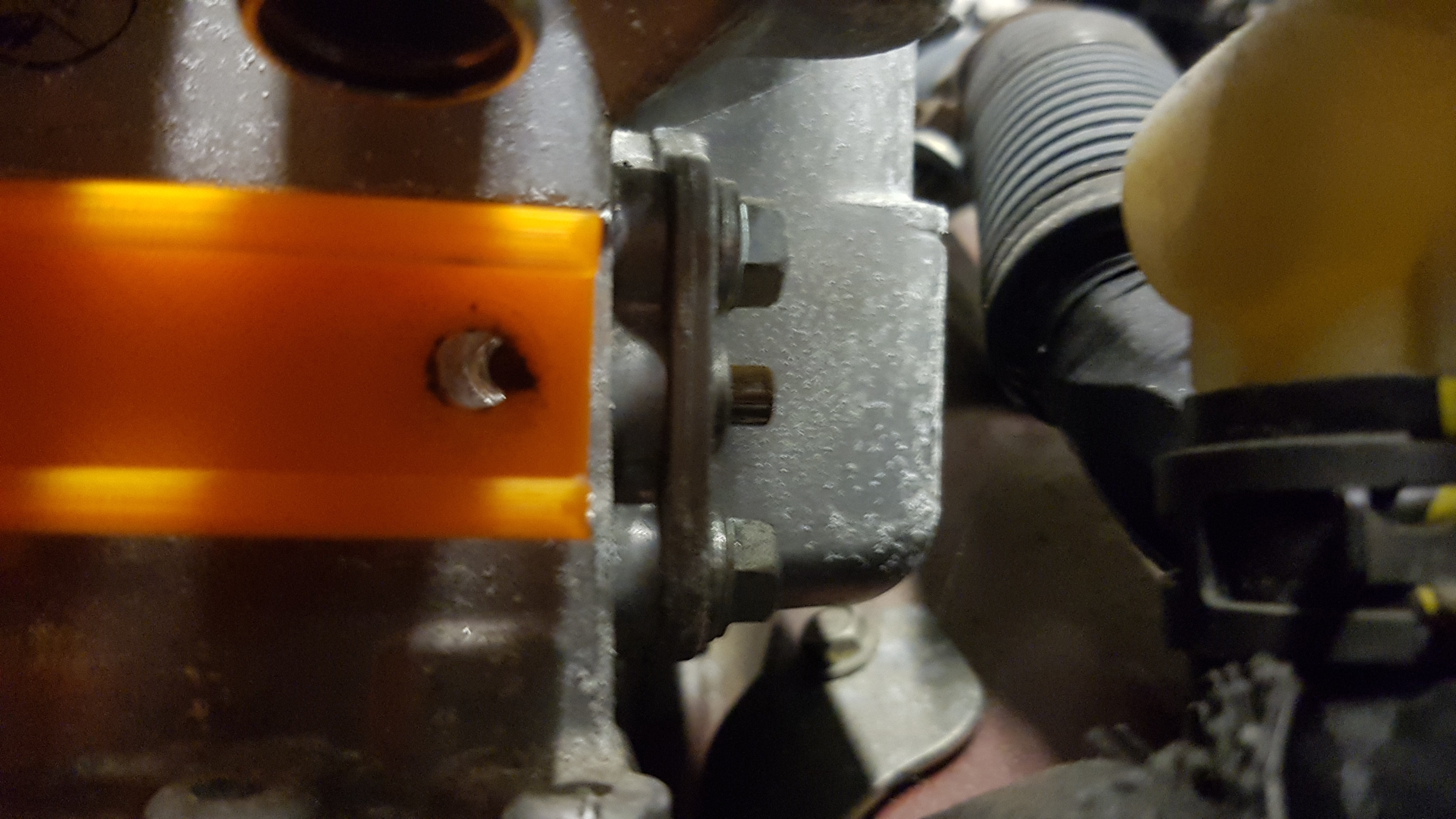

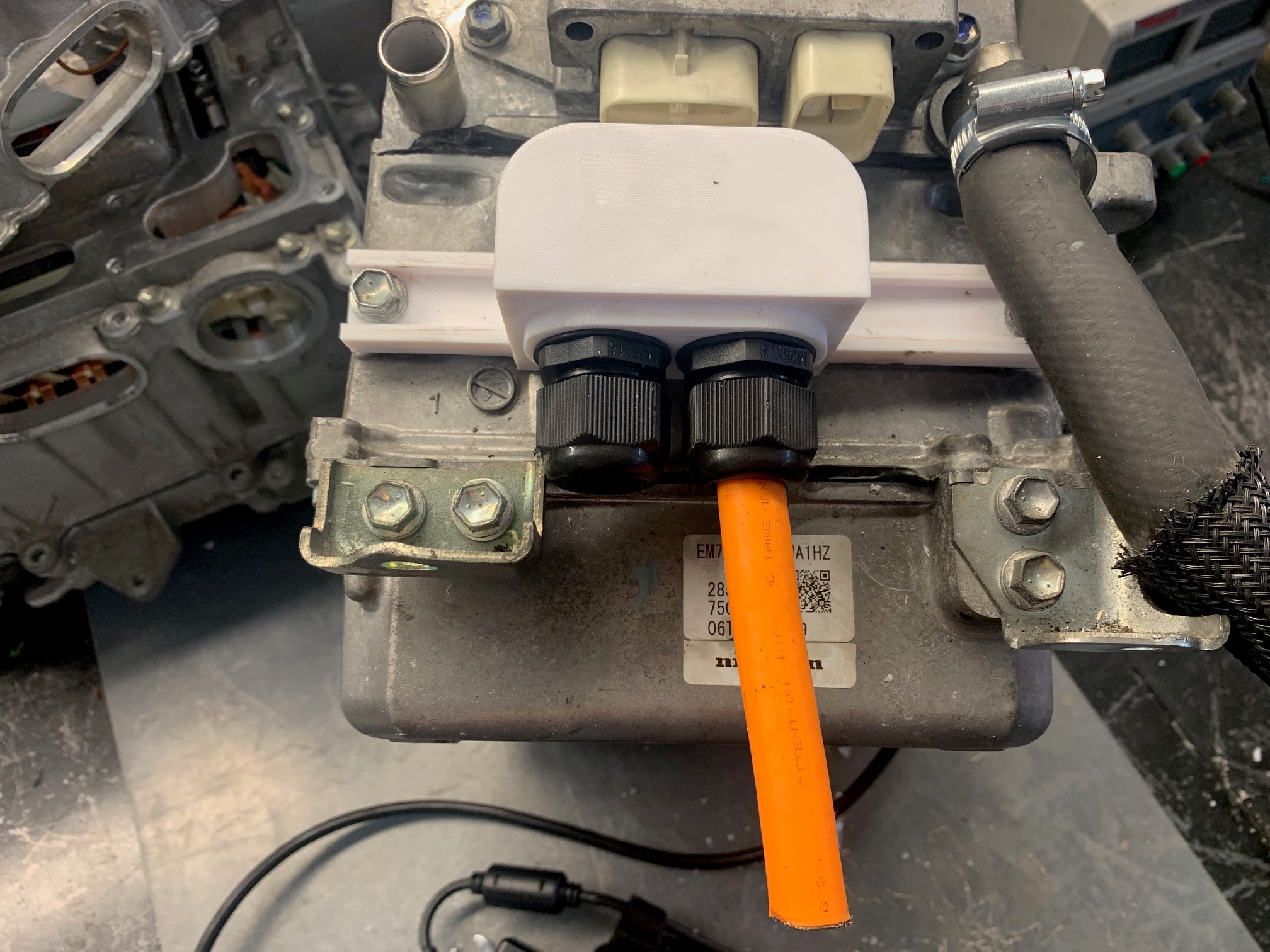

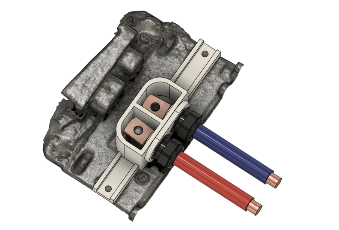

Evening all,
After a couple of requests, here's my design for an enclosure that can be sealed to make the HV battery terminals watertight for the GS 450H Inverter (stl files attached to the bottom of this post).
It bolts down to the 2 M6 bolts used by the original. Because of the flat base it needs a couple of washers under each side to keep an even pressure on the flat plane which needs to be sealed with gasket sealant.
The divider in the middle is there to help prevent physical movement rather than to provide electrical insulation as it doesn't extend below the flat plane so you'll need to use an appropriate insulation sleeve for your brass standoff posts.

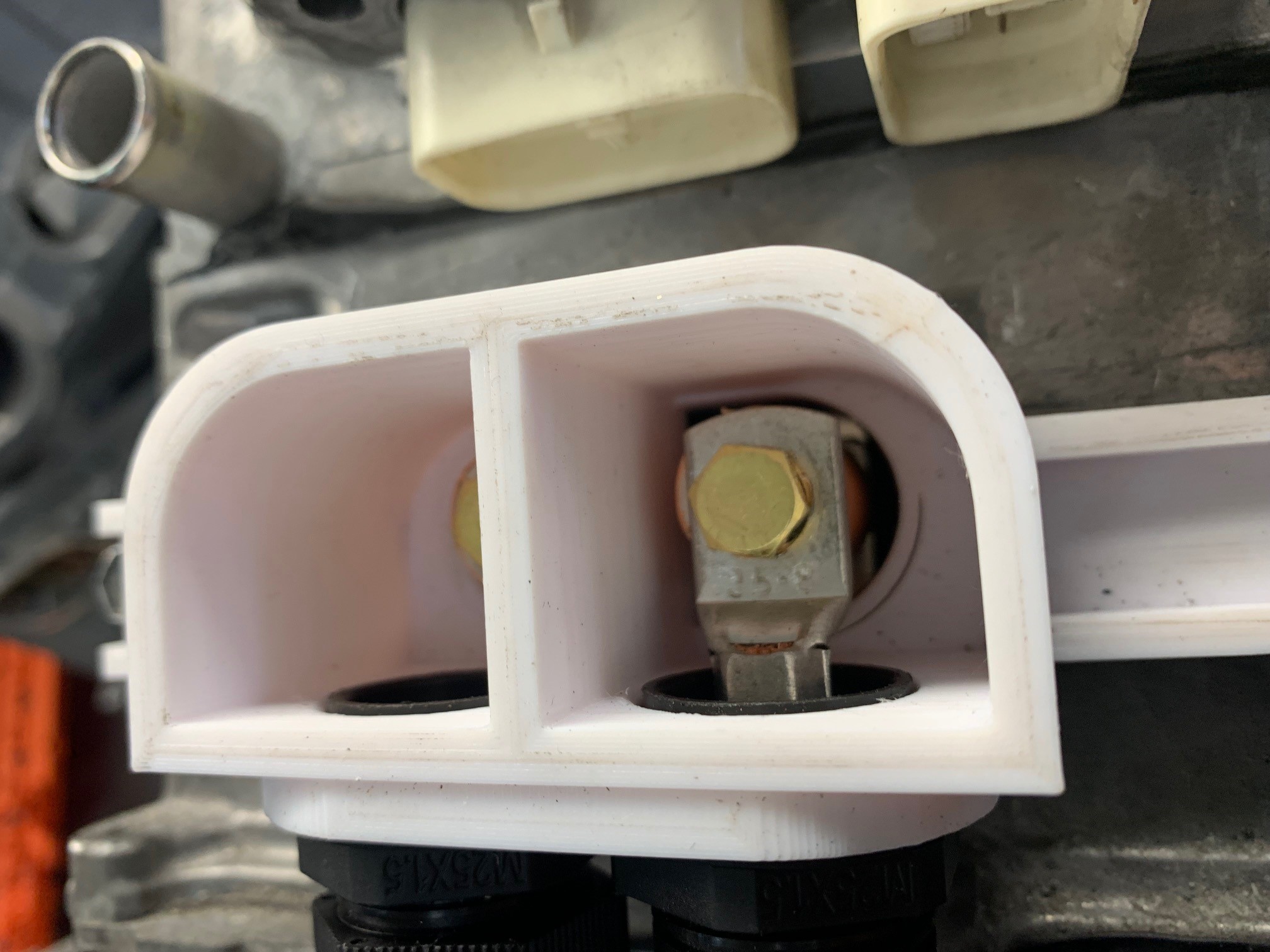

The standoffs themselves would ideally be between 30-40mm. The picture above is with a 30 mm standoff which is probably as small as you could use.
The cable glands you will need are M25x1.5. They are pictured above in a test block with 35mm² shielded cable on the left and a 50mm² unshielded cable on the right which both form a tight fit. There is an M25 thread incorporated into the enclosure design so the backnut isn't needed.
Once installed, a bit of gasket sealant should secure the lid and help to keep everything watertight. I hope this is useful if you're intending to use this inverter in the future.

Question: Why you didn't add 3 small screws to secure the lid?
Like some extra material in the corners and some simple screws would secure it.

It's a good question. When printed the lid snaps in place really well (obviously depends on your print settings) and makes a good secure fitting with friction. It is removable (with a bit of force) until you're ready to secure it with gasket sealant and at that point, if you want to take it off you'd be destroying the part either way so it'd be better to print a new part to replace it with.EV_Builder wrote: ↑Sat Jun 12, 2021 5:24 pm Question: Why you didn't add 3 small screws to secure the lid?

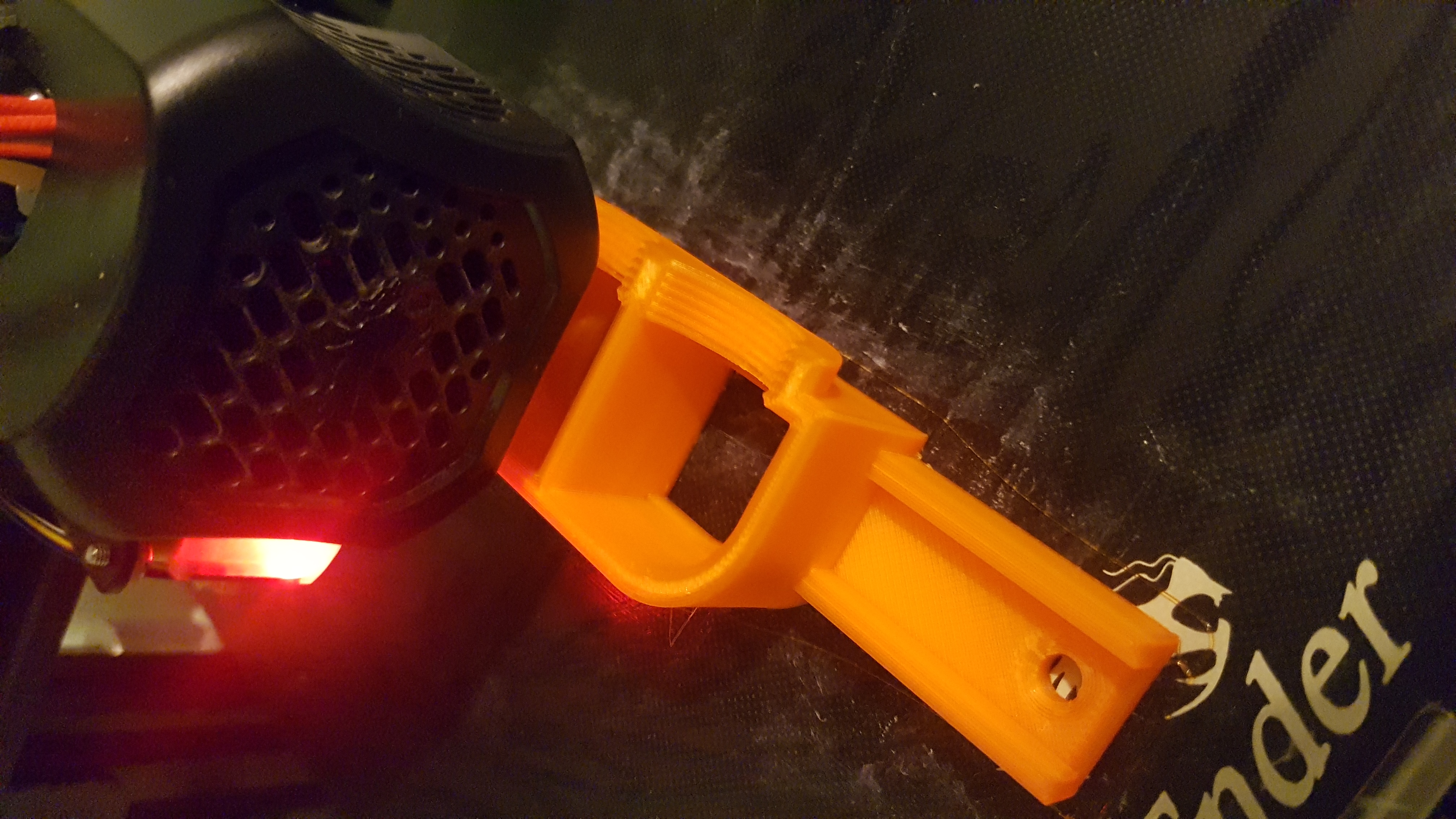

Good luck, I’ve had a lot of success with the Ender 3 V2 but the max print temp is 260°c which isn’t quite enough for Carbon Fibre reinforced Polycarbonate which is the gold standard. Going to try Carbon Fibre Nylon next as it prints at a lower temperature. Just don’t buy a Flying Bear Ghost 5 from AliExpress. Mine caught fire!
Re: 450H HV Terminal Post 3D Printed Enclosure
The Ender 3 V2 is what I've bought, been printing lots of PLA to practice, going to attempt your enclosure in PETG next!james@N52E01 wrote: ↑Sun Aug 01, 2021 2:12 pm No worries, at least if you’re able to turn the bar yourself you can get a better shape from it.

Carbon fiber blocks the print nozzle and can cause increased wear to extruder/hotend components, I don't recommend it.james@N52E01 wrote: ↑Sun Aug 01, 2021 2:12 pm No worries, at least if you’re able to turn the bar yourself you can get a better shape from it.

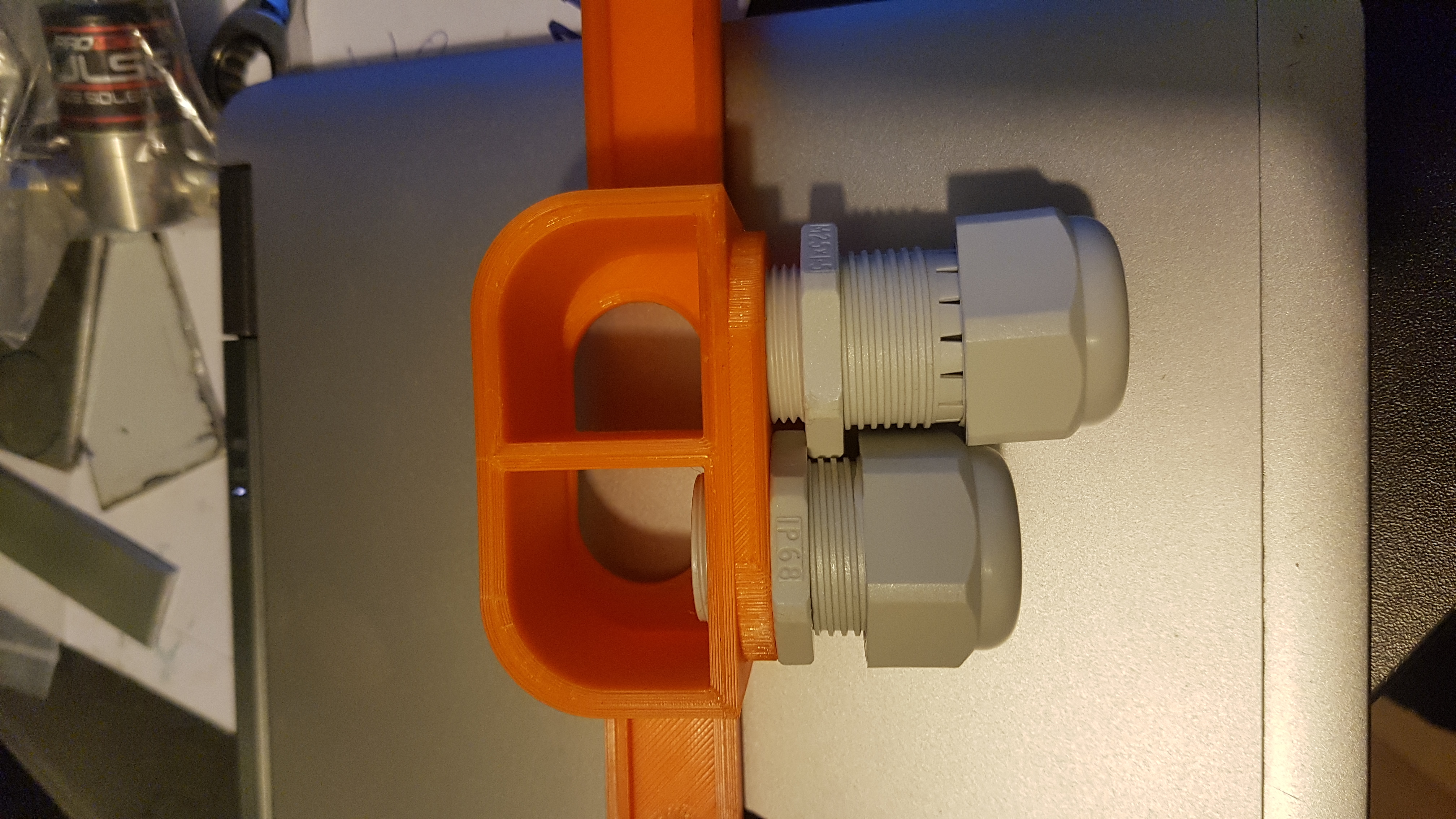

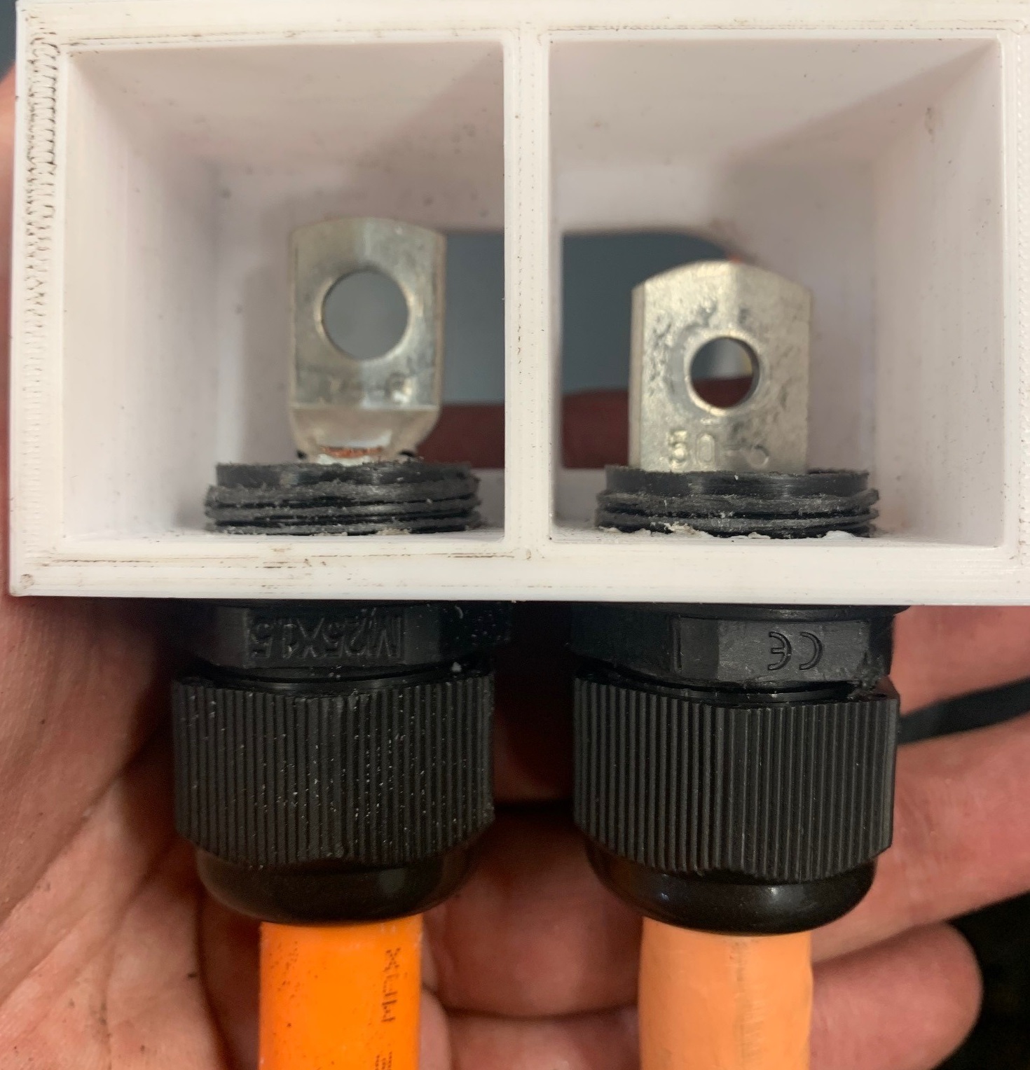

Well the print came out lovely
But having some issues fitting.

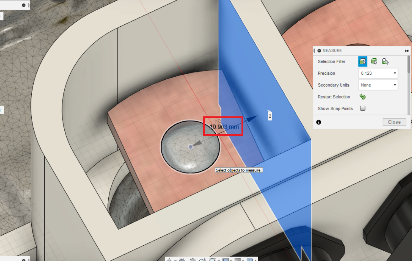

The spacing between the two bolt holes is a few mm too short. I need to confirm if this is my printers accuracy that is at fault and measure it up against the cad model. It's not a big deal I can file it out a little. And today my cable glands arrived, but unfortunately seems there isn't enough space between the two threaded holes for the two glands to screw in side by side, did you find two glands that fit? Could you send me a link to them if so? Thanks
Dan
Dan

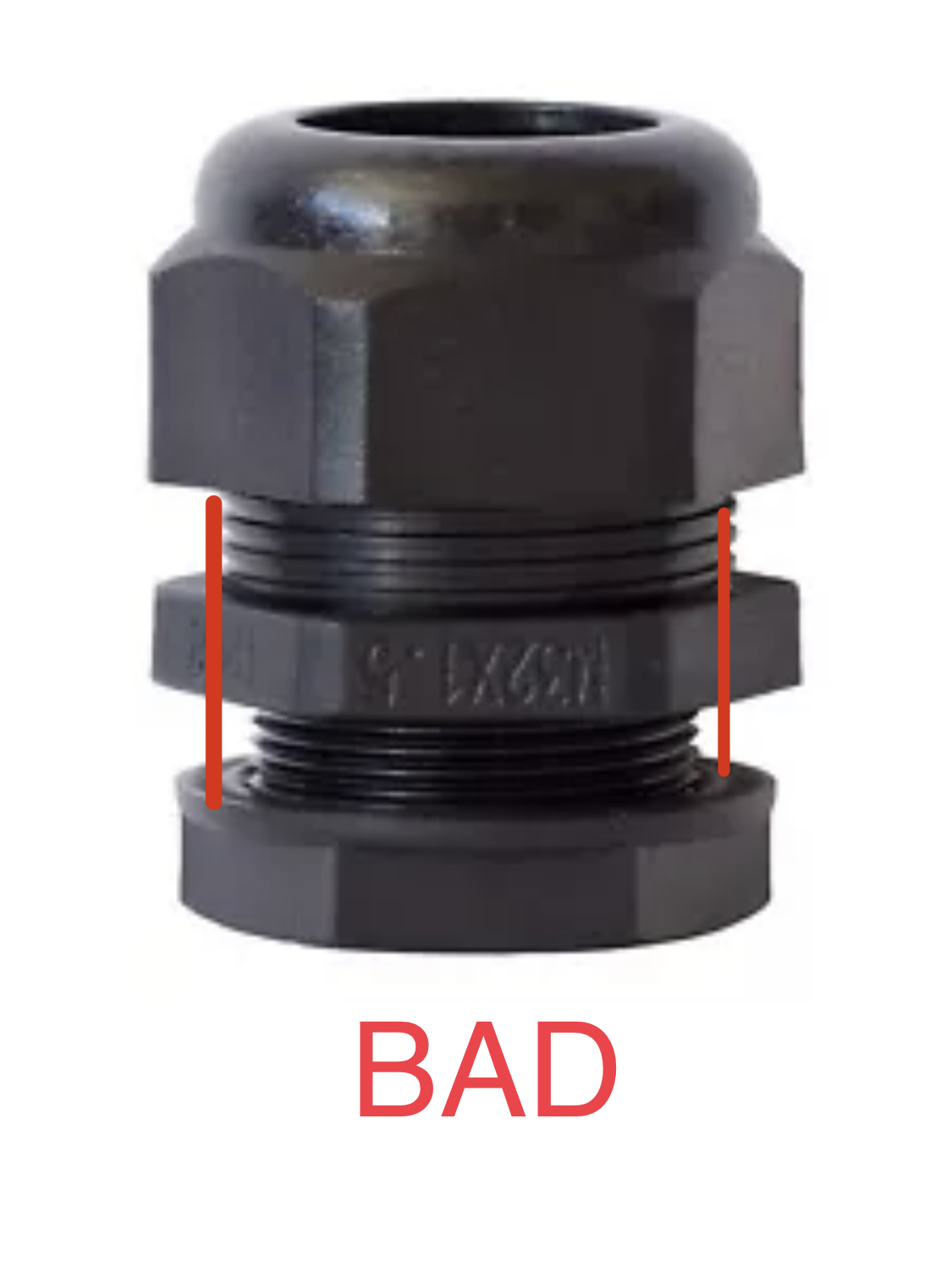

There was similar on my printing too. I think because M25 cable glands thread fit nicely it is not printer accuracy.
There might be different cable glands, mine was like those gray ones which was in my case plausible but tight fit. Screw one in, align its flat side of the hexagonal nut against another cable gland and another one should be able to tighten just barely.And today my cable glands arrived, but unfortunately seems there isn't enough space between the two threaded holes for the two glands to screw in side by side, did you find two glands that fit?
And many many thanks to James for sharing this enclosure!!

Thanks for posting this. That’s my bad, I had the same issue as well, the post holes were a few mm too close together in both directions. I corrected the model but must have uploaded the old version, sorry. To correct it I just ran a 6mm drill bit (by hand, not in a drill) up and down a few times to widen it out slightly. I’ll update the model when at home next week.

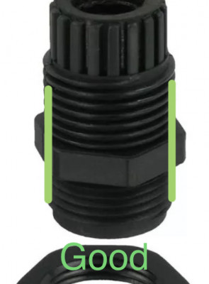

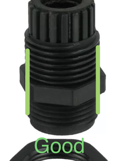

Glad the print came out well Dan. I’ve looked into the gland size issue. Very helpfully, the specs tell you the thread for the hole but not for the gland part on the other side. There are a range of sizes and the ones you have are the bigger ones. I can get some eBay links for the ones you want if that would help but essentially you’re okay with any glands that have the same thread (m25) on both sides. Example below:Dan--T wrote: ↑Wed Sep 01, 2021 9:09 pm
Dan

Thanks for the reply James. I want to point out that I'm in no way disgruntled or blaming you, you've taken the time to design this and post it for free and I'm really grateful for that!
The bolt holes aren't a problem, I've made them both oval with a needle file and it fits now.
Thanks for posting up the gland type, I'll have another look on eBay for ones with M25 on both sides of the nut!
Got some nice new slimline cable glands and now fit perf ctly!
These ones work
https://www.amazon.co.uk/gp/aw/d/B07JZ5 ... asin_title
Dan

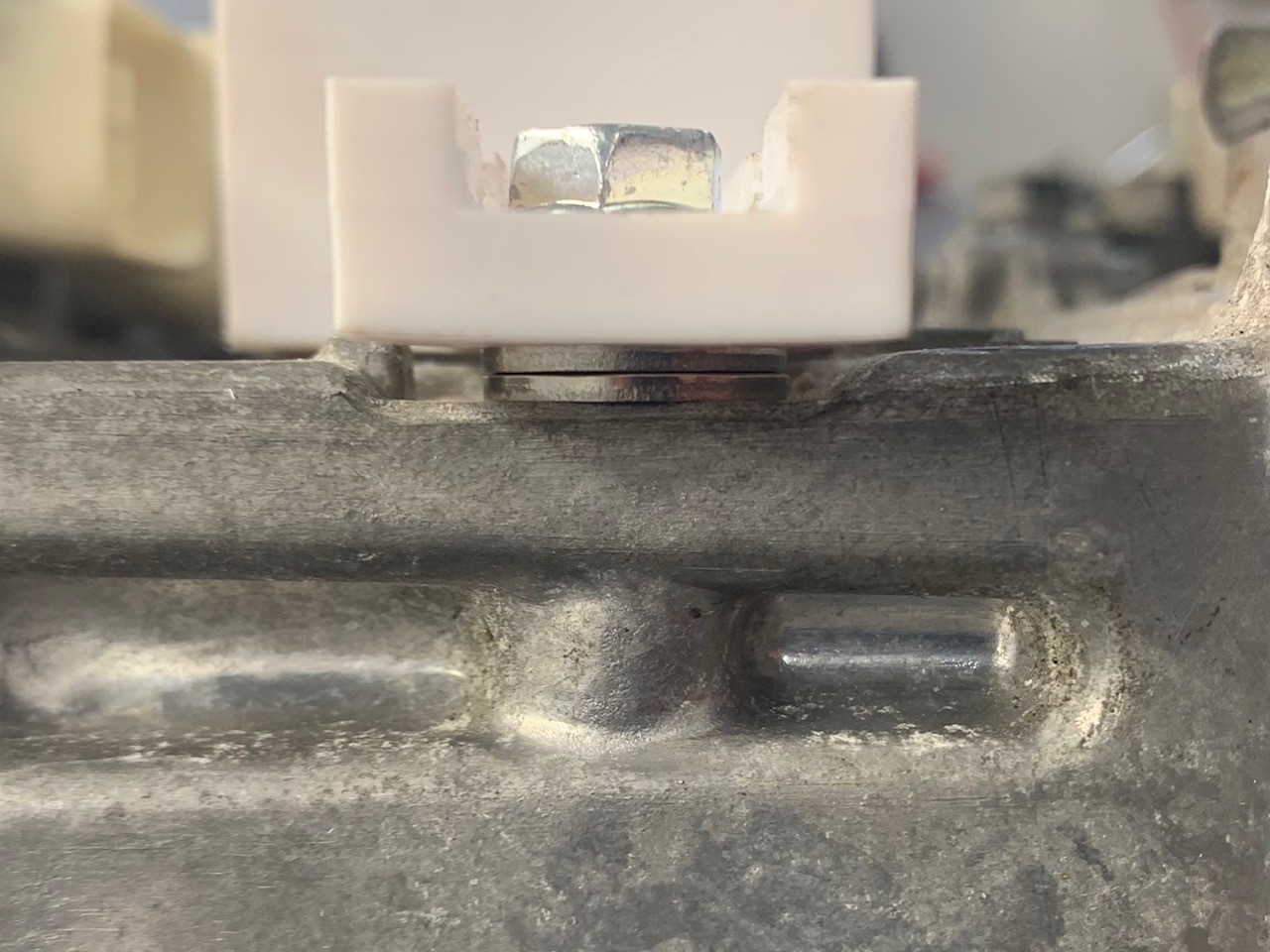

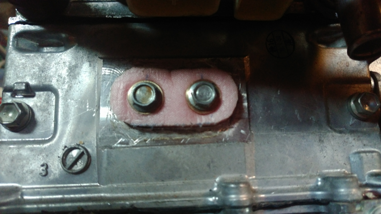

Here's my simple implementation.
Two posts made out of 3/4" diameter brass rod machined down to 16mm, each with a 6mm hole for the bolt.
A 55 x 30 x 20 block of polypropylene foam cut with a sharp scalpel into an oval shape slightly larger than the hole in the inverter with two 14mm holes of centres spaced by 25mm cut into the foam and jammed into the oval hole and around the brass posts. The 14mm holes were cut into the foam with a sharpened piece of 14mm OD steel tubing (sharpened with a countersinking drill bit) spinning slowly on the lathe.
No hacksaw required.

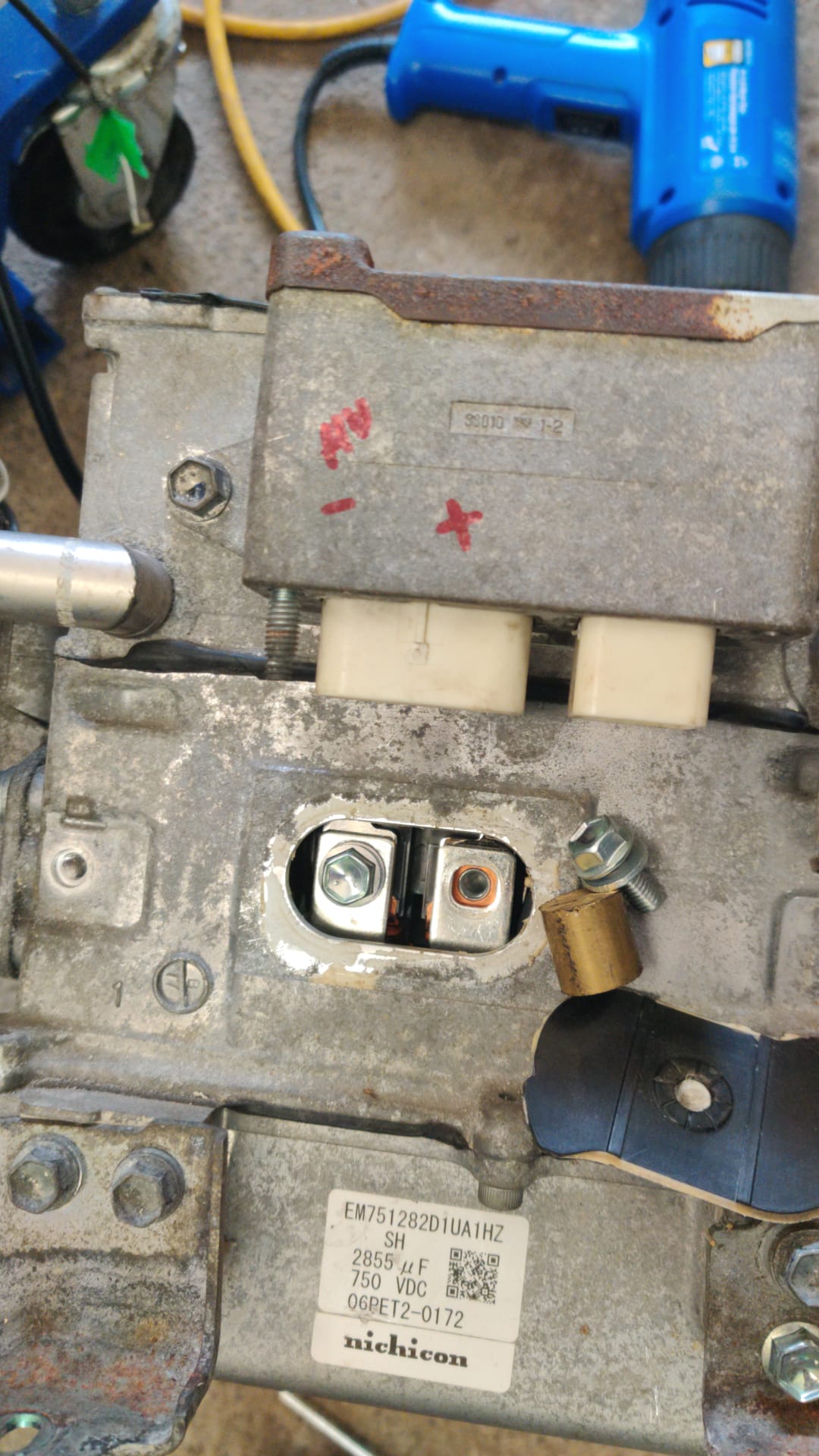

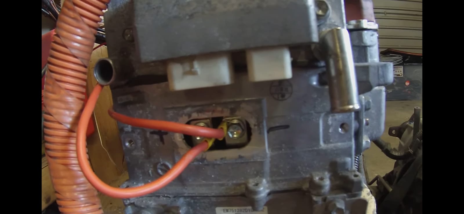

Greetings EV World.

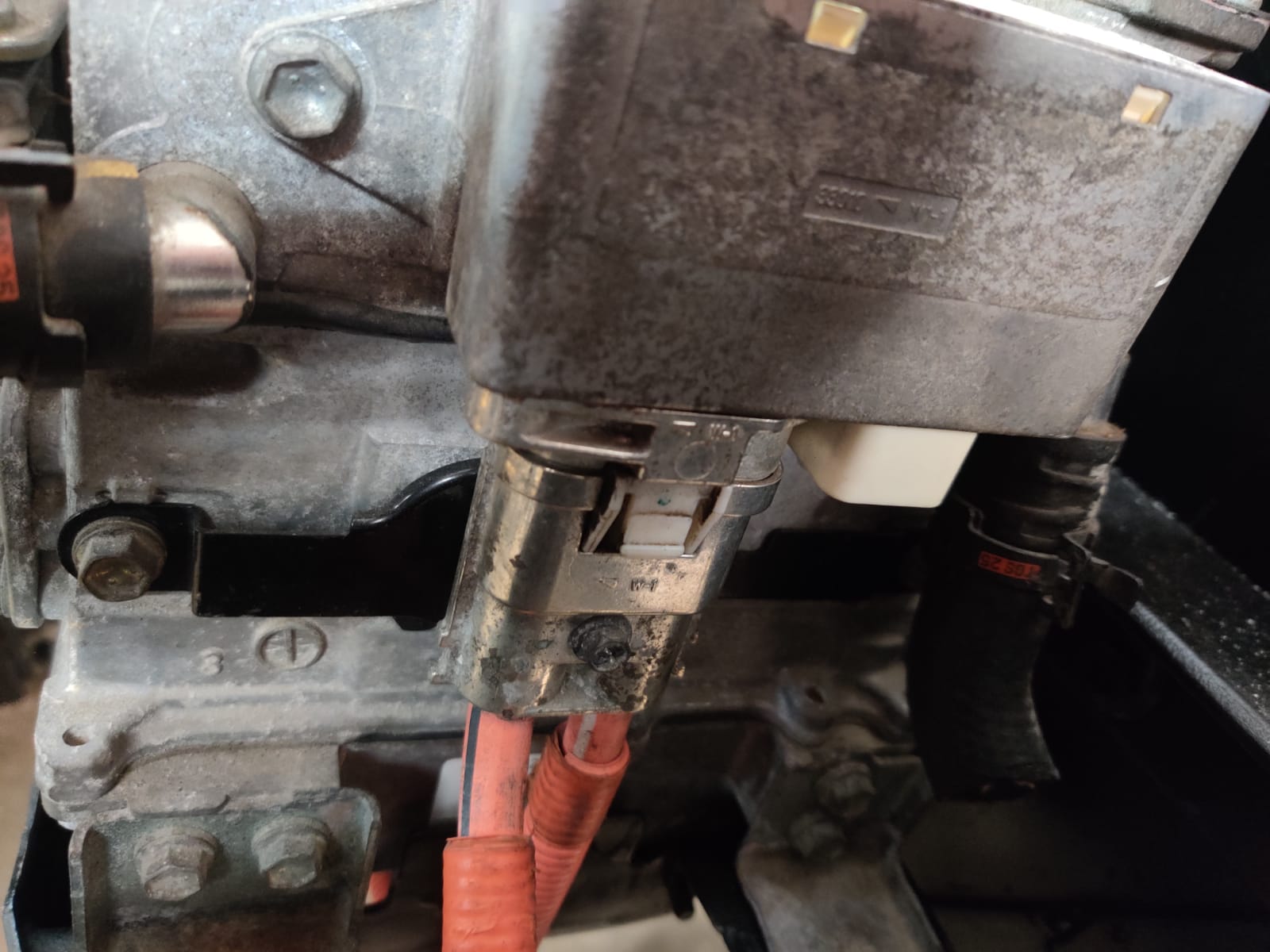

In Damien's last video he mentions making the HV DC connections to these points in the GS450H inverter and not the OEM location, from the previous Prius inverter videos, was under the impression that was only for Prius Inverter only.
Can someone confirm which side is positive and negative?
The OEM HV is listed above:
Left (-) | (+) RIGHT When connecting a Ohm Meter, for the brass studs, the (-) is on the RIGHT, and the (+) does not make any noise or contact.
Can we confirm which side is HV DC Positive, and Negative.
This important safety info should be on WIKI.
