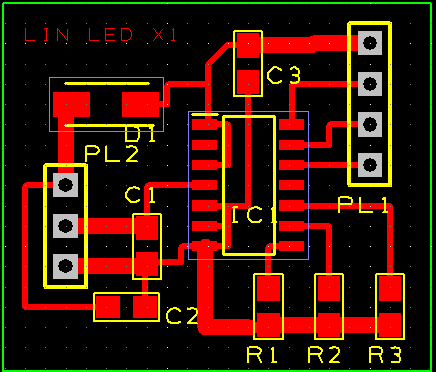

I found a nice cheap Lin led driver with everything on board. I'm wondering would it be worth spinning a board for these allowing us to drive RGB LEDs for chargers or vehicle state etc...

I think I've also figured out how the toyota inverters can work for the different models. I have an intermediate class called ToyotaInverter which provides much of the MTH-HTM communications support. There's still lots of testing to do, but looking good so far. I'll be poping the files up on my fork of the GD_Zombie code on git when i get a chance.

In other news, I've completed a little Tricolour LED driver for LIN, I'll make up some boards later in the week.
