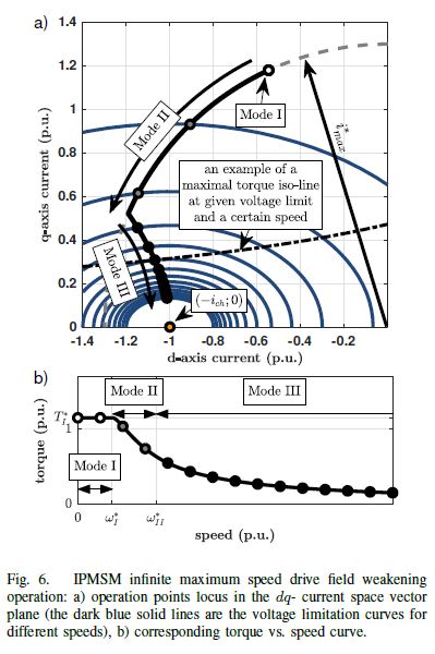

I'm up for some more motor control alchemy. Are you? :mrgreen:
There was this "speedy_gonzalez" person who posted some really interesting stuff about "infinite speed drive" class motors in viewtopic.php?f=7&t=1628 and said that the Prius motors are of such type. They since deleted all the content of their posts. No idea why. I saved the graph they posted and will attach it here too. I'm going to completely botch the terminology because I didn't save the posts and can't be bothered to dig up the papers they posted that I didn't bookmark. They said something like: These motors have three operating modes or regions instead of two. Two being (1. non-FW and 2. normal FW), three being (1. non-FW, 2. normal FW and 3. current-limited FW).
Basically it was so that you have a maximum field weakening (-Id) current that you can use, and once you reach the maximum you're in mode 3 and have to start decreasing Iq in order to stay in FW (to advance the current vector further without increasing -Id), I recall you then ramp Iq down in such a way that the motor power stays the same.
I'm going to suppose the MGR is also this type of motor, and also that it's basically the same as the Prius motor and also similar to the graph in the image.
I believe we're still very far in terms of correct Id-Iq distribution. And of course we don't have any of the limits implemented, but we have to start from the lower speed distributions.
In the graph you can see at the mode 1 -> mode 2 transition point the Id-Iq relation is about Id=-0.7*Iq, at mode 2 -> mode 3 it's Id=-2.3*Iq and at the end of mode 3 it's Iqd=-7*Iq.
Now, these modes seem to be only or mostly dependent on motor speed and there's no information on what the speeds would be. Given that moving current from Iq to Id increased performance when starting from about a 1:1 distribution at 2300rpm, I would reason 2300rpm is close below to the mode 2 to mode 3 transition point. Maybe the transition point is somewhere between 2500-3000rpm.
The goal would be now to make the motor accept full power (45kW) at around 2300rpm (153Hz) and when that is achieved there should be a very steep performance loss at some higher RPM if the currents aren't appropriately limited - however we can try to use the idcmax value to implement mode 3. When mixed in with syncadv, it will result in something surprisingly close to ideal control I believe.
To make 45kW at 2300rpm, given that it's where I think it is, looking at the graph, the motor wants about Id=-2*Iq. To make that happen using syncadv, current vector needs to be advanced to 153 degrees from the regular 127 degrees, that's 26 degrees and, given a syncadv of +10 at this speed will give 7.5 degrees, we want a syncadv addition of 35, that's a value of 10+35=45.
Then to limit power to 45kW as a mode 3 implementation, set idcmax to... uh, bexander: what's your battery voltage again? If it's 350V, set idcmax to 128. Well anyway, it should be 45000/udc (I=P/U).

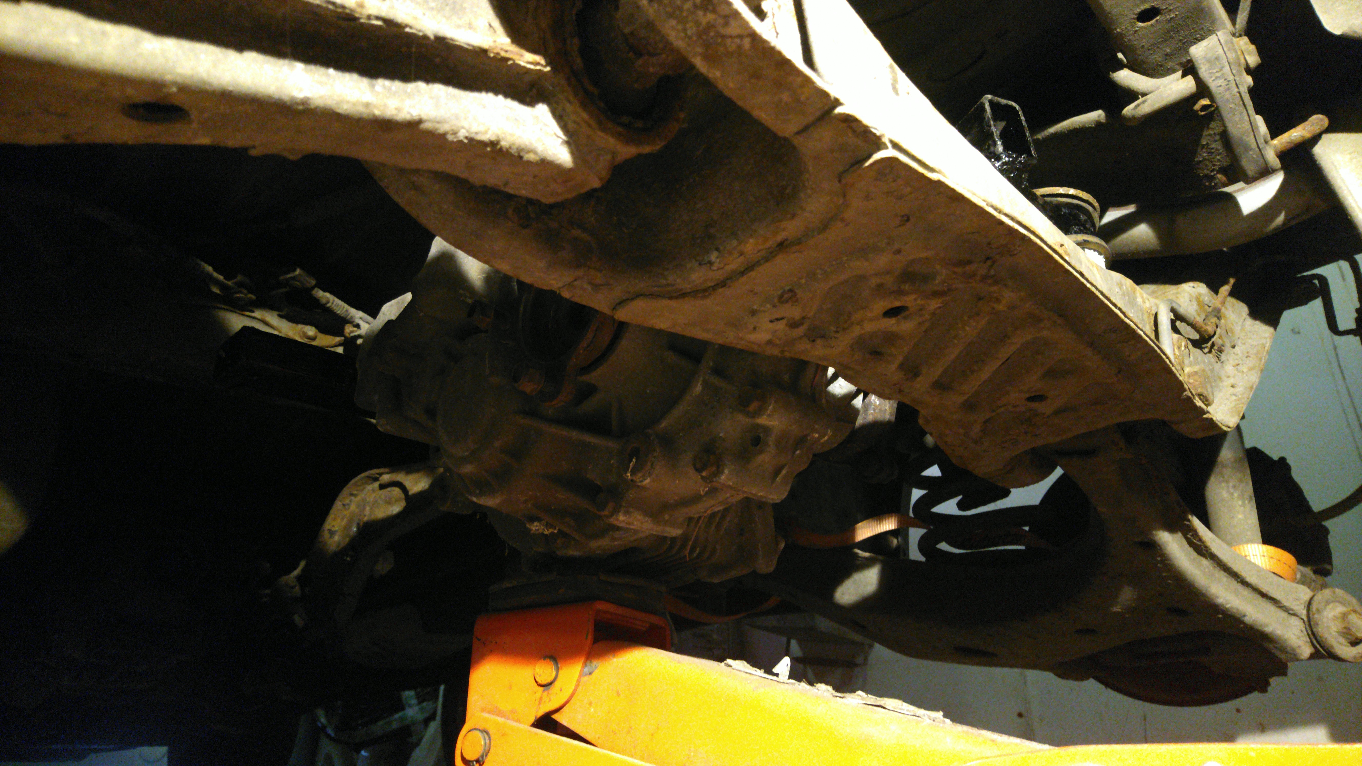

I decided to start doing at least a temporary MGR installation to get on board with testing. Won't have much time sooner than after two weeks though.
I will be using a Leaf gen2 inverter for this, and a 96S battery pack - pretty much the beefiest stuff within reason.

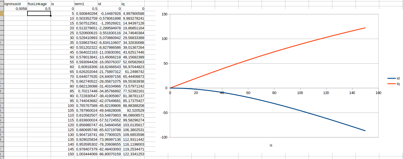

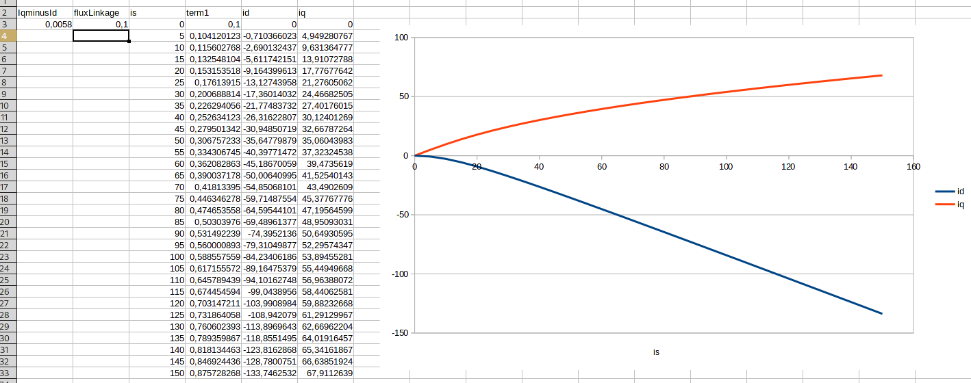

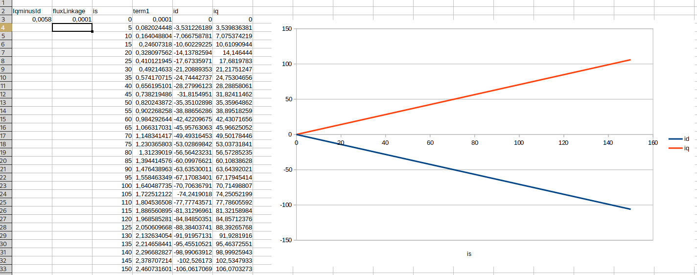

And lets come to that. I have played around with the MTPA formula and I find it a bit weird. If I leave it like it is, changing lqminusld and fluxLinkage actually make a difference. If I change it to the one advertised by TI or Mathworks, it always results in a pretty linear 50:50 distribution of id and iq
fluxLinkage=0.5
Without the factors, fluxLinkage=0.1
Formula with the "8" and "4" factor in it
So I don't know what to conclude. Is TIs formula wrong? Or do we not understand it correctly? A formula that hardly responds to its input parameters doesn't seem very useful. I think I will make a firmware with "our" interpretation of MTPA and have fluxLinkage be a parameter.
Been thanked: 1918 times
Re: Halved current during field weakening
Investigated a bit further. So in TIs formula we have the term
fl²/(16*ldminuslq²) (fl being fluxLinkage). If I plug in our commonly used values, the result is about 18. To that is added is²/2.
Now if it is like 100A it will be totally dominating with a value of 50000. The other term just makes it 50018.
So it's almost like writing sqrt(is²/2) or is/sqrt(2). Then in front of the square root we have fl/(4*ldminuslq) which results in about 4.
So we essentially calculate 4-is/1.41. This can't be right?
