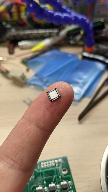

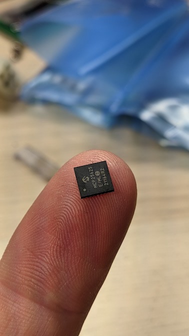

Got my boards today! Thanks Jack ;-)
I need to fit the MCP25625's, Jack included the parts with my boards. Anybody done a video on fitting this part? Should I make a video?

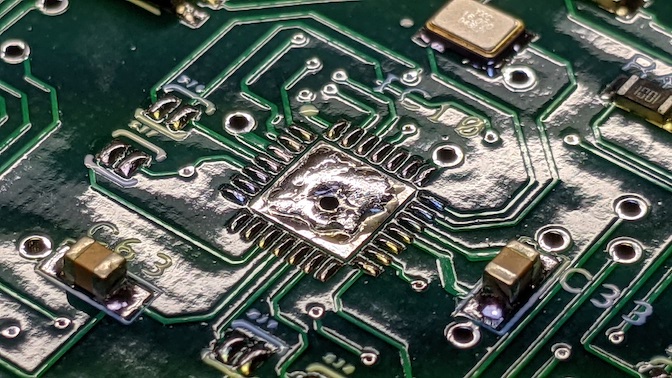

That MPC25625 was a nasty little bugger to fit onto the Zombie Brain! I hope I got all those pads nice and seated.
