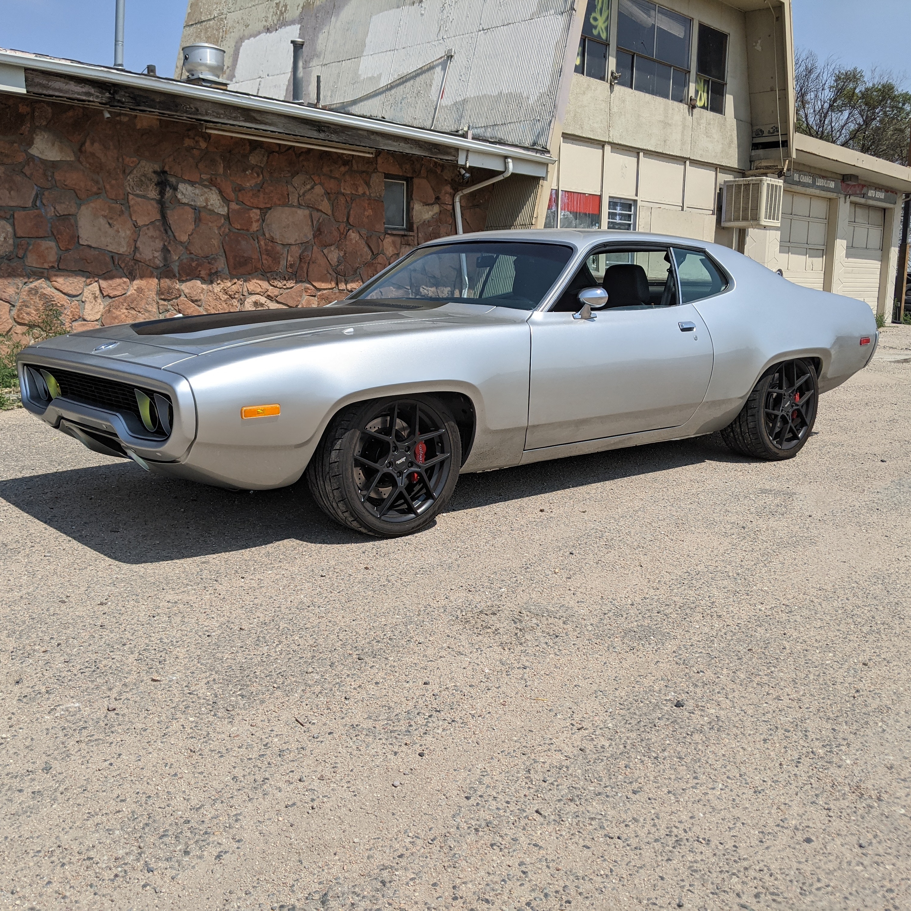

Hello, I am looking for some advice from the experts, beyond the already terrific information on this forum.
I have a newly running build and I am feeling my way through the settings. My dyno guy from my Turbo builds has offered me a free dyno day so we can learn the Inverter tuning.
I would like to approach the session with a solid plan on what to tune first, second, and so on. Any advise would be very much appreciated, thanks in advance.
The car is a 4000lb + 1972 Plymouth Satellite
LDU Sport motor with Zero EV control board
100 kWh Tesla Battery pack
Orion 2 BMS
So far the car makes decent power but I would like to safely maximize the potential with some fine tuning.
I look forward to sharing all the results and hopefully have a good base tune for similar builds.

Found the smoke.
I have probably 1000 miles on the car with lots of hard acceleration. Not sure what would cause the Tesla pyro fuse to blow, it was power off regen at the time, battery cells were about 4.05 max.
Here is a picture of the inverter, the bottom phase took hit. Do you guys think this is due to the fuse blowing?
