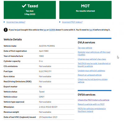

Well I'm feeling very lucky today..
Just checked on the .gov website and the mini is now showing as 0cc and ELECTRICTY as fuel type.
Hopefully get the V5 in the post soon.
Keen to see if it's still classed as historic on the V5.

When When you send your v5 in? Checked mine and it still says petrol
