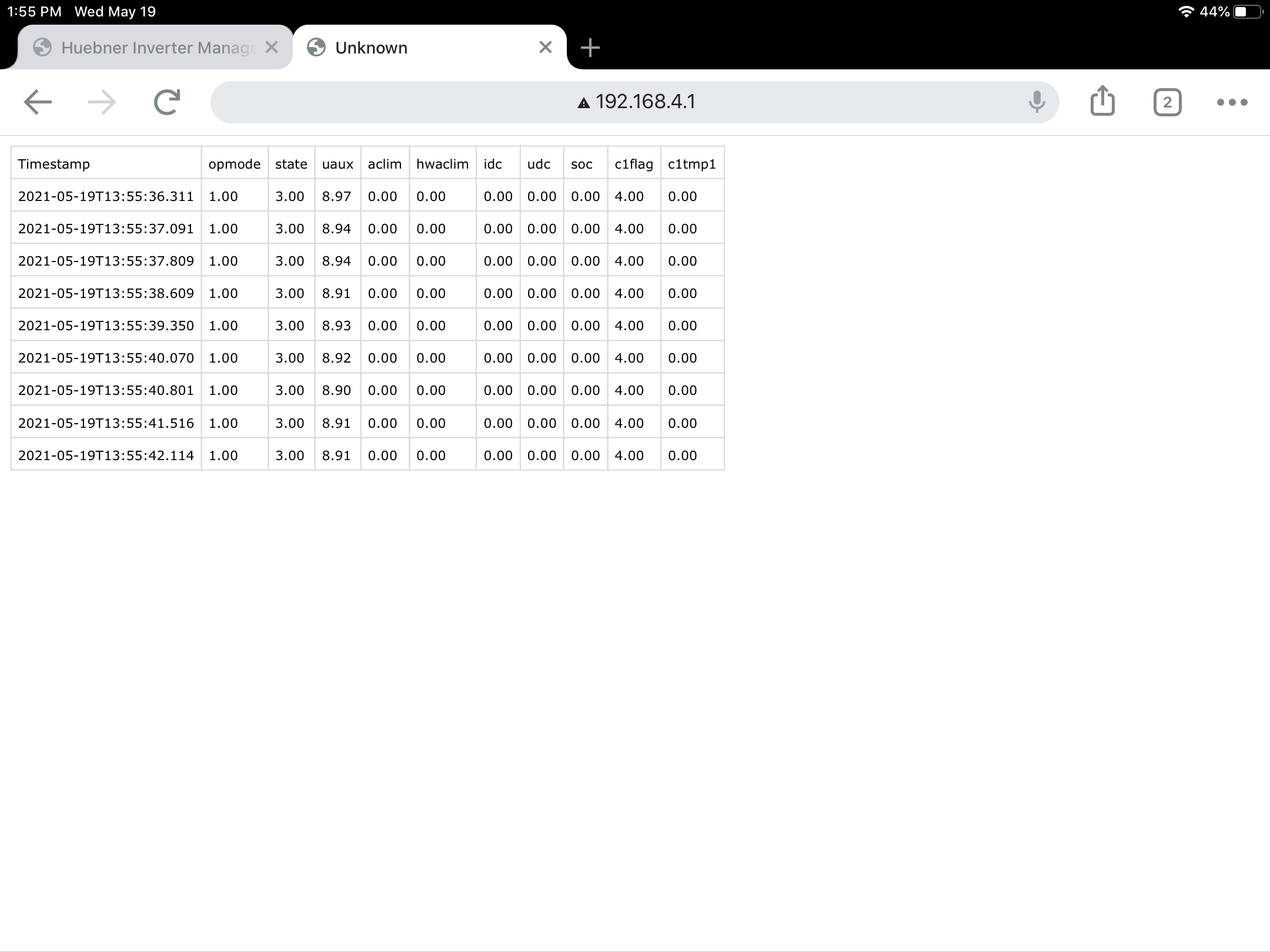

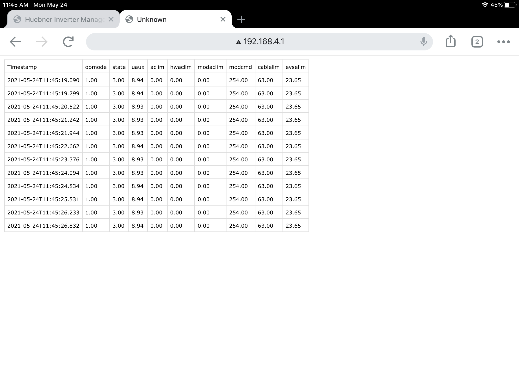

Sir, I did try again EVSE kick in it looks like charging ,but my battery voltage
Is dropping so it not charging here is the screenshot.
Please guide
Posts: 6765
Has thanked: 383 times
Been thanked: 1582 times
Re: Tesla Charger alternative firmware
I think your version of the datalogger has a limitation, only 8 values can be logged. Can you reduce your selection to the relevant ones and post the data as a text file, not image?

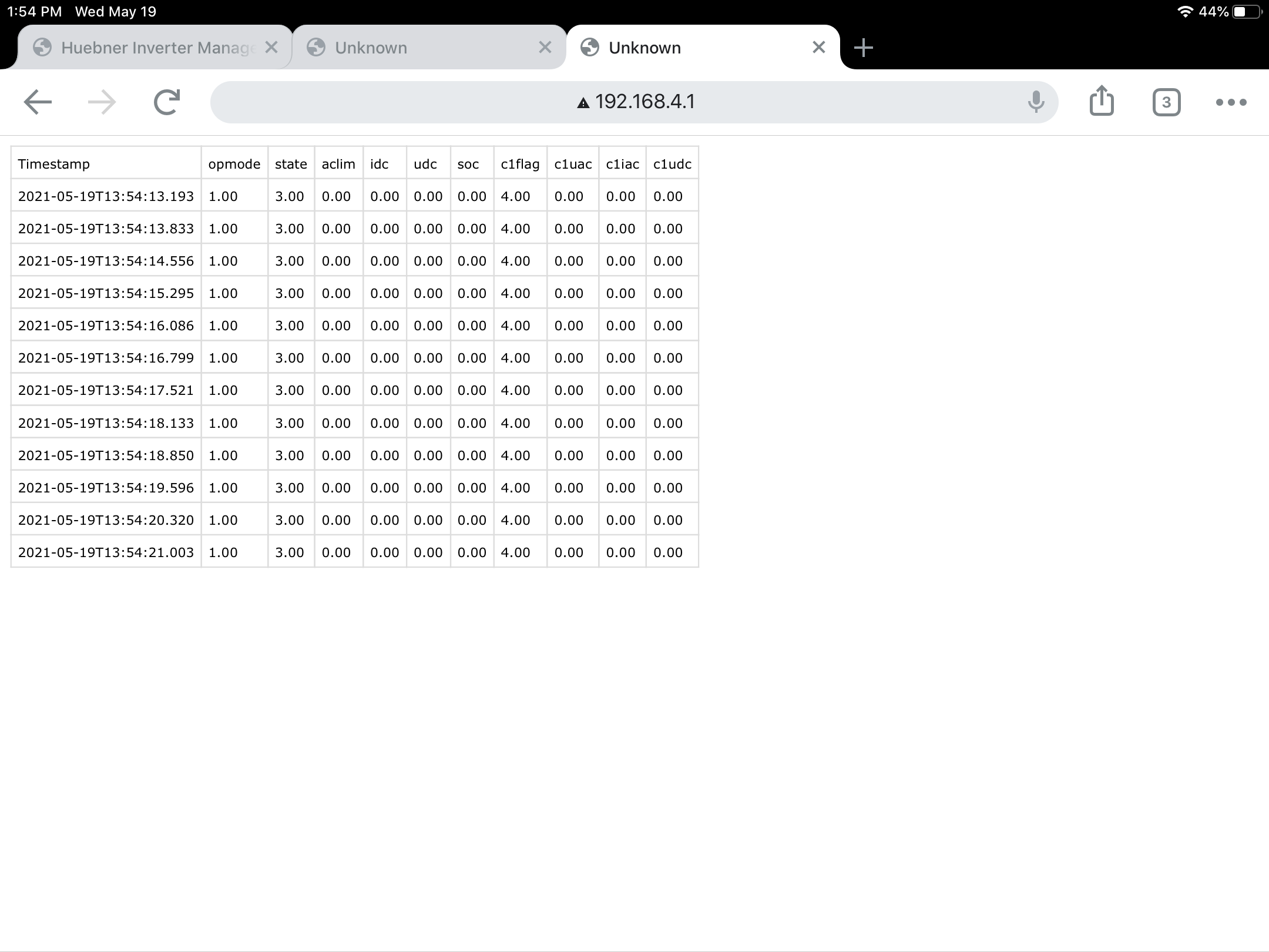

Could not save text file attached better image

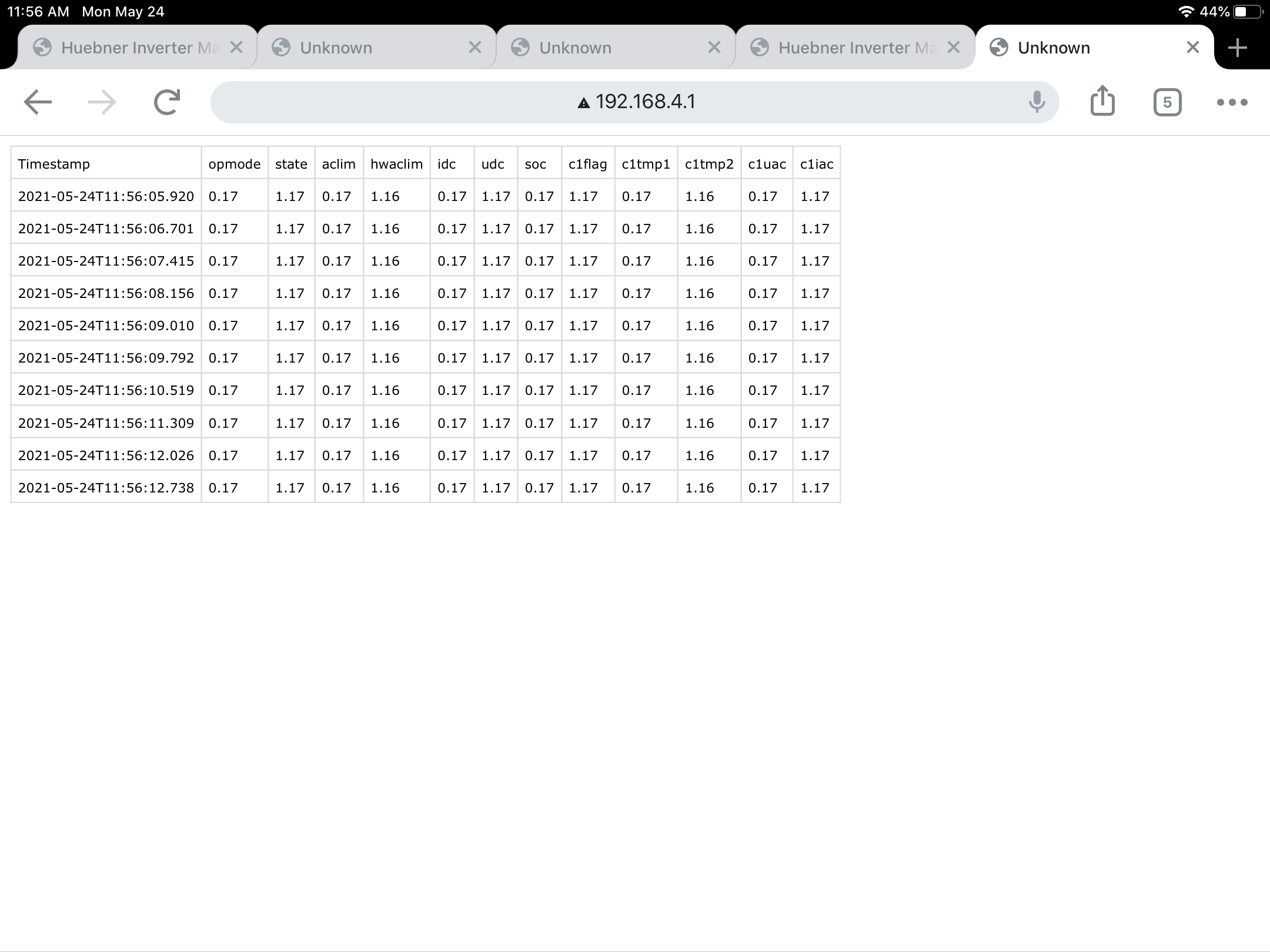

On the same setting it show different data for same parameters and also repeat same value in all parameters.
Please advice
Posts: 6765
Hmm, no AC voltage reported on c1
Also, do you have B3 board?then uaux reads too low

Your second datalog looks strange, like "0.17" for opmode. Not sure what happened there. I would need to get access to your charger via remote support to clarify. Can you install the latest firmware: viewtopic.php?p=27210#p27210
