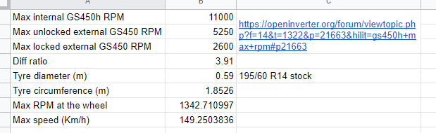

Well efficiency is the thing and top speed / acceleration choice.
Did you calculate top speed from GS450h rpm to wheel speed and tires? I would first focus on that and then on regen / inertia..
Re: Differential type & ratio for Regen braking
I believe the attached calculation is correct. Based on unlocked MG1 & MG2.EV_Builder wrote: ↑Fri Aug 13, 2021 10:47 am Well efficiency is the thing and top speed / acceleration choice.

150km/h i think you found your answer then regarding the diff right?
Because if you mount 4.1 it will be lower and the rpm's used are the maximums and you also need voltage in your batteries to reach rpm's. So i would guess 3.91 is your ratio.
Maybe other can jump in with their opinion too.
