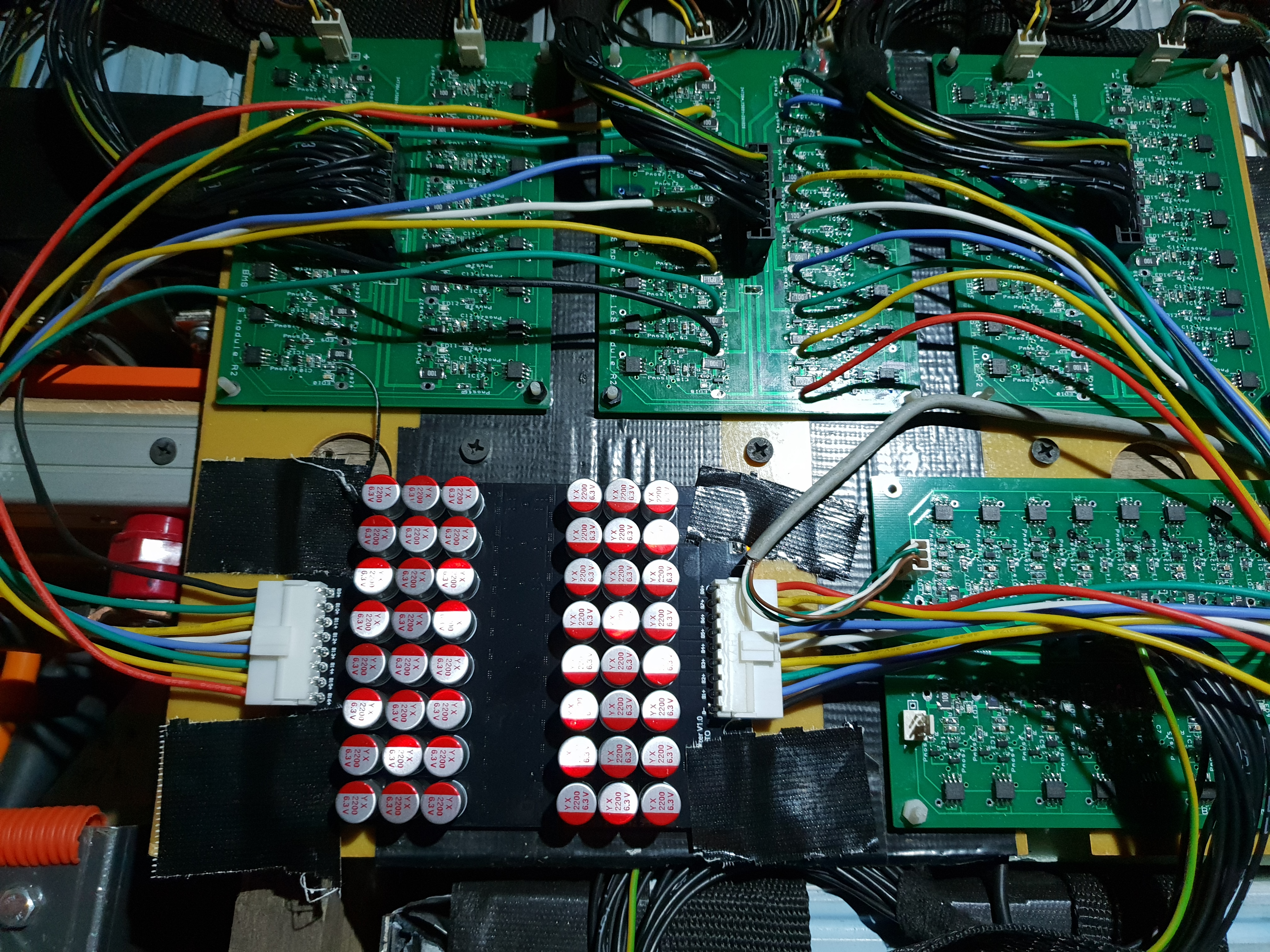

I put this one in my car on one of the more varying cell voltages
After the first test for several hours it seems that it takes charge from adjacent cells to top up the lower cells in 16S module. This slowly depletes the cells of voltage (in the range of 0.01V) but complete module voltage seemed to remain at 61.8V. Current involved that i registered was in the range of 0.8A to 1A. While i left balanser connected overnight it seemed to correct voltage on once cell from 3.85V to 4.01V and there was still 0.2A flowing. It seems this to be a real deal.
EDIT: I will run this in my car for a week and compare to adjacent modules.
It seems modules can be cascaded.

What do you think would happen if you have several of these overlapping?arber333 wrote: ↑Mon Aug 16, 2021 7:18 amI put this one in my car on one of the more varying cell voltages. I will inspect voltages after a few charges and drives.

I was thinking the same thing. putting 6 of these on a 96S pack could be interesting but of course would not balance between those 16 sets. overlapping could solve that. hmmmm
