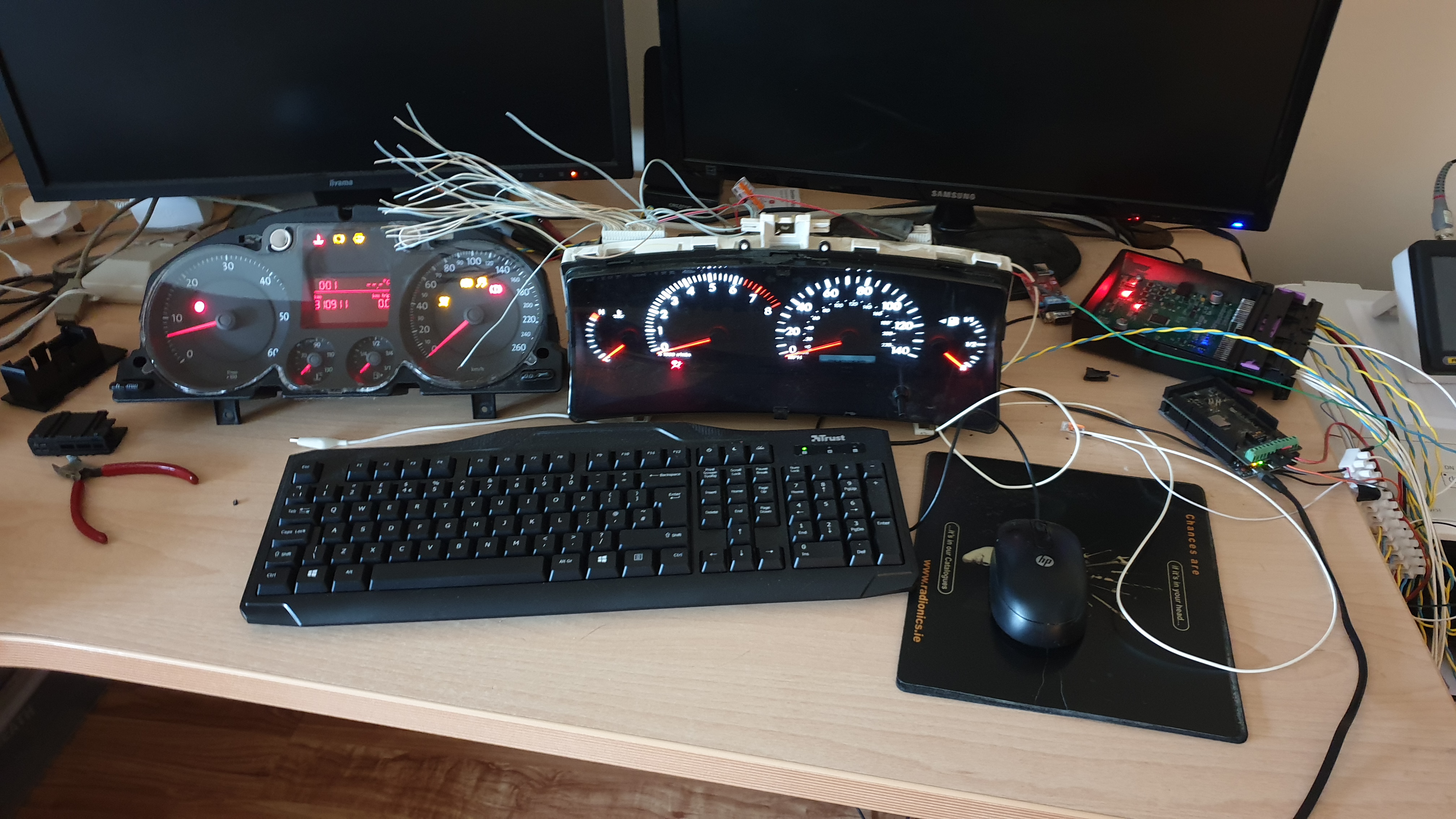

Zombie munching on some VAG and Toyota clusters.

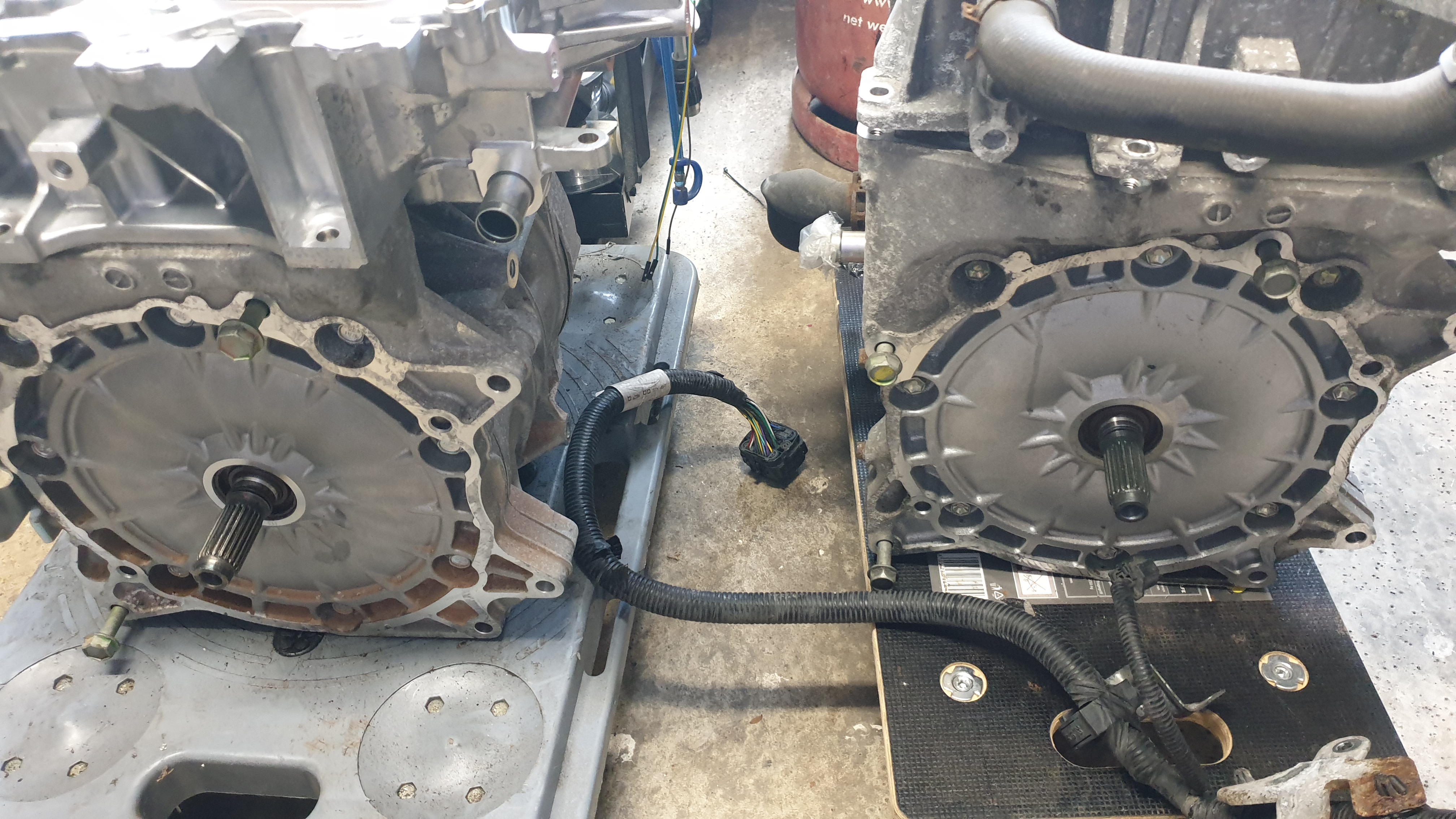

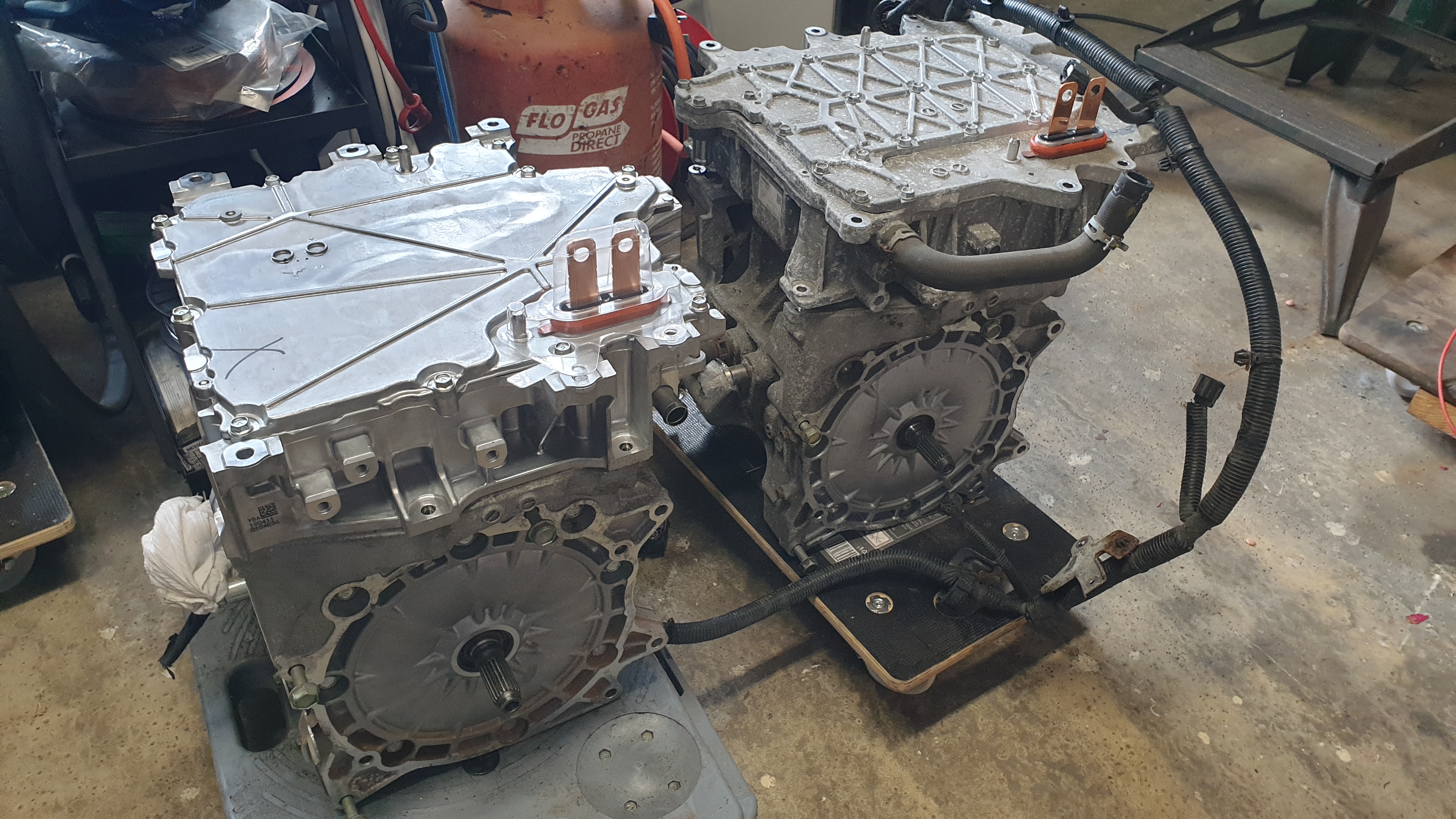

More Zombie food. Complete stack from a ENV200 Van and complete stack from a 2018 Gen 3 Leaf. Soon all you will have to do to run stuff like this is choose the right option from a menu. Whatever happens folks DO NOT contribute or help with this project. I get much more of an ego boost ripping off other people's work and passing it off as my own.

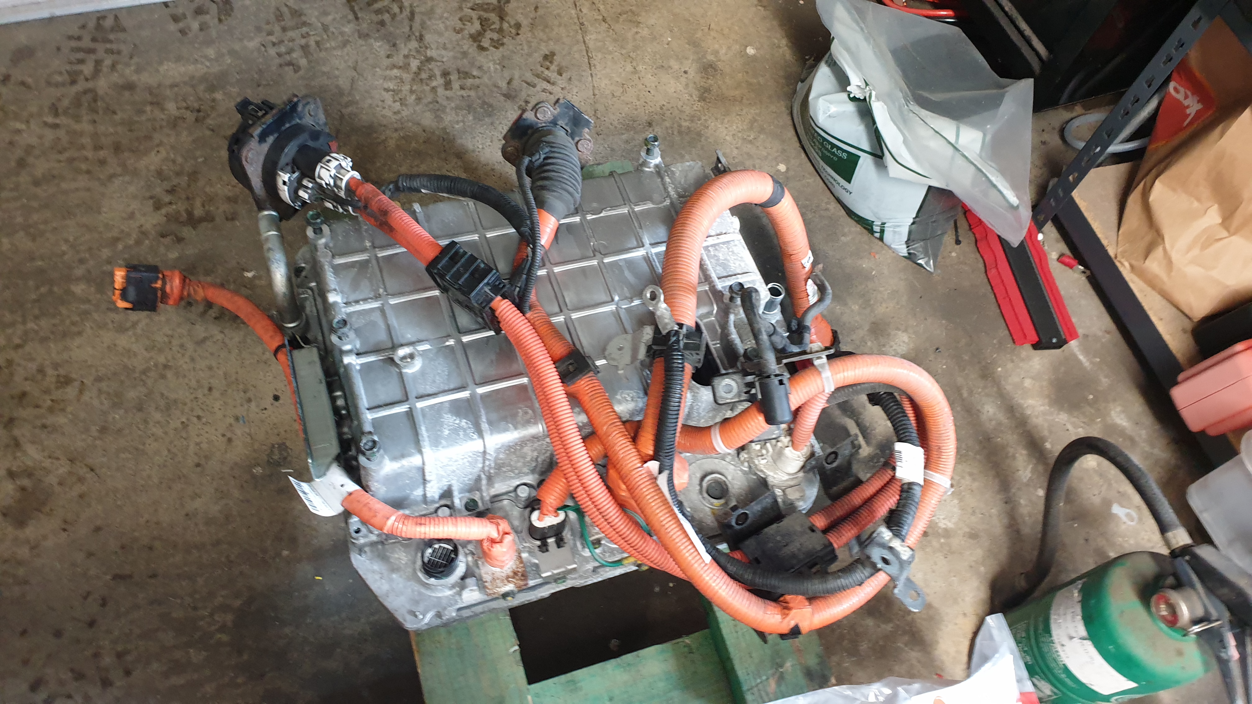

Posts: 4006
Been thanked: 1135 times

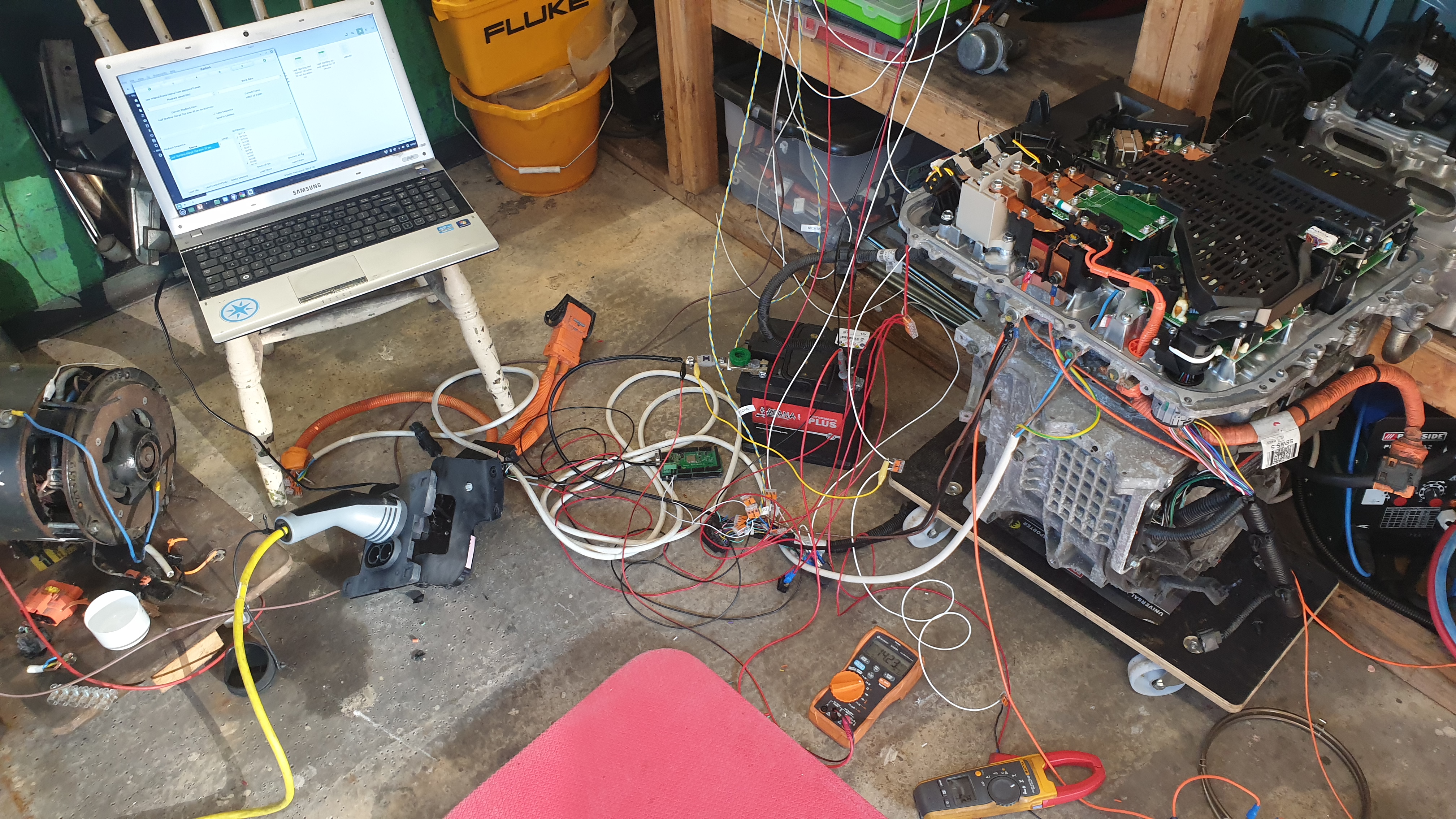

Leaf gen2 pdm now under Zombie control.
Been thanked: 1918 times
So now we can use the entire "power tower" without any disassembly, nice work! (Provided you find a car that can accommodate it)
