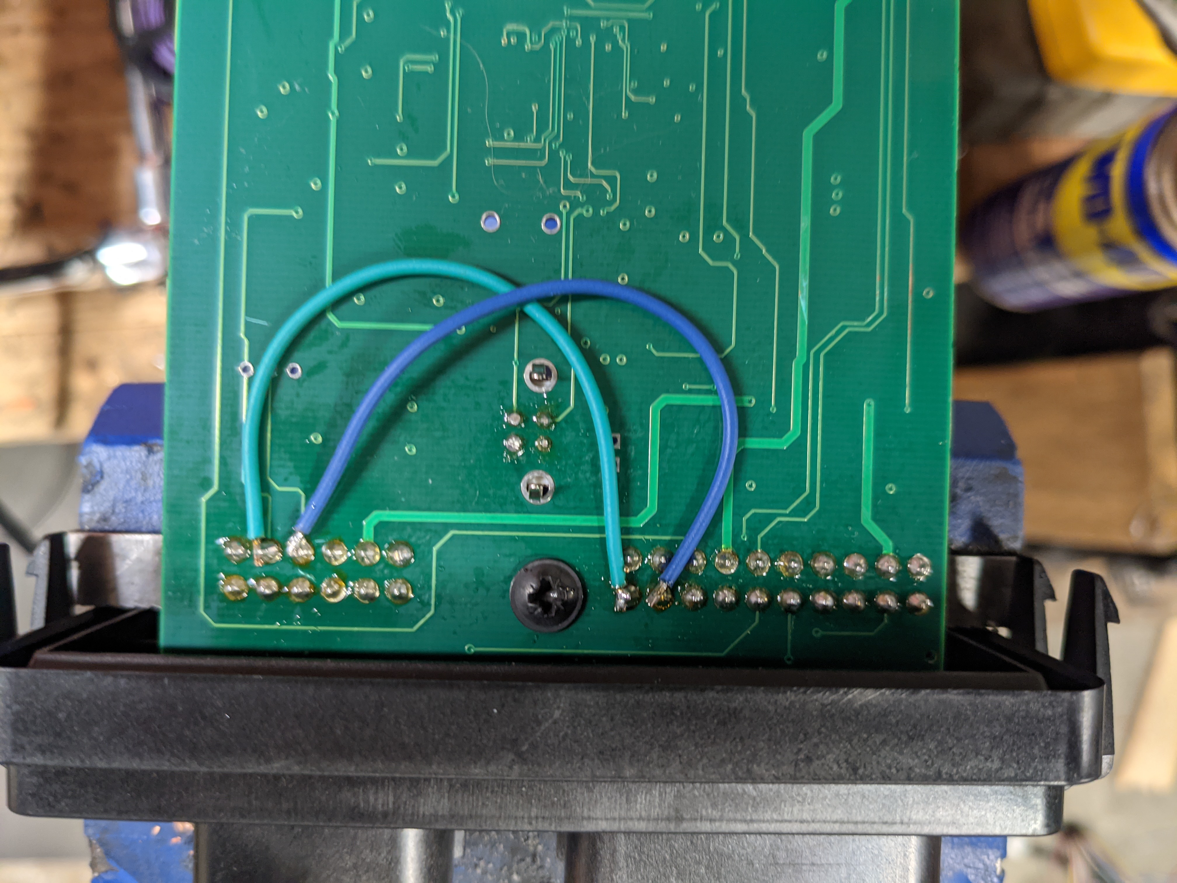

I just posted an update on my project thread: viewtopic.php?p=33241#p33241
and i decided to jump the Nissan Inverter CAN between the headers so i could connect in my ISA shunt that lives in my junction box. I'd be super welcoming of any feedback on this. From what i could gather im 98% sure these are on the same bus.
regarding the USB pins, I don't need these if i plan to just pull the pcb from the enclosure and connect directly, right?

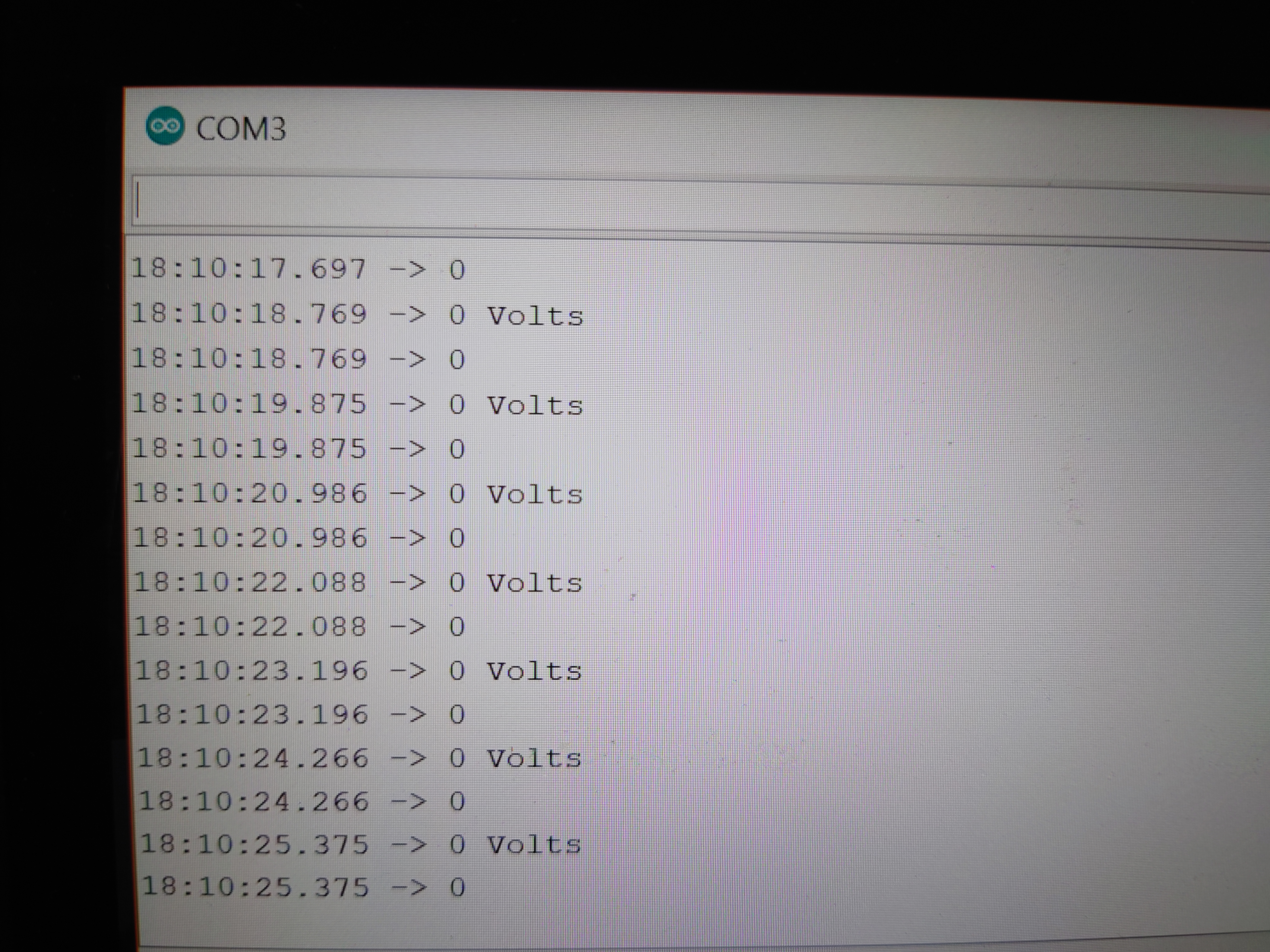

There is a problem with my VCU - inverter CAN.
And I don't know what it is. 😅
I have HV connected and precharge works, but I only get reading of 0 Volts on serial USB. Even If i disconnect the can connector, it shows that, so I think something is wrong with the Leaf CAN.
Any ideas? I have the original Leaf wiring that I just Hacked the CAN from VCU to its twisted pair green and blue wires.
Edit: Measured harness,
When connected to VCU, CAN H/L has resistance of 120ohms.
When not or only inverter connected, it doesn't have any resistance at all.
The Cables I just measured intact.
Inverter plug gets +12v on green and light green.
GND on black
And CAN on the twisted pair.
What is the purpose of these? Just doubles the CAN bus wires?
What am I missing?
I only have 170Volts now, but shouldn't it still give some error or something other than 0V measured?

It may not matter but shouldn't you have a 120R resistor at either end of the CAN cables? If so the resistance should be 60R not 120R
JaniK
Posts: 404
Has thanked: 101 times
Been thanked: 15 times
Re: Leaf Gen 1 Inverter Board
Post by JaniK »
Alibro wrote: Mon Oct 10, 2022 8:43 pm It may not matter but shouldn't you have a 120R resistor at either end of the CAN cables? If so the resistance should be 60R not 120R
I have the nissan original wiring harness and the 120r resistor is on the vcu board itself.
The original cable doesn't seem to have resistor on the inverter end and when plugged in, the inverter doesn't have one? Can someone confirm this?
I just added 2 modules for total of 197Volts and still nothing.
I will find a 120R resistor next. Lets see if it helps.

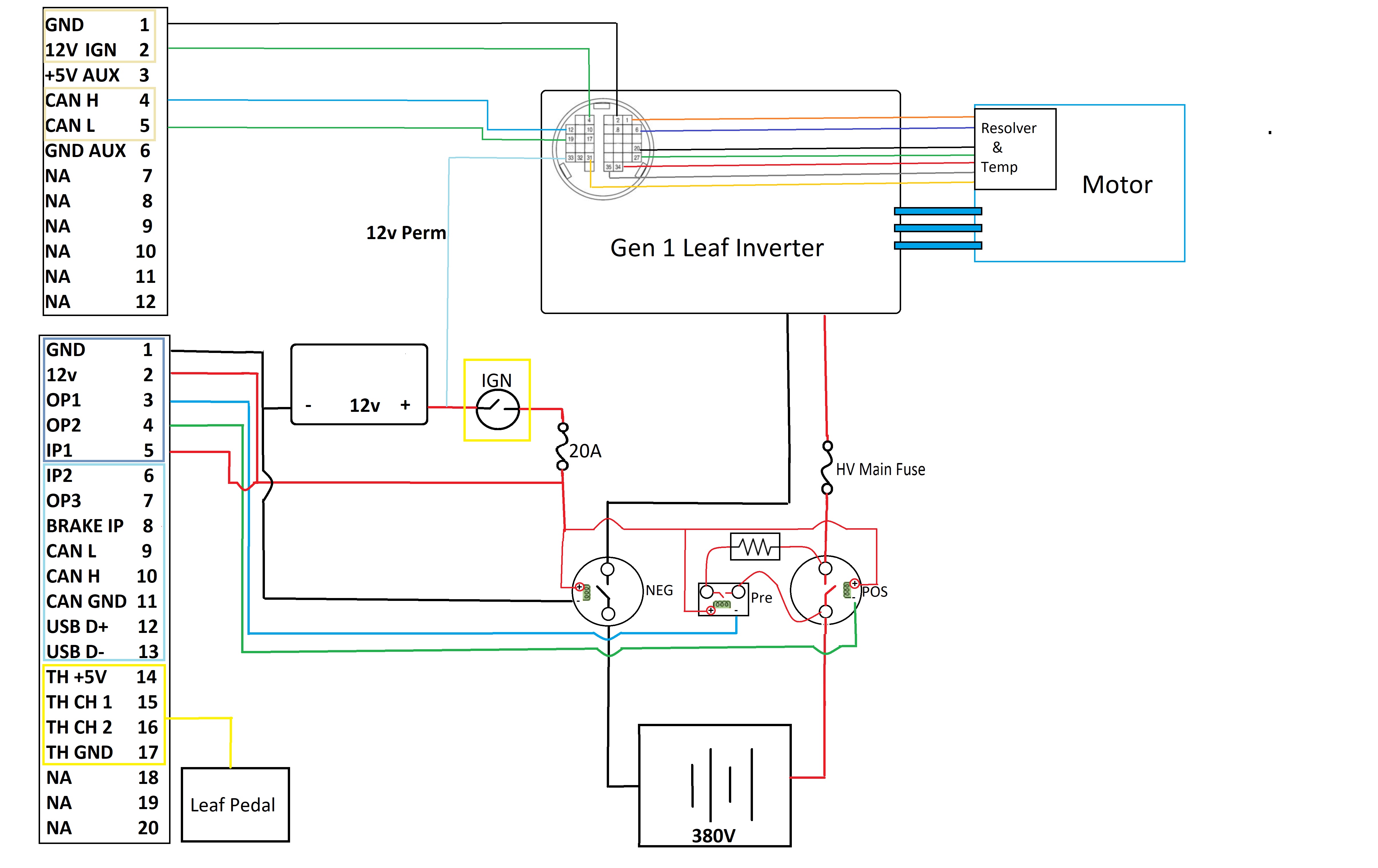

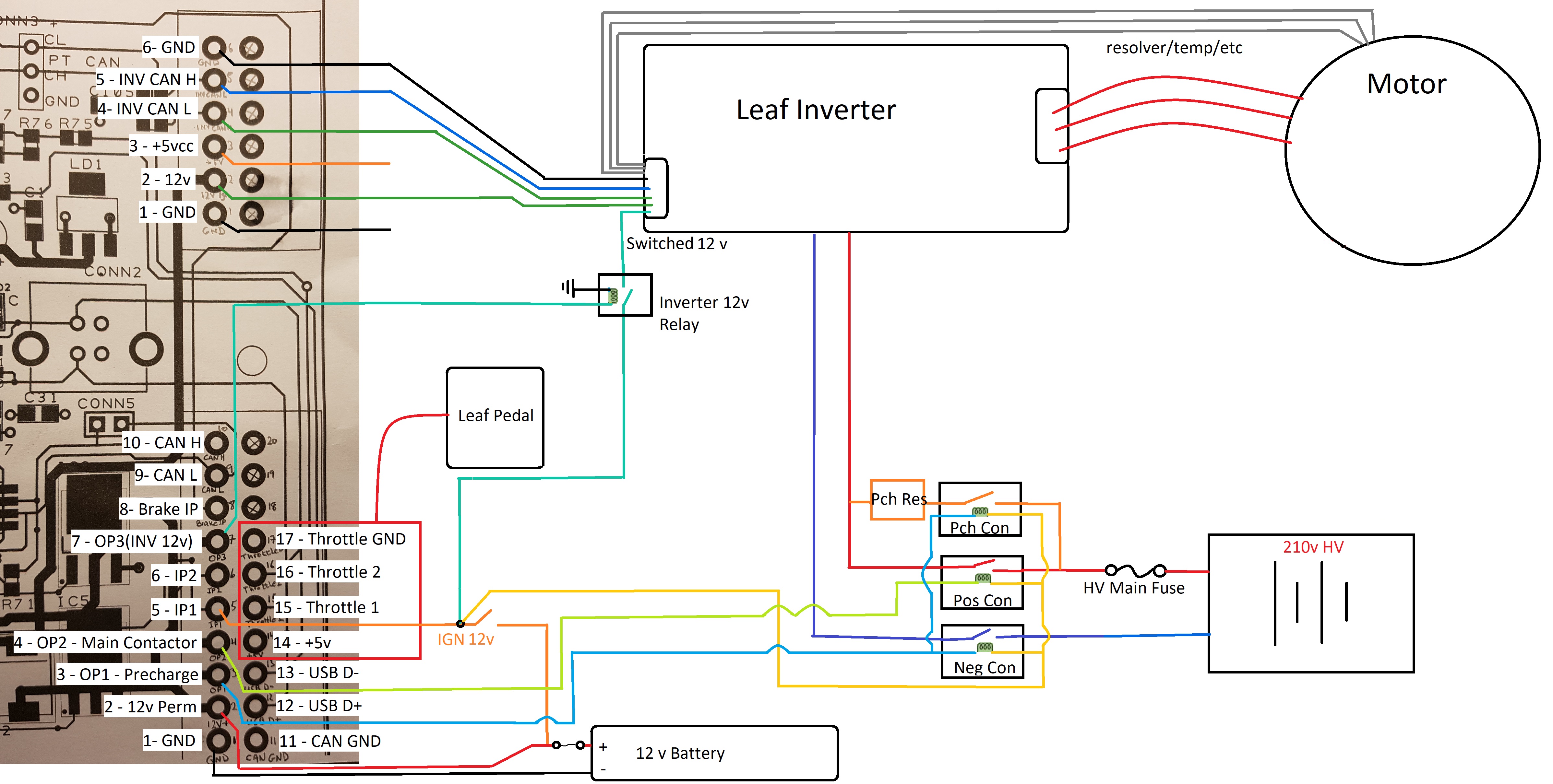

Reading 200V @ HV system, +12V from old ATX power supply.
I was looking for another 120R resistor, when I thought I'd read the thread once more..
- The problem I had was that I had printed out a drawing by cookie that has CAN H / L flipped and just connected my inverter like in this picture: NOTE download/file.php?id=3185&mode=view
- I also thank Fiachra for posting picture of the connector and a right CAN H/L schematic in this message where I saw the CAN bus colors flipped.
Cookie6000 wrote: Mon Aug 24, 2020 11:58 am Following on from resolving the issue with the VCU over a week ago. I had the system running perfect. I am stuck now however in a new problem that needs your help.
... VCU Schematic v1.3.jpg ....
download/file.php?id=4879&mode=view
download/file.php?id=4882&mode=view

JaniK wrote: Tue Oct 11, 2022 1:07 pm It spins !
