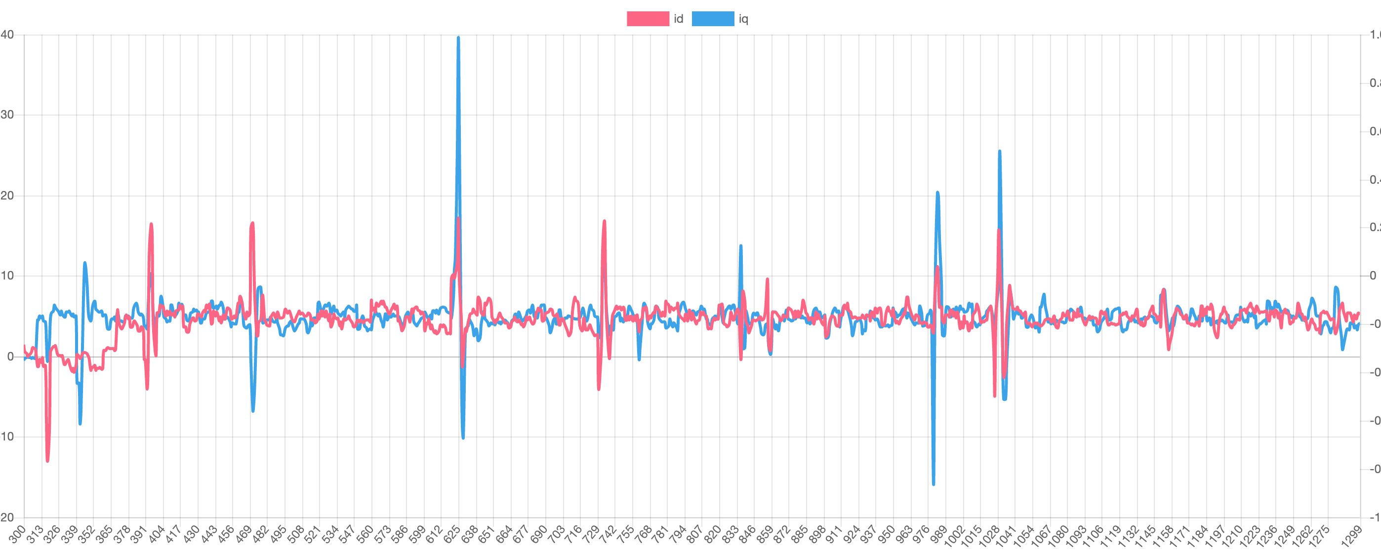

I've put the inverter in manual mode with the physical gearbox in neutral, plotted id and iq, set both to 5 amps. iq has a large spike to 40 amps. Is this a problem? I've got a lack of umph when it comes to steep hills that I'm trying to tweak away if possible with this motor.

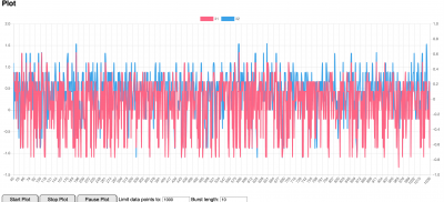

So further testing in manual mode, 0 manual id and manual iq
il1 and il2 seem very noisy. It's a gen 3 prius inverter with a board from Damien btw.

Crap in, crap out. Do you get the same noise with sensors unplugged? Gotta be some hardware issues. Scoping ahead. Both power supplies (26V and -5V) and the actual output of the sensors.

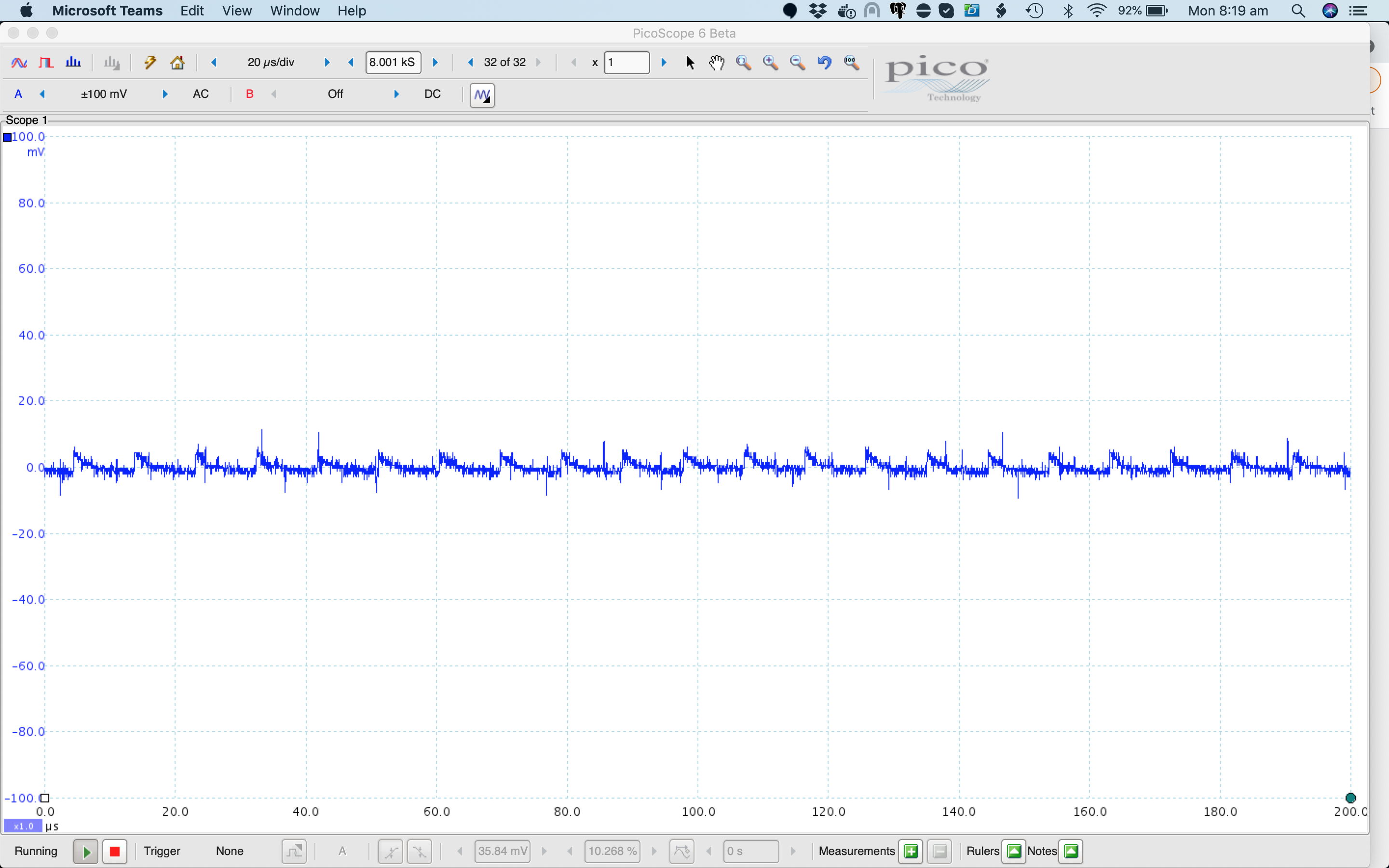

Here's IL1
IL2
3.3v
3.3 measured as AC

Ooooh, 3V3 is totally out of shape. I assume any other analog inputs look similar. Does it improve if you remove the Wifi? There was a problem with 3V3 reg on some earlier Prius boards, not sure which one you have. They needed swapping in a stronger regulator and an LC filter for the Wifi.
bexander
Posts: 867
Location: Gothenburg, Sweden
Has thanked: 71 times
Been thanked: 97 times
Re: FOC manual mode, large iq spikes
Post by bexander »
Also the CAN transceiver might create disturbances on the 3V3. Looks like close to 10us pulse repetition. Might be CAN if nothing else is connected on the CAN bus. The transceiver get no response and tries to resend repeatedly.
When doing the 3V3 measurement, try using trigger auto to get a more steady state plot. You are using single trigger in posted plot. Decrease trigger level if needed to trigger in auto.

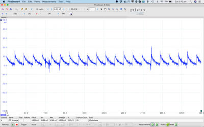

It does seem to improve when the wifi is unplugged. Wifi powered with an external 3.3v.
Looks like that's the issue, thanks :D

Alright! That looks like the usual jitter now.
