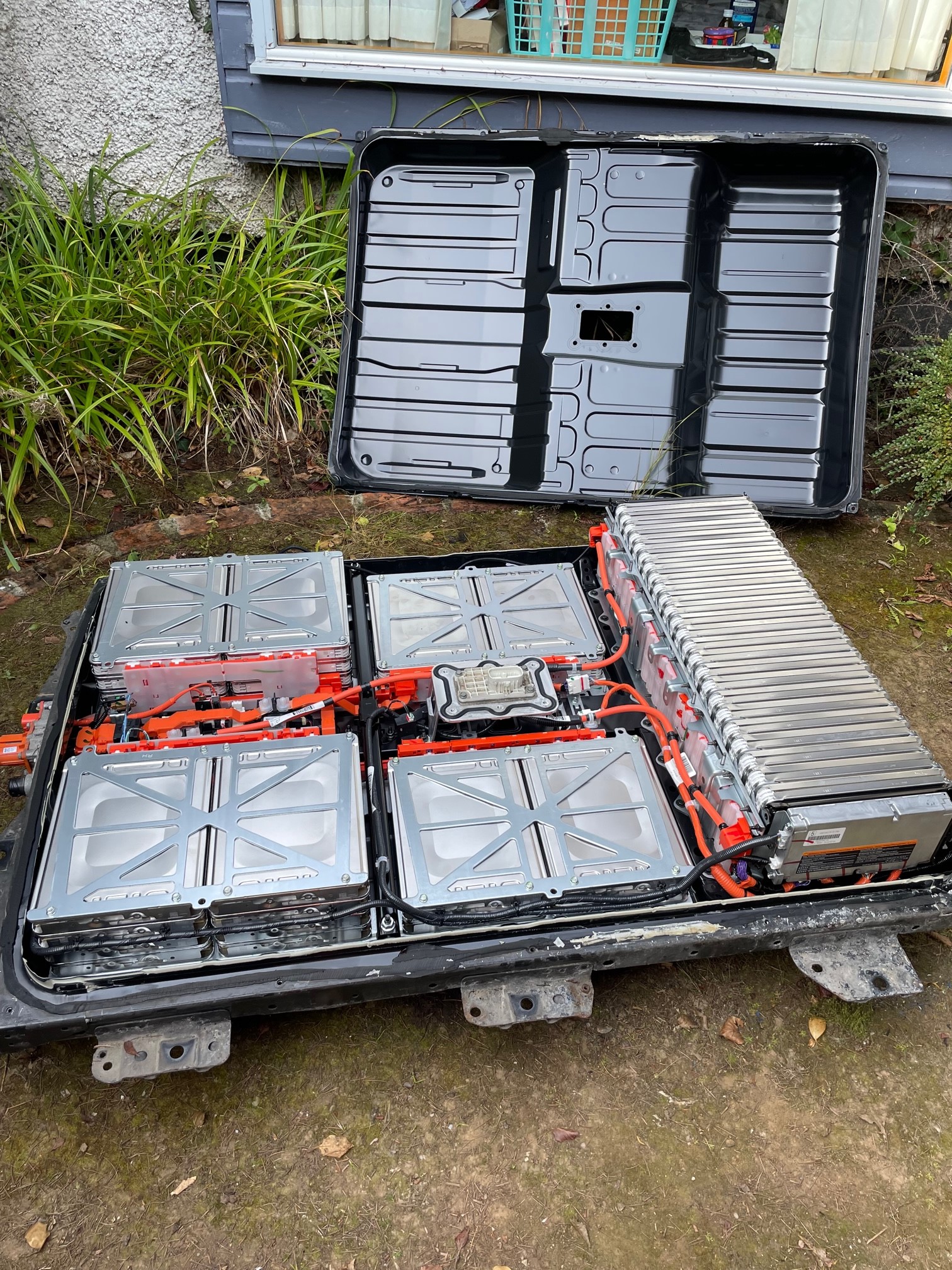

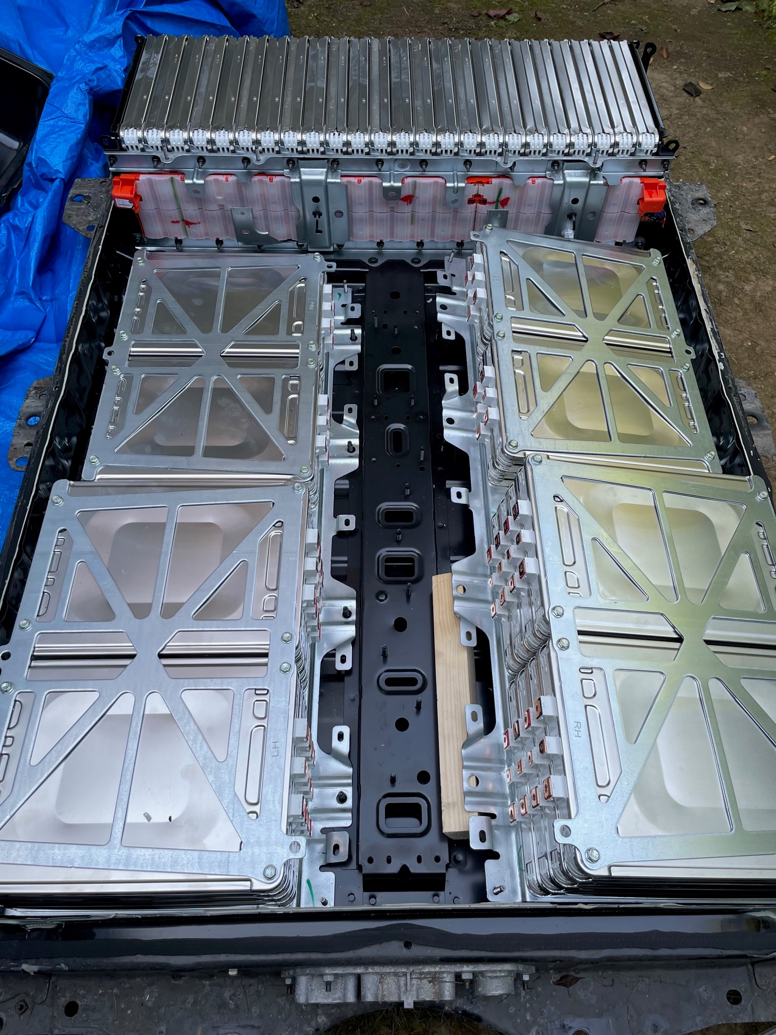

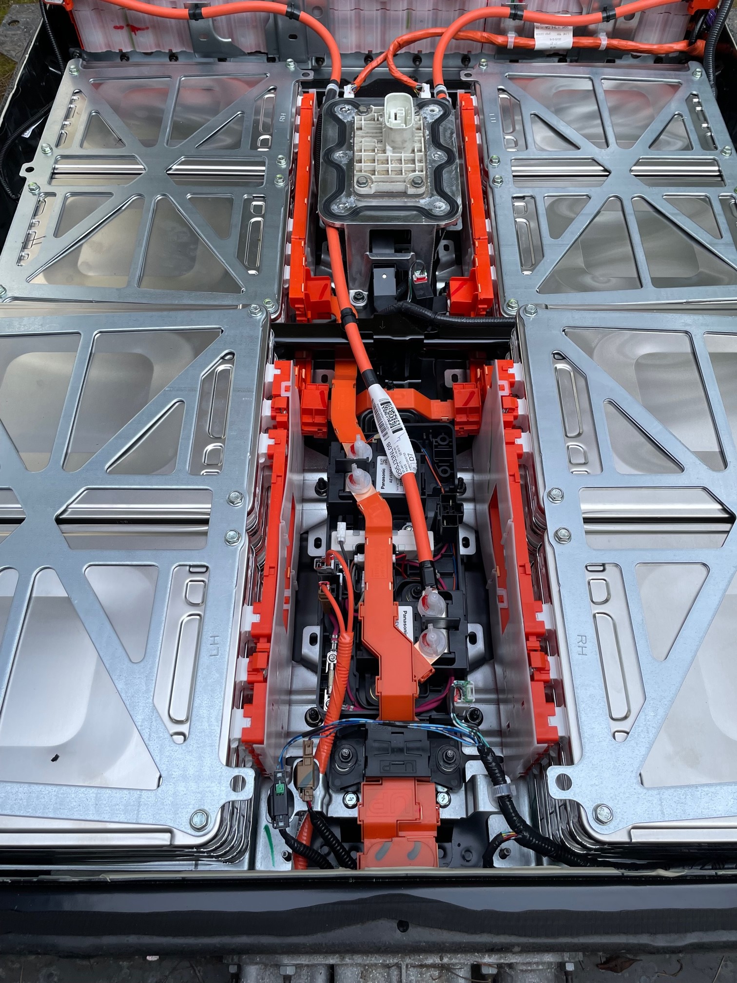

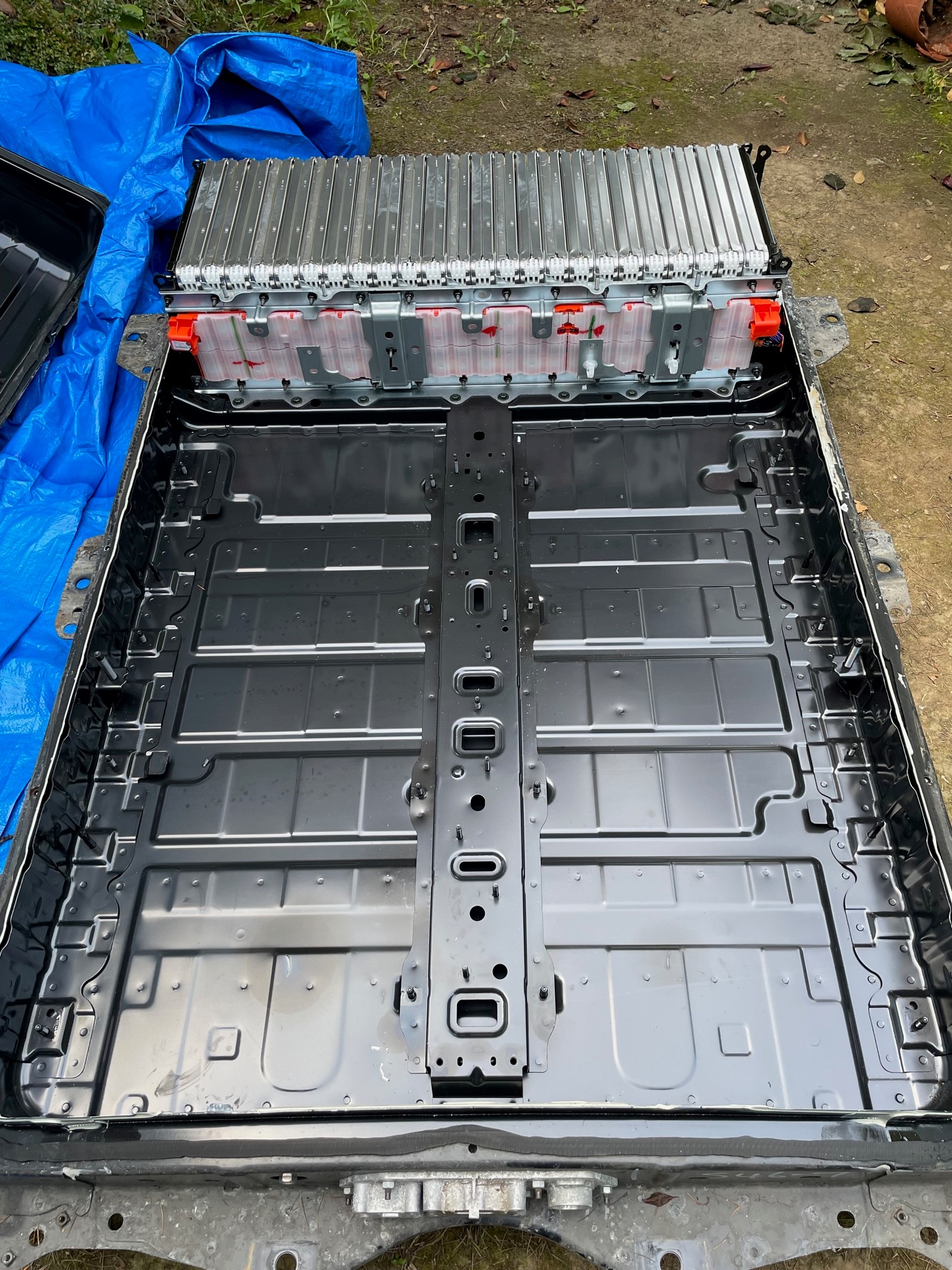

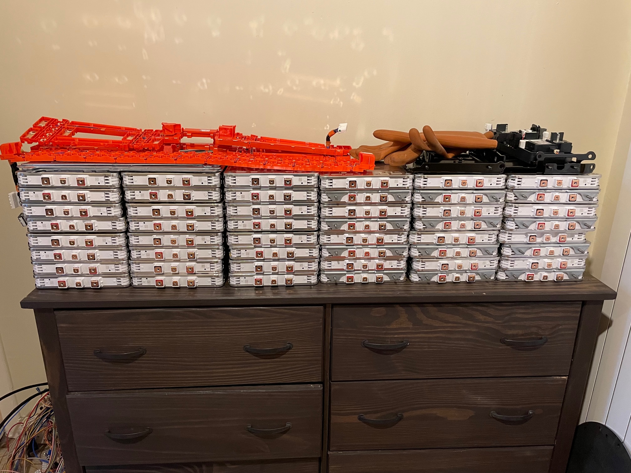

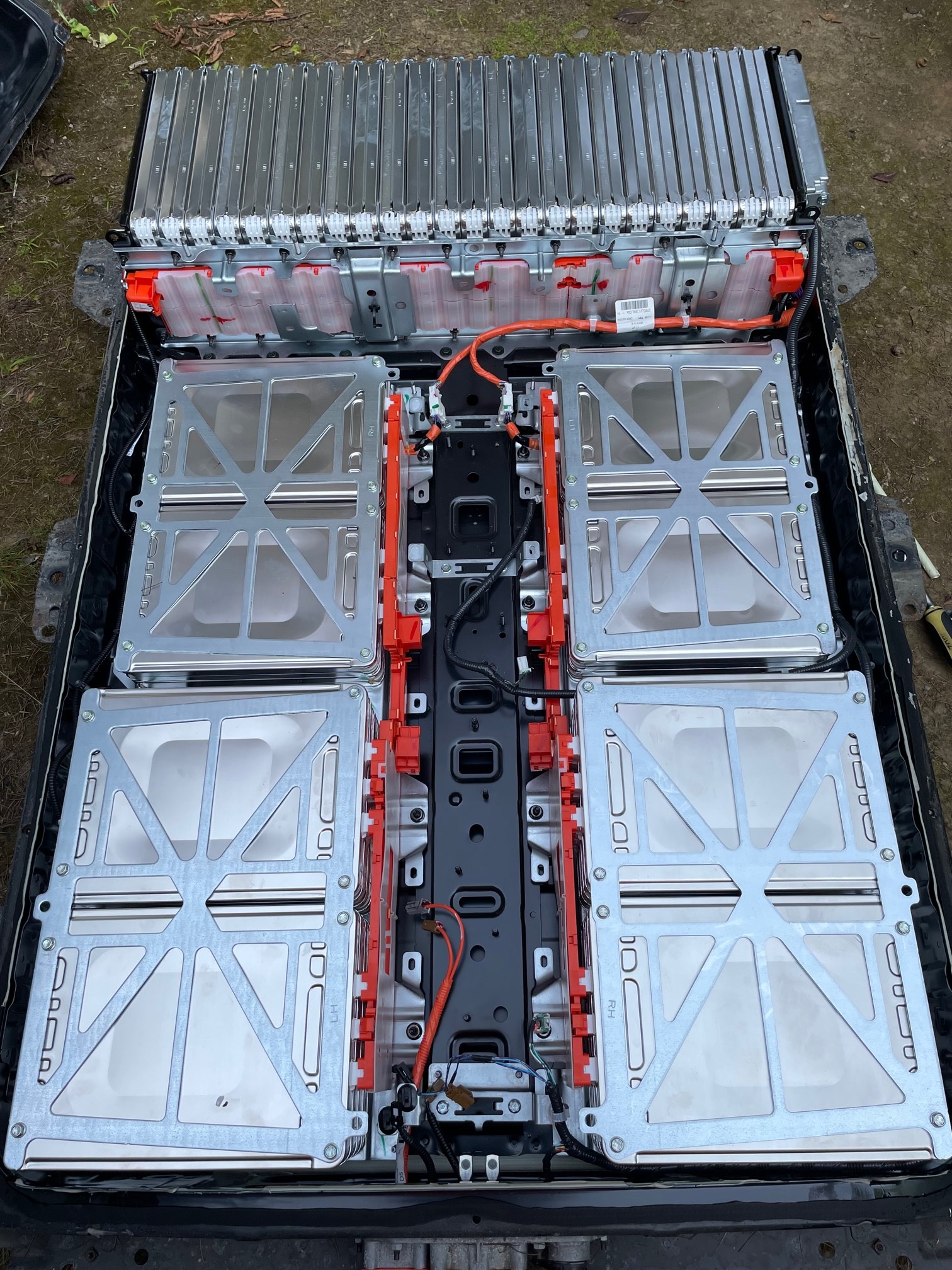

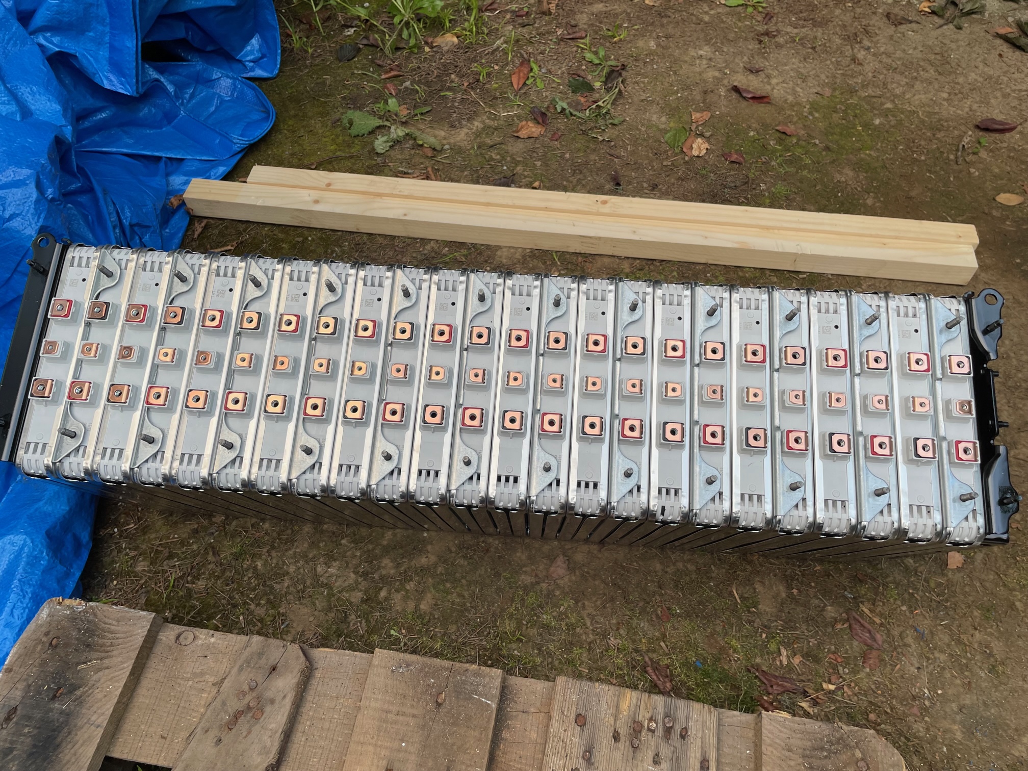

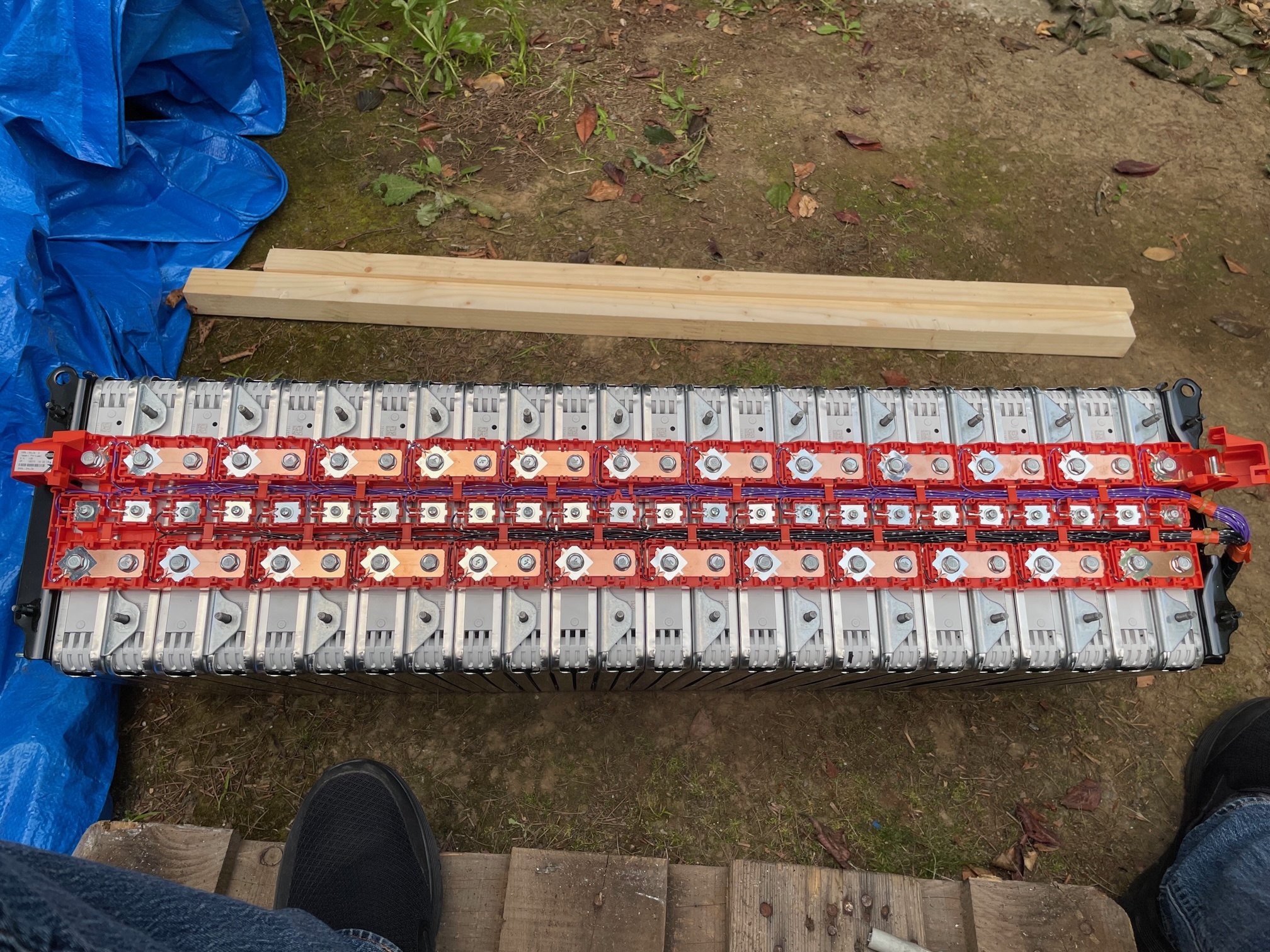

Battery disassembled. More work than you think it will be!

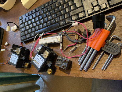

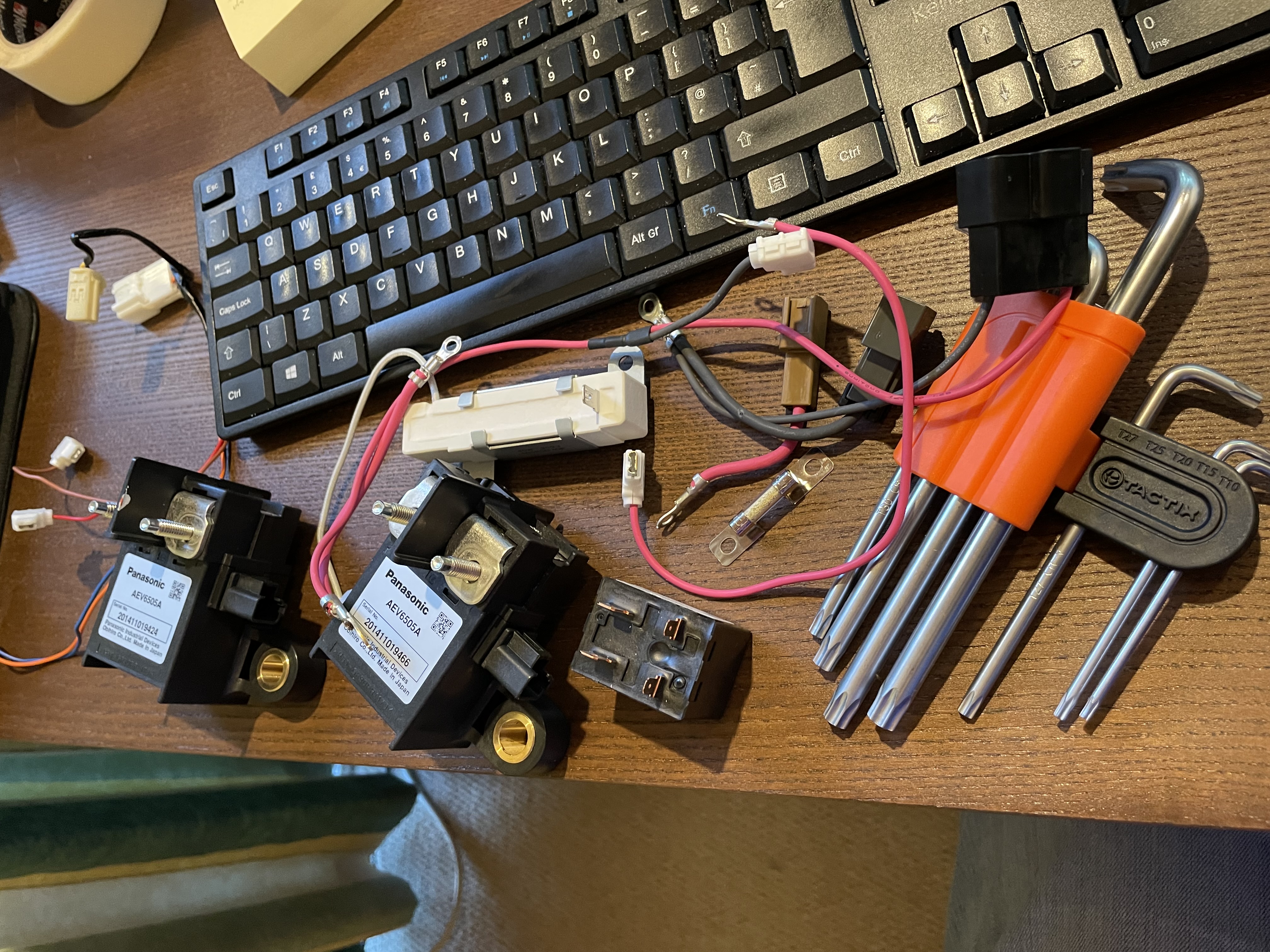

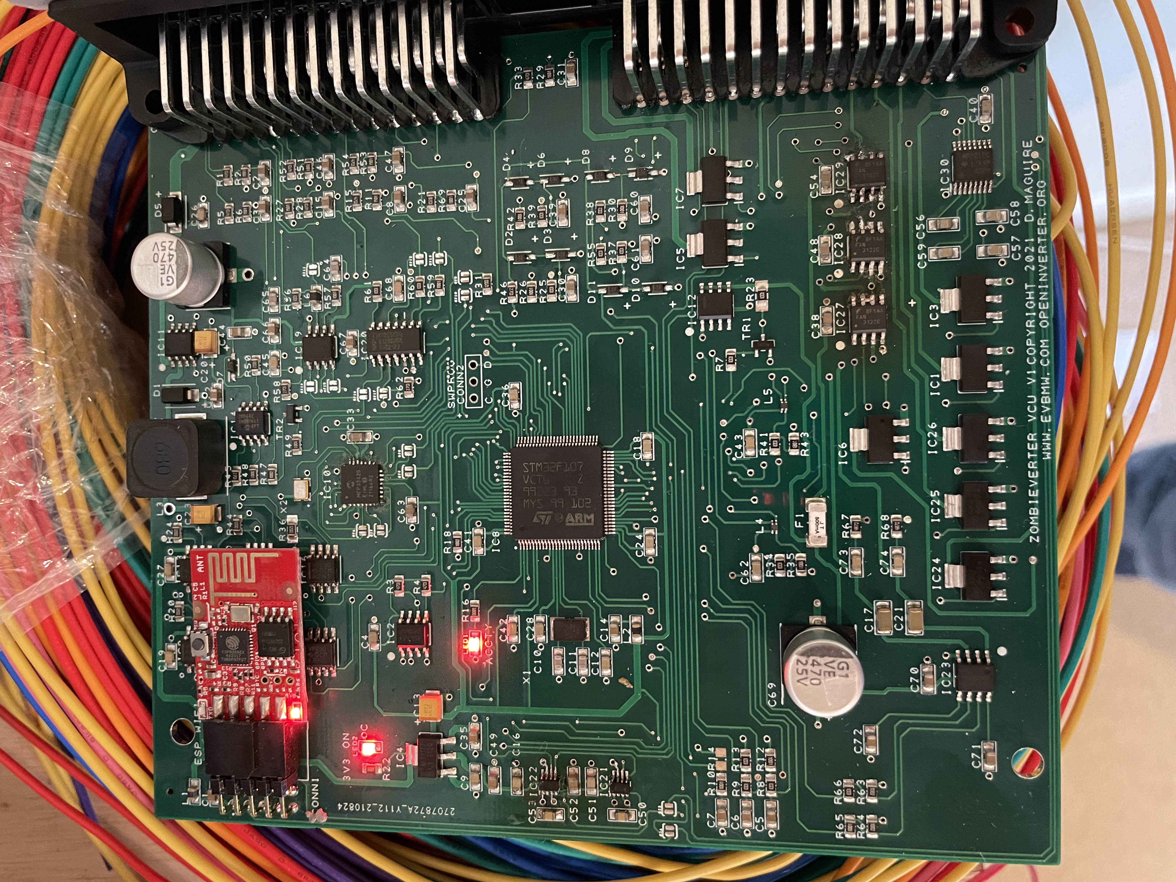

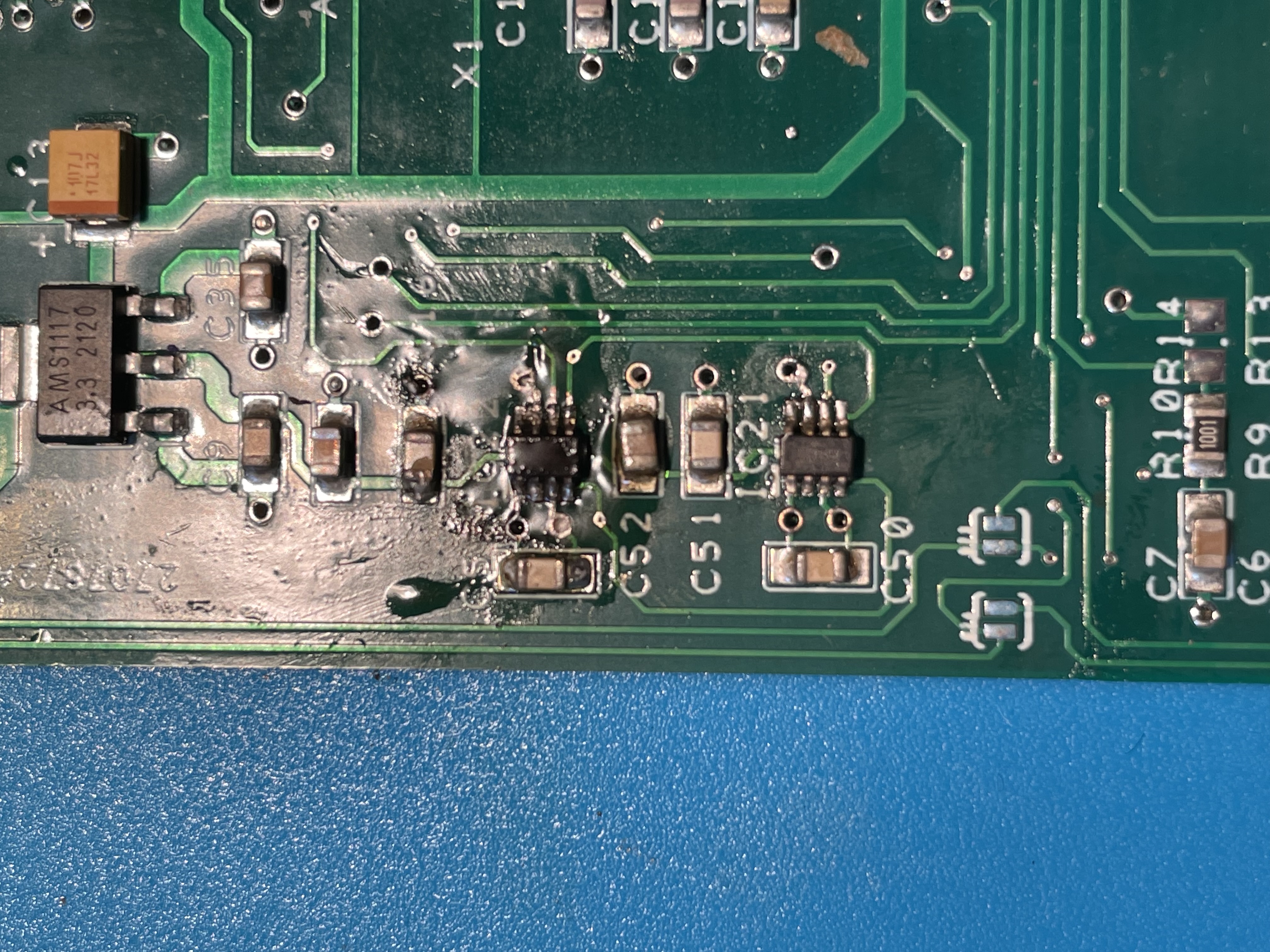

So a little progress, but not much. Had @paaa over to trade a battery box for some soldering skills and we got both of our ZombieVerters finished. Had some trouble with IC21 & IC22 but got them in the end.
Got the VCU powered up with basic 12V and connected to it fine but no other connections wired up yet.
Got the Leaf pre-charge circuit disassembled. Question: can any of this be re-used? It seems these contactors need flyback diodes and PWM so I'm guessing it's easier to just get standard contactors like the Kilovac or Gigavac ones. Any recommended guide on building a junction box would be appreciated as that's my next task. Hoping to re-use some of these parts such as the 30 Ohm pre-charge resistor and the pre-charge contactor. Have to buy a shunt too.

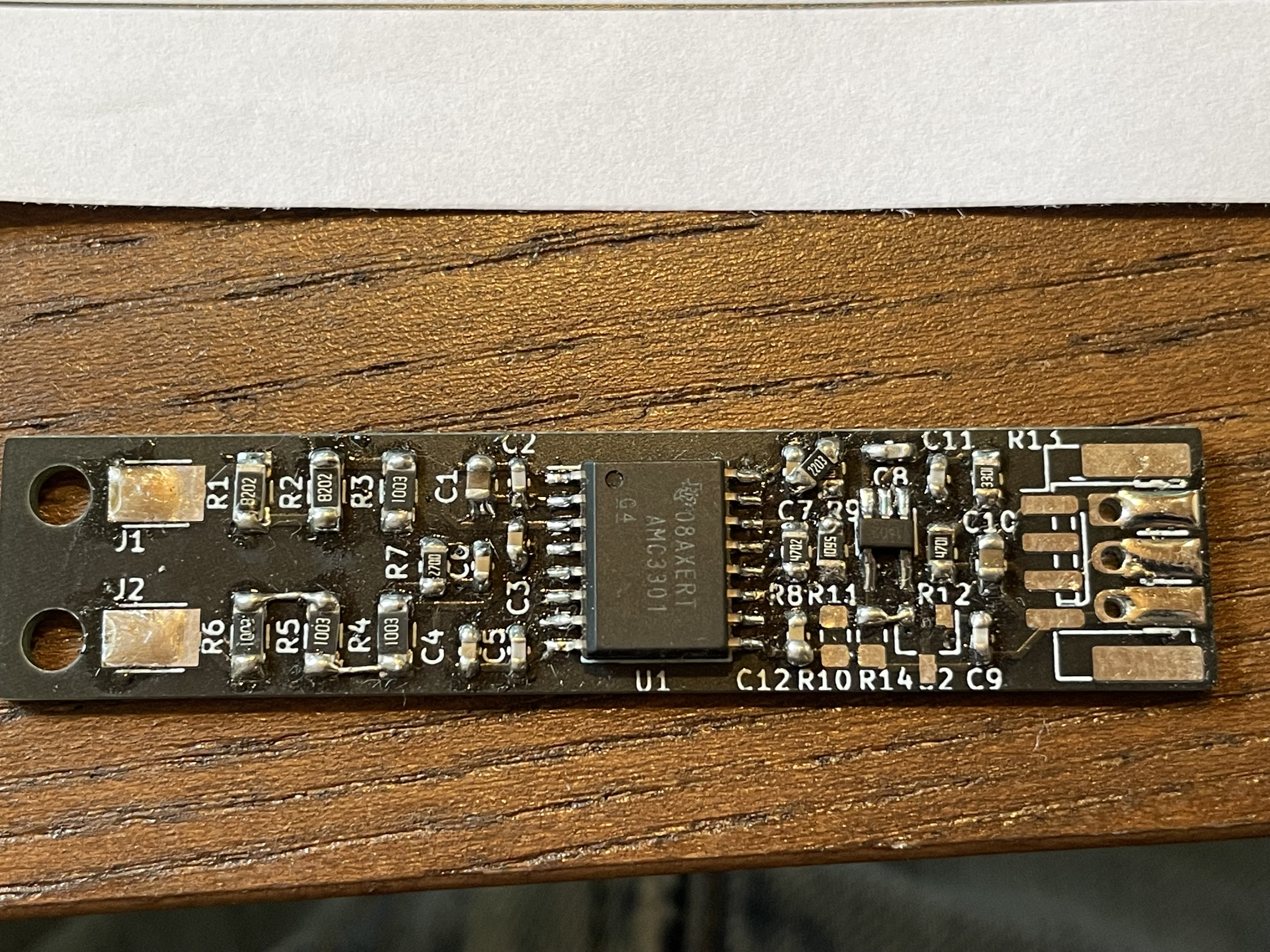

Also got the CCS Voltage Sense board from @muehlpower. Waiting on the LIM connections from auto-click.co.uk; they got sent back by An Post so hopefully second time lucky.
Got a lot of wiring in my near future!

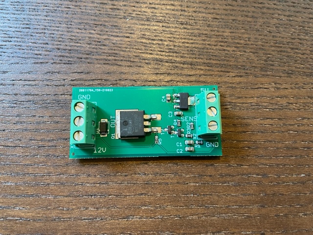

Also got the vacuum pump controller from the web store.

kevpatts wrote: Tue Sep 21, 2021 6:16 pm Battery disassembled. More work than you think it will be!
that looks Wife Approved, love it!

kevpatts wrote: Tue Oct 12, 2021 9:56 am So a little progress, but not much. Had @paaa over to trade a battery box for some soldering skills and we got both of our ZombieVerters finished. Had some trouble with IC21 & IC22 but got them in the end.
Edit: Also waiting for a CCS port from a Kia E-Niro or Hyundai Kona from Calvin in EVBreakers. Looks like I may need to pull a resistor out of it after Damiens latest video. I'll check it when it arrives. Also a granny cable on the way for Type 2 port.
Loving all the detail, and along for the ride to see how the Zombie fares?

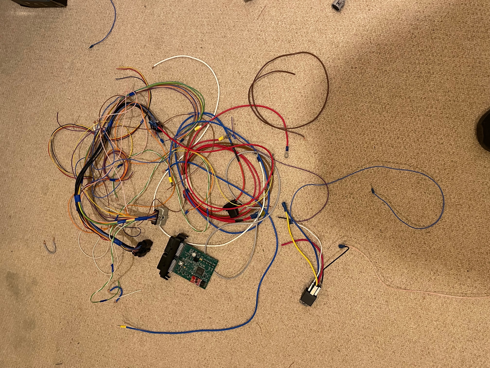

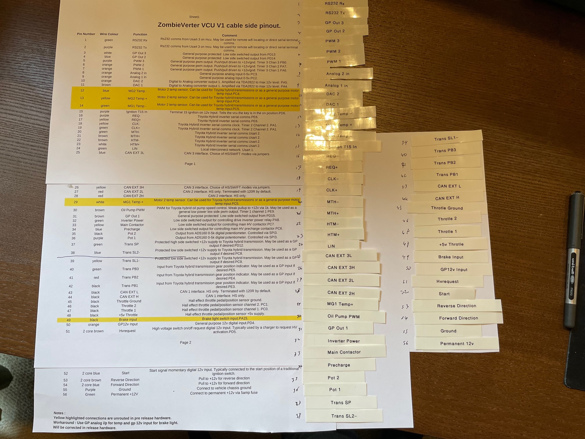

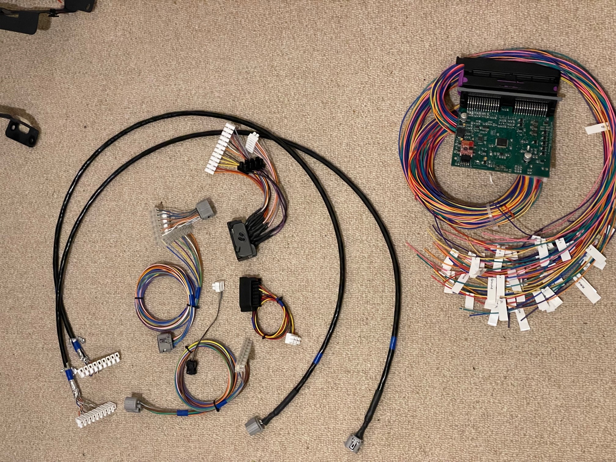

Moving very slowly recently. Finally got round to butchering the old loom
that was made for the GS450h dedicated VCU and tidied up the connections and labelled the ZombieVerter cables. Pain in the ass work but only took a few hours.
Also got the pre-charge circuit mocked up and working.
Received a Kia CCS port and connections for the LIM en-route as well as CCS contactors. Thinking of leaving the CCS part until a phase 2 (or 5 or 10 depending on how many phases there will be before it's on the road!) though. I'll only need slow charge initially but at least I have all the parts.
Hopefully I'll have it spinning off the bench source this weekend and then think about running a HV source and start wiring the charger too. Reminds me: need to get a granny cable for testing.

kevpatts wrote: Tue Oct 12, 2021 9:56 am Got the Leaf pre-charge circuit disassembled. Question: can any of this be re-used? It seems these contactors need flyback diodes and PWM so I'm guessing it's easier to just get standard contactors like the Kilovac or Gigavac ones. Any recommended guide on building a junction box would be appreciated as that's my next task. Hoping to re-use some of these parts such as the 30 Ohm pre-charge resistor and the pre-charge contactor. Have to buy a shunt too.
a few folks are using the leaf contactors in conversions, not sure what the contactor control on the zombie is rated for, but the fets on the oi main board can drive them as is from my understanding.
The contactor assembly is quite a nice unit when not disassembled. Pre charge already wired up!
