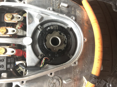

Hi Guys, anyone own an i3? I think with a little info on the wiring I can help out. I am using an i3 motor and controller for a project and need to know the following to understand how to hack the system. I think I have the easiest way to do it, but need to confirm:
1. Which ECU module does the PNDR stalk plug into, or does it plug directly into the controller?
2. Which ECU module does the accelerator cable plug into, or does it plug directly into the controller?
3. If anyone has schematics that would be a great plus.
4. PiD codes also a plus, but hopefully I can do it without changing the programming.
Here's hoping someone out the has got the info! :)

I have an i3 but I don't think that'll help, I don't want to tear down the car and track where each wire is going to :) I think it's better to try to find the wiring diagram.

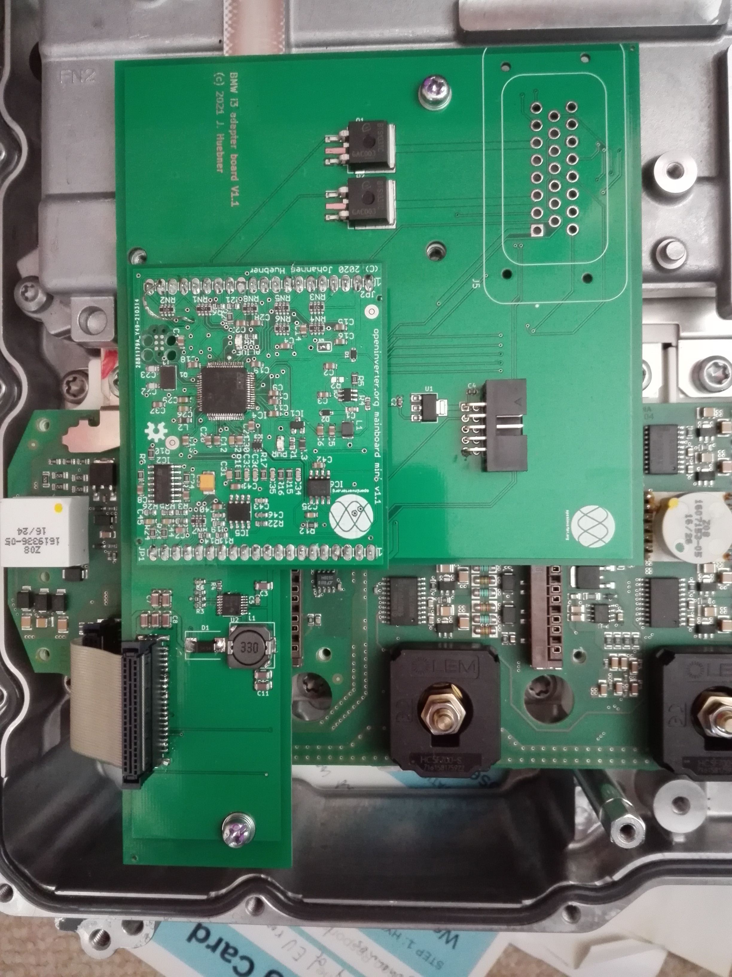

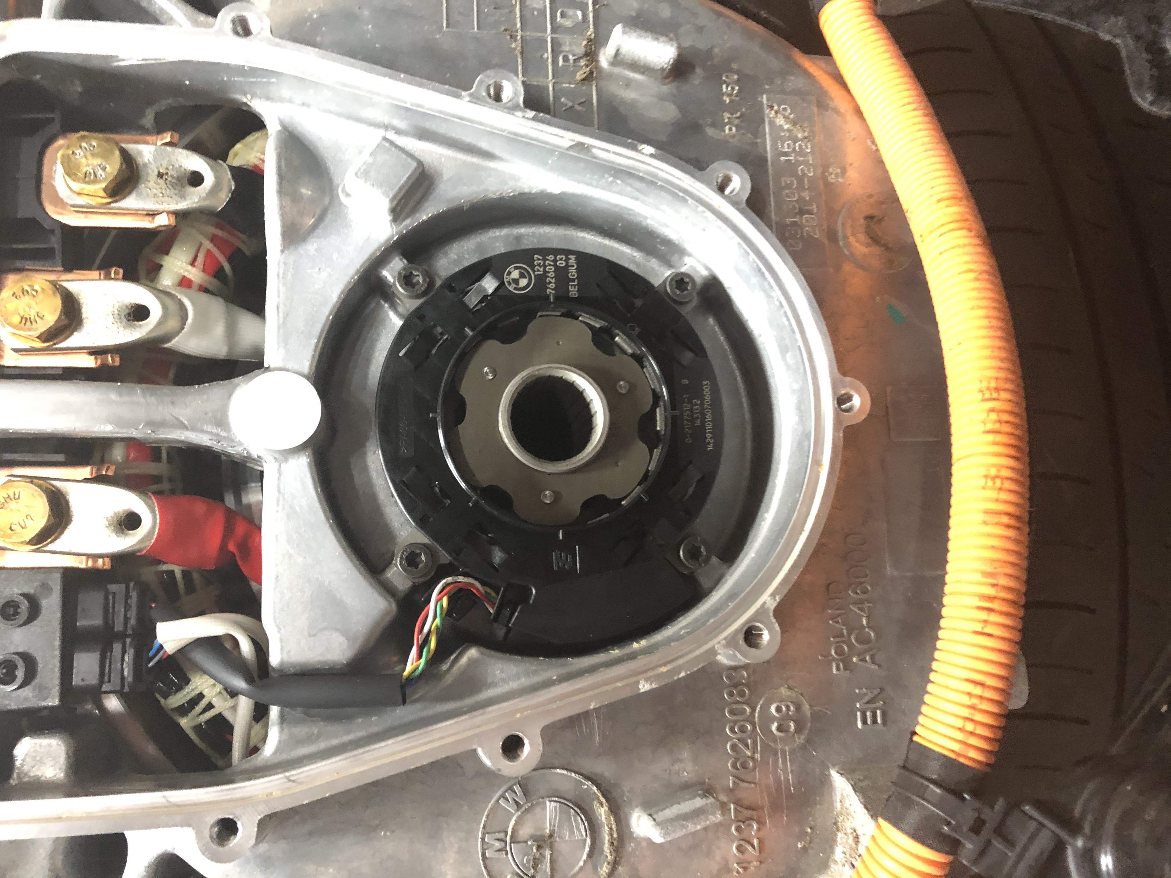

Picked up work on the i3 again after Heikki sent me some brilliant pictures about what does and doesn't fit.
I am also taking care of the 32V boost regulator and the fix is pretty easy: lower switching frequency from 1.2 MHz to 450 kHz and use a larger inductor. That fixed the problem with the weird looking waveform and also the wifi module is no longer disturbed. As an extra challenge the TPS61175 has gone out of stock at JLCPCB....

Got some boards while I was away, one of them being the i3 adapter. Many improvements but still one issue
  • 32V boost converter now works without overheating
  • USART comms not disturbed when running
  • SPI_CLK and SPI_MOSI now have a nice 5V swing
  • All holes match
  • Hopefully no more collisions with the enclosure
  • I botched the TTL drivers. Pulled !OE high instead of low
  • SPI_CS needs to go via a driver as well, for now I just bridged the 470R output resistor
Another issue is the TPS61175 still being out of stock but I did successfully reflow it in my pizza oven with only minor alignment issues. I might put a small batch up on the shop. I might also swap over to the right angled Erni connector (connection to the gate driver) because that can also be reflowed by hand.

Hello all, I have been a long time admirer of the openinverter projects, and personally jumped in the deep end with an i3 about 1 year ago. Originally I thought that Damien stopping work the project had left my hopes of "open" control in the hands of an off the shelf inverter, but I discovered progress here a couple of months ago.
To summarise, I have had the i3 motor spinning with an off-the-shelf inverter and done a small amount of characterisation work using Jim Hendershot's reverse engineering (like in the video posted above). The i3 motor's requires quite a high amount of Id current to be able to reach peak power, around 70degrees advance angle is ideal, if Jim's modelling is correct. I know that spinning a motor is a little way off, but I believe sharing all this info I've accumulated may help to get things moving a little quicker once we get to that point. I am very motivated to help progress the i3 controller hacking in any way, so please let me know Johannes if you would be interested in having a V2 board down under (Australia) for testing in parallel.
A summary of the values that I would suggest using to start:
  • Lq = 240uH (1.72 ohm resistance)
  • Ld = 85uH (0.81 ohm ? Not sure, hard to make out in Jim's slides)
  • Peak RPM = 11400 (~500V back EMF at this RPM!)
  • 6 pole *edit* pairs
  • 240Arms peak current (until we starting pushing it, of course...)
Some risks I maybe see however is that Jim makes a point of saying that at maximum RPM, with the 6 poles, the commutation frequency is around 1200Hz, and that the inverter switching frequency should be approaching 20kHz at this point. I would actually tend to agree with him, as the rotor inductance is fairly low and therefore the current ripple could be fairly interesting. I would like to know what everyone's thoughts are on this. Johannes: I think your point regarding this super short deadtime would be that the BMW engineers have optimised the gate driver to achieve maximum on-time at these required high switching frequencies.
Okay, I think that's enough of a brain dump for now for a forum newbie!

That's some valuable info. I'm currently in the mechanical design process, the volume where the board resides is rather awkward and I needed two revisions so far just to kind fo get that right.
20 kHz sounds pretty high for an 800A IGBT stage, maybe somebody can find out what BMW runs. The inductances are indeed quite low, I think the Prius motor was 4 times that. Uuuh.

In the video a little higher up states (7.00) it is a twelve pole motor and I am pretty sure that encoders use the same pole number. I have used it for my Unitch inverter and it "worked" even if I have not driven the car yet, only spun the engine.

Sorry, my mistake I meant 6 pole pairs. I’ve corrected that now. Does the ultra-high frequency when compared with the leaf motor make a bit more sense now?
The resolver is 6 poles total, but to be honest I’m not sure if resolvers have “pole pairs” like motors do because they’re just a sensor.

I have made most corrections except moving the control board down another 1 mm so it doesn't collide with a screw post.
