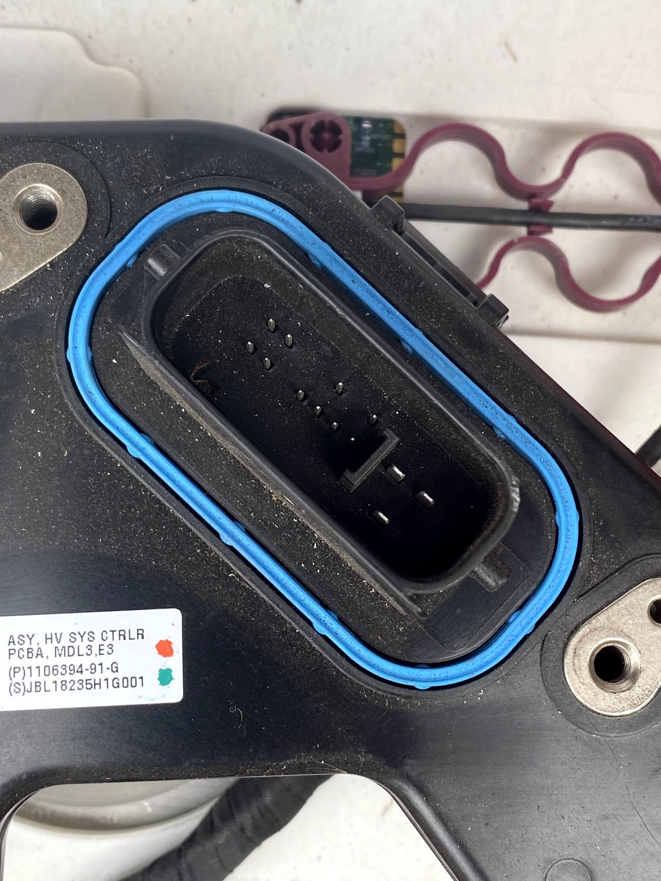

Re: Tesla Model 3 Battery Hacking
Hello Moin
has any of you ever read a battery from the 2019 model y with the batman chip? I have a Batman chip on a model 3 25s 160Ah battery element.
I have an offer for a 75kwh battery for 9,000 € with ~ 6,000km. that would be 120 € / kWh.
the question is whether you can read the Model Y battery with it.
Data I have are:
1493127-00-D
ASY, HVBAT E3, AWD
400VDC 1PH, M3
SN: TG120194002RYK
Made in USA
The M3 makes me wonder "Model 3"?
Best regards, Liebe Grüße
Alex
Hello there, this wont answer all your questions but here are some info from my battery, tesla model 3 2018 eu 3 phase.tollerteppich wrote: ↑Thu Sep 09, 2021 9:09 am Hello Moin
