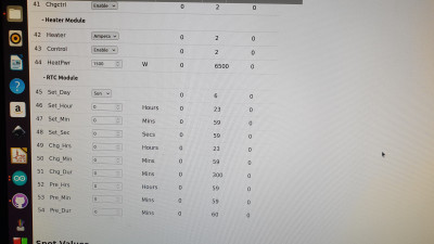

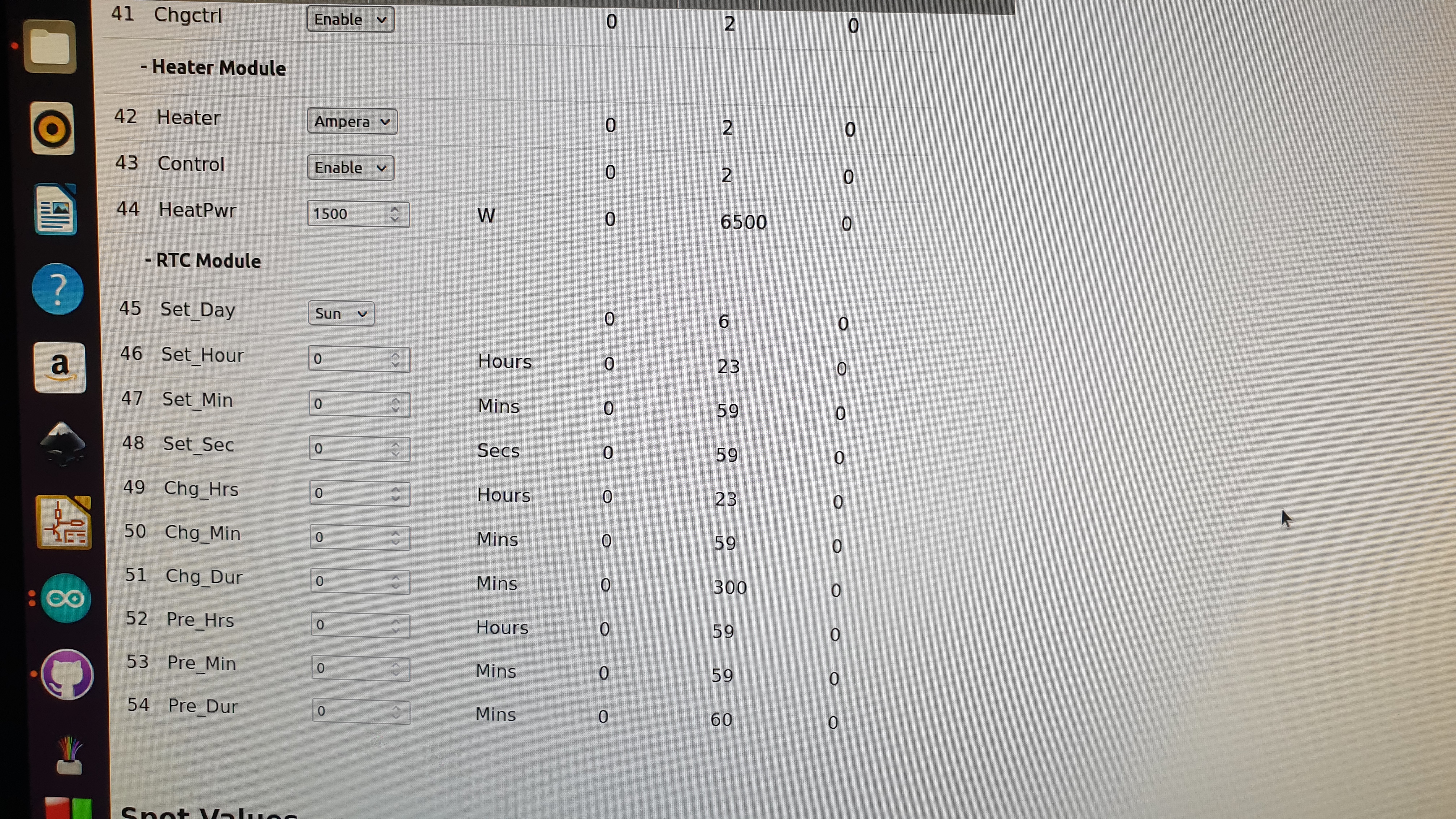

Timed charge, charge duration timer and cabin heater options now undergoing testing.

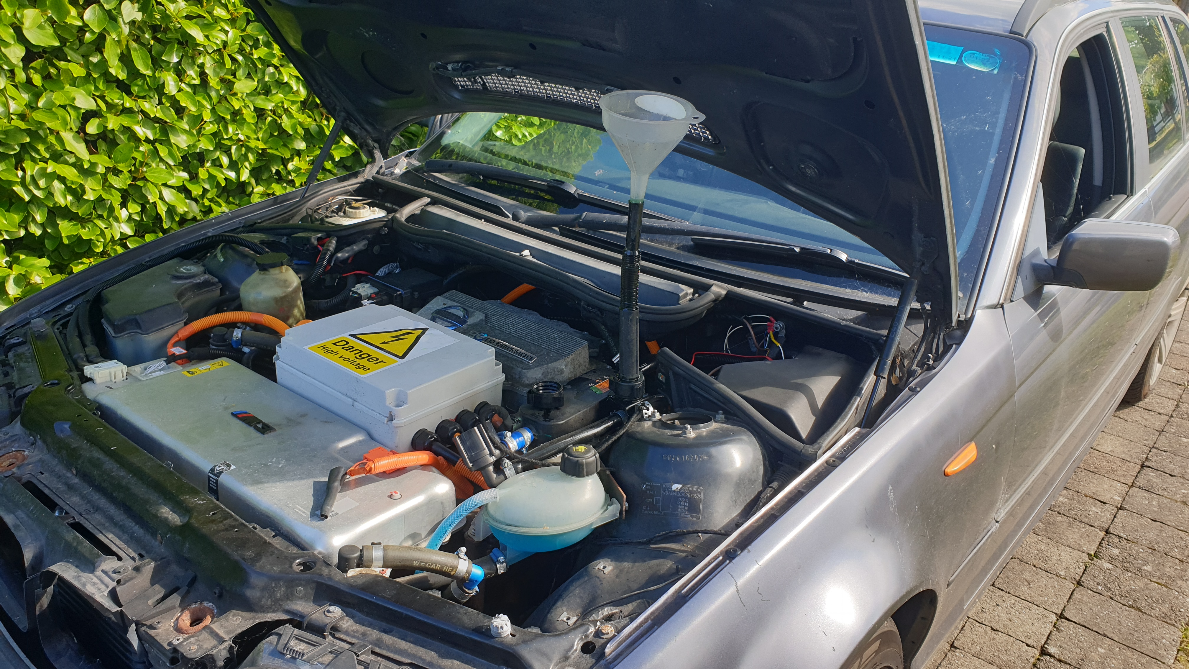

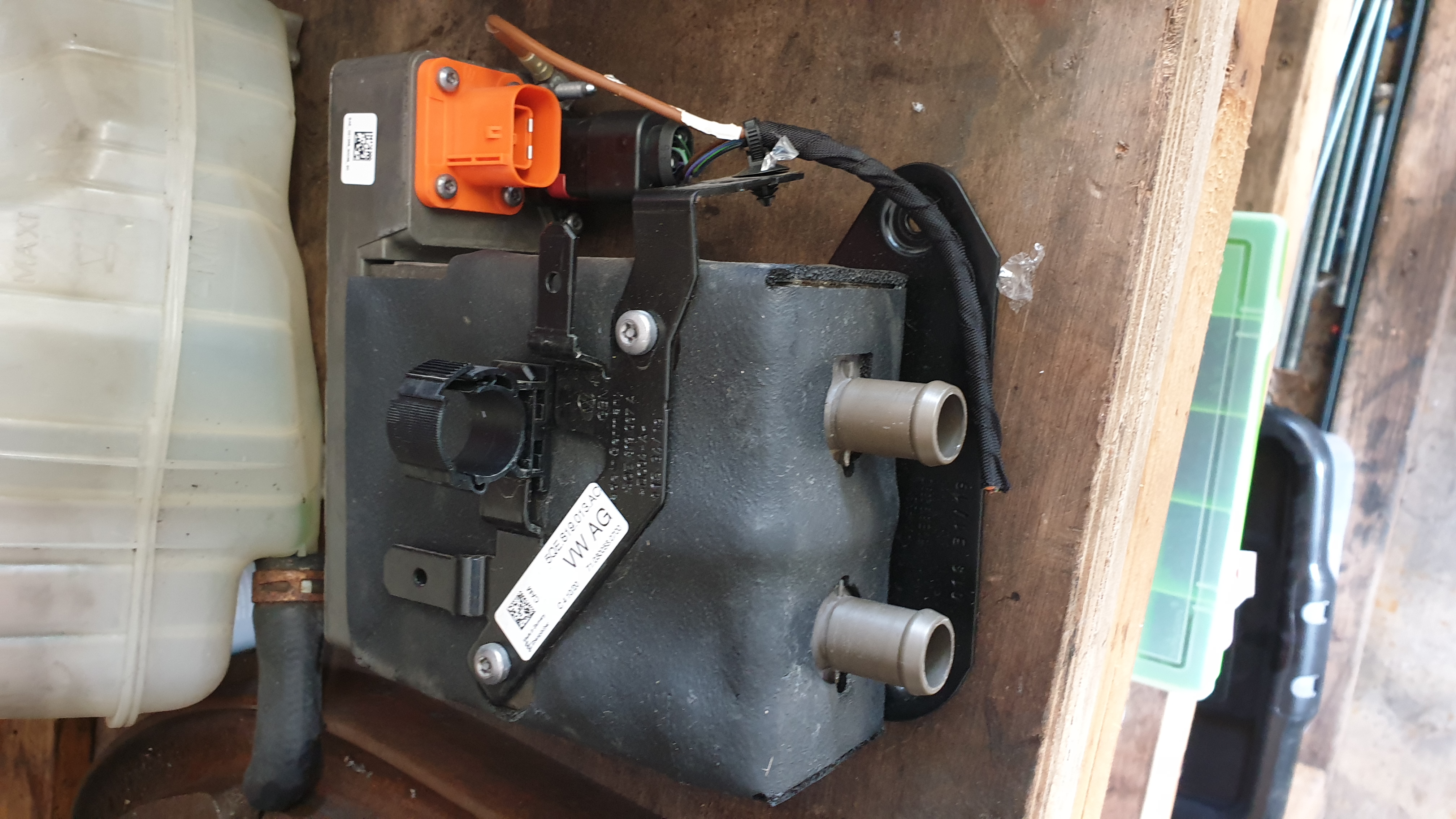

Ampera/Volt heater now running under VCU control. Now have to integrate with E46 ihka. Also got a vw unit which I believe is LIN controlled for further zombiefication.

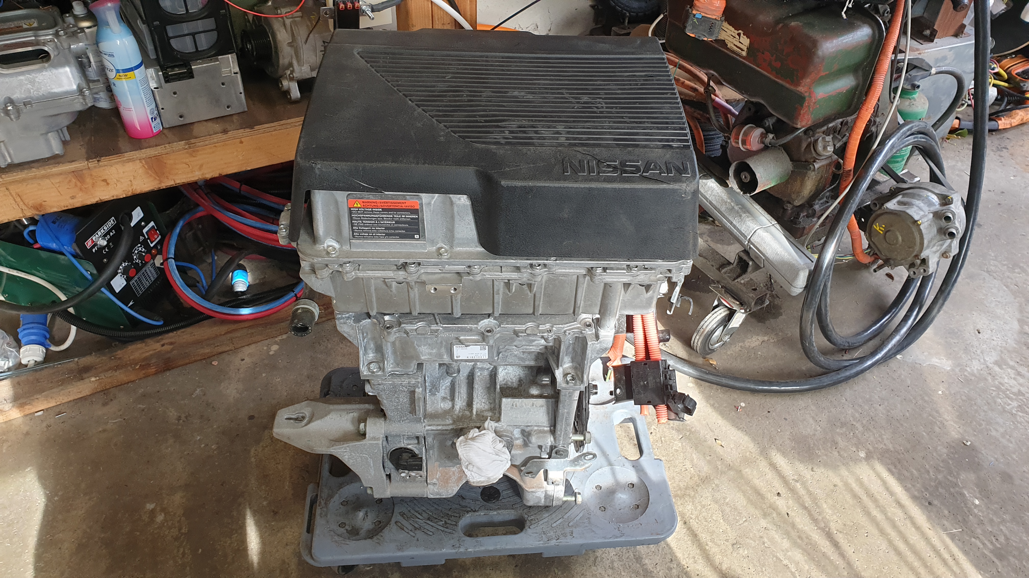

Thanks to Dala I now have a full GEN3 Leaf stack for zombification. It will feature in the latest conversion project now dubbed "The Trition Missile".
