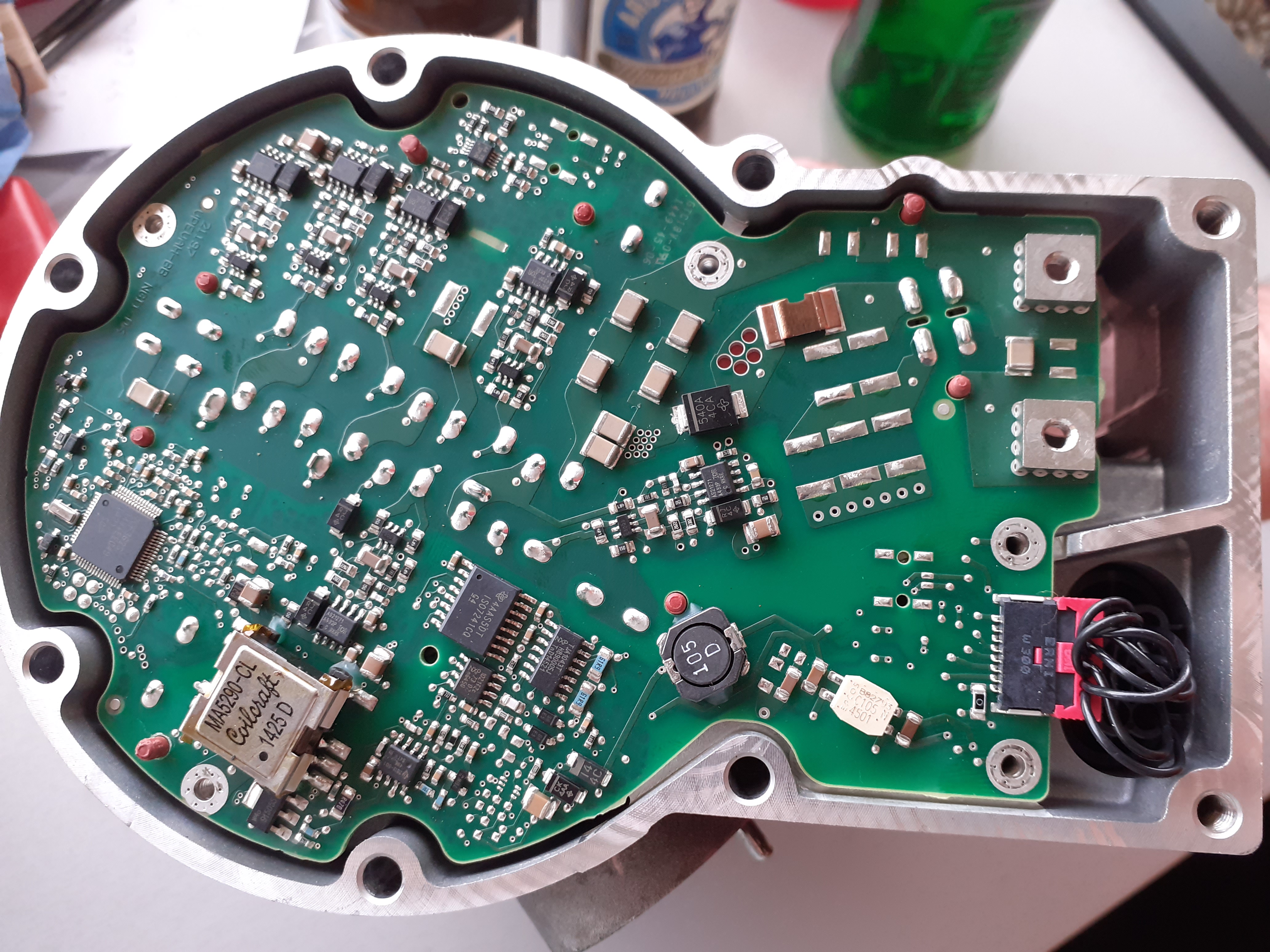

Clanarn
Posts: 56
Joined: Sun Oct 18, 2020 6:42 pm
Location: Göteborg Sweden
Post by Clanarn »
So after a week of troubleshooting, I found the issue. Not the same I inverter/pcb with overcurrent and blown fuses that I described here a month ago. Anyway, this pcb was purchased fully assembled and tested.
I had it on the bench fully working in February this year. But when test running it now it threw OVERCURRENT and HIRESOFS. First I thought it was software related. Then I measured around on current sensing related TP and components and when holding the probe against a leg of IC11, That bastard moved! Turns out IC11 had only been soldered on one of leg. Looked hand soldered. So I soldered it and now it works.
Been thanked: 1914 times

Clanarn wrote: Fri Sep 24, 2021 4:08 pm So after a week of troubleshooting, I found the issue. Not the same I inverter/pcb with overcurrent and blown fuses that I described here a month ago. Anyway, this pcb was purchased fully assembled and tested.
Ok, Clanarn contacted me and the board was not sourced from the openinverter shop - always buy original :P
