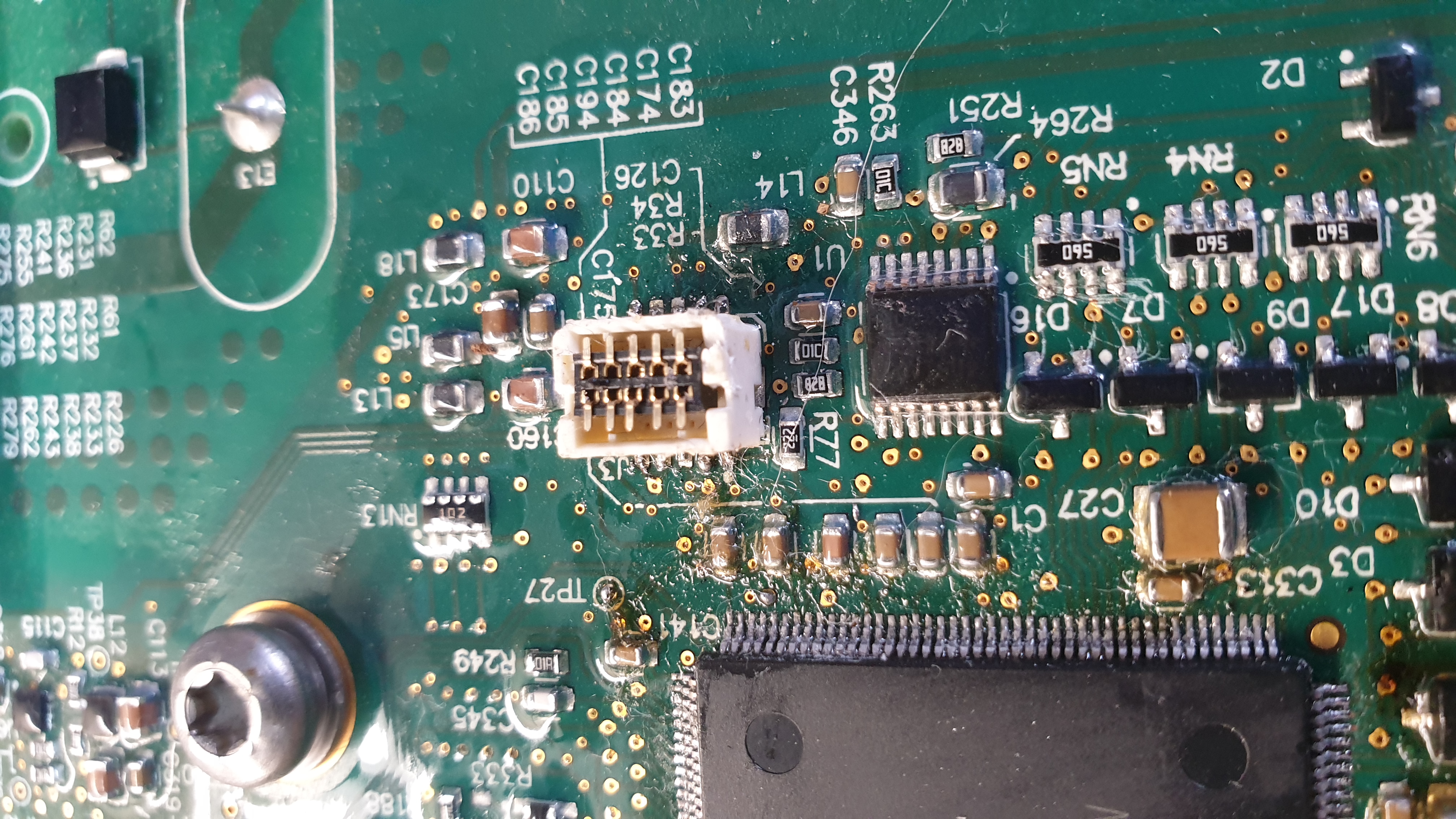

Thank you, Dave, Damien, Joho and anyone else that is helping on this project. I am a builder not a coder and looking forward to a Model 3 solution other than the Ingenext. It's a real pain to send your inverter to them and get it back in a timely matter without the thoughts of it getting lost in the post and making the remnants of the Model 3 motor a paper weight or living room table, boat anchor also comes to mind. Again, thank you guys.

Good news on the hardware front. The Harwin M40-3100545R arrived from Mouser and is a very nice press fit on that silly jtag socket.

Great, how about the connectors, so you plan to include them on the JTAG board kit?

This connector goes on the bottom of the PCB of the JTAG adapter. It just plugs in to the inverter board, hook up a USB cable and away we go. A very neat solution!

Yes, I know how it connects, I just wanted to know if Damiens kit will have all parts or just the PCB with SMT parts on board.
So we don't run into hastily ordering duplicates..

All parts will be supplied in the kit. I should have boards and FTDI chips this week for testing.

Good news : jtag boards arrived from jlc. Bad news : there was a slight delay in RS shipping my FT2232 chips. It's all good though as I'll have them in June 2023. Fun though that would be I paid over the odds for 5 pieces from chip one stop. ETA next week.
