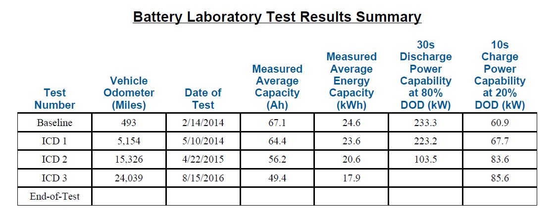

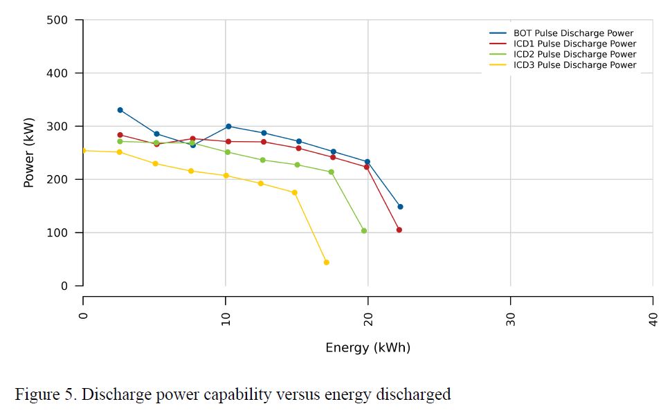

Just ran across this thread. People seem to be underestimating the capabilities of the Leaf pack. I have enclosed some data from a test report by Idaho National Labs under the DOE Advanced Vehicle Testing Activity Program. They tested every EV pack (except Tesla) up to about 2016 with very detailed capacity, charge, and discharge information. A GOOD 24kwh Leaf pack is capable of over 200kW discharge power for a 30 second burst right down to 20% SOC. However, it appears that there is relatively fast degradation, so a high mileage pack will not achieve that. We used the DOE data to choose the pack (Kia Soul EV) for our 1st generation race car. The DOE data was bang on. I have included a couple of screen shots and will try to upload the PDF. The data should still be available on the DOE site.
batteryLeaf9270.pdf
(1.3 MiB) Downloaded 277 times

dougyip wrote: Sun Oct 17, 2021 9:39 pm Just ran across this thread. People seem to be underestimating the capabilities of the Leaf pack.
I think what everyone is pointing out is it lacks proper thermal management resulting in rapid degradation. The chemistry appears to be quite similar to volt packs. No doubt they can deliver the juice.
Thanks for the review data, I’ll add it to the wiki
