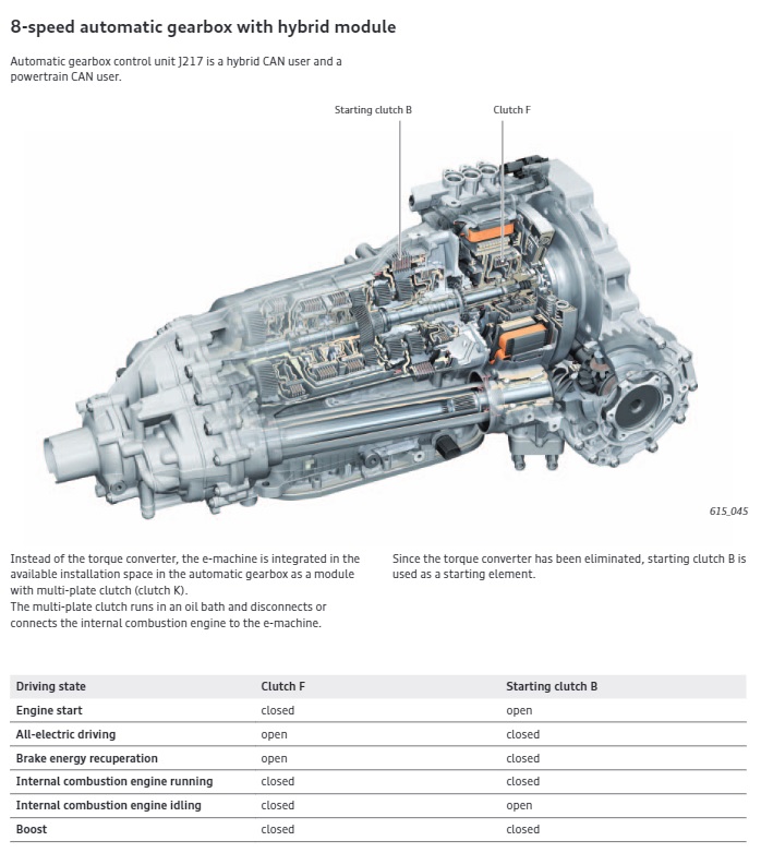

I cant speak fully for the BMW side as i work more on VW/Audi (below an example of audi hybrid 8sepeed gearbox)
when it comes to a hybrid manufactures have gone many different methods of control. some making the engine ecu decide when the transition happens some leaving the motor inverter. lots of test have been run on the engine and motor to make sure the swap between the two are as smooth as possible.
the main thing is manufactures don't like sharing with us there CAN Bus data. meaning we have to reverse engineer all the signals and find out what they mean and which ones control components.
if you are using the bmw gearbox, typically the gearbox control unit is built into the gearbox. you would need to learn that CAN BUS signals are transmitted to/from the gearbox for it to select gears and transition between engine and electric motor. this is getting done on the BMW thread BMW ZF GA8P75HZ Gearbox Hacking.
The transition device (can be STM32, Arduino, Rpi, ect) connects before the ECU, inverter and gearbox would have to take in the pedal input and essentially match the engine output to the motor output before you start actuating clutch's to swap modes. sounds simple really isn't.
As for less hardware unfortunately. you still would have to remove the mechanical power steering pump as that would stop working as soon as the engine is switched off. electric power steering and vacuum pump would need to be fitted. A/C you could have mechanical or electrical as its not always needed.

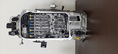

Re: 330e Hybrid Swap
I'm in the middle of this right now with a GA8P75HZ from a BMW 330E, any info on the motor is scarce and ZF are tight lipped, we are using the original BMW battery pack, Standalone engine management, separate TCU and a VCU to control the inverter and BMS.......LOTS of CANBUS, main issues so far are getting a "torque model" style output from the ICU ECU to feed the VCU and getting any information about this damn motor, I'd like to run a PM100DX for ease of integration with the VCU but i'm open to suggestions if anyone has any?

Are you sharing the information needed to run the oem parts as open source?
Sorry I didn't make that very clear, Not looking to run too much of the OEM electronics, battery pack will be broken down into its 5 individual modules and probably managed with an orion bms and valeo charger, TCU is an aftermarket controller, still up in the air on which inverter to use(We don't have the OEM unit) I was looking to use a Cascadia PM100DX but they aren't being very helpful in identifying if they can work with this motor. Anything useful I might know I'm happy to share though.

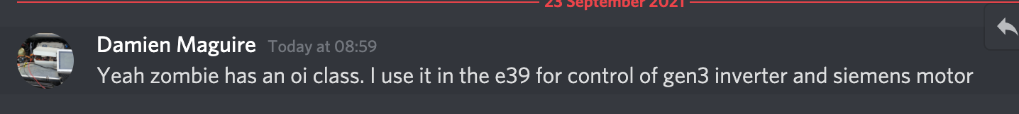

Not 100% sure, maybe the zombie will support generic can controlled inverters and you'd just match up the ids. I suppose you could use the zombie for controlling heater, chargers, car gauges etc.
*Edit* Zombie does support that setup

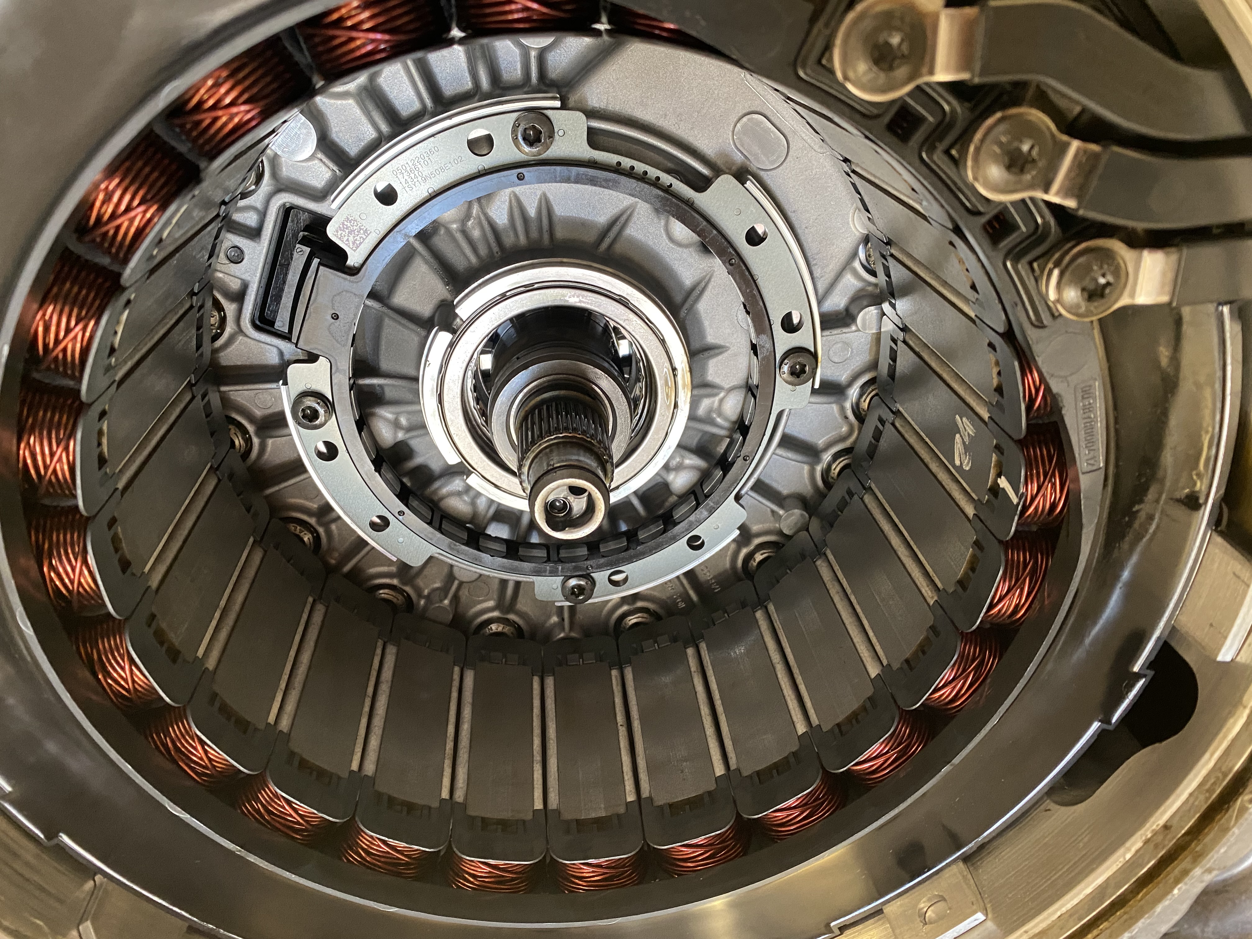

Is anyone willing to share a bit of knowledge about what would need to be found out about this motor to find a suitable inverter? Cascadia have come back to me with a list of
Is the motor SPM or IPM? Looks like its IPM from what I can Gather?
How many pole pairs? Out of my depth Rotor has 2 Rows of 16 poles? And stator has 24 slots?
How many pole pairs is the resolver? 28 Poles/Slots? (My electric motor terminology is terrible) with 8 peaks on the encoder rotor? This is a SIN/COS encoder but I don't know the standard exciter voltage.
What is the peak and continuous current rating? No Idea....I believe it's an 80KW peak output motor
What is the battery voltage? OEM 5 module BMW pack has a nominal voltage of 293V, a working range of 224-332V and 26Ah capacity according to BMW data

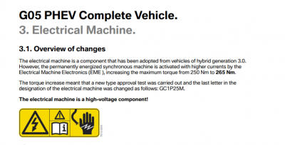

Found this interesting little snippet from BMW PHEV GEN4 document, Battery voltage has increased to 354.2V Nominal, 269-403V range

If you want to get an idea of what it takes to spin up an unknown motor I'd suggest starting here :

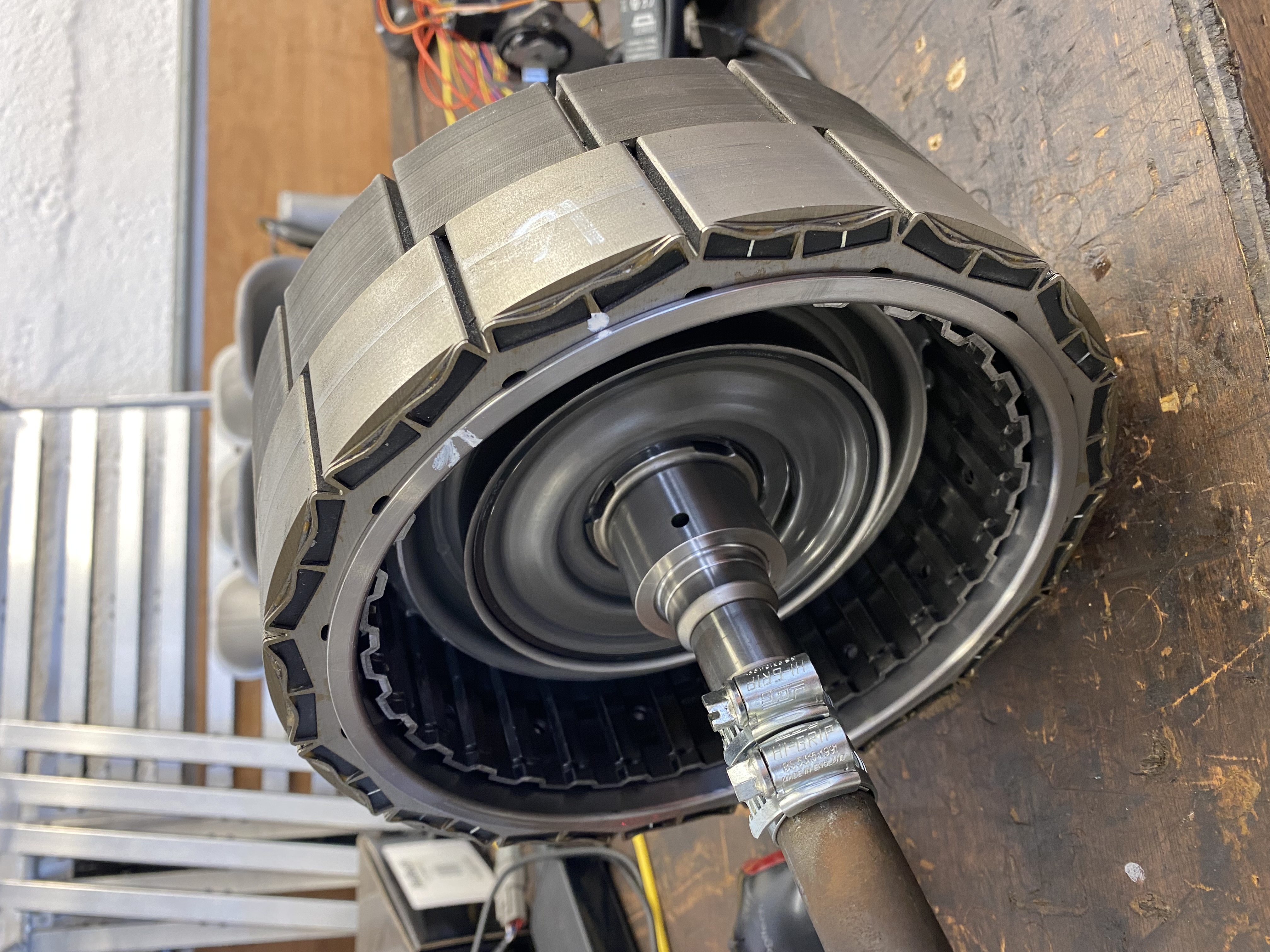

Well, here goes nothing...
I have mine spinning with Johannes' board and a Prius inverter now, only at 100V at the moment but looking to get the main pack connected soon
