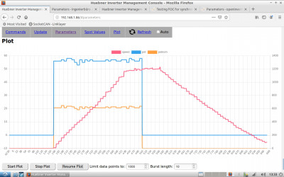

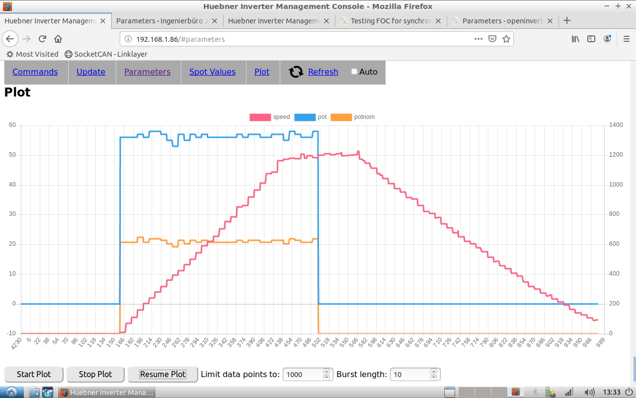

I think I've found a bug in the FOC.
First my setup - arduino with a pot and a button - pot is read and the value is sent via CAN, but only if the button is pressed, otherwise zero is sent. I can plot this as potnom. Quick presses of the pot work as expected. However if I hold the button down for a while then release, the motor continues to run for quite some time. This is different to the experimental FOC branch which worked exactly as expected. I've attached my parameters.
params (2).json
(1.09 KiB) Downloaded 167 times
doobedoobedo
Posts: 264
Location: UK
Re: Inverter Firmware v4.56.R
Post by doobedoobedo »
here is a plot of motor speed vs pot/potnom you can see the motor continues to run at max rpm (in fact rpm actually rises slightly) following zeroing of pot
Been thanked: 1913 times
Ah yes. So you set fweak to 15Hz and idweak to 1A/Hz. So above 15Hz it will start injecting field weakening current. Since your syncofs isn't 100% correct this also contains a small torque producing component and your motor keeps spinning. Try setting fweak to 1000 for now to disable that and you should have the old behaviour back.

So if syncofs is off and commanding pure d-current will also contain a q component, i.e. the motor will spin. Once you get past fweak the inverter maintains a certain, supposed, d-current and there is no way to stop the motor gracefully. You can send the stop command and hope that back EMF is below 2x IGBT max voltage.
