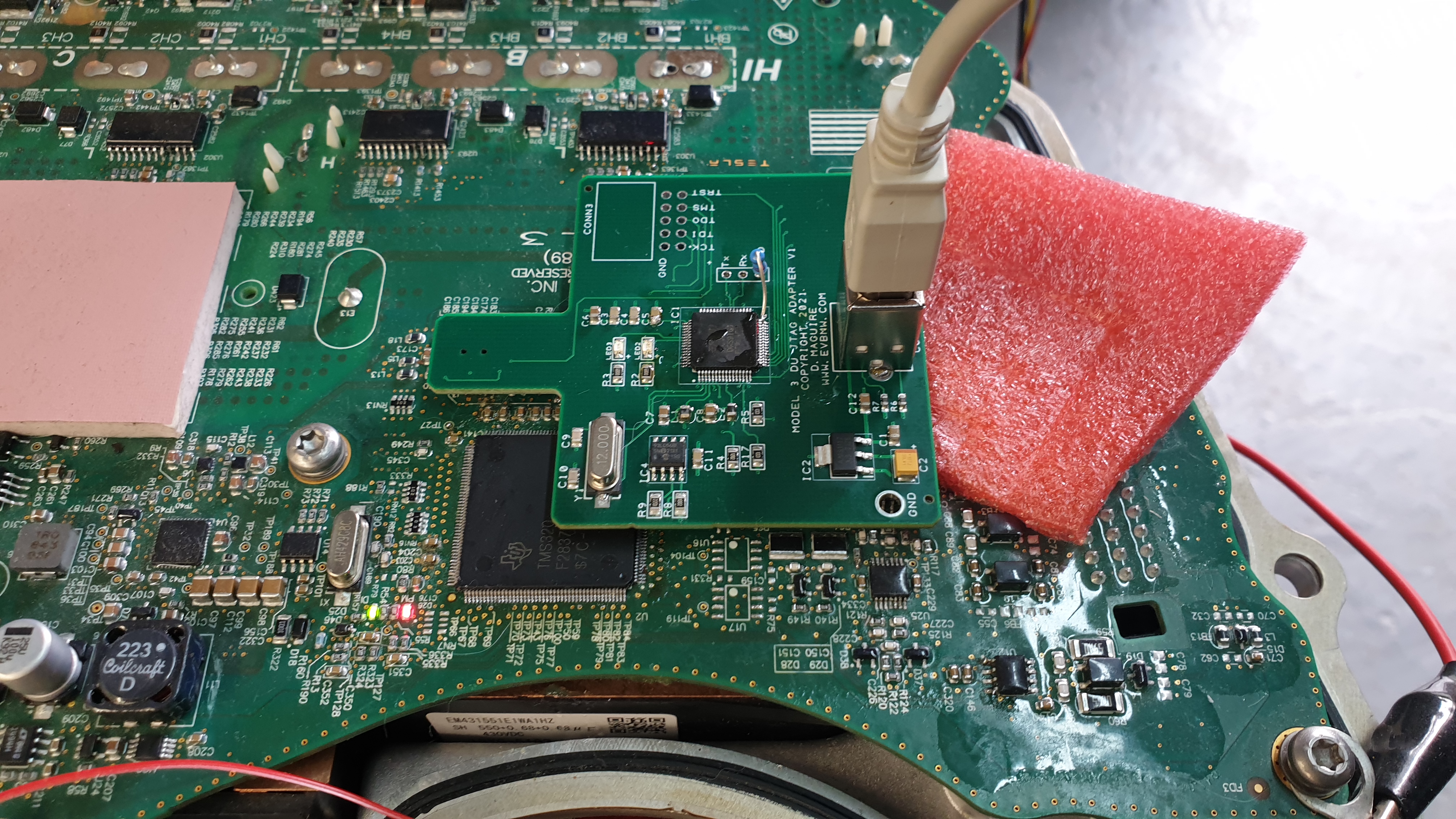

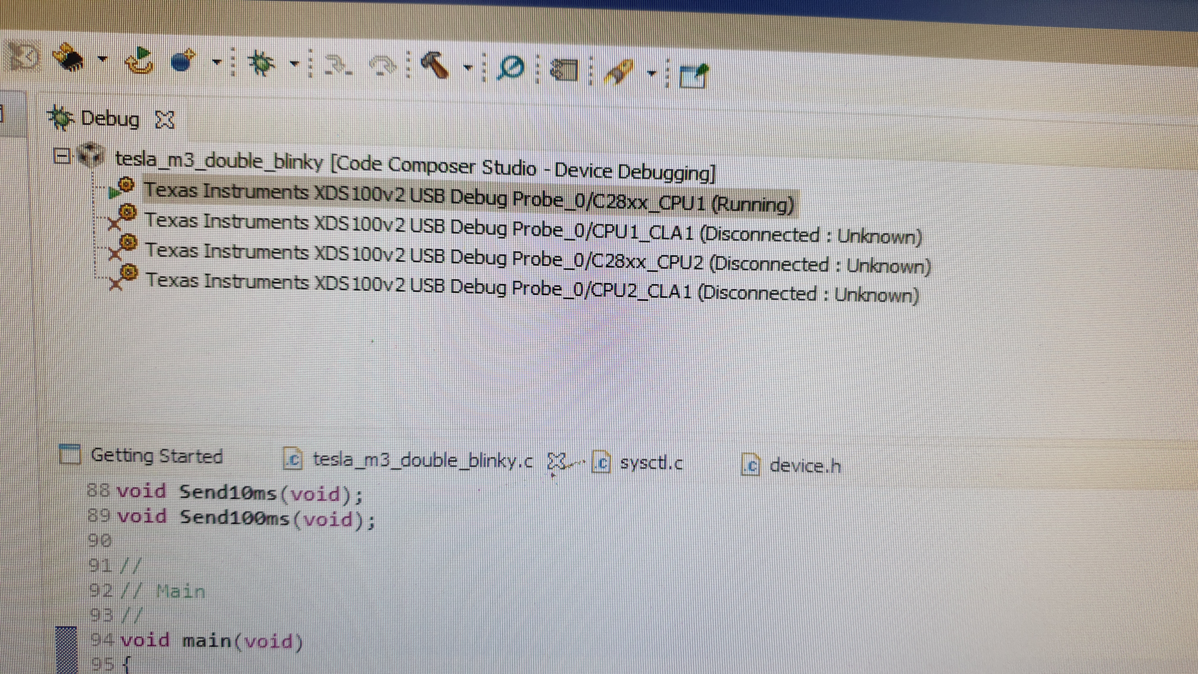

Good news : Harvested a FT2232 from a dev board, soldered to the jtag adapter, programmed and presto we are talking to Elon. Push fits perfectly into the horrible jtag socket.
Bad news : Design flaw! That 1k pull down resistor on ADBUS5? Should have been ACBUS5!! Gahhh. Anyway. Boards are fairly cheap from jlc without the ft2232 so I'll fix and order a fresh batch.

Jack Bauer wrote: Mon Oct 18, 2021 2:52 pm Bad news : Design flaw! That 1k pull down resistor on ADBUS5? Should have been ACBUS5!! Gahhh. Anyway. Boards are fairly cheap from jlc without the ft2232 so I'll fix and order a fresh batch.
Sorry about missing that when I reviewed. That was my design fix too... :(
Posts: 3666
Has thanked: 12 times
Been thanked: 350 times
No worries Dave:) new boards ordered. At least we know it all works other than that.

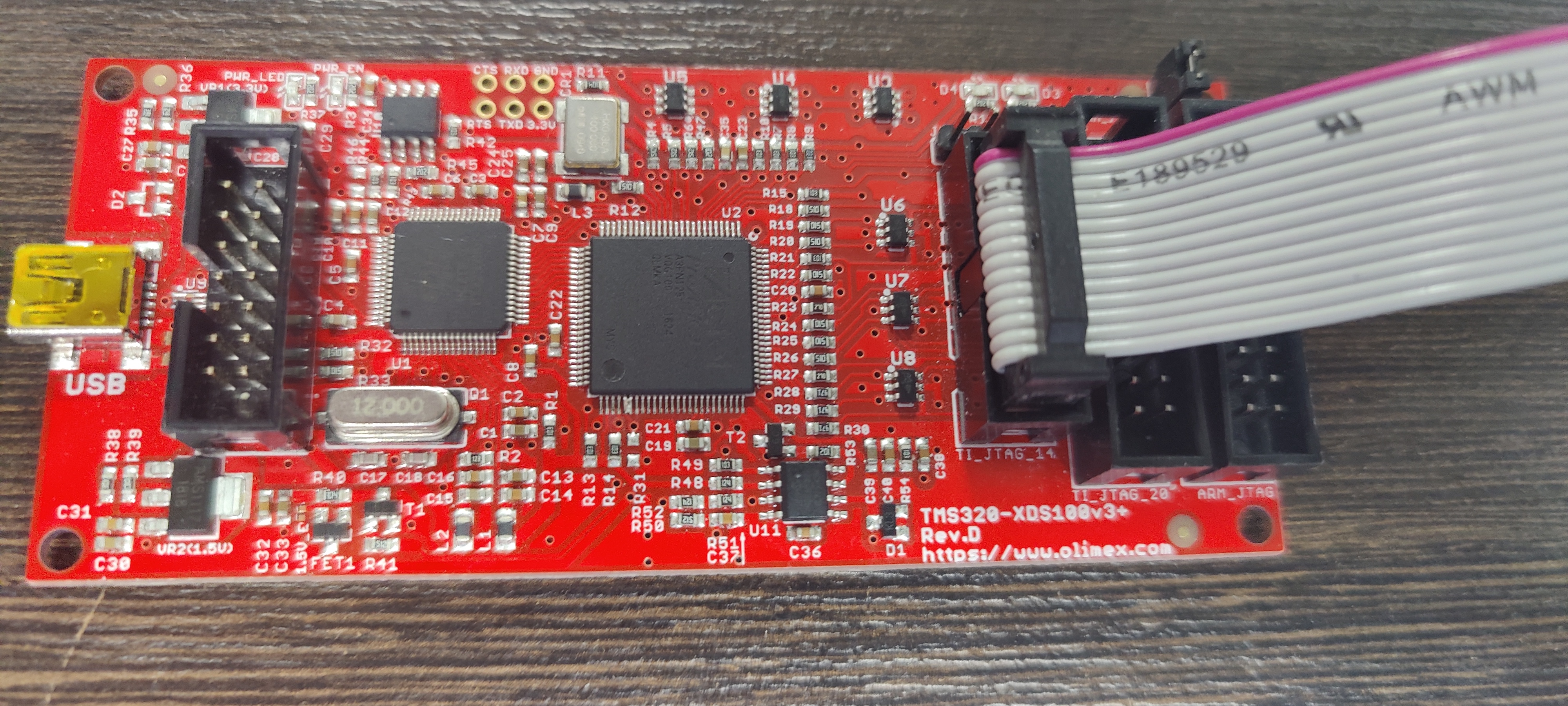

That's only simpler if you can find the mating connector and successfully crimp the pins. Damien's board is a MUCH easier solution for everyone else. Since he's tested it to work (other than the one problem) I'd say he's in good shape and everyone is likely to want to go that route rather than crimping pins you need brain surgeon dexterity for.
I feel so lucky that the Model S board has 14 pin ARM JTAG headers right on it. No dinking around making things, just use a normal ARM JTAG cable and it works. Why couldn't they do that on the Model 3 as well?! XDS110 works great on a Model S controller too. It seems like they've went backward a bit in terms of accessibility. But, that doesn't really surprise me a whole lot.
