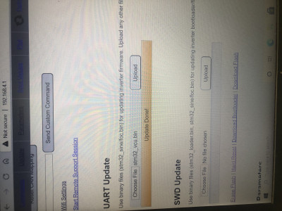

Hi strange issue here. Updated the software on my v1 board yesterday(compiled from master on github) I did update as normal and then it just stopped at 80%. No problem pulled power the did tweezers across c12. The board then accepted the update and finished. Only issue is now it doesnt show any parameters on web portal(it did before update) I have tried Johannes tip of clearing the files on the/list page. II have also tried another wifi board that works with the older vcu to no avail.Already tried compiling a new bin on other computer just to be sure. Would i be right in assuming the issue lies somewhere in the communication between stm and wifi module? Any body got any thoughts?
Can anyone share a .bin file with me to see is it i just made a mess when compiling?

@paa your most likely issue is a bad solder joint on the MCP25625. the latest firmware initialises this device at startup and if not present or has a problem will give the problem you describe. Attached see binaries for an early release without this check in place. Future updates will see a timeout on this so the vcu does not halt.

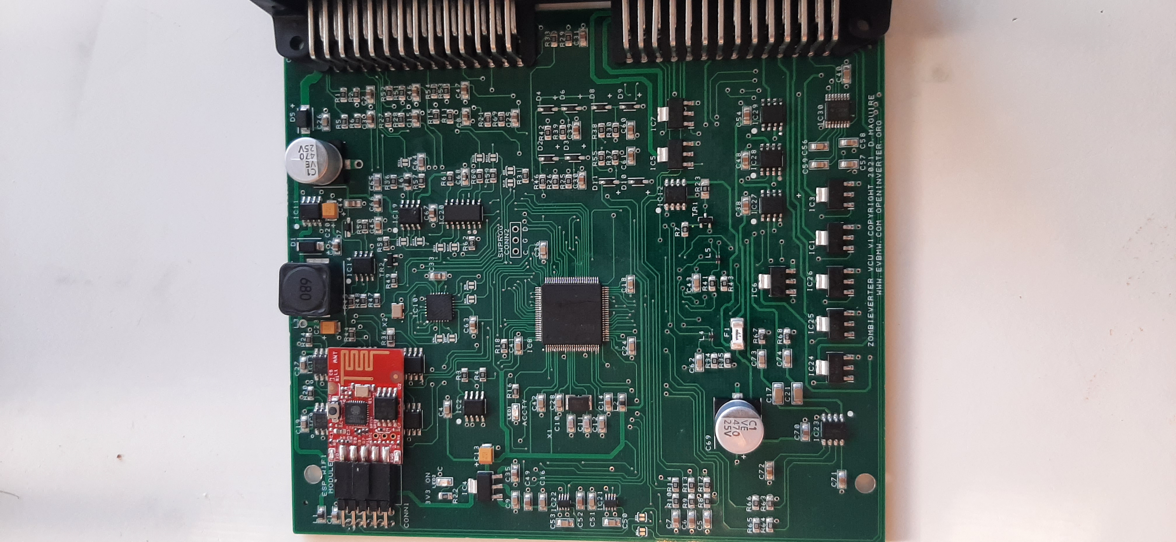

Coming back to it today and the web interface is empty, like paaa described above. I have re-loaded it several times, apparently it accepts this OK (with or without the tweezer reset) but still no life after a reboot. I tried your .bin file too Damien. There should be a LED flashing if it’s alive?
The soldering on the MPU / IC10 looks fine, I can reflow it but not too optimistic right now. Any other ideas?
Posts: 4003
Been thanked: 1121 times
Re: ZombieVerter VCU Support
the led should be flashing when the software is running. The fact that its uploading means the bootloader is alive. The .bin above should run regardless of the MCP25625. Honestly, I can't generate a fault like this here.

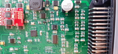

andrewjenkins34
Posts: 57
Joined: Thu Dec 17, 2020 1:48 am
Been thanked: 15 times
Post by andrewjenkins34 »
Anything new is always challenging. I wouldn't have even started my project if it weren't for the work you're doing and I look forward to seeing it through.
That being said...
I trust my soldering skills about as much as I trust the gov't so I paid someone to do it for me. As soon as I hooked up power and ground, the component at ic19 let out it's magic smoke. Before I have it replaced, can anyone see anything else that would cause problems?
All leds light up and blink, at least for the half second before the smoke started.
Posts: 4003
IC19 is an NCV7356 SW can transciever. As such it gets a direct 12v feed to pin 5. It looks from your pictures to be oriented the correct way so I'm going to guess its the wrong part.
andrewjenkins34
Posts: 57
Great, so that means at least one other component is in the wrong place.
So of the similar components:
IC2 - 24M01RP
IC11- XL1509
IC12 - NCV8461
IC14 - V7356
IC 27, 28, 29 - 3122C
IC23 - TDA2822G
Whatever is at IC19 is not legible. IC14 is supposed to be at IC19 and I'm hoping that's the only change?
Is this information available somewhere that I missed?
Posts: 4003
Full schematics and board layouts on the github as always :)
https://github.com/damienmaguire/Stm32- ... are/Zombie
Looks like IC14 is the NCV7356 that should have been in IC19
