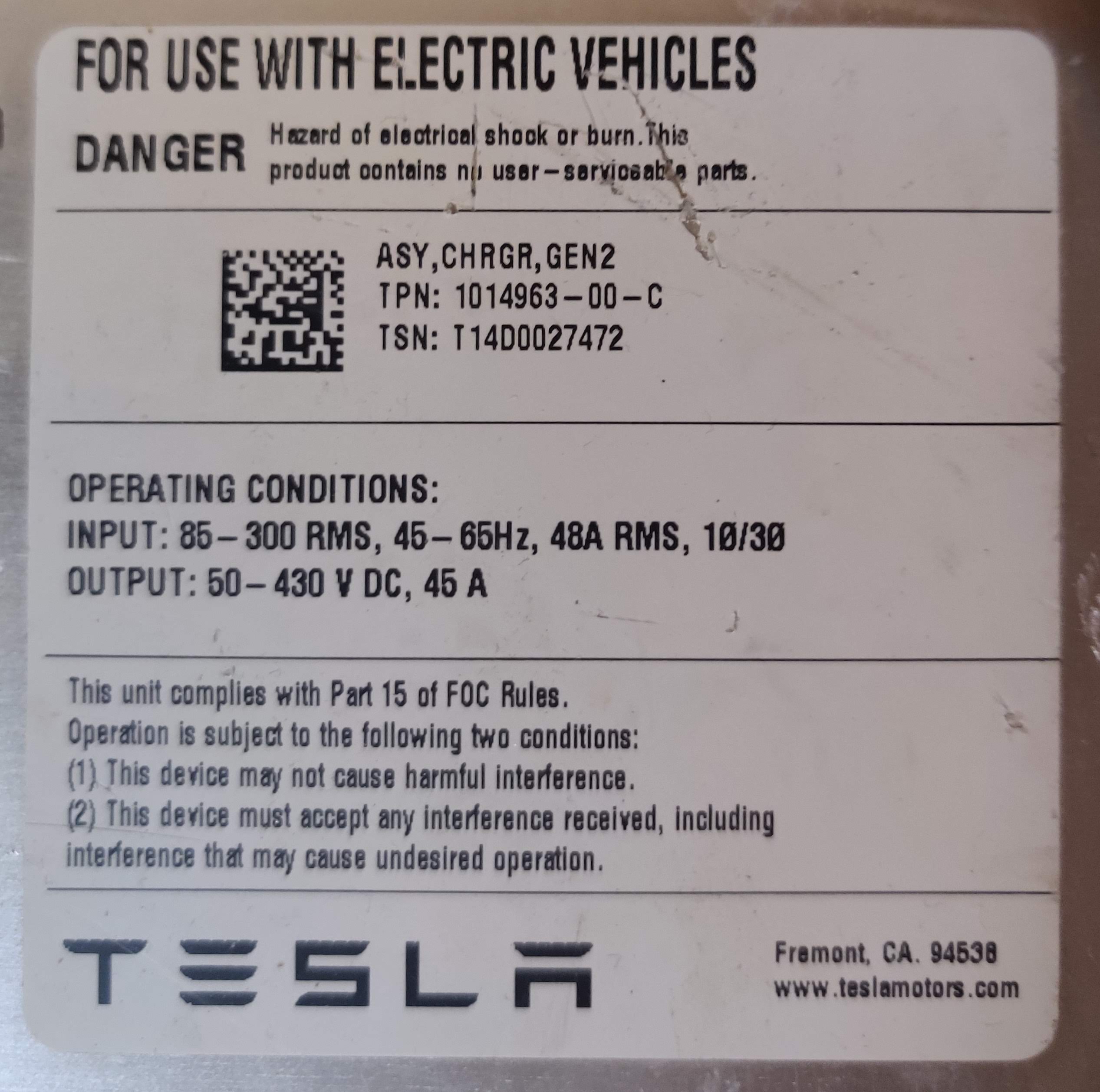

Folks, I am trying to test Tesla GEN2 charger. Using V5aB3 board running commercial software downloaded using link on Wiki page (not registered yet, just testing for now). All modules are operated on one common phase (110V).
When I initiate charge in "Manual" mode by putting HIGH on '"D1" two modules are being activated (see photo, showing only two module LED lit). I get ~110V on the output regardless of setting on web interface. I verified only one module outputs voltage. I checked voltages and control signals to power modules: GND, +15V, +12V, ENABLE, CHARGE_ACTIVATE. All look good.
Does it look like broken charger? Is there anything else to check?

johu wrote: Mon Jul 05, 2021 12:59 pm Do these even do anything meaningful with no battery connected?
Good question, but I am sure it would be helpful if I described what happens with battery connected.
I have half of the pack connected (48s) for testing.
I configured charger to operate single power module at the time through "set chargerena x" command, now I can toggle which unit I want through drop-down.
Each power module behaves differently
Module 1
The only one which responds somewhat properly but not quite. When I set udcspnt and udclim slightly above current battery voltage (172V) and trigger charge then it looks like it wants to charge but quits immediately. I think this is because power module reports battery voltage as 232V !!! When I set charging limit to 240V then it seems like it initiates charging but current going into battery is only ~0.2A
Module 2
No response, no LED, no relay click only 12V supply jumps to 3A and then fluctuates widely between 0.2A and 3A
Module 3
Looks like it tries to initiate charging but relay keeps clicking every second and LED blinks
I really do not know history of this charger, it does not look like it was tempered with and no visual damage or burn signs.
I have no prior experience with Tesla charger therefore I was looking for some tips but it looks like it is just bad unit.
This is not Supercharger unit but it is Rev C, Did anyone get 1014963-00-C (non supercharger) unit to work properly?

Didn’t Damien pop his when he tried to charge under 200V? That may be related..
arturk
Posts: 148
Location: United States, MD
Has thanked: 7 times
Post by arturk »
Bryson wrote: Mon Jul 05, 2021 9:42 pm Didn’t Damien pop his when he tried to charge under 200V? That may be related..
Right, I remember he said "much under 200V".
Lowest I tested was at 185V for few seconds and 3A current limit. No pop, no smoke, no charge.
What is your revision?

1014693-00-G
Been thanked: 1914 times
I think the reason they break below 200V is because they do not limit DC output current. So each module seems capable of 15A. If you allow 16A@230Vac in that is 3750 W. That is only 10A@375Vdc (neglecting losses) but roughly 18A@200Vdc. So already above rating. Go figure @100V.
If you limit DC current or AC current to stay below 15A you should be fine
