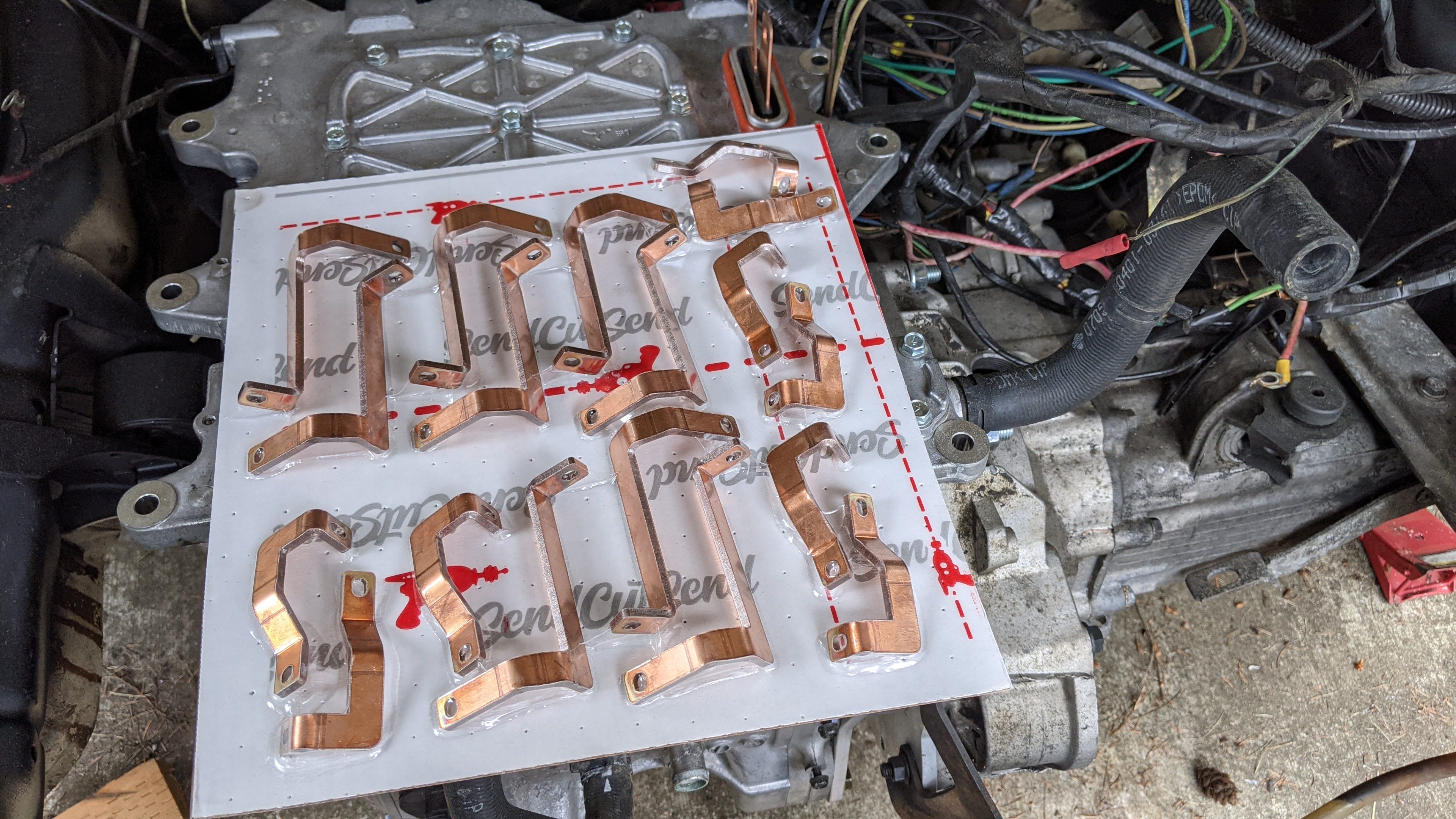

also, i decided to go with custom busbars for my batteries, instead of cable, since they will be VERY inaccessible when installed and it will make me worry a bit less about my crimps :)

Yes, bussbar >>> cables!!!

Busbars!

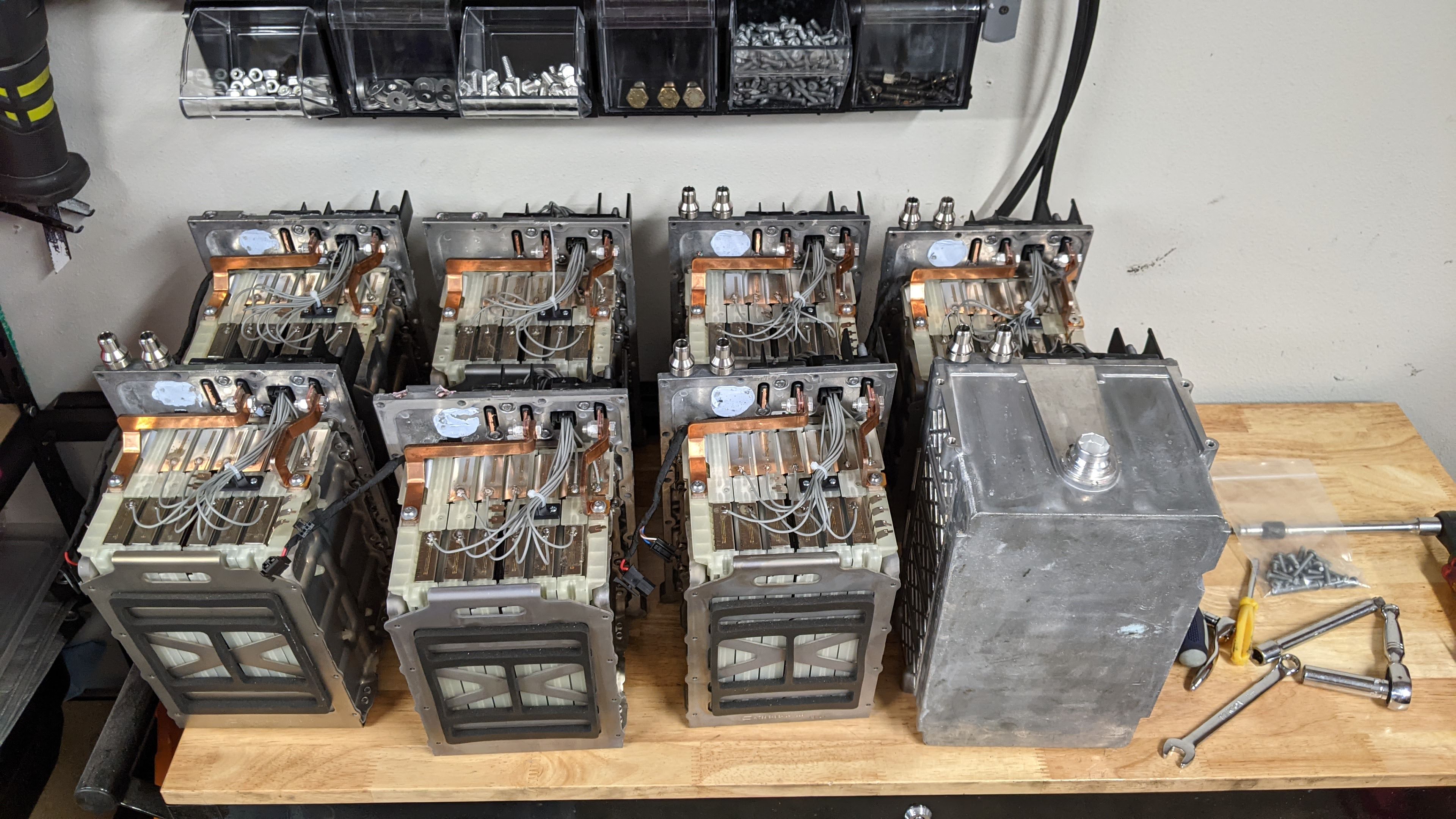

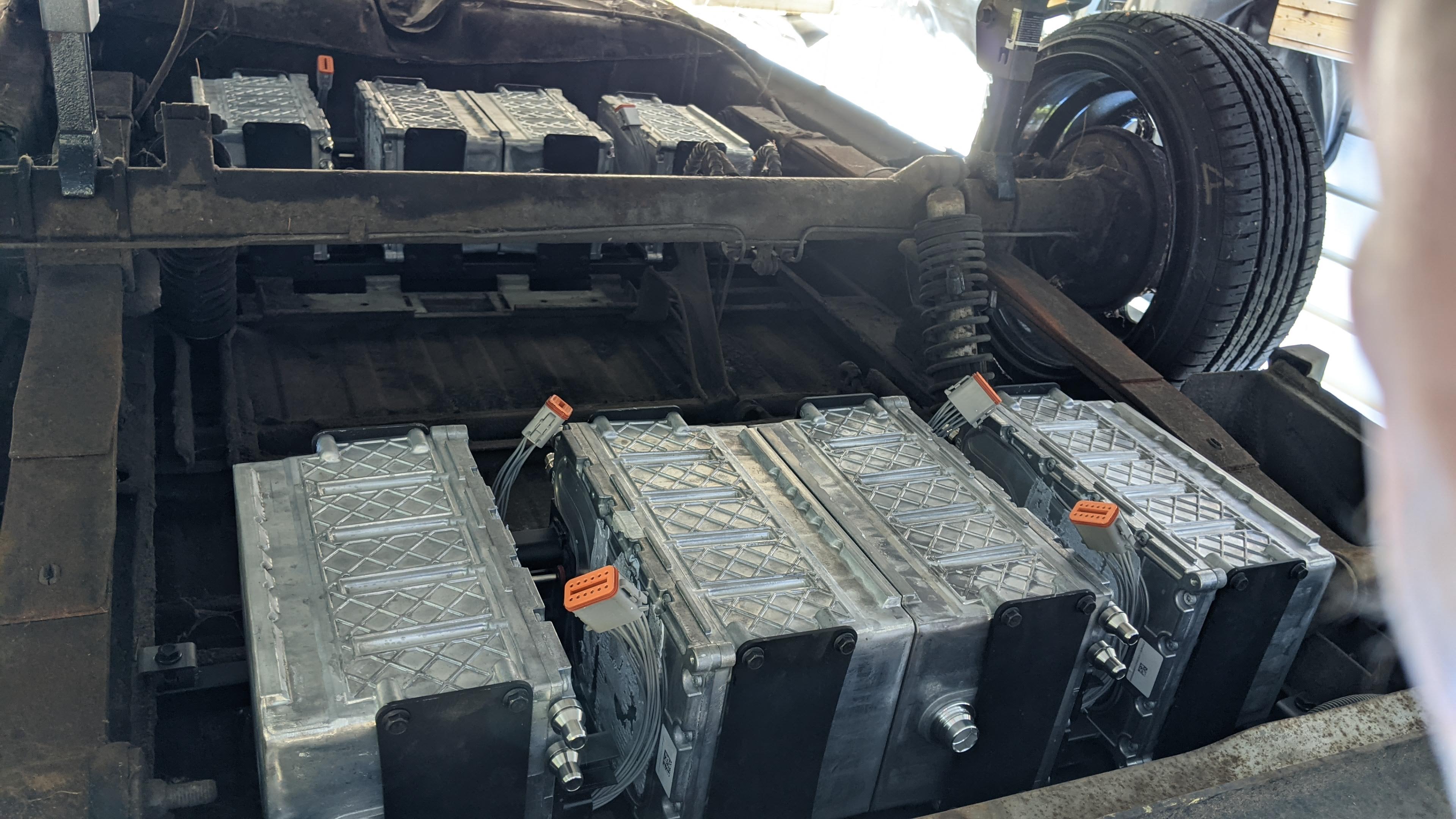

battery reconfiguration done, and installed under the truck. TDL is still very long.
Again, this is a very modest battery pack, @ ≈7kWh, that I chose for it's low cost and small packaging that gets me to a 96s pack.
Batteries with all BMS leads and busbars installed:
then back in their enclosures:
installed under the truck, not noticeable at all:

You said low cost. May I ask how much for the modules? Might go your route.
vwbrady
Posts: 248
Location: Seattle, WA
Has thanked: 5 times
Been thanked: 18 times
Re: Project VW Cadd-E
Post by vwbrady »
RetroZero wrote: Fri Jul 30, 2021 9:05 am You said low cost. May I ask how much for the modules? Might go your route.
They sold out after a few weeks but they were $100 each. Mercedes L09-1 modules, cells made by Li-Tec in Germany.
At 880Wh new, with the diecast enclosure they come in, I thought it was a good deal. I bought 16 and am only using 8 at first. depending on my range i may add the other 8 in parallel. they did take a decent amount of work to make usable, as you can see in the thread. And when running these in a 96S 1P config each cell tab is carrying full current. So, we'll see how that goes...

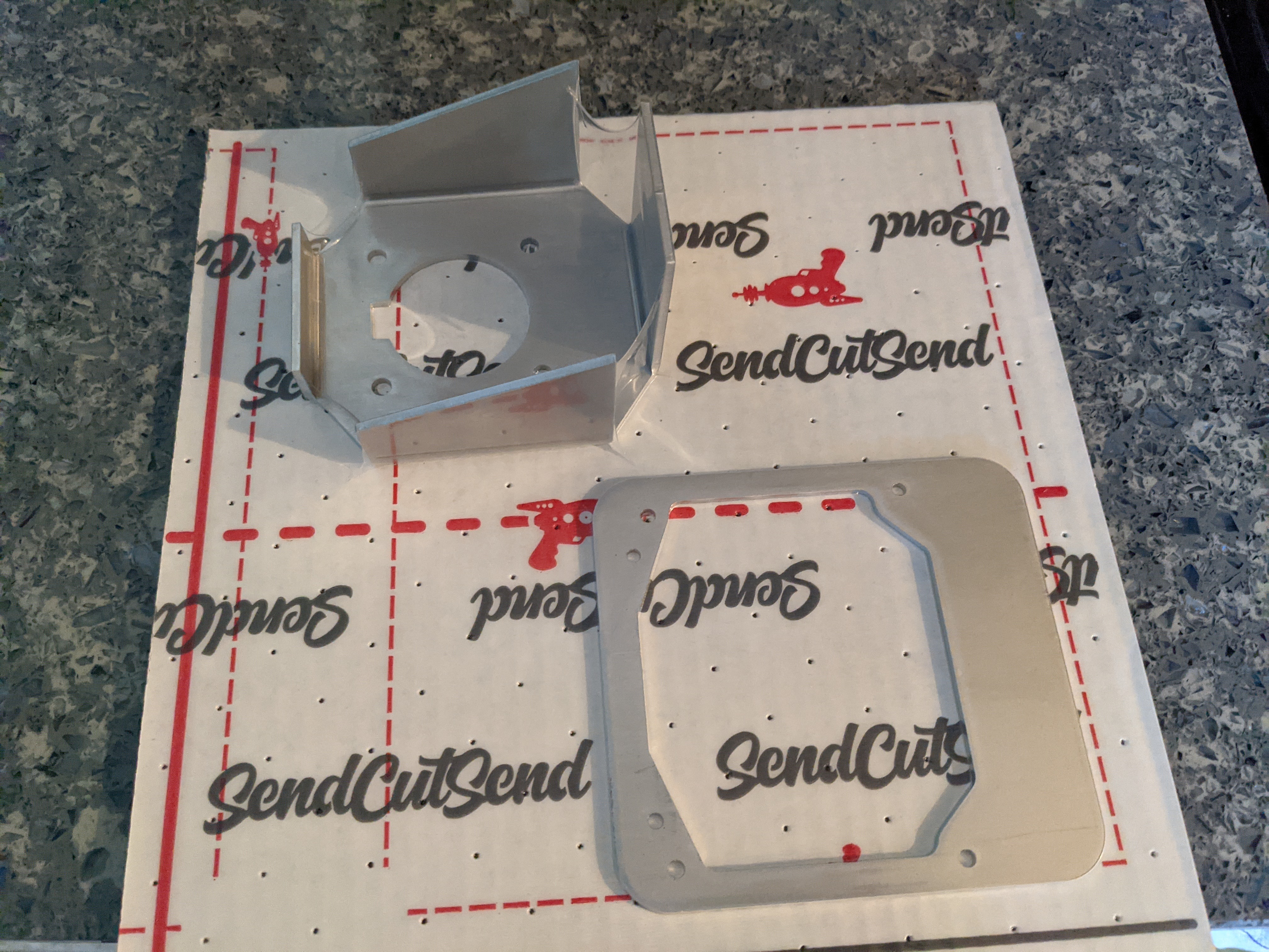

made a little more progress before paternity leave ended.

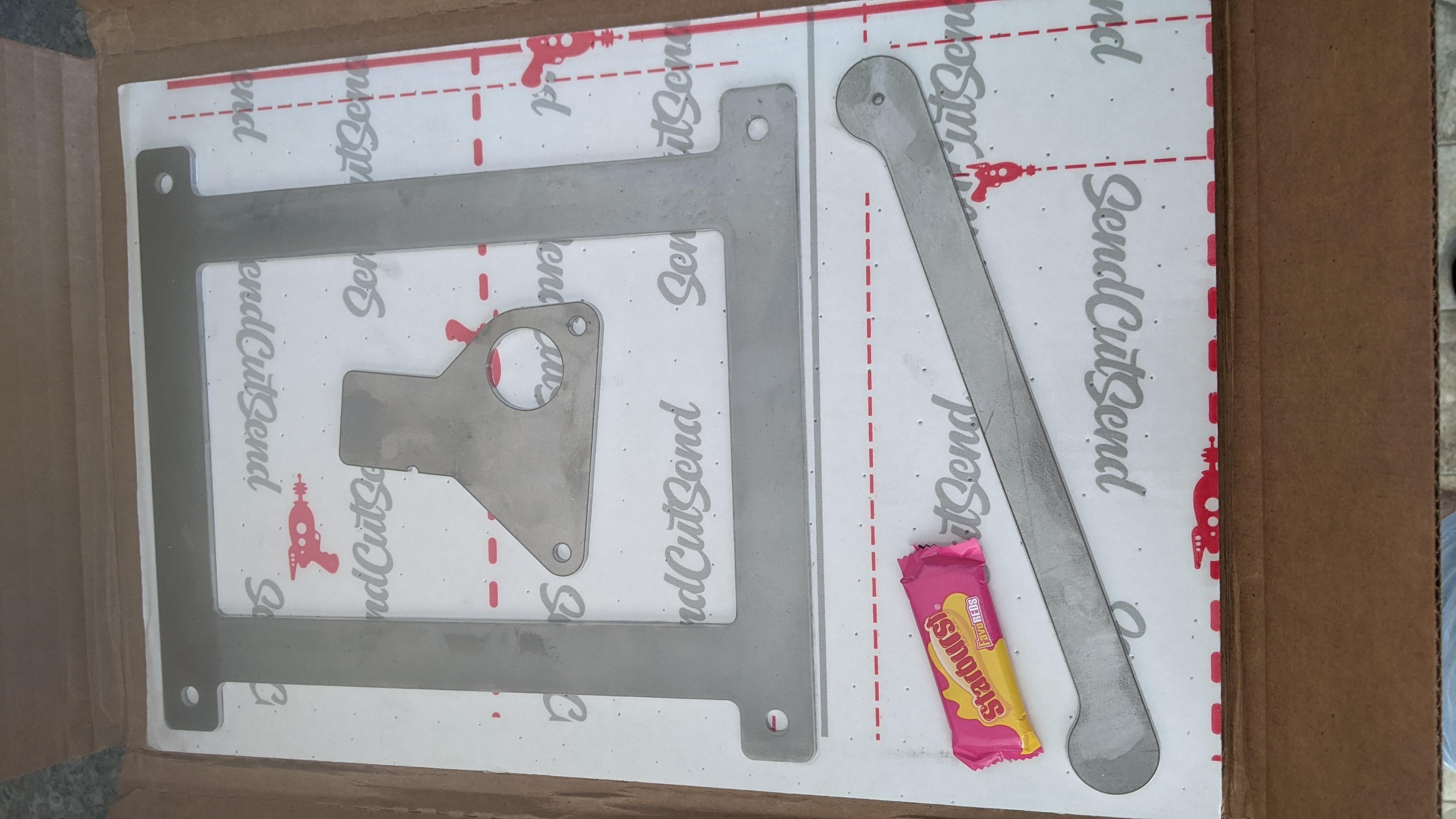

yet again, more laser cut parts from Send Cut Send. Chevy Volt Charger bracket and a bracket for the Leaf acc pedal

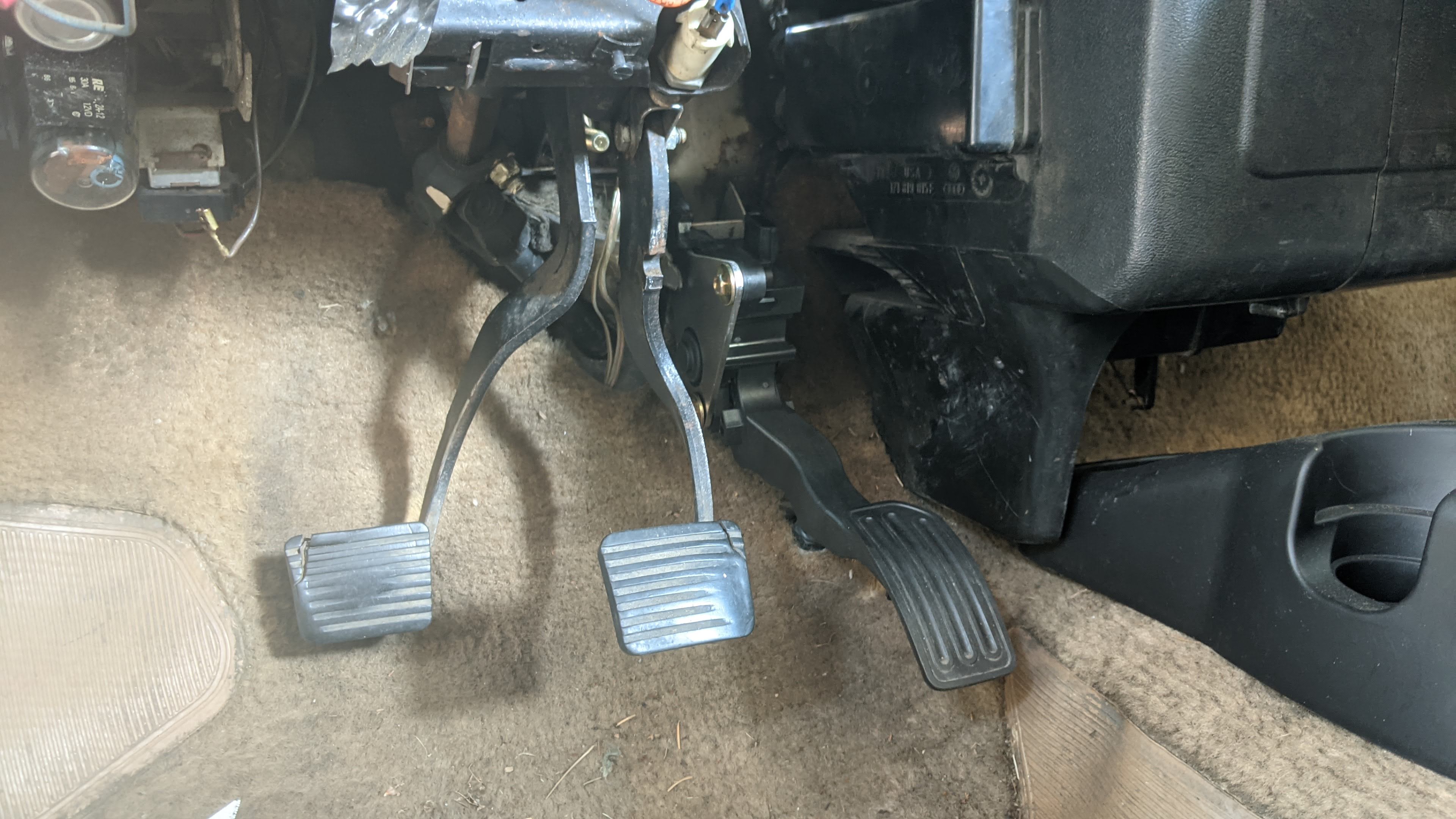

Leaf pedal proto and final bracket. GOT to design > proto > test > design > proto > make
installed in truck:

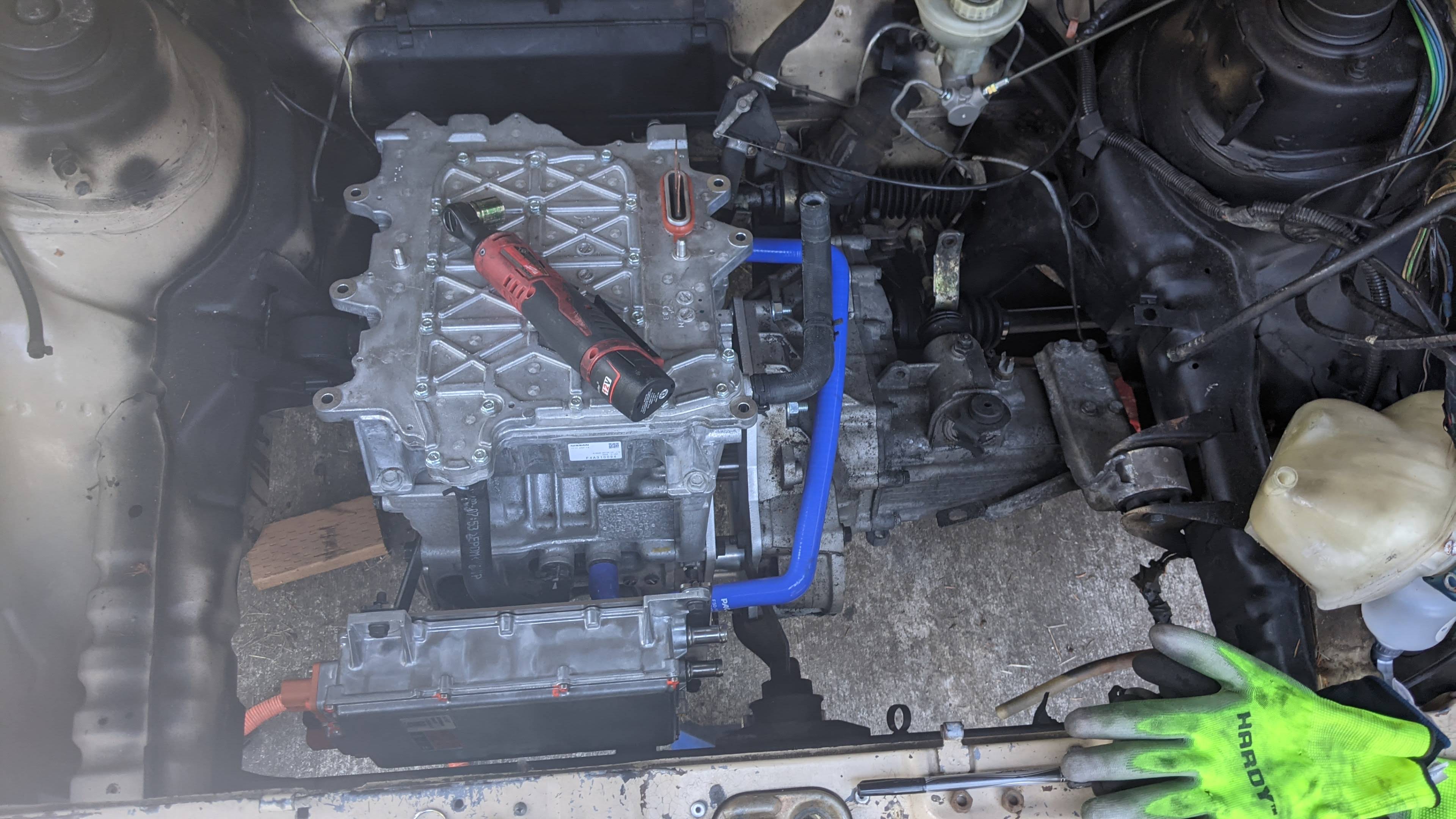

charge bracket mount to Leaf motor:
Installed:

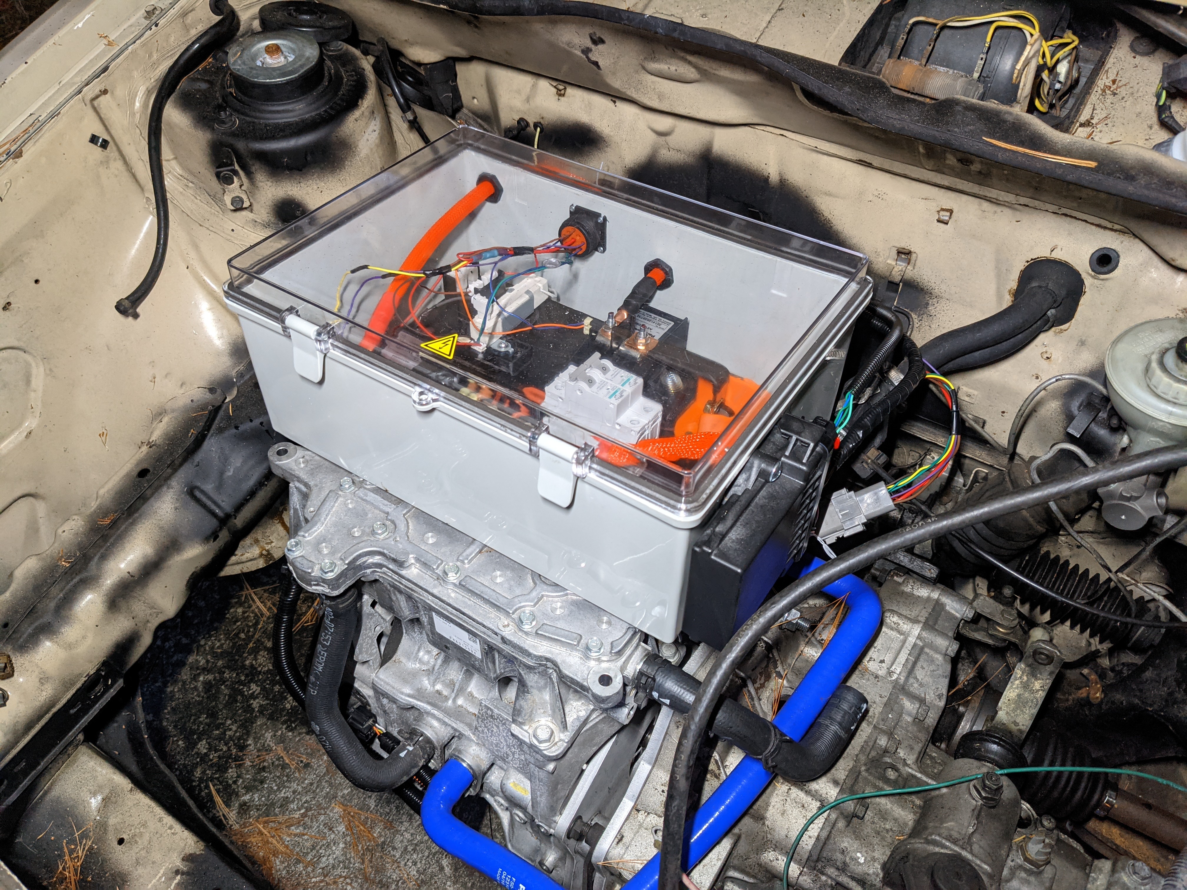

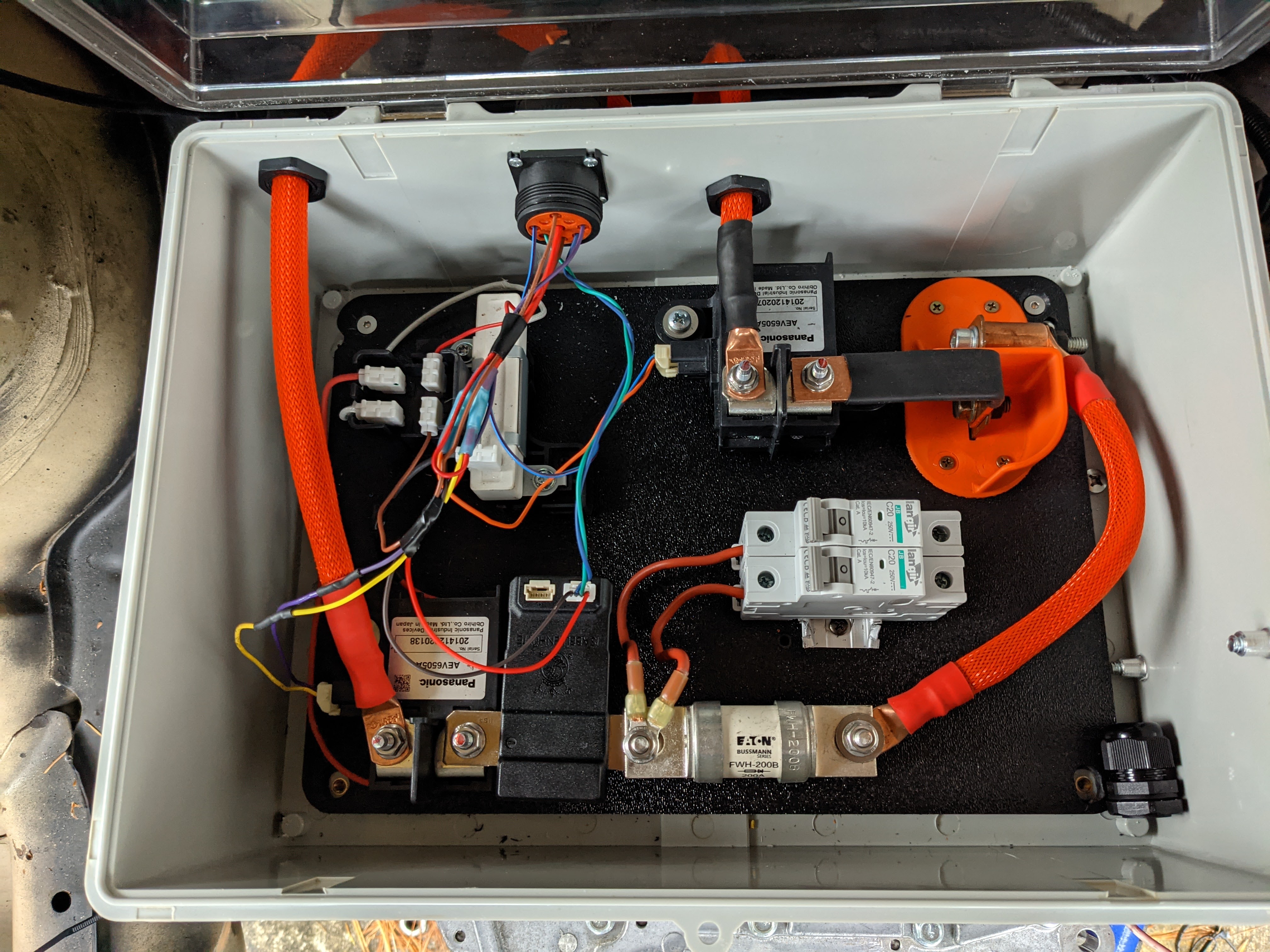

HVJB work has begun:
This is alittle large but i plan for it to contain:
1. HV fusing + distro (DCDC & Charger)
2. pos & neg contactors
3. Isa Shunt
4. precharge relay and resistor

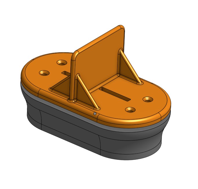

I've 3-d printed mounts so it will fasten directly to the top of the EM57 inverter.
Then the DC input to the inverter will be sealed via this 3-d printed assembly

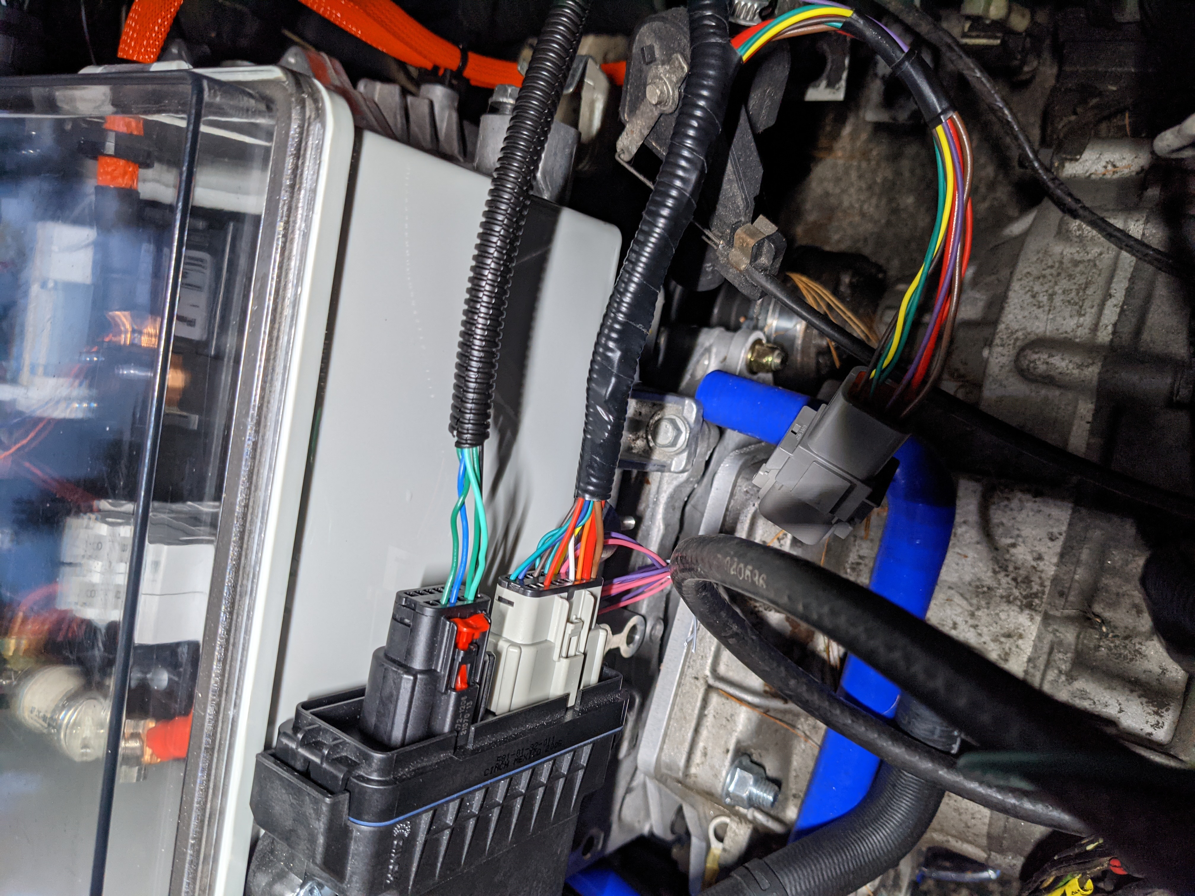

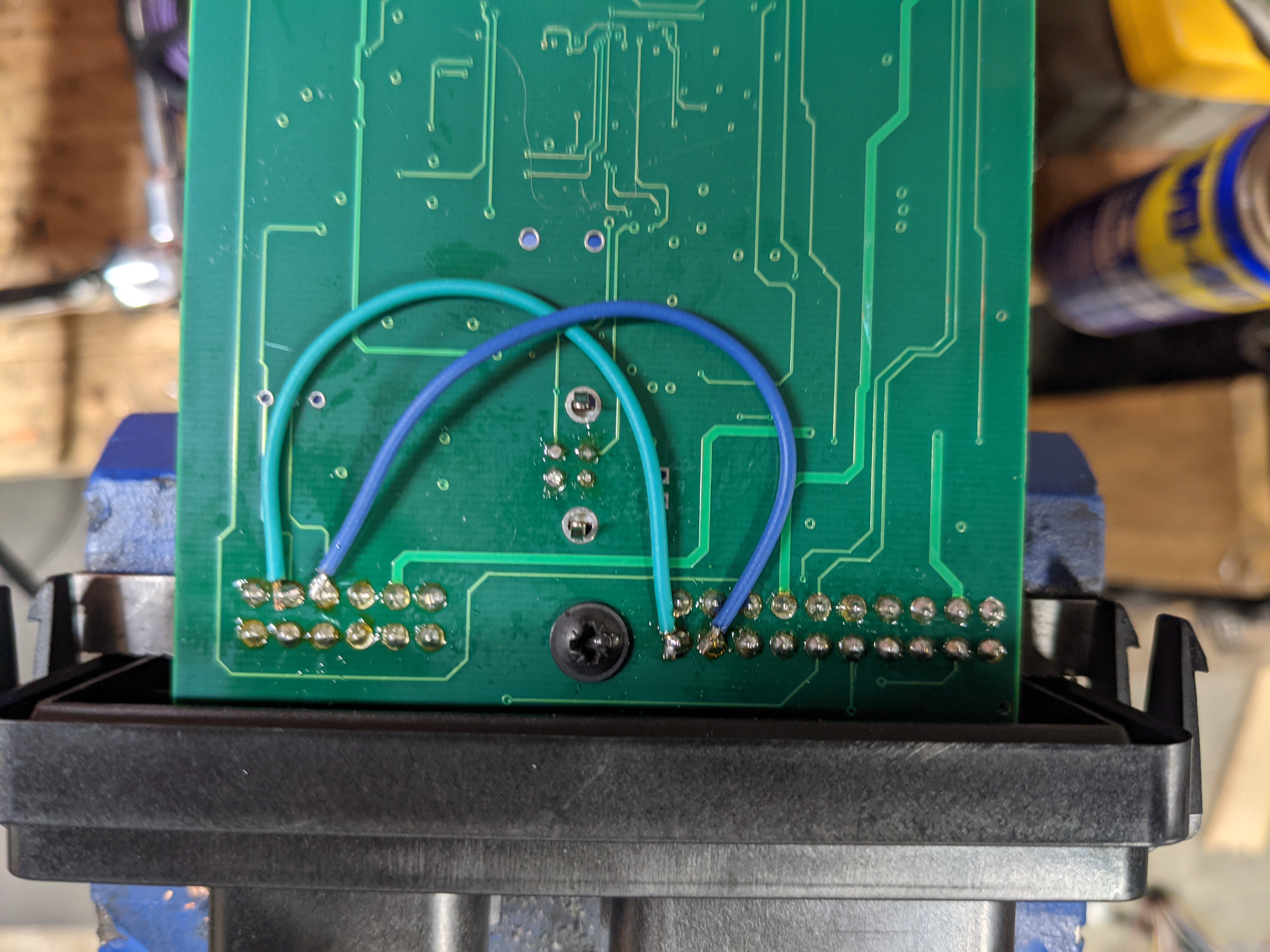

big update:
HV Junction Box is done, installed, and connected to batteries
VCU is wired to HVJB and leaf inverter.
VCU CAN jumpers from header 1 to 2. to connect the Inverter CAN with ISA Shunt communication to pins on HVJB header where ISA shunt resides. I plan to bring this up in the Leaf VCU support thread. It's my understanding that the ISA Shunt and Leaf Inverter share the same CAN bus. I'll have to look at Damien's code to confirm.

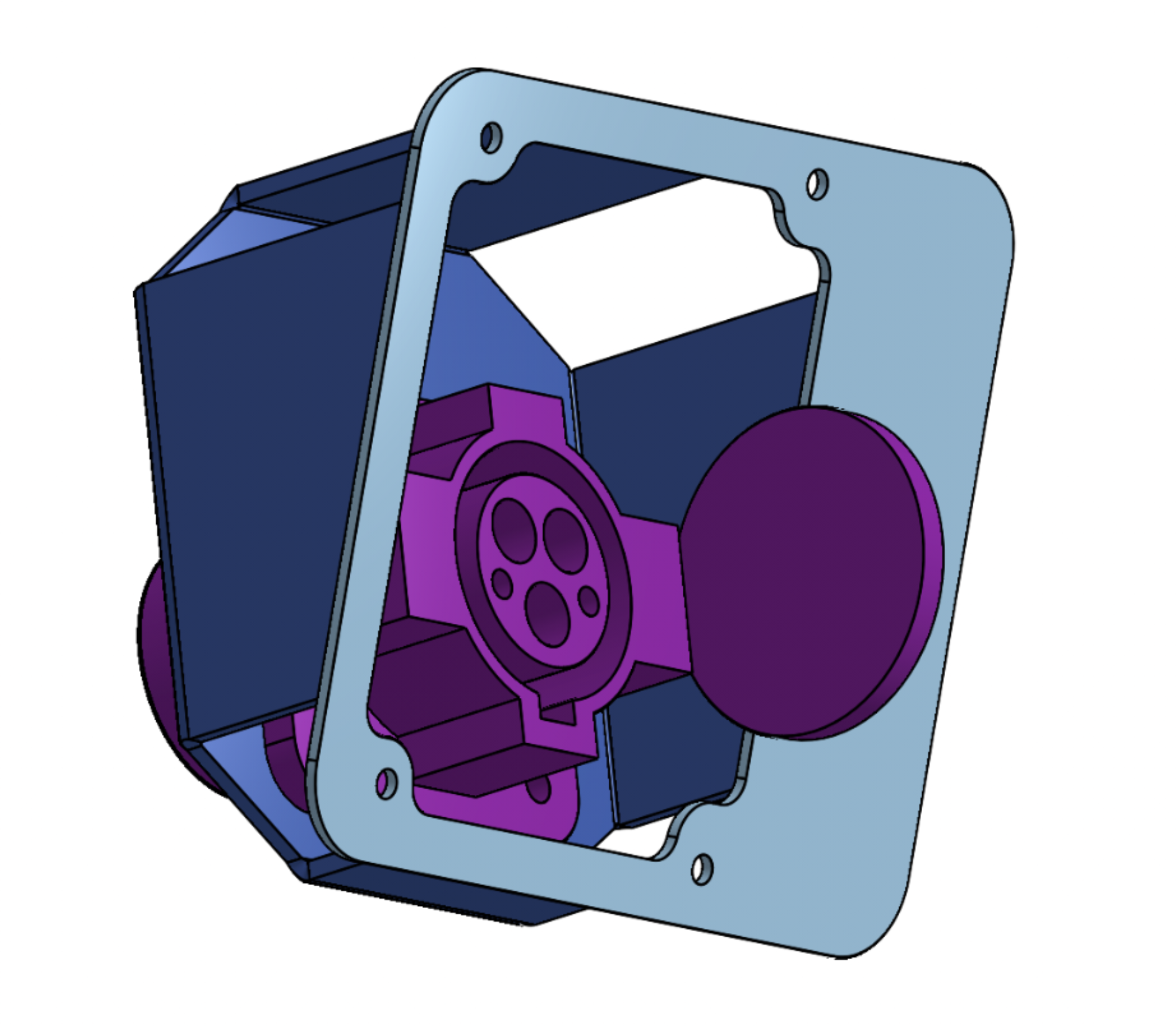

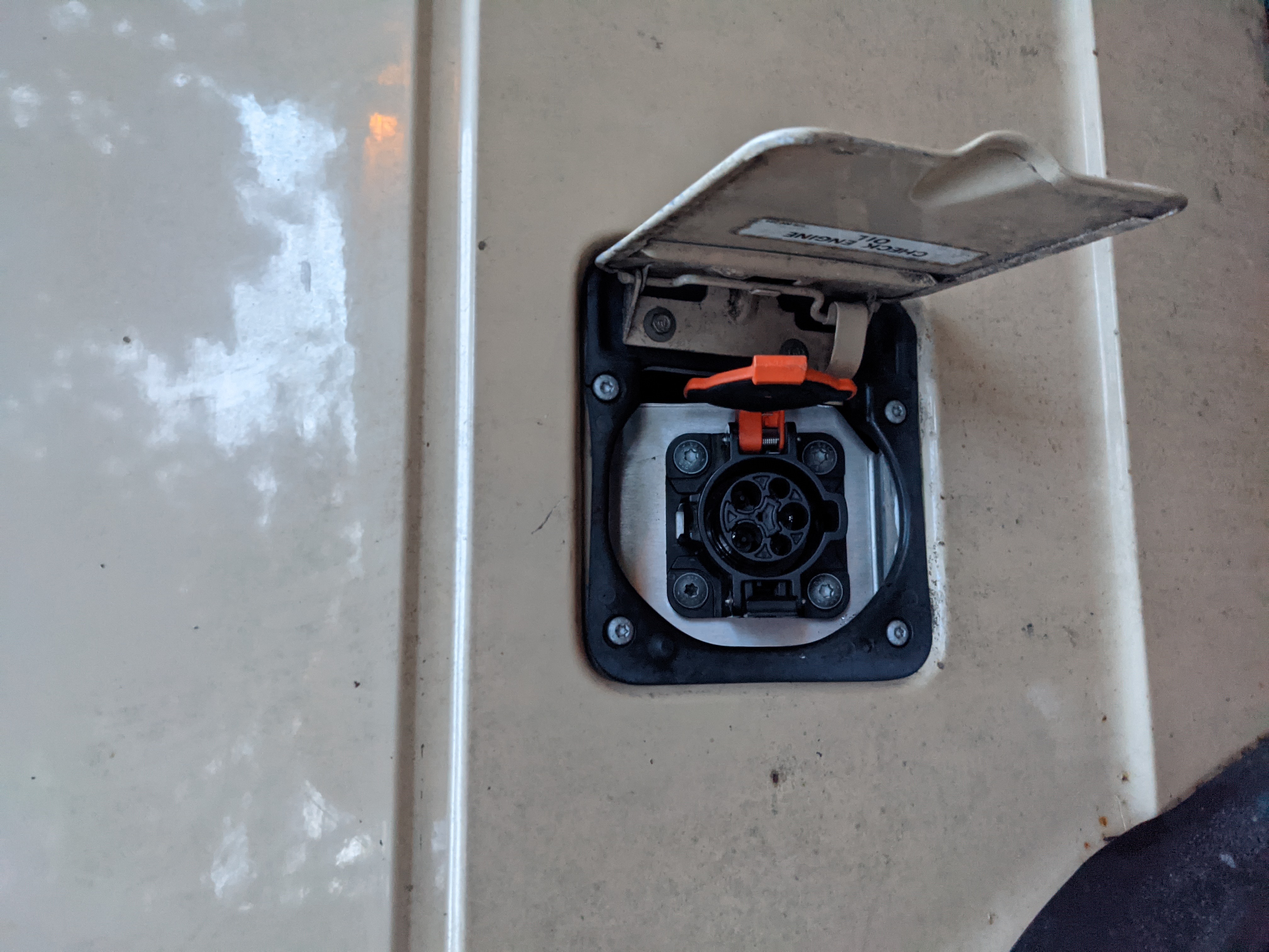

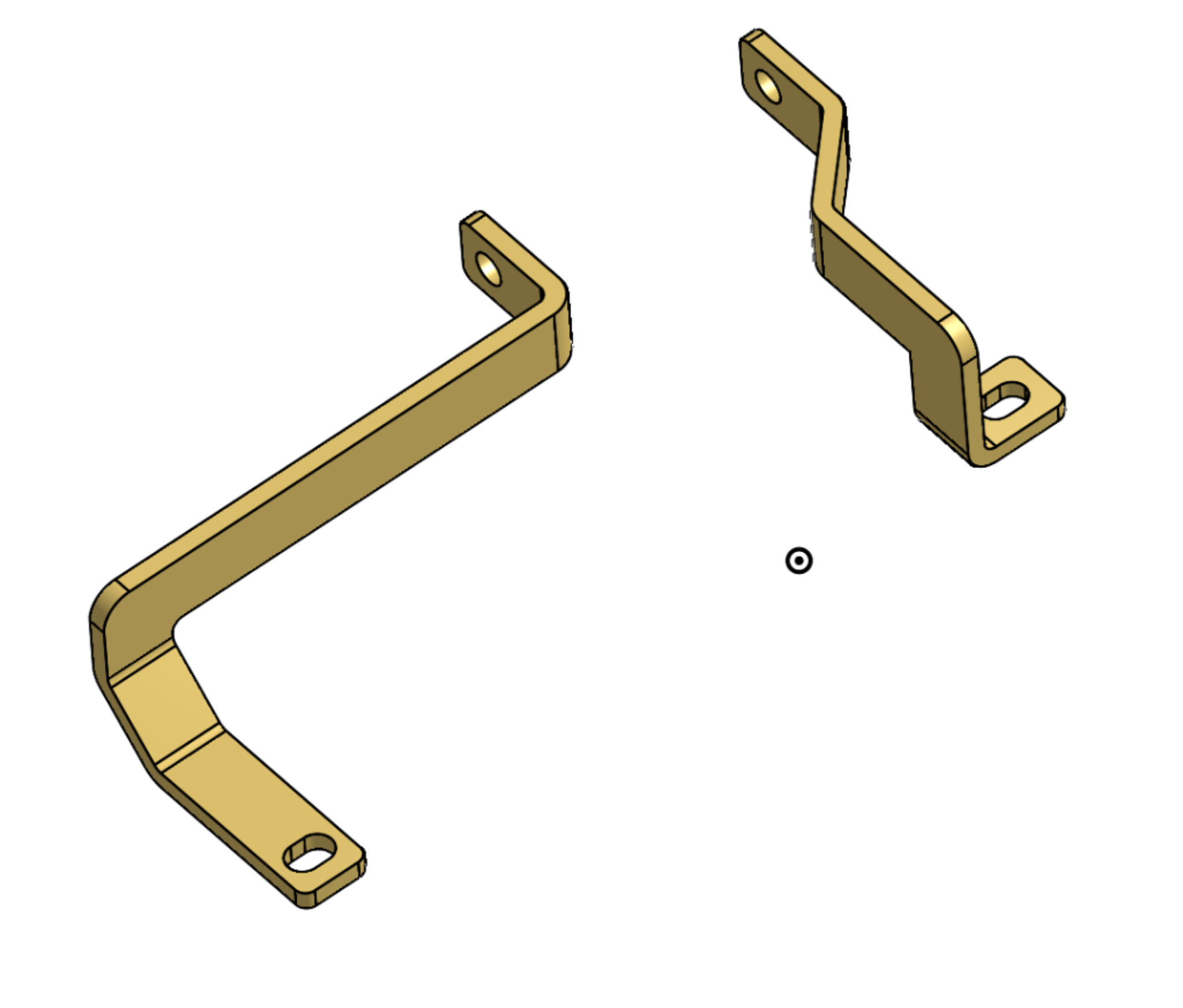

Charge inlet mounting designed and done

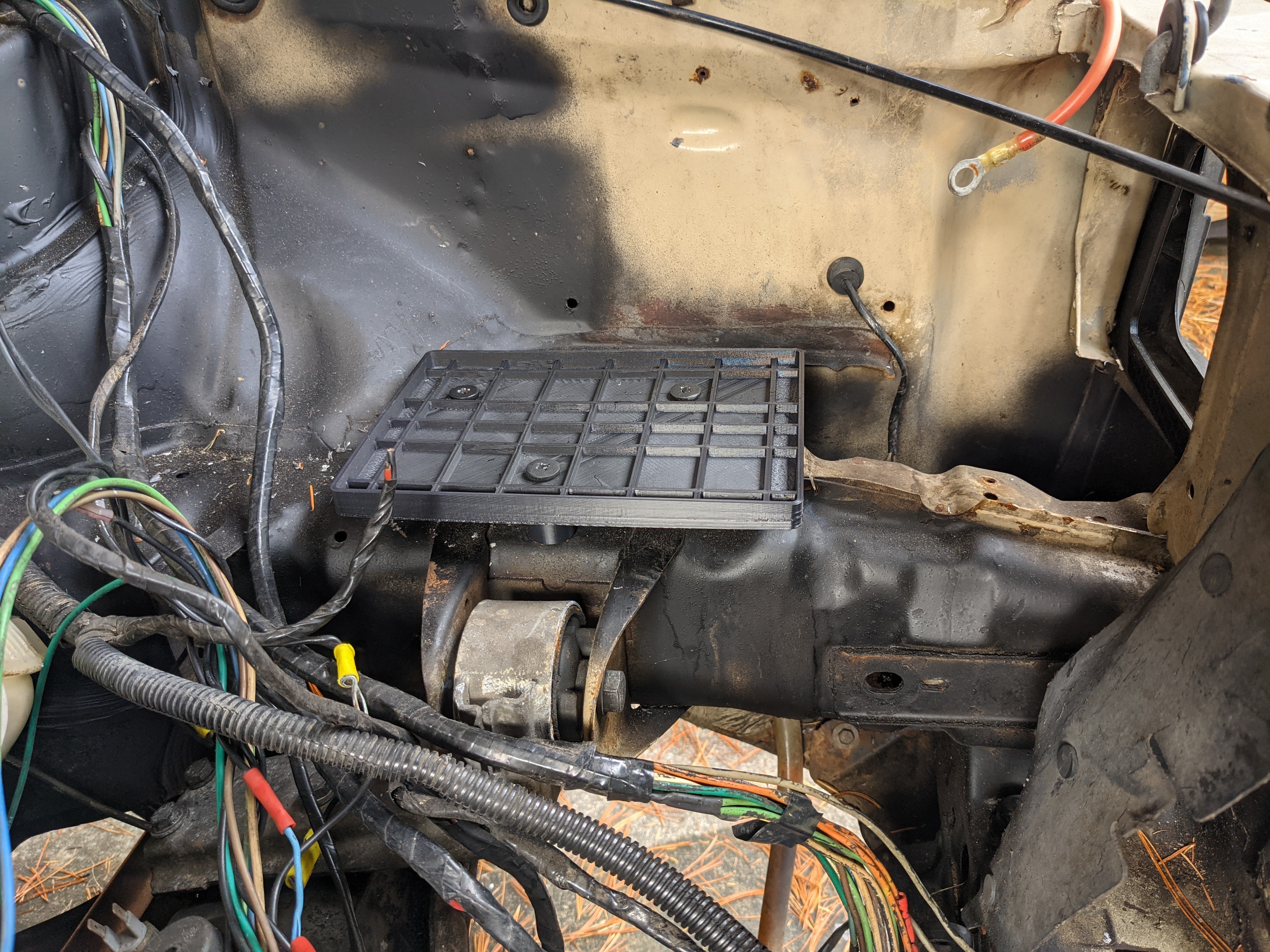

designed and printed a 12v battery tray for a LiFePo4 35Ah

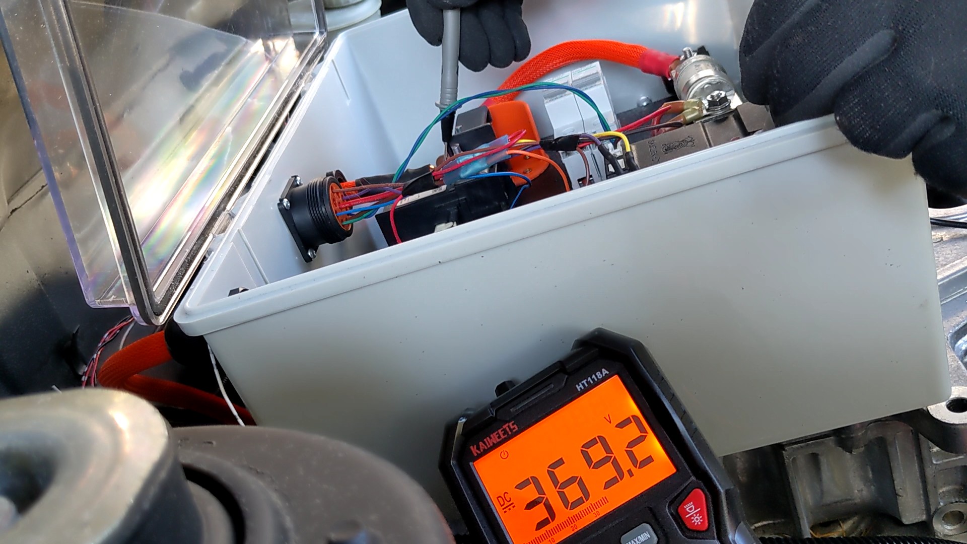

Post by vwbrady »
Kind of a big milestone. Full Voltage in the Junction Box.

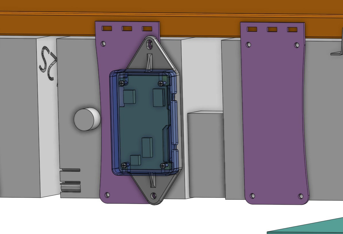

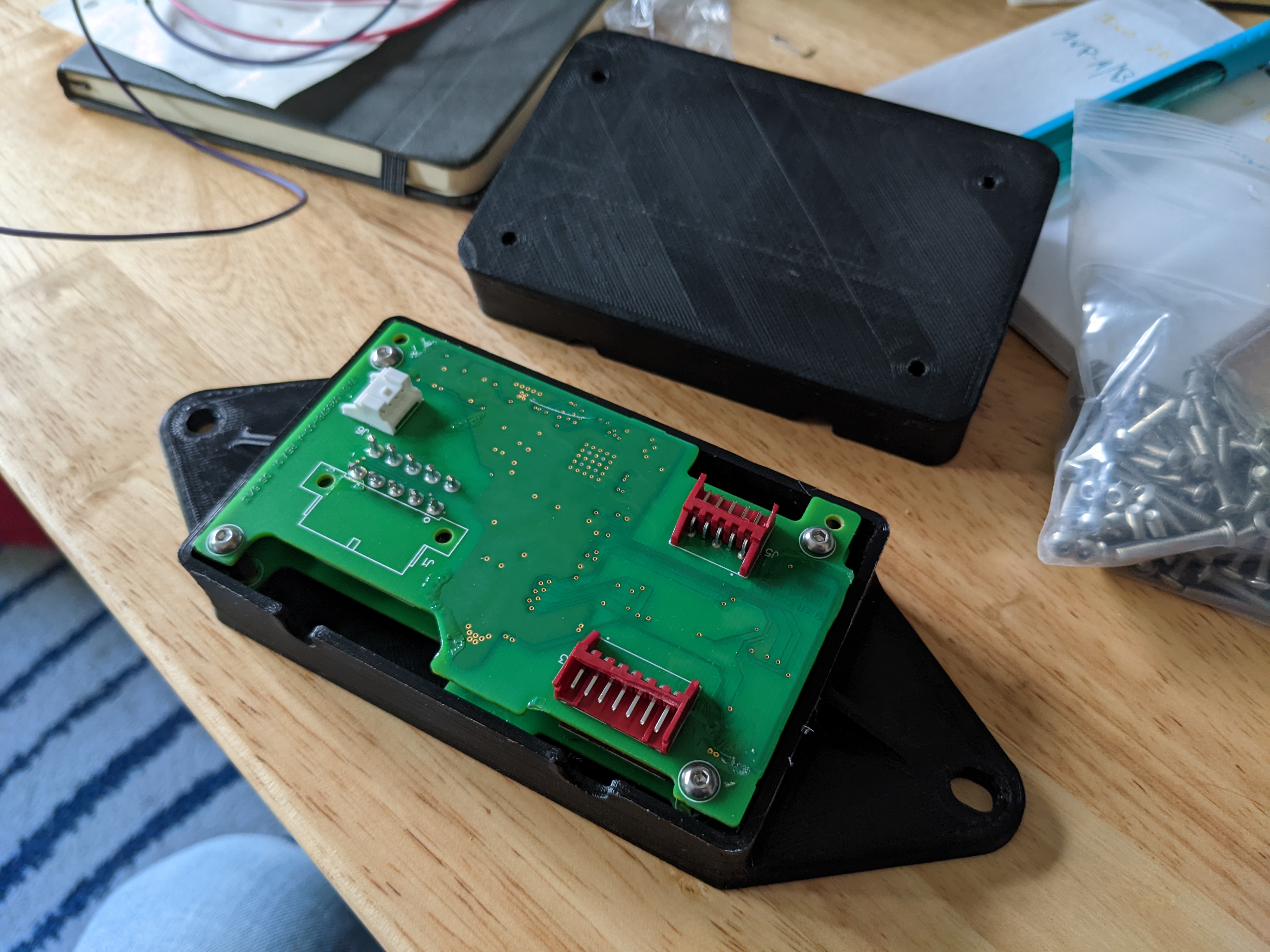

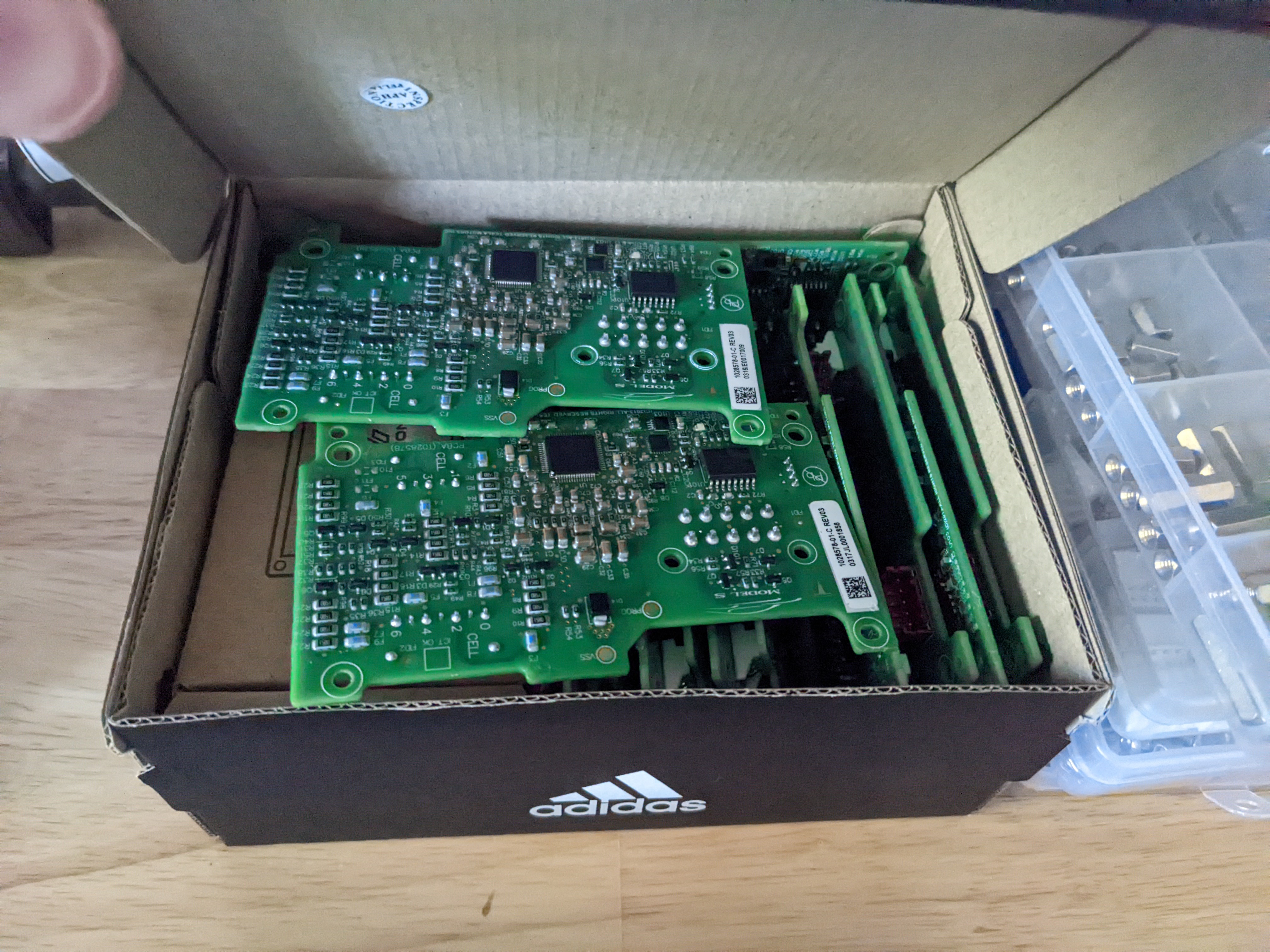

changing my BMS strategy. Was intending on using the Nissan Leaf BMS, but have since decided to go the Simp BMS + Tesla route.
You may wonder how, if I'm not using Tesla modules. Well i just bought a bunch of used Model S/X BMS boards off ebay and am going to wire them to my cells. Combining 2 boards get's me the 12S i need for each of my mercedes modules.
CAD:

Here is my first 12s sub-module test setup, contains 2 tesla boards:
They will mount to the side of my batteries like so:
