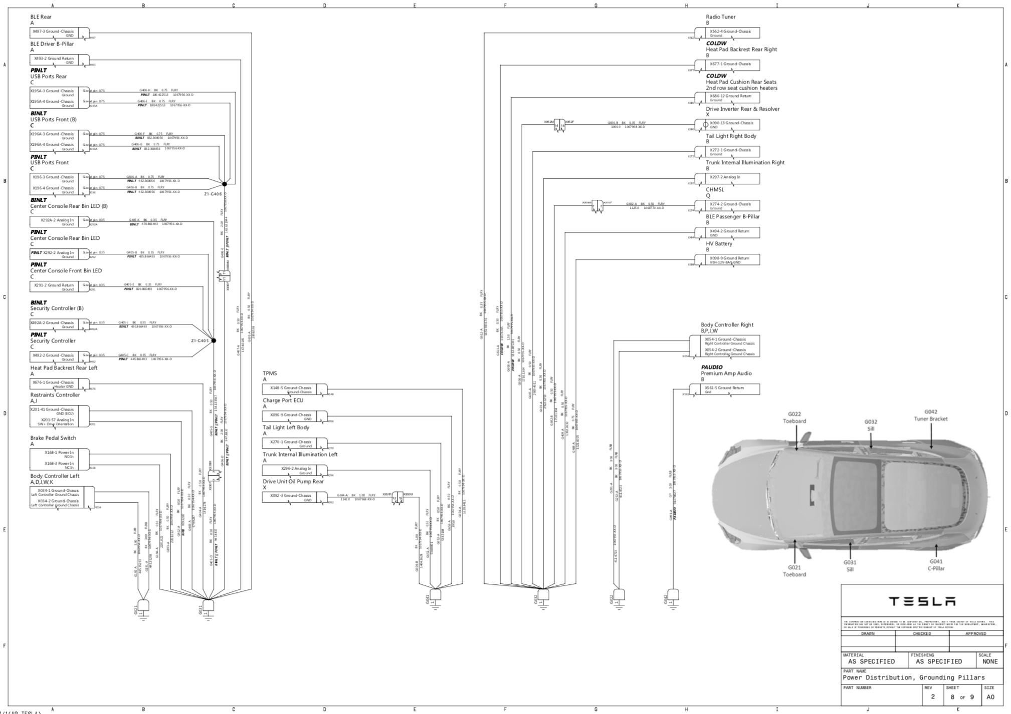

We've been discussing the possibility of reusing the Tesla CCS hardware/software in our conversions. It's early days but we believe that Tesla have at least two different "Charge Port ECU" that provide the CCS interface on European Model S/X and Model 3 cars.
The US Model 3 schematics show the "CP ECU" mounted close to the charge port (see item #2 in the Model 3 schematic).
I don't currently have European Model 3 schematics but if anyone does it would be good to confirm the architecture is the same :)

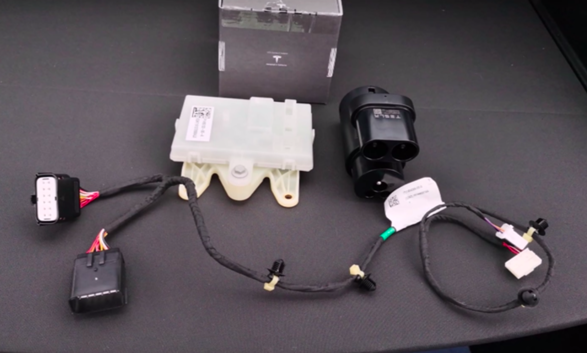

Here's the Model S/X CCS adaptor;

2018 Model 3 LHD schematics... a single CAN interface into the Charge Port ECU controls the Charge Port Inlet and Charge Port Door... if the European cars are the same then we just need to hack the CAN messages :)
Updated to include all schematics with reference to "Charge Port ECU"

Tesla Model S CCS upgrade kit.

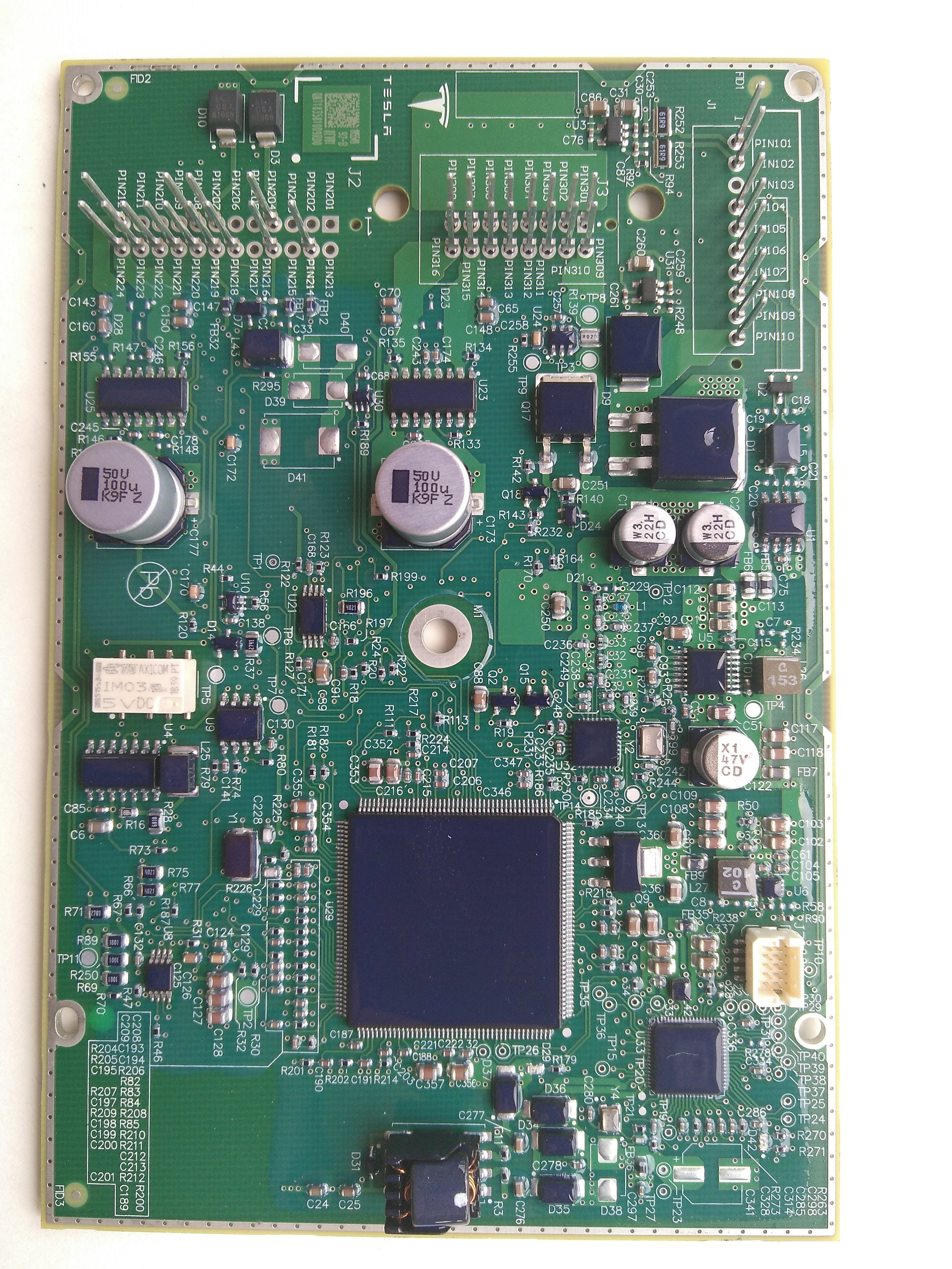

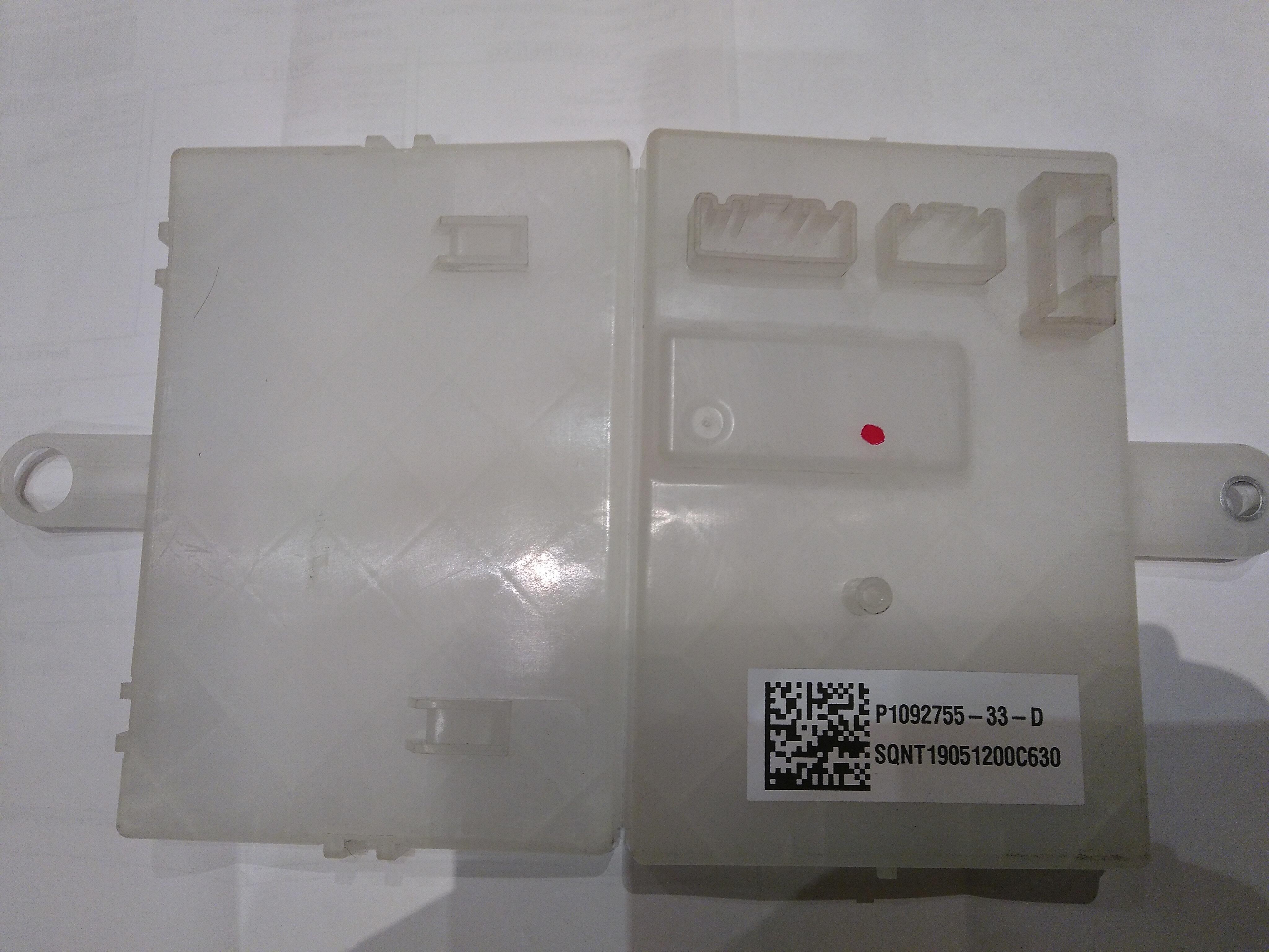

We now have the US and EU hardware in Ireland 8-)
The US Charge Port ECU is a single PCB mounted inside a plastic clam shell. It's clearly been designed for low cost assembly with connectors replaced by individual press fit pins and mounting screws with plastic studs which have been melted to secure the PCB.
ECU Part Number: P1092755-33-D
ECU Serial Number (?): SQNT19051200C630
PCB: FAB 1084808-00-DREV-01
Assembly Version (?): SAXE1PBB4F0 Rev F
The main MCU is a Freescale (NXP) SPC5605BMLL6 in a 100 pin LQFP package (14mmx14mm). A 10 pin connector J7 is mounted close to the MCU and may provide a JTAG port for programming/test.
The PCB is conformally coated and part numbers on other IC's are not visible.
The schematic posted for the US Model 3 (see above) seems to match the PCB pinout. The interface to the vehicle PCS (located in the HV Battery) is just three signals and one (possibly two) CAN bus's 8-)
I'll get some decent high res photo's when I get a moment... for now here are some from my phone;

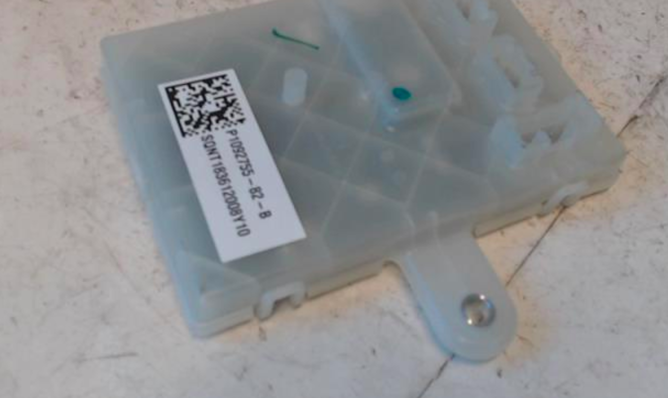

Kevin Sharpe
Posts: 1339
Location: Ireland and US
Been thanked: 8 times
Re: Tesla Combined Charging System (CCS)
Post by Kevin Sharpe »

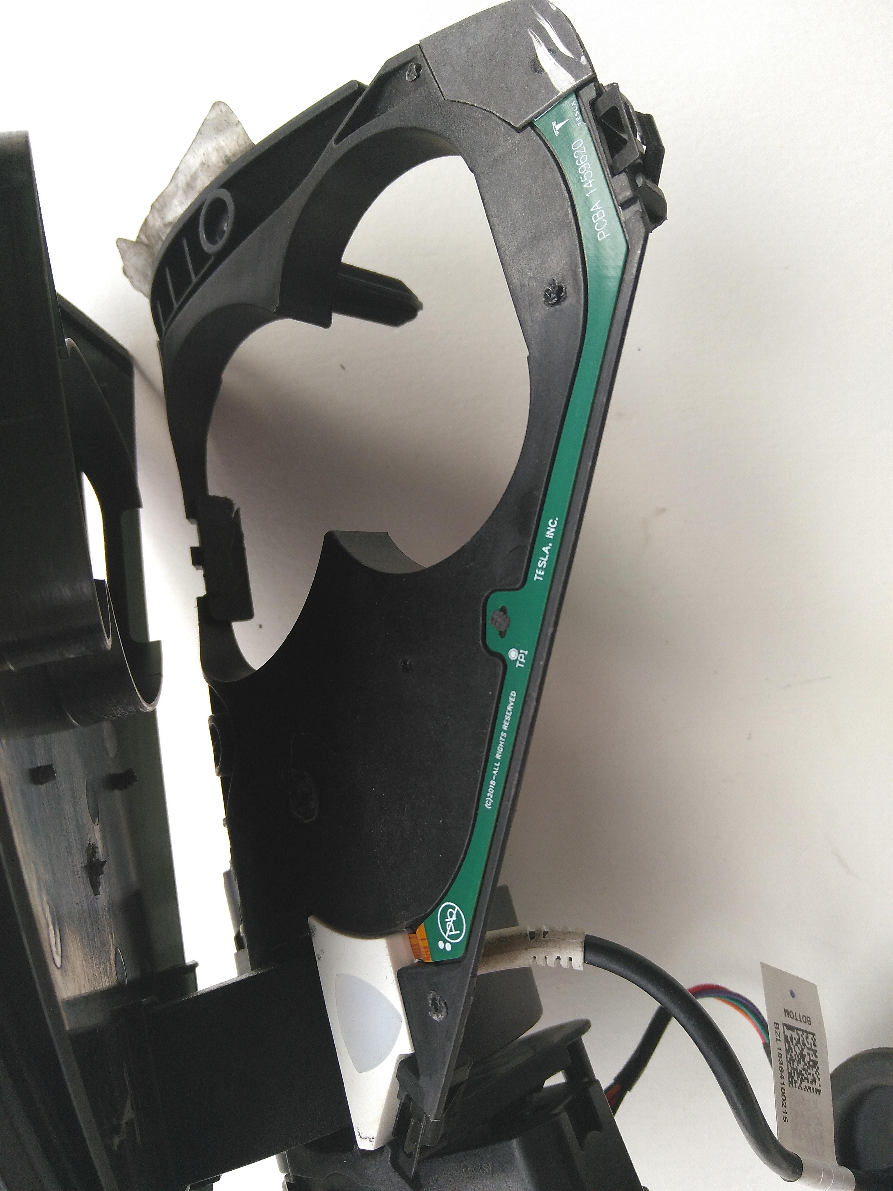

The EU Charge Port ECU is a single PCB mounted inside a plastic clam shell (same moulding as US ECU). The PCB design has many similarities to the US ECU although the board is larger.
ECU Part Number: P1092755-82-B
ECU Serial Number (?): SQNT183612008Y10
PCB: FAB 1084809-00-B REV-01
Assembly Version (?): SAXE1BB4B0 Rev B
The main MCU is a ST SPC56EC70L7 in a 176 pin LQFP package (24mmx24mm). A 10 pin connector J7 is mounted close to the MCU and may provide a JTAG port for programming/test.
The Home Plug Green PHY is a QUALCOMM QCA7005-AL33 in a 68 pin QFN package (8mm x 8mm).

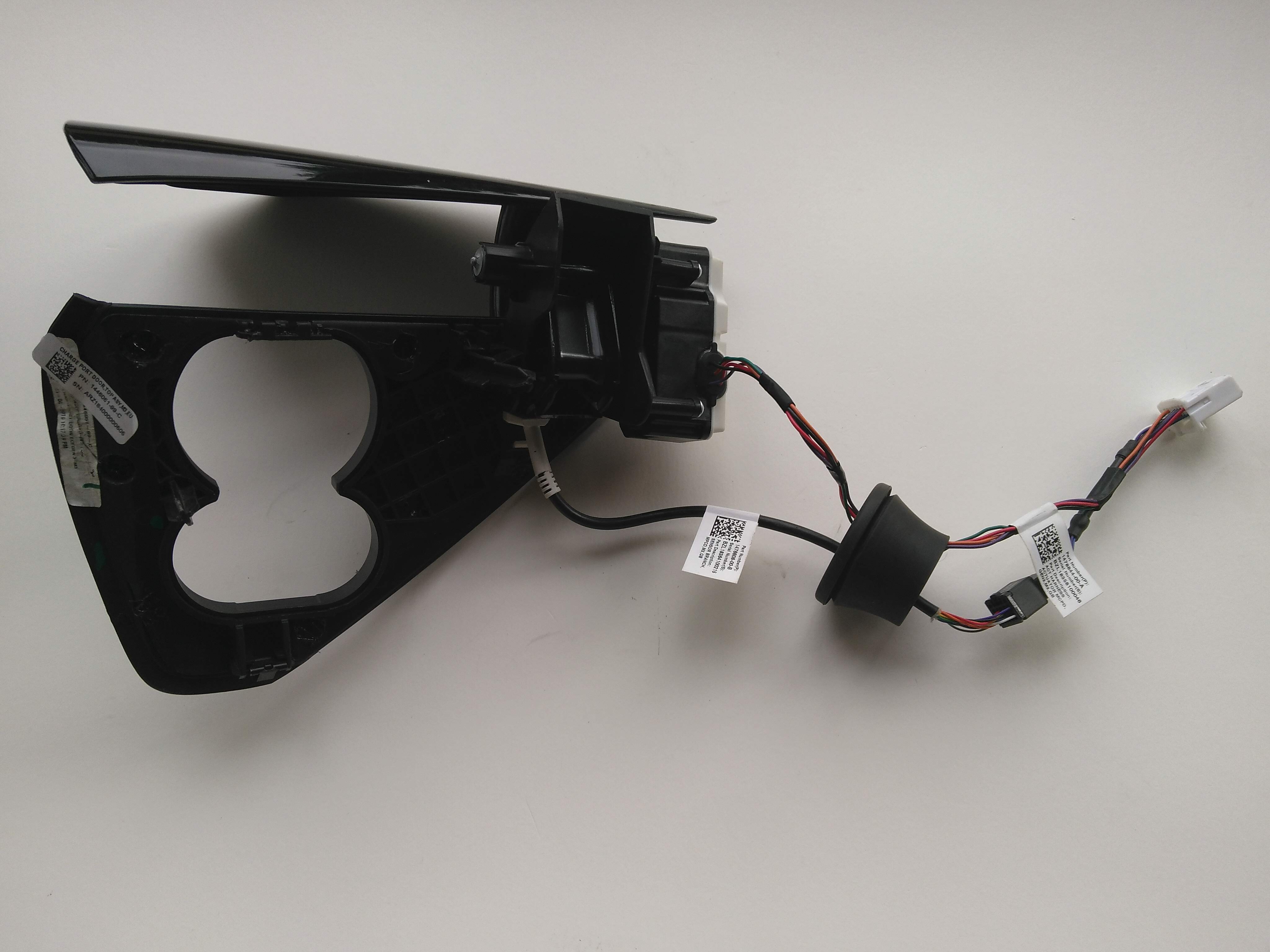

Kevin Sharpe
Posts: 1339

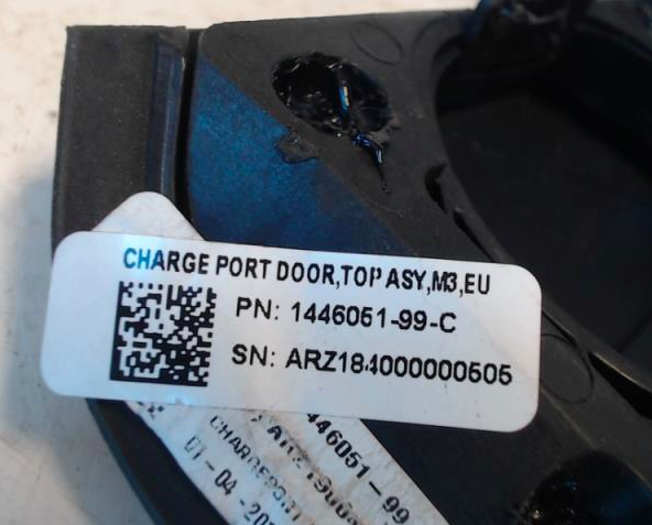

The EU Charge Port Door assembly appears to be very similar to the US version with the moulding for the charge port connector being the only obvious difference.
Charge Port Door Part Number: 1446051-99-C
Charge Port Door Serial Number: ARZ184000000505
The door assembly has four electronic functions, motorised door flap, LED status indicator, RF comms to key fob, and press to open detect.
The motorised door flap has a five wire interface which plugs into J3 on the ECU;
PIN05 - ANALOG OUT DOOR SENSE
PIN10 - GROUND RETURN GND
PIN11 - VREF INPUT 5V
PIN15 - POWER IN DOOR DRIVE 1
PIN16 - POWER IN DOOR DRIVE 2
The LED status indicator has a three wire interface which plugs into J3 on the ECU. The signals are active high, drive the LED's direct, and reference to PIN03 (GROUND RETURN GND);
PIN06 - POWER IN LED RED
PIN07 - POWER IN LED GREEN
PIN08 - POWER IN LED BLUE
The RF comms and press detect circuit (possibly a TI induction sensor given the LDC signal names) use the remaining five signals which plug directly into J3 on the ECU;
PIN01 - I2C SDA
PIN04 - I2C SCL
PIN12 - ANALOG OUT UHF
PIN13 - DIGITAL IN LDC_SD
PIN14 - DIGITAL IN LDC_INT
Power and Ground direct from J3 on the ECU;
PIN02 - VREF INPUT 3.3V
PIN03 - GROUND RETURN GND
Only one pin is not connected;
PIN09 - unused

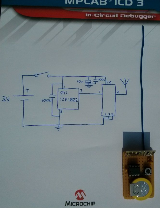

Open Source project for RF Comms button to open Model S charge port... 6 years old but will gives us some clues no doubt;
https://teslamotorsclub.com/tmc/threads ... ort.21001/
https://github.com/mstegen/Open-Chargeport
