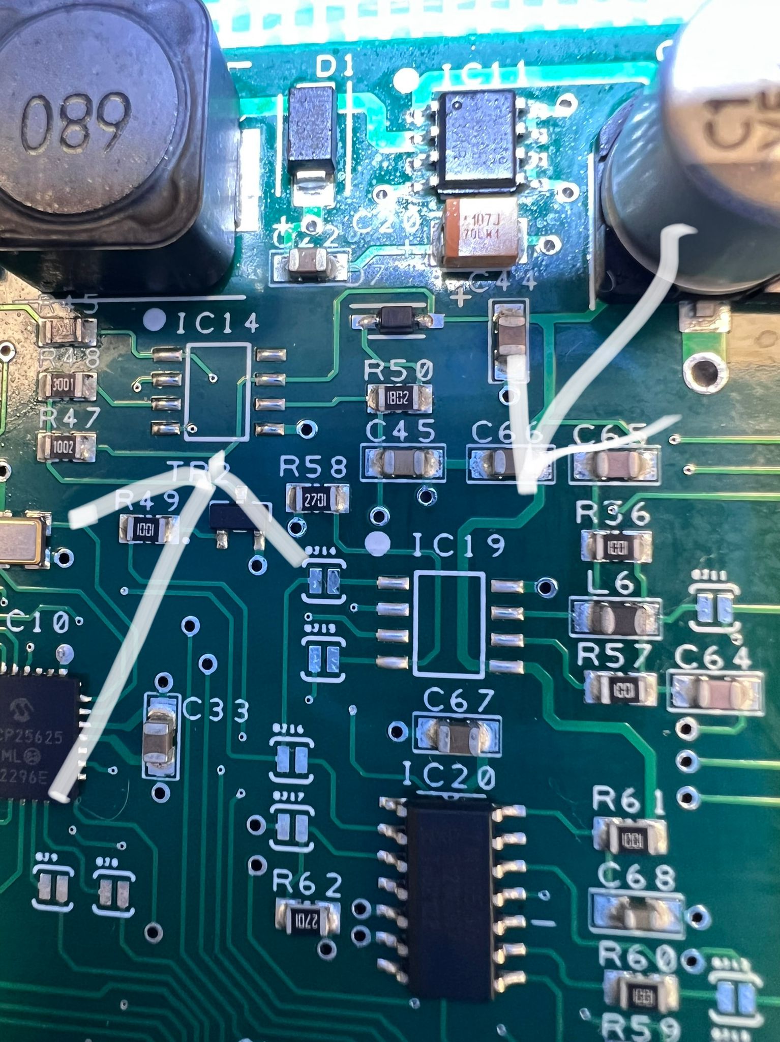

Quick chip query for the VCU. I'm getting some help soldering the IC's that came loose in the kit. There are two left, IC14 and IC19, and I might have a similar issue to a previous post.
This would be IC19, the NCV7356, but want to double check the orientation. No clear marker so which pin would align with the dot on the PCB, upper left pin as per the image below?
That leaves this chip for IC14, tried searching to see what it is as its not the TJA1020 or MCP2004 suggested as a replacement. Am I right thinking this is just the wrong chip for this kit, or have I misplaced one of the others!?

nkiernan wrote: Wed Nov 10, 2021 5:18 pm
Usually а chip has a slightly larger bevel on the side with the first pin (which is marked with a point on the board)
