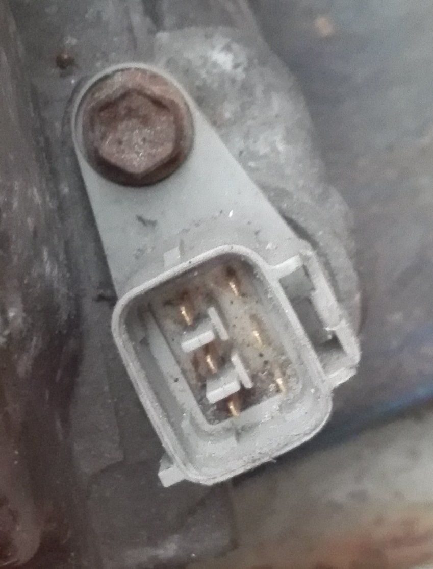

I don't know the specific connectors, but I'd try looking at Sumitomo connectors on auto-click.co.uk, they have fairly good photos of the common ones. I might actually want to order elsewhere though as I still don't have much faith in the changed British customs stuff.
Been thanked: 1918 times
Re: Audi A2 /w Prius Gen2 Transaxle & Inverter
I think it could be Yazaki. They look very similar but I only found the correct keying in the Yazaki
The other resolver, the temperature sensors and the two jacks for A/C and DC/DC converter look to be the same.
https://www.auto-click.co.uk/6-way/yaza ... ct_id=1113
Received the connectors and they fit. Added to wiki

Can you confirm if this pinout is correct for MG2 resolver?
I cant spin mg2 on throttle. Searching all the wiring for issues. Potnom does not rise.
