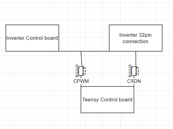

Re: Prius Gen2 Adapter Board for CHARGING
I think my battery connections might have something to do with it. I was bypassing the original stock battery inputs on the positive side and going straight to the HV bus. This makes sense in terms of driving a motor of course, it also makes sense that I am always seeing current and voltage since I was connected to the HV bus, so of course I would.
But it all the videos I have seen on charging the battery connections being used were the stock inputs. So I moved my battery connector back to the stock input. I'm thinking the boost converter I am by passing is kind of important for charging? Or do I have that confused?
This time I get no voltage at all on the stock battery inputs. So this feels like progress, I'm going to keep going through the processes, just confirm the signals are all correct and present.

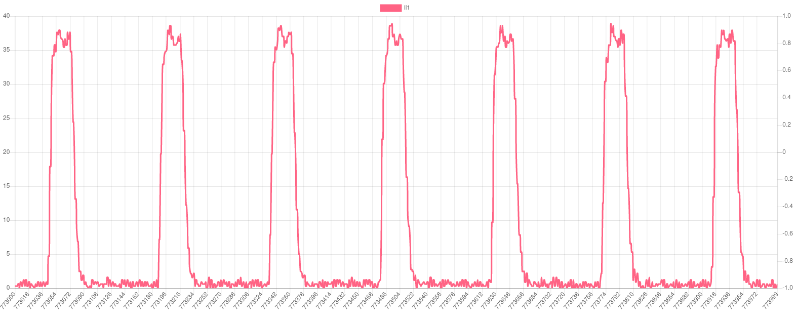

I think it's working in a manner. Rechecked all my connections just to make sure.
What I get too now is the HV bus precharged, all contactors closed and CDSN/CPWM pulled high.
Then I can set buck in the web interface, and manually pulled CSDN low. When both of those are done it starts making a different noise and the EVSE isn't very happy, clicking on and off. I do however get some voltage on the stock battery inputs.
The UDC voltage is as shown. I'm thinking CPWM is pulled the wrong way and the high side IGBT is on, shorting the EVSE. That would cause it to keep trip out and hence lower the voltage? I id try to bypass the 470 ohm resistor on CPWM to give it full 12v but that made no difference.
Shorting CPWM to 12V AND connecting it to the control board can easily blow the output driver. Please check if you still see a valid waveform with CPWM pulled up.
CPWM pulled high and CSDN pulled low (or floating) will close the LOW side transistor, shorting the battery input (the stock one). Pulling CPWM low (or floating) will close the high side transistor thus connecting DC bus to battery input bidirectionally.
CSDN pulled high disables both transistors.
No quite sure what you connected where, schematic would help
- Posts: 577
- Location: Somerset, UK
- Has thanked: 78 times
- Been thanked: 231 times
Not sure why I decided to by pass the resistor on CPWM now, I think I got confused with CSDN which isn't so clear if it needs a resistor or not. How do we check for a valid waveform?
I was of the understanding that CPWM needs to be pulled high at all times during charging. Then CSDN is pulled high to start with and then left floating or Low to start the charging process.
This is how I have connected CSDN and CPWM, the Teensy control board sends 12v via resistors when needed and leaves them floating when not.
Finally succeeded somewhat with boost mode charging via A/C inverter. When I say inverter I have to say I threw out the IGBTs and replaced them with a standard rectifier. Managed to reuse 3 PCB holes, the 2nd AC input goes directly to a terminal block. Also bridges the emitter resistor as it was blown anyway.
So now I can charge directly from the grid but the current waveform is not pretty. Have to research this further, in my "poor mans charger" it looks way better. BTW the currents are off by a factor of 5 because the charging current sensor has a different gain. The setpoint is 10A (2A real) but the overshoots are 40A.
The DC-DC converter also operates happily from rectified AC.
CPWM is pulled to 12V via 499 Ohm. CSDN is connected to the DC switch out (so 12V with switch off, GND with switch on). So it activates simultaneously with the positive DC contactor.
