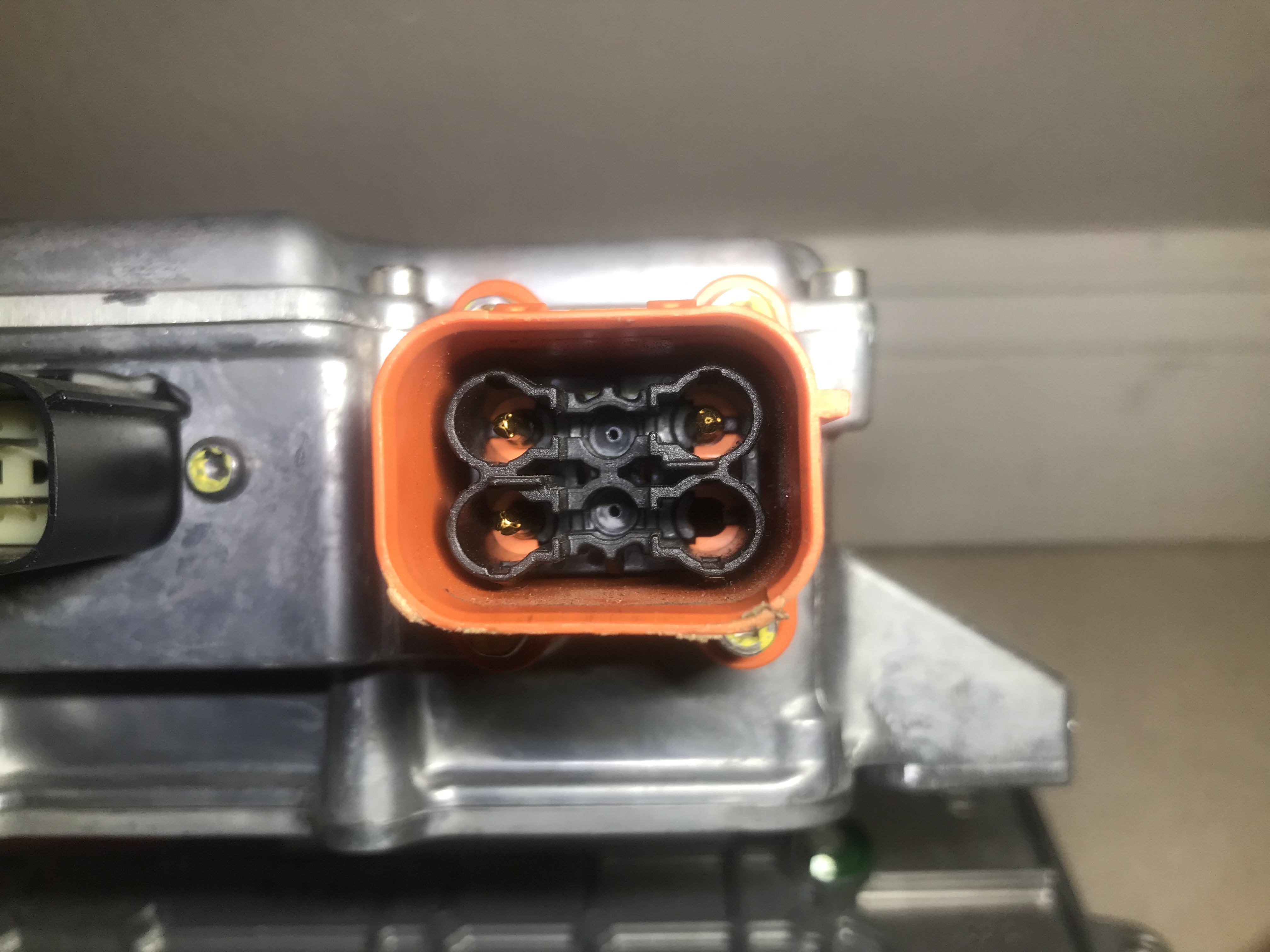

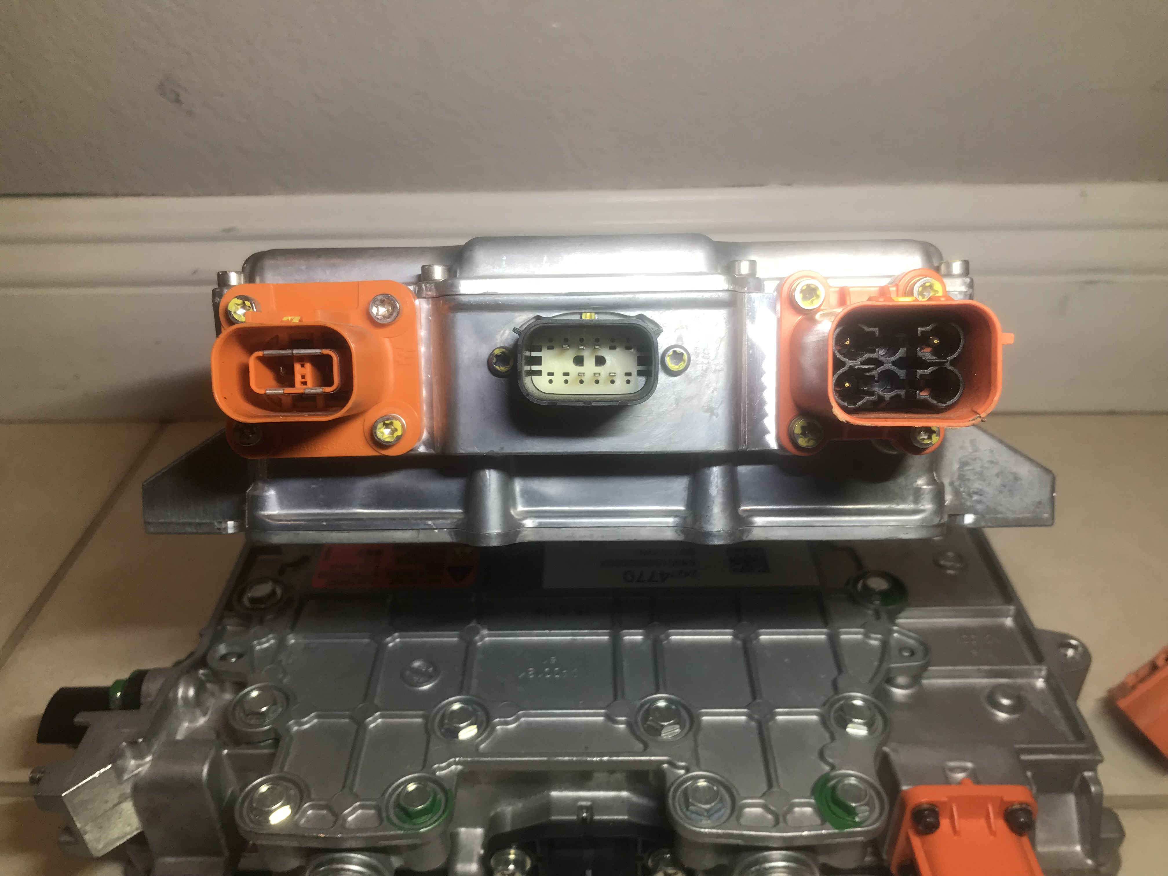

I've looked high and low but I cant find anywhere the pin layout for the GEN 2 battery charger control plug.
Can someone tell me where Pin 1 is? Or better yet a link to a pinout somewhere would be awesome.
I checked amber's blog and he describes the pins but I really could use the pin layout.

Ok, i am away from PC now and cant do much. But observe in my blog how i used all black wires with numbers and single green/yellow wire. Well that is P2 GND (black wire in your photo) wire. P1 is not populated and then you can count wires from there. You only really need 4 wires P2, P4, P9 and P11.
I think you can also download molex connector datasheet to see pinout distribution.
I will draw a schematic when i am home...

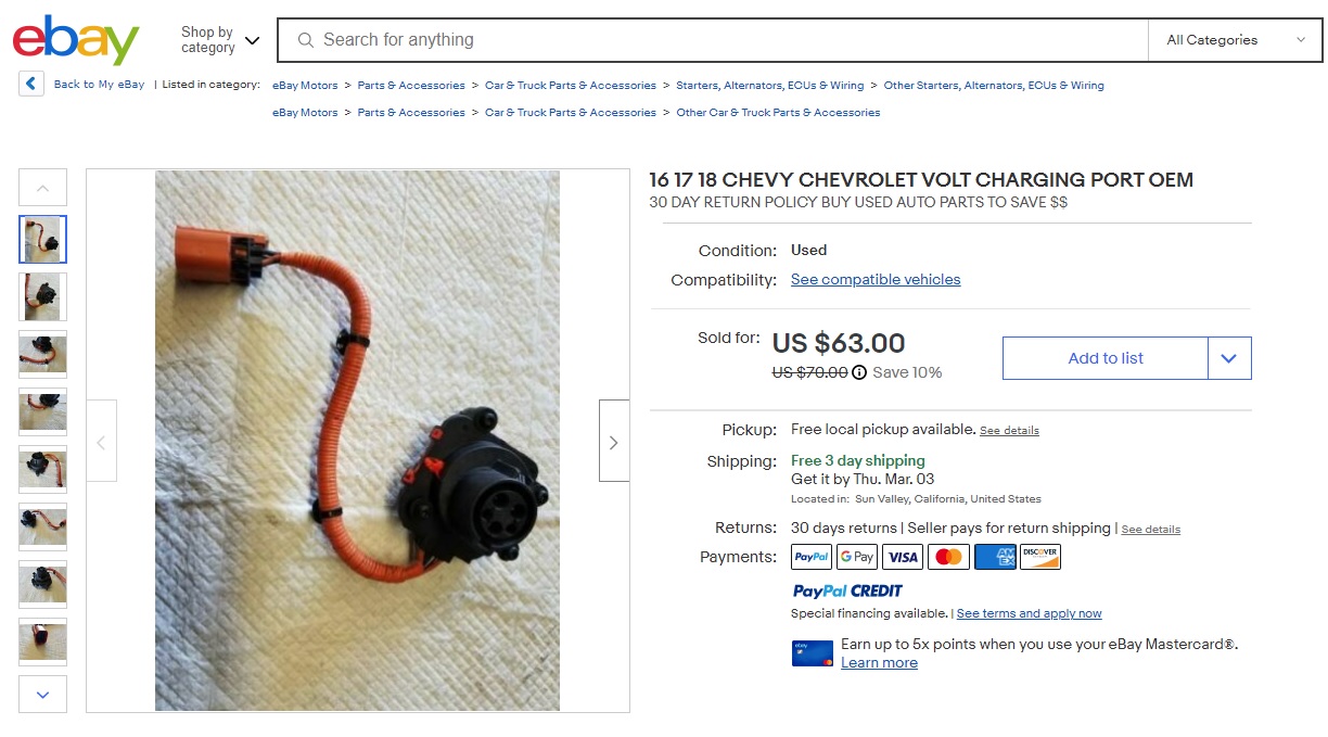

just got my second gen Charger/Converter set on eBay, sharing the charger listing (items were purchased separately) to show folks what they go for as of the current date, brace yourselves for death by a 1,000 questions, ha ha
Part Number: 24281923
Supersession(s): 24277705
Part Number: 24291446
Supersession(s): 24275451; 24286781
https://www.gmpartsmog.com/p/75741768/24291446.html
