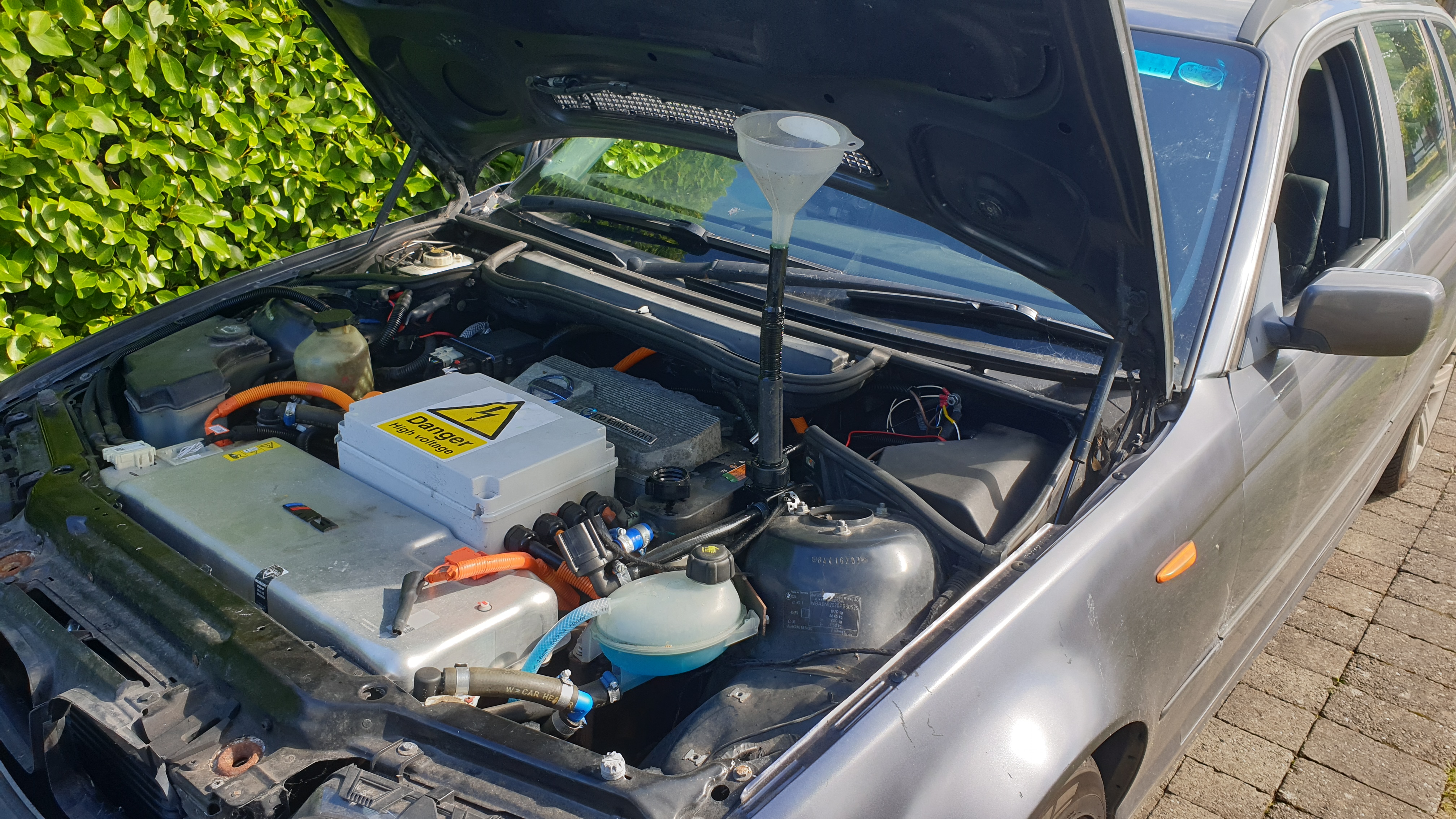

Not done many updates on this thread so here are a few bullet points :
-CCS fast charging working with i3 LIM
-New production version of ZombieVerter VCU fitted and running.
-Ampera heater running as of today integrated with E46 climate control via vcu.
-10k miles covered.
-Recently drove across ireland and back on CCS (approx 600km). No batt temp issues despite the internet's concern.
-M3 pcs running fine
-Recently got donated a set of E46 330i front brakes so will be a nice upgrade.

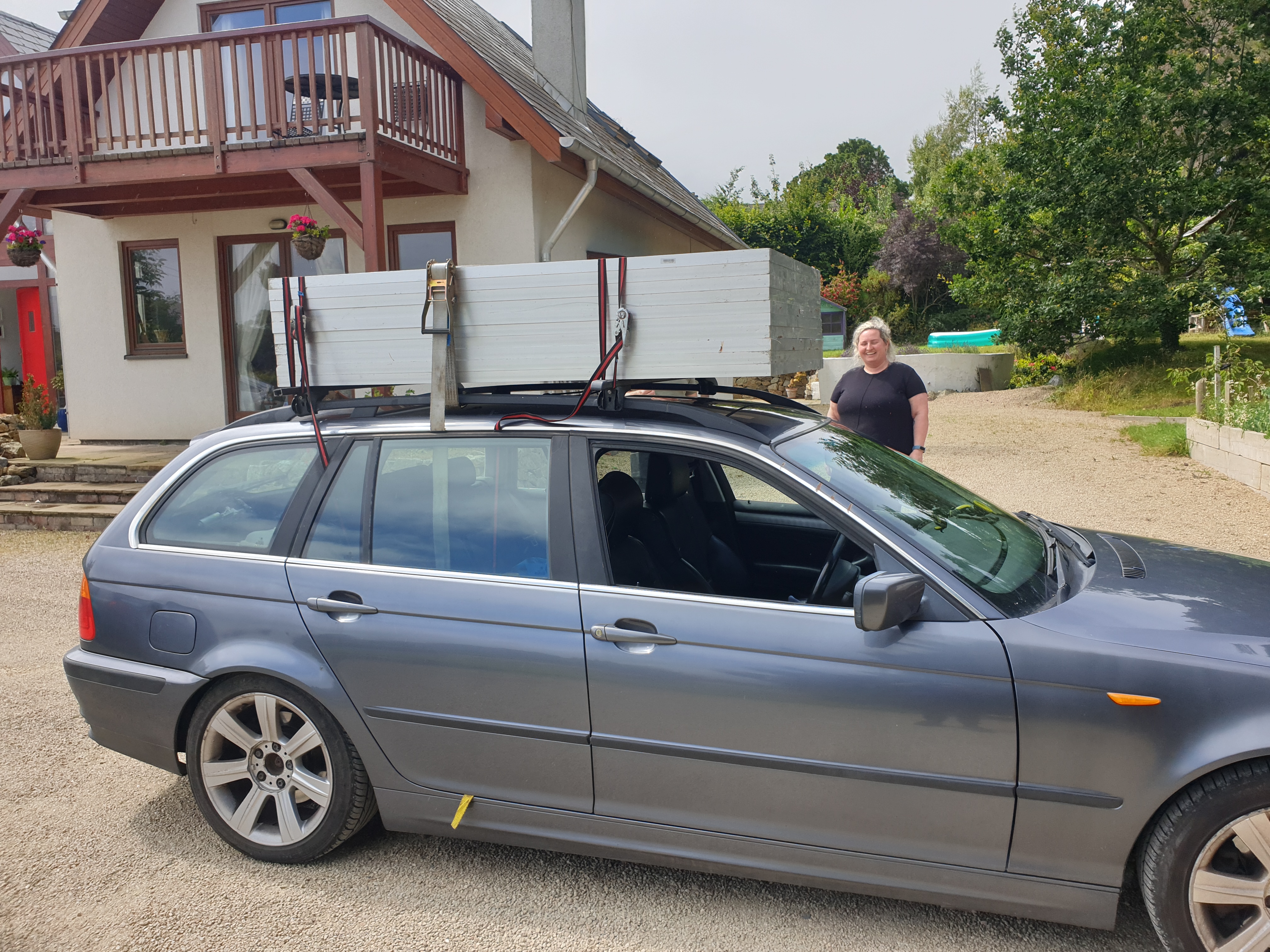

Posts: 3639
Has thanked: 9 times
Been thanked: 280 times
Re: Nissan Leaf Powered E46 Touring
372 miles , 9 ccs fast charges and an amazing donation of 10 x 250w solar panels from a forum member. The goose yet again prevails over such meager obstacles as having its frontal area doubled :)
