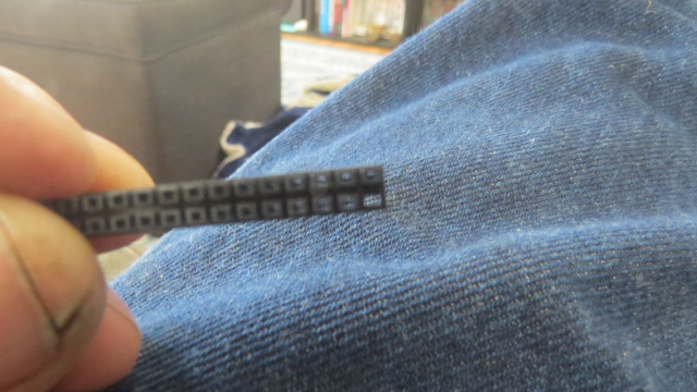

I just received my newest Gen 2 board. Couple questions. Is the new firmware in it? The other question is about the 30 pin connector. I ordered the suggested part number but when receiving it the number 1 terminal has been deleted. Damien uses the number one pin so can I just flip it around so the missing pin is on the opposite end? It looks like there's no connections there if it's just a 2 layer board.
- EV_Builder
- Posts: 1205
- Location: The Netherlands
- Been thanked: 37 times
Yes that's correct. You flip it.

Yes, see this image from the wiki, pin 30 is not needed:Roadstercycle wrote: ↑Tue Nov 16, 2021 9:00 pm I just received my newest Gen 2 board. Couple questions. Is the new firmware in it? The other question is about the 30 pin connector. I ordered the suggested part number but when receiving it the number 1 terminal has been deleted. Damien uses the number one pin so can I just flip it around so the missing pin is on the opposite end? It looks like there's no connections there if it's just a 2 layer board.

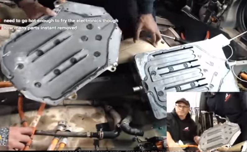

We considered drilling and tapping an extra bleed screw into our Gen2 charger because of our positioning (sideways & upright & high in the cooling circuit).
So we X-Rayed one!
Added picture to the wiki: https://openinverter.org/wiki/GEN2
So we X-Rayed one!
- Posts: 6761
- Has thanked: 383 times
- Been thanked: 1581 times
Interesting! So current flows top to bottom I guess. Grid filter (2 common mode chokes) PFC stage (two more chokes), TO-247 transistors mounted on the side of the module. Then capacitor bank, transformer, output filter.
Not so easy to see the waterflow.

Wow this is great! Do you have a link to the video? Who is the guy in the picture?
Not sure i snipped it a while ago. But if I'm not wrong it was "Rich Rebuilds" on YouTube
