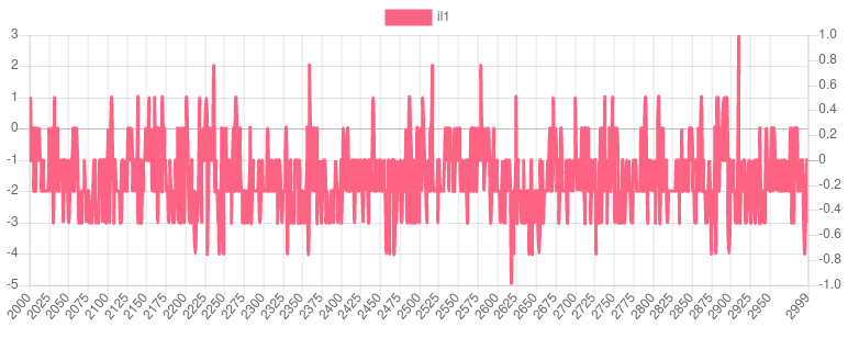

It has become physical :)
Tested it on the i3 inverter and it seems to work. It also seems that ADC readings are less noisy, like 8 digits jitter as opposed to 25 digits on the larger main board. But this can be easily back-ported: I replaced the LC filter with 100 uH/10 uF as opposed to 10 uH/1 uF.
I have also decoupled the CAN transceiver and the wifi module is no longer on board and must be supplied by an off board regulator.
I think I'll base the i3 drop in board on it.
