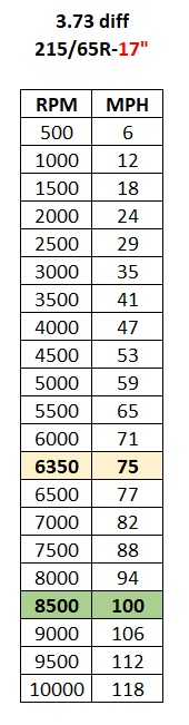

Since my 1971 Chevy truck aka GMC used a mechanical speedometer which I am ditching I plan on using MG2_Speed to calculate my miles per hour MPH
so I punched some numbers into the good ol' Lotus 1-2-3 (pronounced: Excel) ha ha to correlate RPMs to Miles Per Hour based on my 3.73 rear end and 215/65R-17 wheels
I relied on the good ol' folks at x-engineer.org to provide the complicated formulas, (and our daughter to recite pi to the 57th digit):
How to calculate wheel and vehicle speed from engine speed
How to calculate wheel radius
