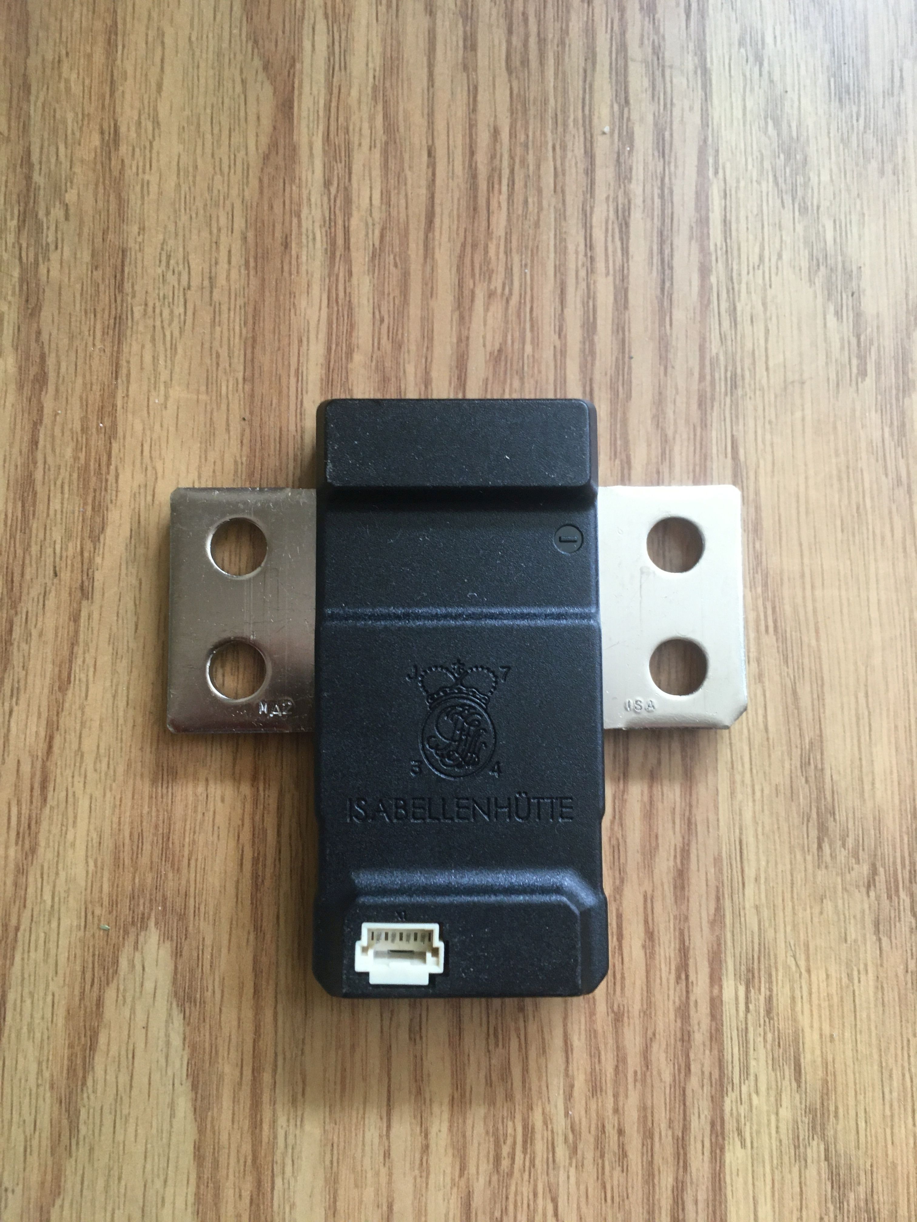

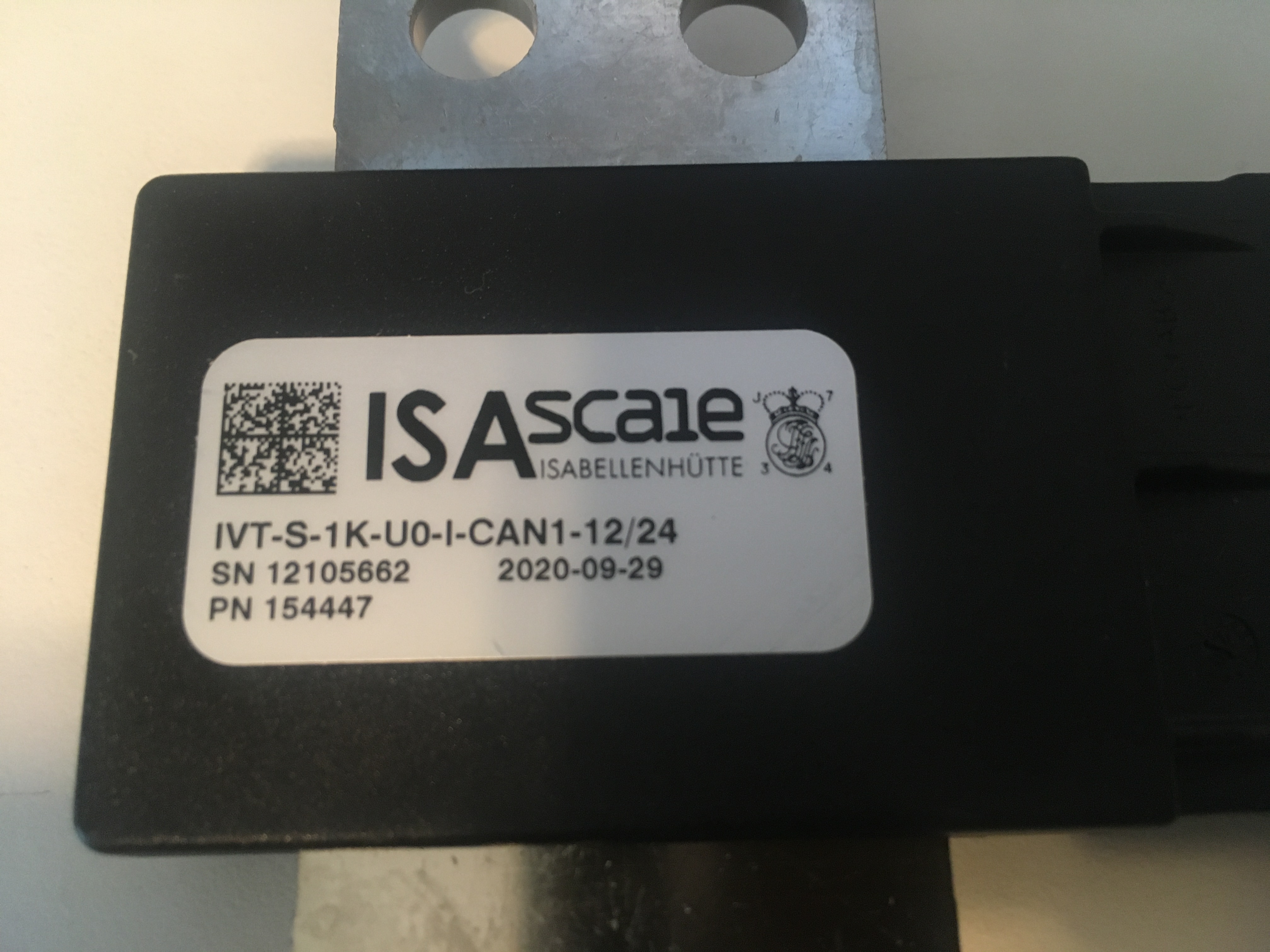

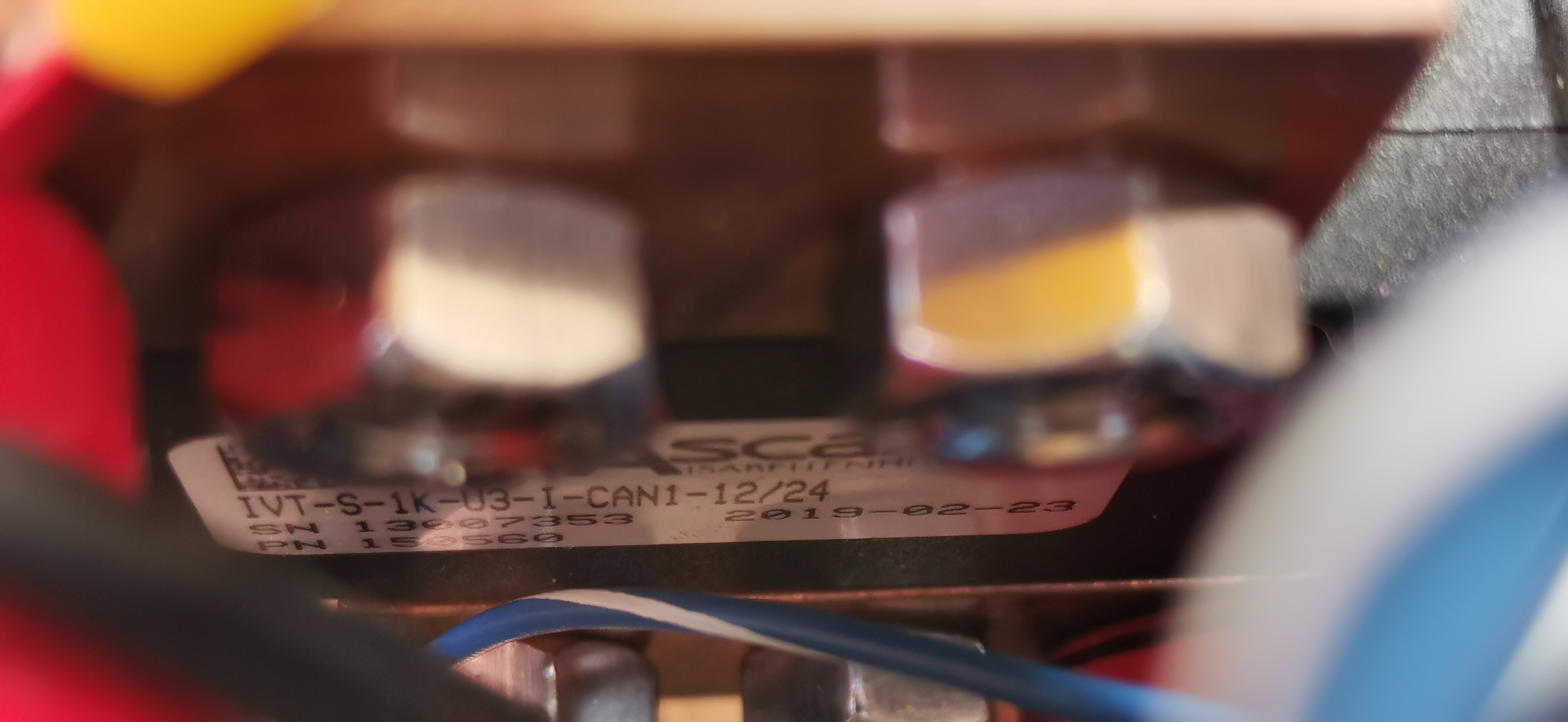

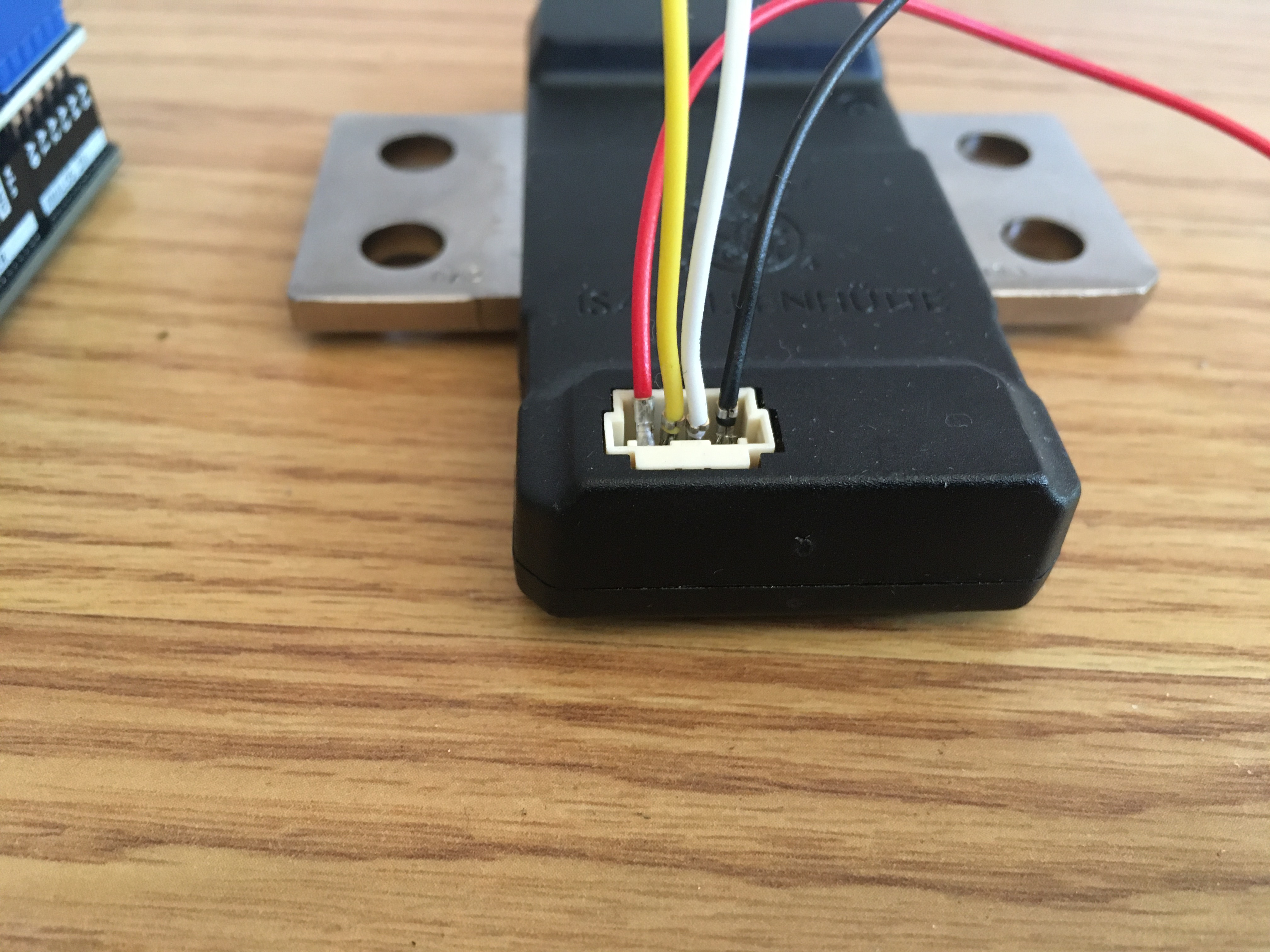

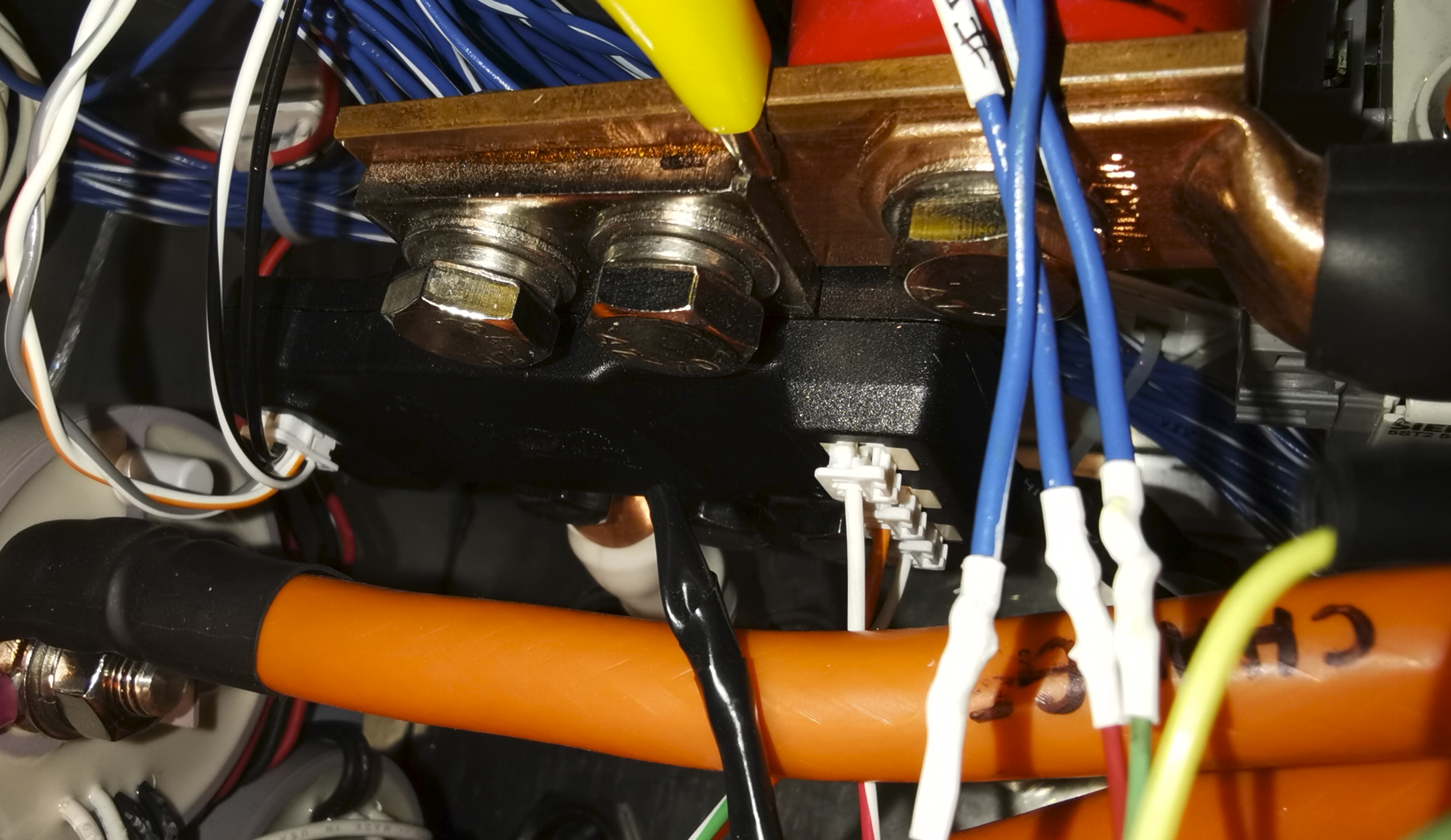

So I went out and bought an Isabellenhütte IVT-S 1000A current shunt on eBay and they sent me the wrong one. I thought I was buying the exact same one as shown on our Wiki, you know the one with the three Volt sensors on top and two CAN ports on the bottom, well they sent me the model without any Volt sensors on top and only a single CAN port. I mention this up front as maybe this has something to do with the issue I am experiencing.
So the goal is simple: Get the ISA sensor to work so that we can have working stock (or customized) virtual gauges using the Damien Maguire EVBMW hardware version 2.0 VCU.
The Problem: for the life of me I can not Initialize or more precisely read the current aka amps value. I realize that this shunt does not read voltage, all I want to get working for now is the current.
  • not working using the VCU
  • not working using an Arduino Due with a CAN Bus Shield
Background: I own an Arduino Uno and a CAN Bus Shield and I followed the Wiki instructions and can Initialize it using this setup and I can read the current just fine.
I will add more detail and pics in the posts below.

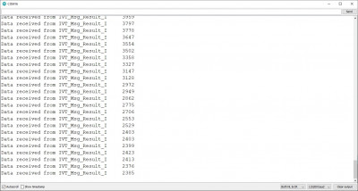

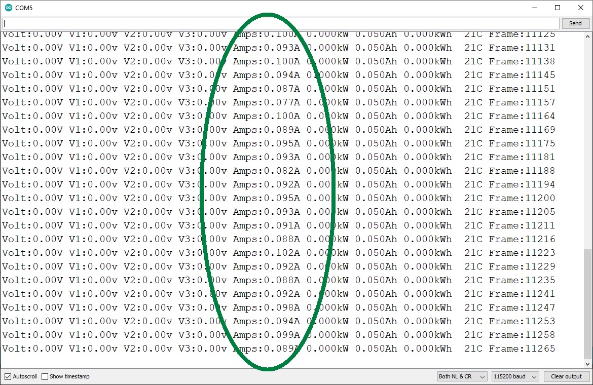

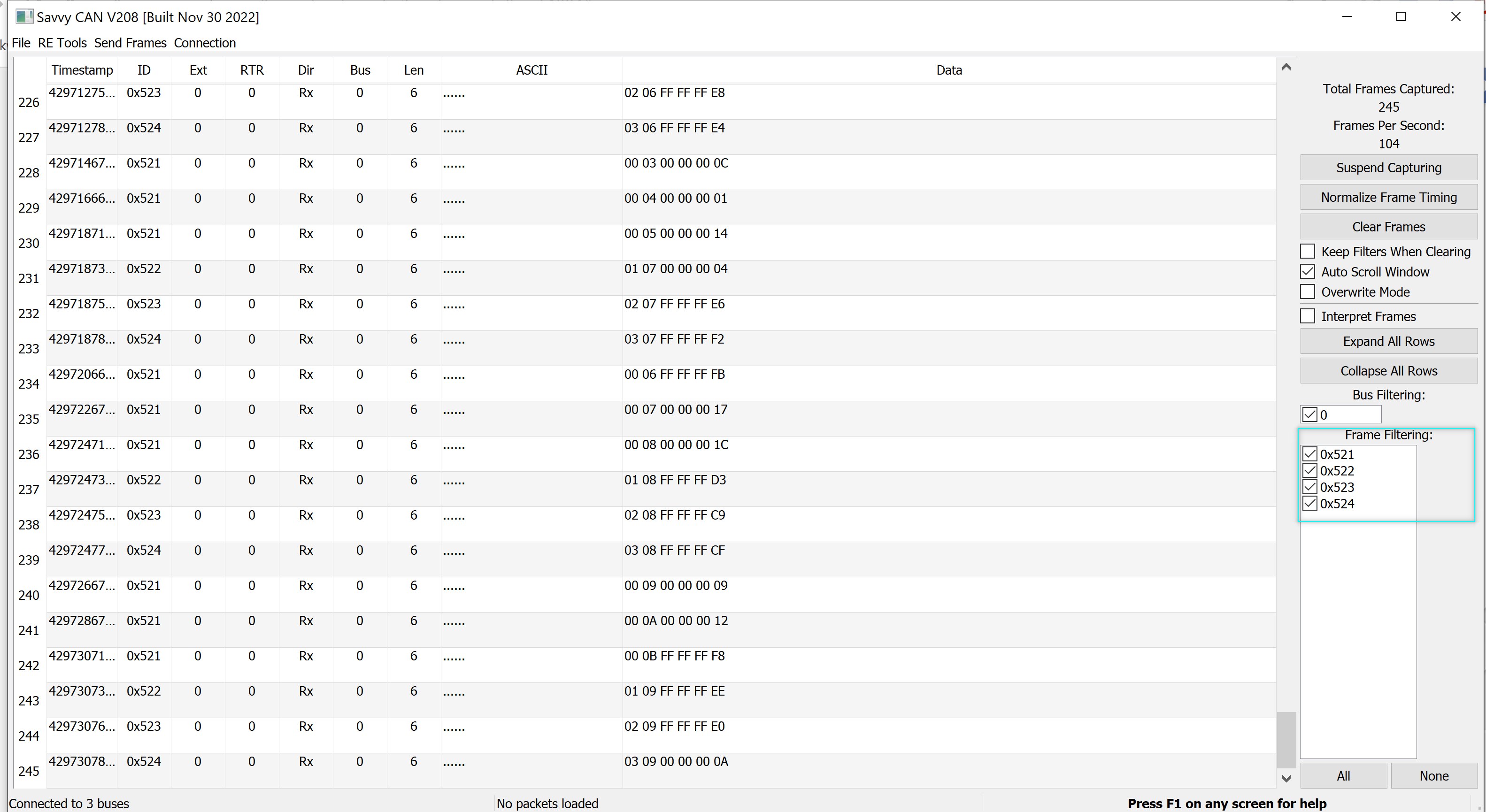

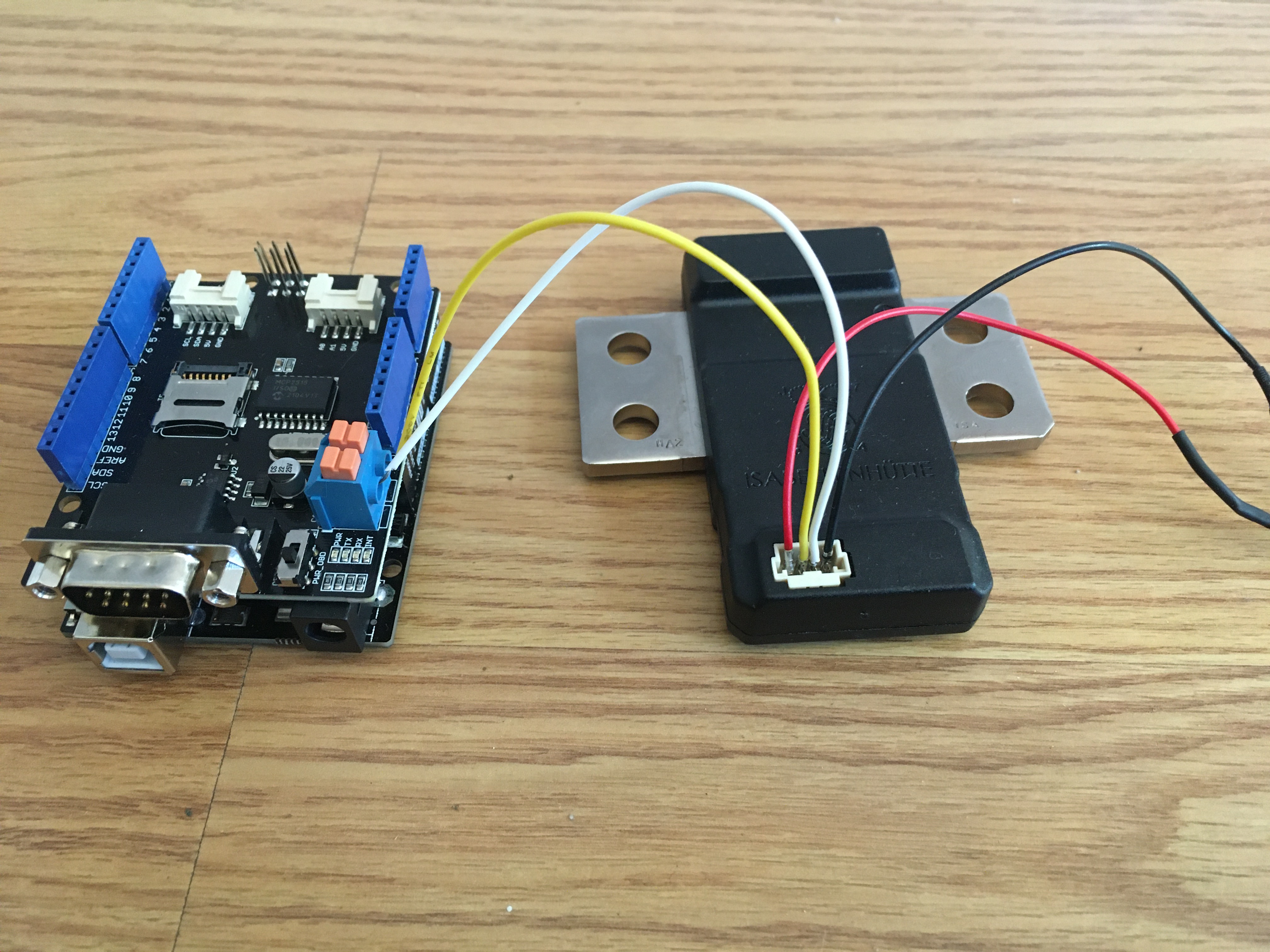

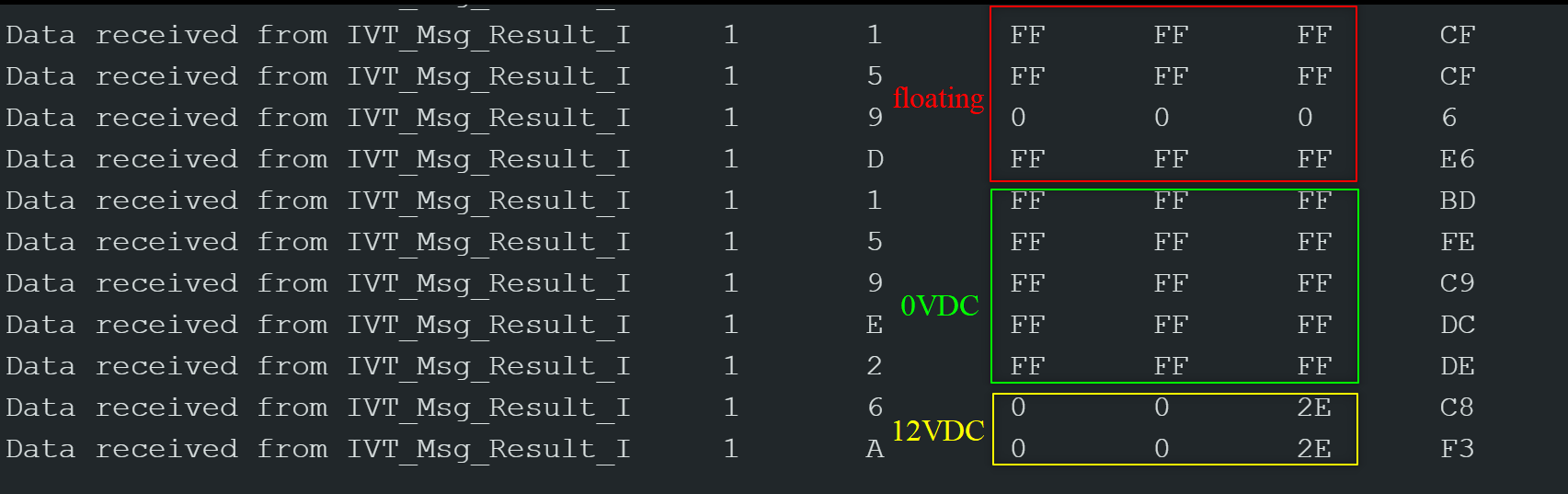

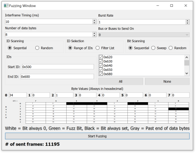

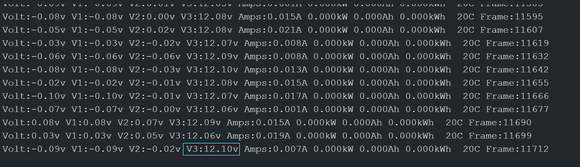

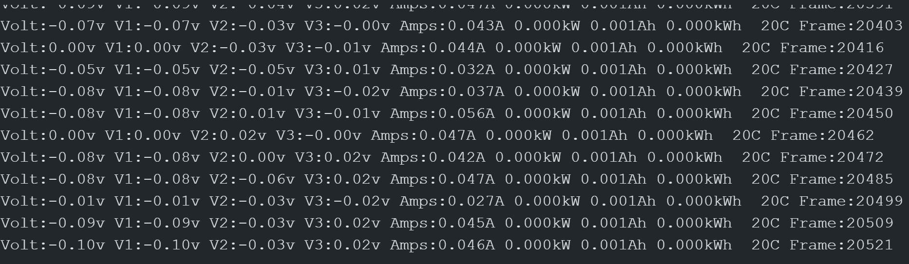

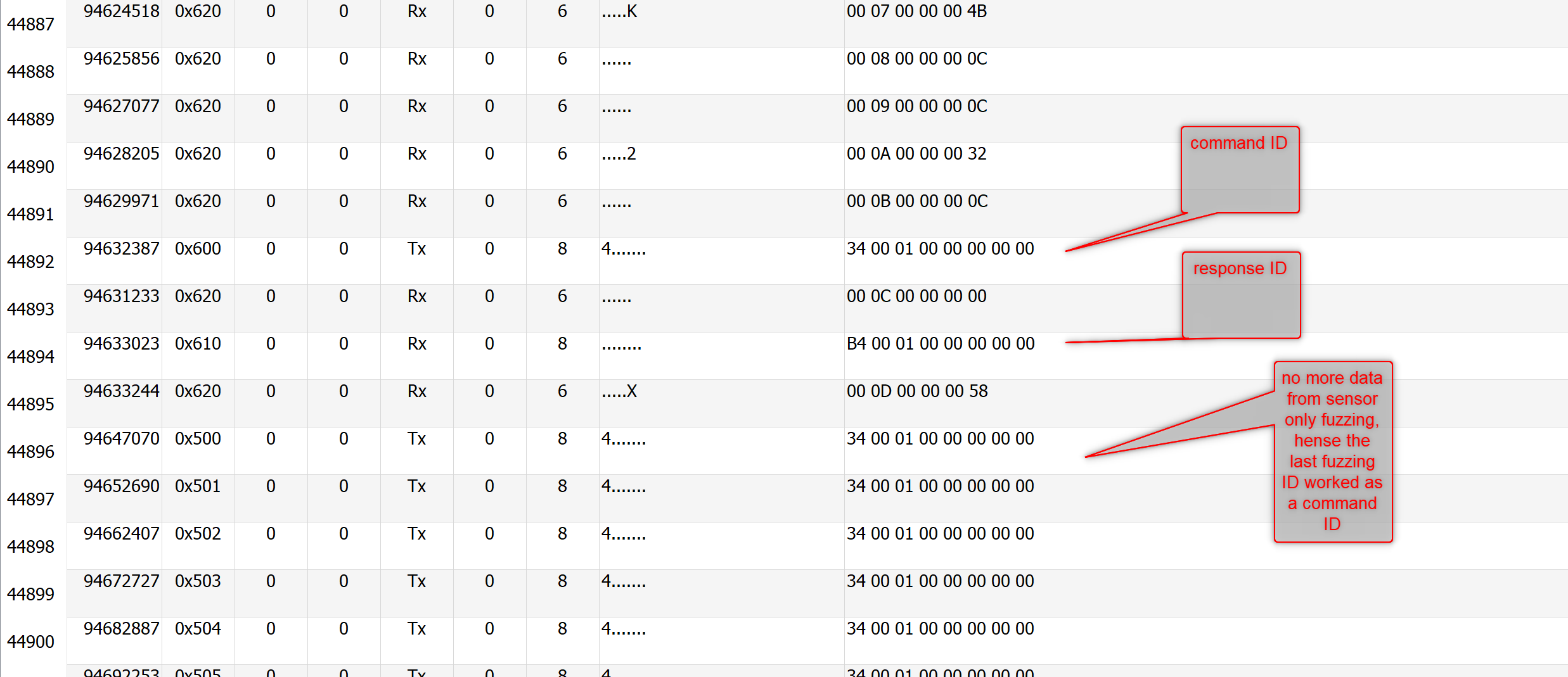

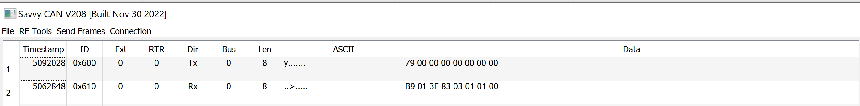

I believe my ISA sensor is good because I got it working with my Arduino UNO (Elegoo technically) and a CAN Bus Shield

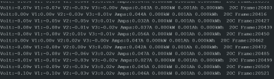

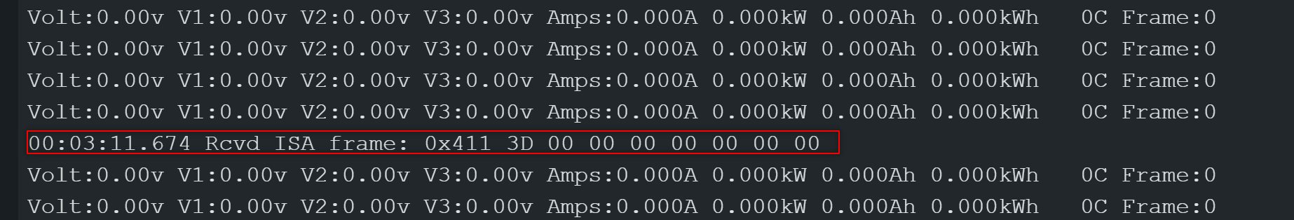

Re: Can't Initialize Isabellenhütte ISA Sensor.
Post by Gregski »

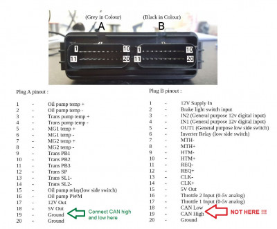

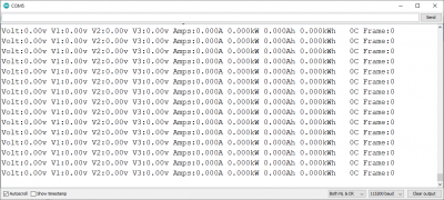

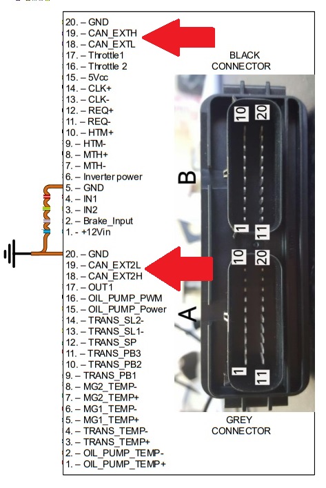

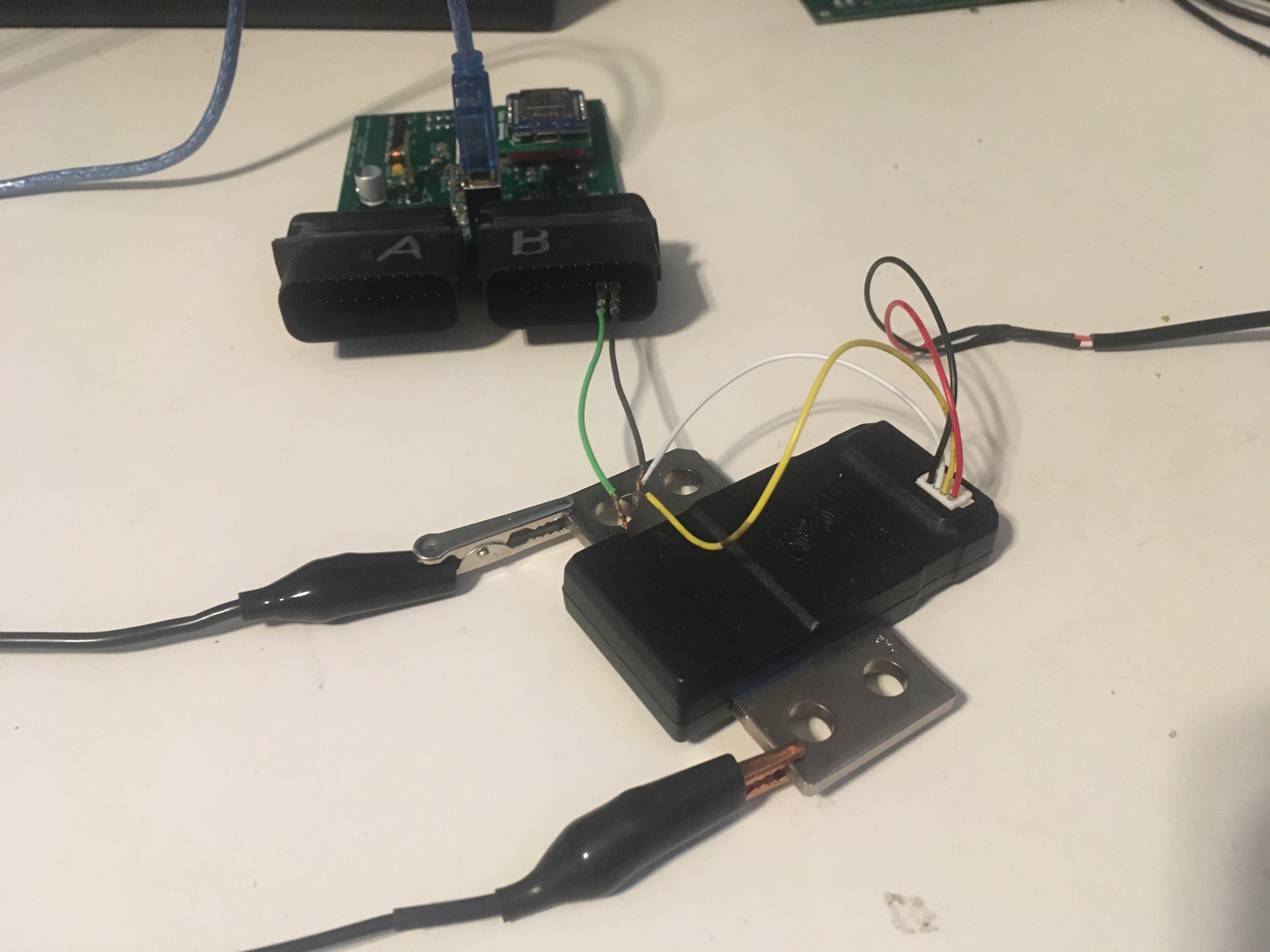

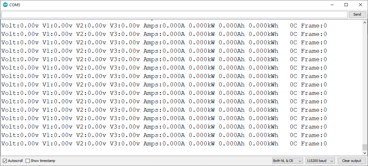

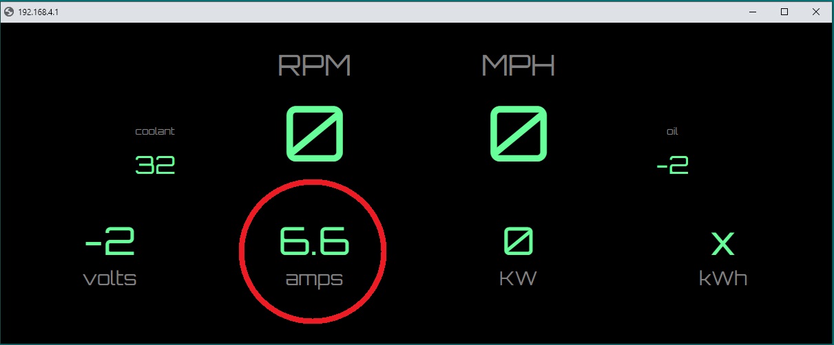

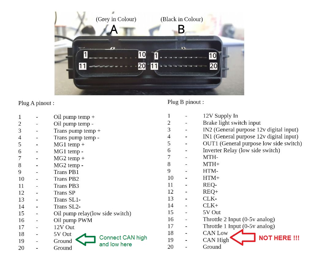

Then I tried it using the VCU itself by connecting the CAN Hi and Low signals to pins 19 and 18 respectfully and following the Wiki for the Due instructions
I tried it by saying the CAN port is on 0 or 1, I tried it by saying use 500 or 1000 kbps data rate
and no dice does not work!

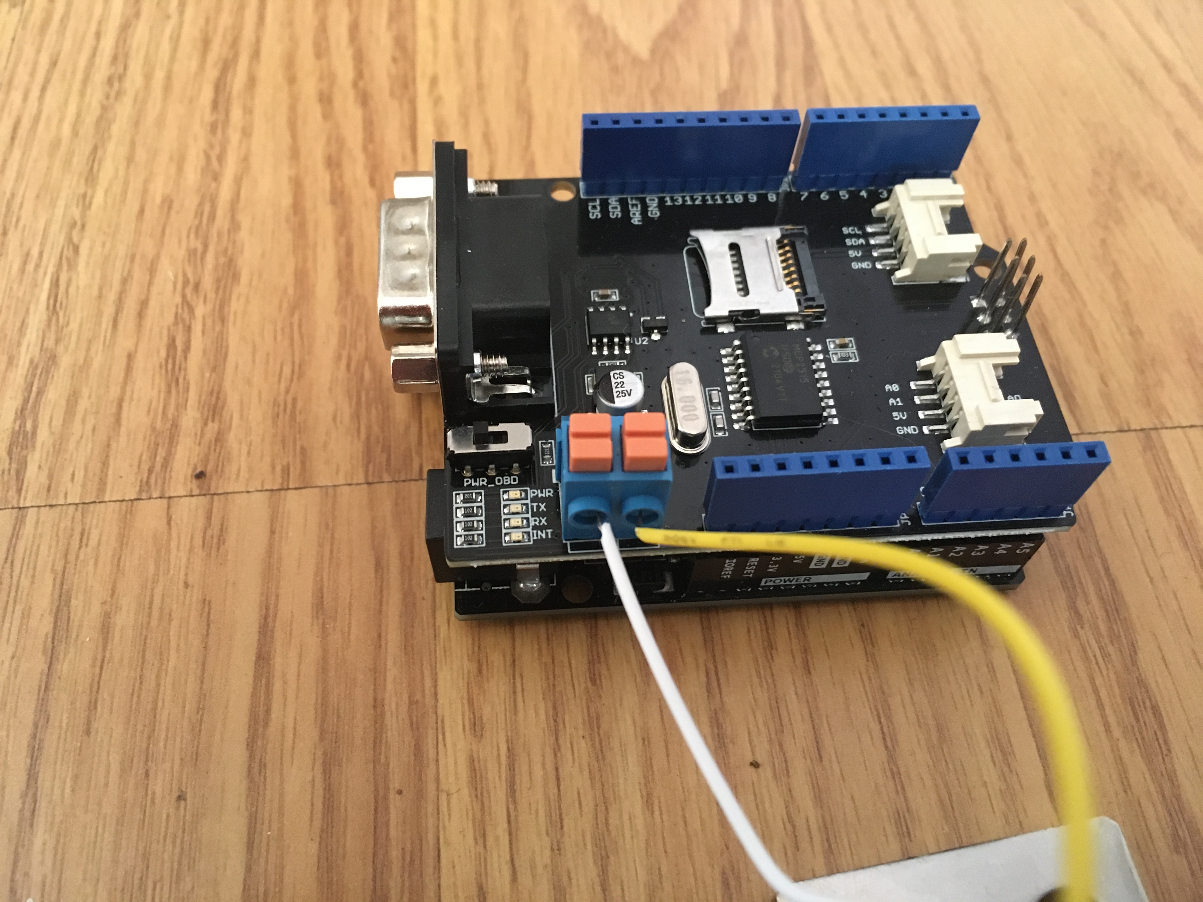

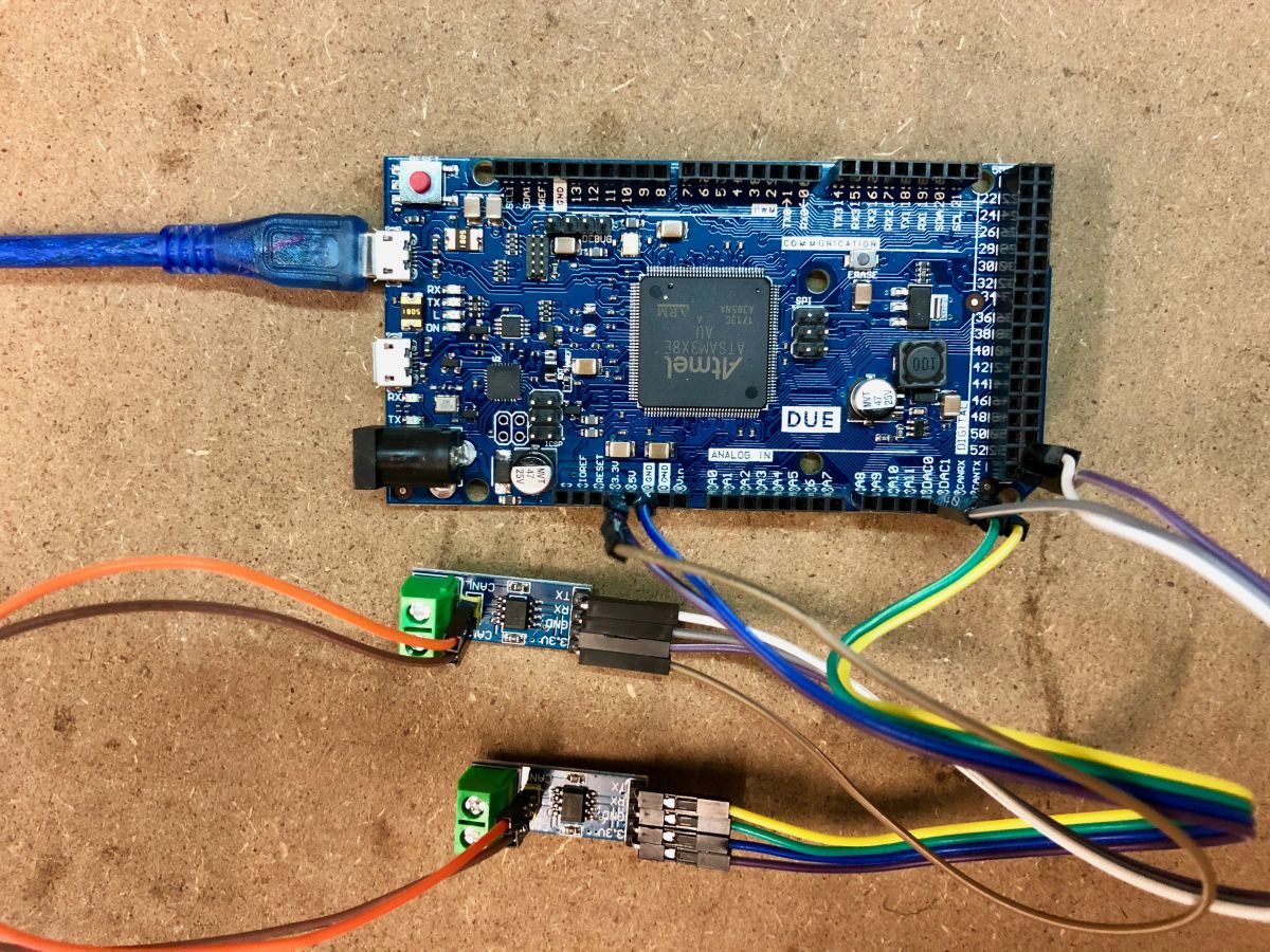

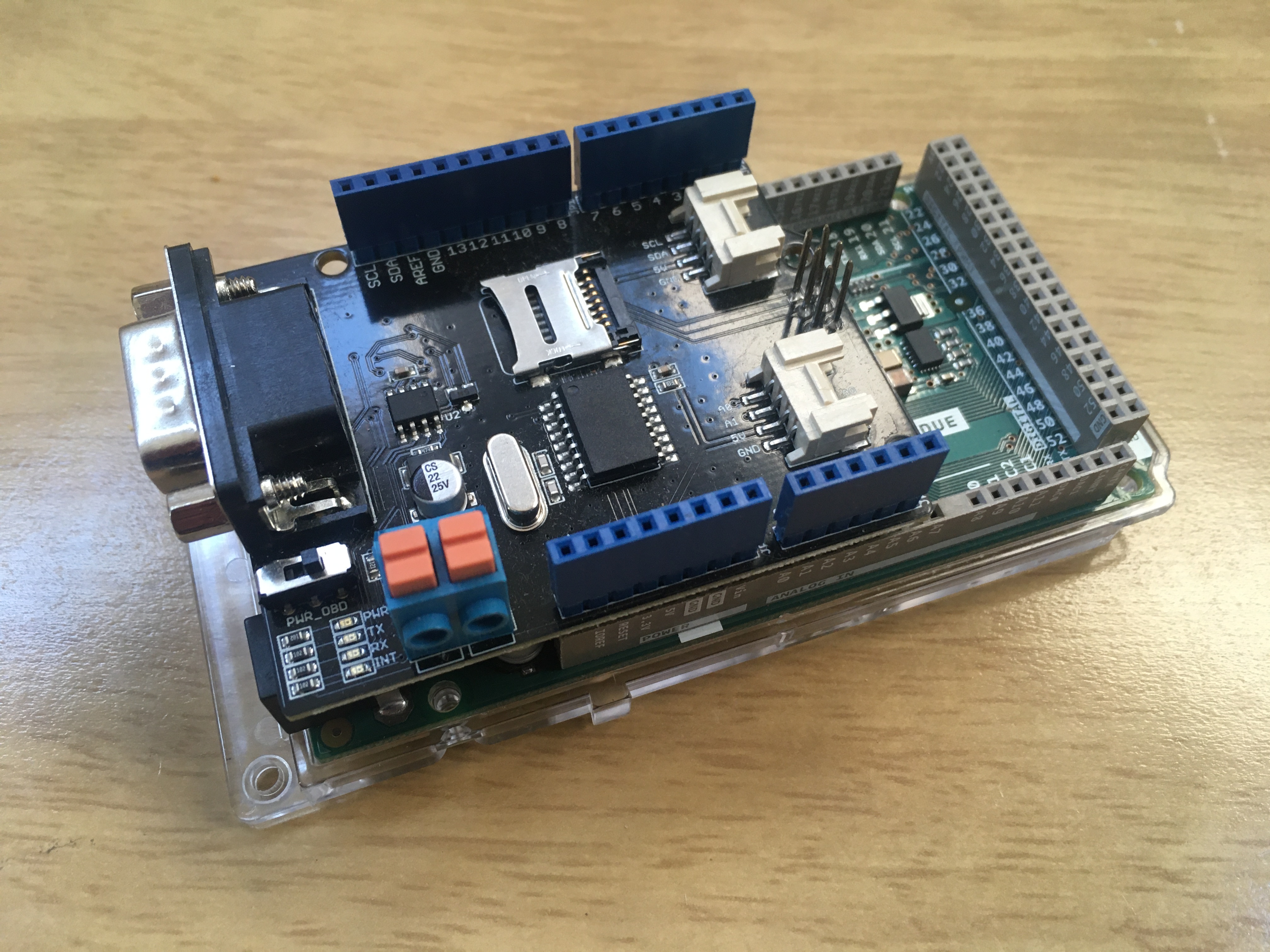

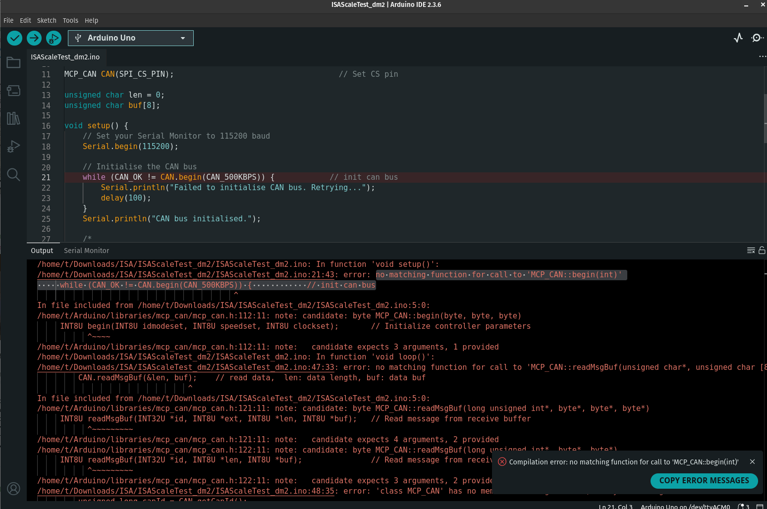

then I tried the CAN Bus Shield atop of the Arduino Due (though I am not sure that is even supported, word on the street is they make special CAN Busers for the Due, correct me if I'm wrong) well at least this way I could see some LEDs light up when I connected the CAN high and low wires to it, unlike flying blind with the VCU, but still no dice, does not work!

Gregski
Posts: 2743
Has thanked: 500 times
Been thanked: 946 times
Post by Gregski »
seeking a cheaper alternative I stumbled upon this article Arduino Due CAN Bus (Controller Area Network) Interfaces which provided three alternatives and a tiny dinky dink called a Breakout Board $10 bones on Amazon
it read: "In order to add CAN bus transceivers to your Arduino Due, you will need either a CAN transceiver breakout board or the CAN Shield for Arduino Due:"
CAN Bus Breakout Board from SKPang Electronics
CAN Bus Breakout Board by WaveShare

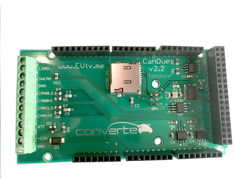

Arduino Due CAN Shield With 2 CAN Ports
Posts: 3567
Has thanked: 134 times
Been thanked: 336 times

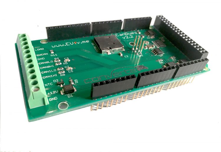

Gregski wrote: Thu Dec 09, 2021 7:22 pm Found this thread on the Arduino Forum: Arduino DUE and CAN BUS SHIELD
seems like the exact same question I am asking, well that thread led me to sum sticker shock! complements of EVTV.me they make this CAN Bus Shield specifically designed to fit the Arduino Due for $149 bucks
Here is my DUE variant with everything you should need :)
viewtopic.php?f=17&t=1148&p=34456&hilit ... eld#p34456
viewtopic.php?p=30299#p30299
But for experimenting i use Canalyst II tool. It is much more flexible than programming DUE and can record and replay CAN.
https://www.aliexpress.com/item/32779970643.html

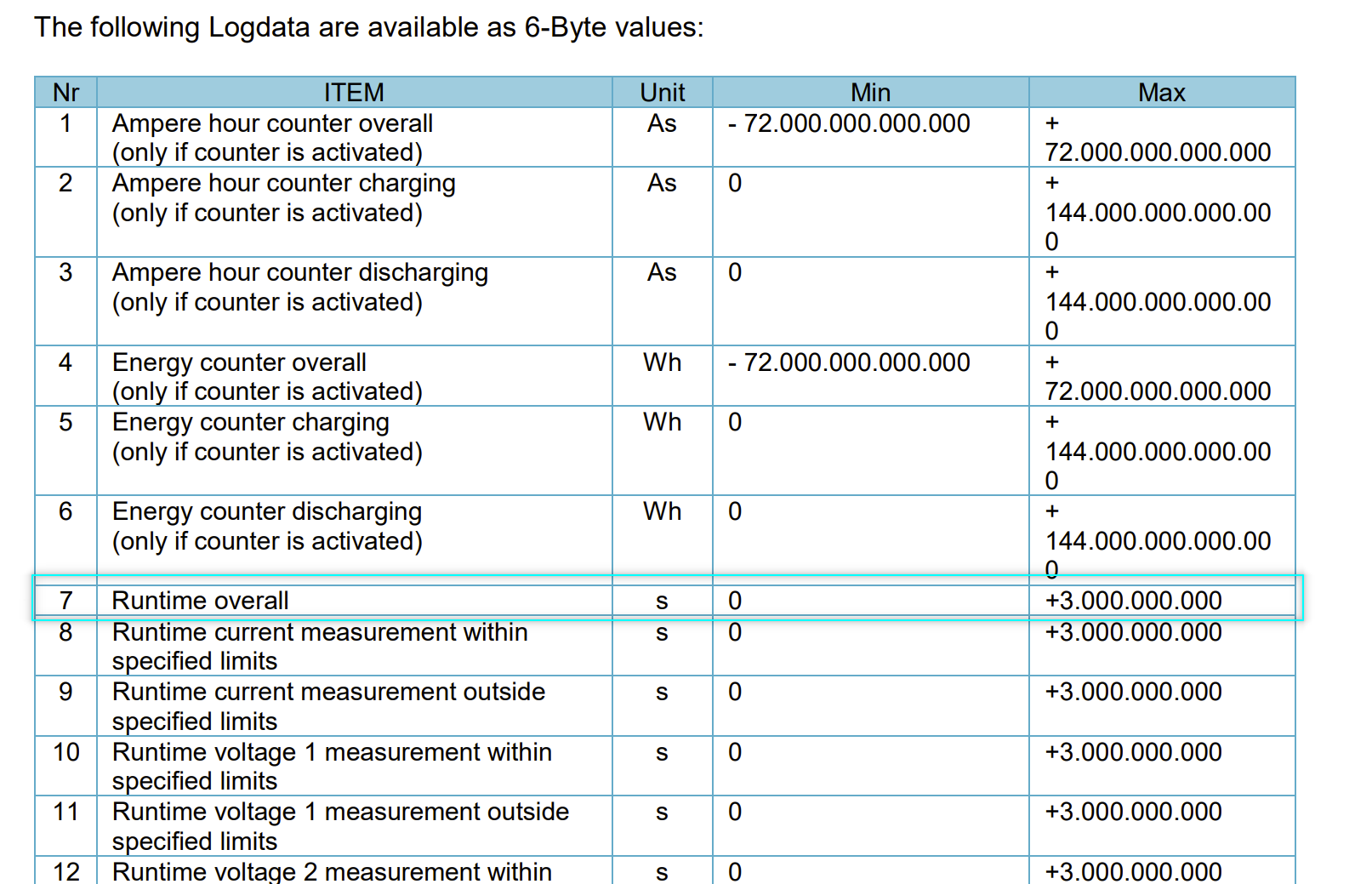

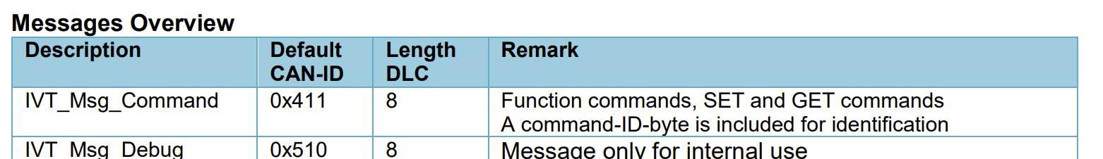

guys I am a total newb so I have to ask what in the world does this mean, it seams to me like the module is stubbed out
Sensor.debug=!Sensor.debug;
or this
Sensor.debug2=!Sensor.debug2;
per the attached User Manual they should look like this no?
Sensor.debug=1;
Sensor.debug2=1;
ISAUserManual.pdf
(1.83 MiB) Downloaded 506 times

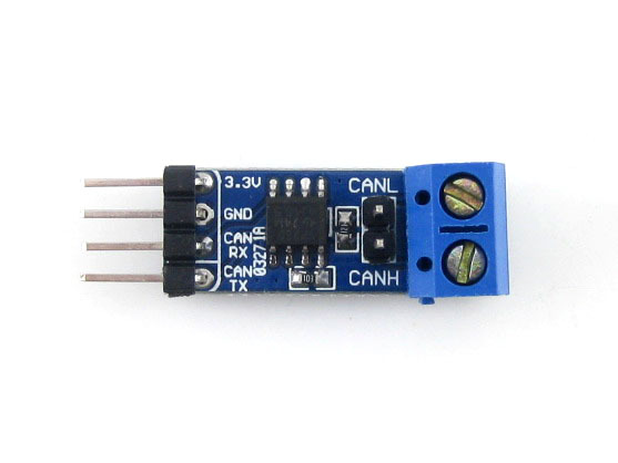

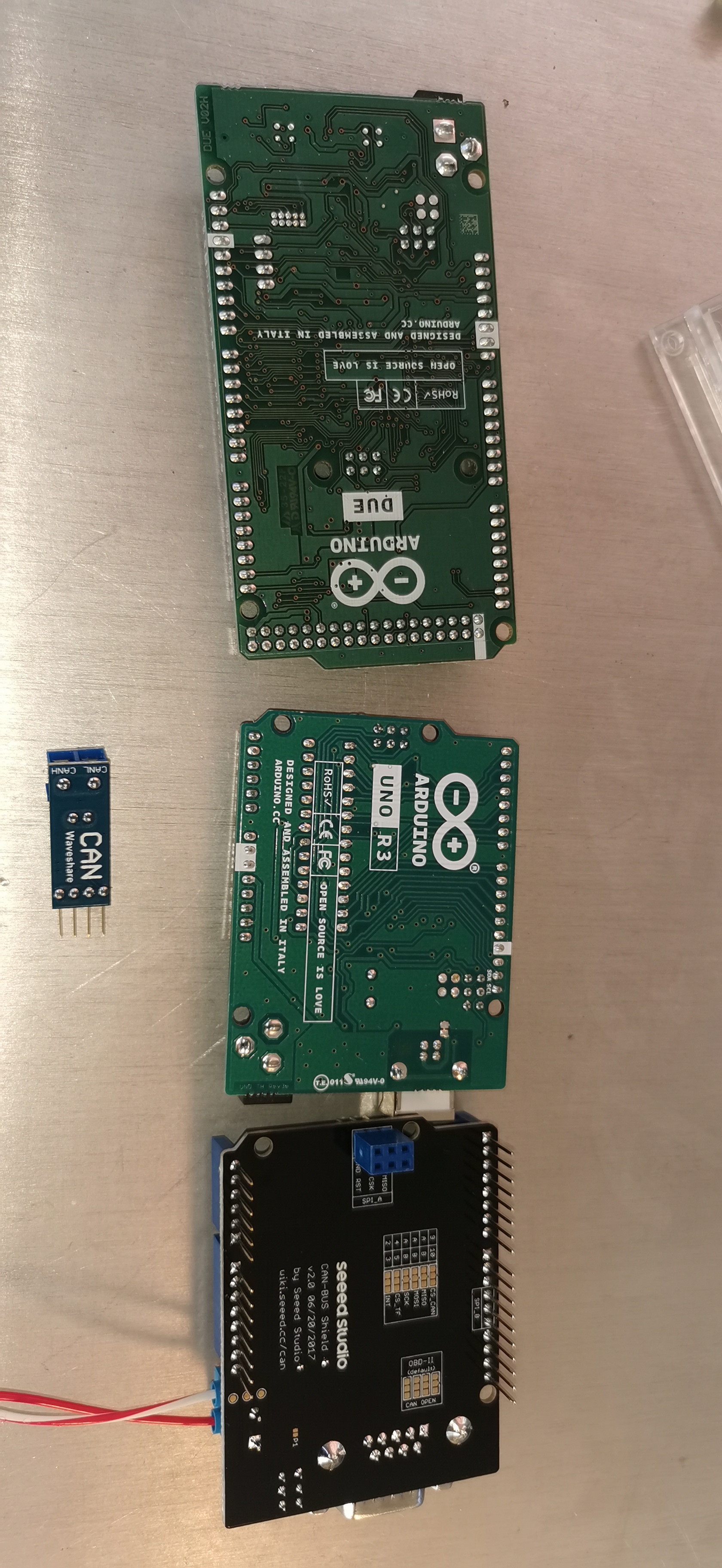

so I finally stumbled upon this Wiki page by dumb luck just Googling CAN bus with Arduino Due to which there is no link off of the Isabellenhütte Heusler Wiki page at all
which reads: "The Due has two on-board CAN interfaces. However, the board lacks the necessary CAN transceivers to make then useful. You will need to add the transceivers yourself. You can find suitable 3.3V SN65HVD230-based CAN transceivers easily on eBay. They are very cheap. Unfortunately, not all of them work."
Gregski
Posts: 2743
Post by Gregski »

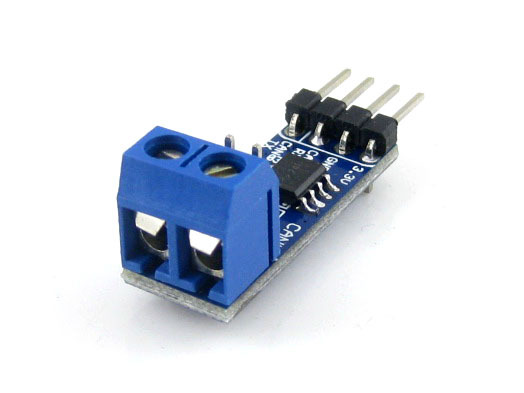

so I ordered one of them 3.3 tranceiver breakout board thingies but for the life of me I don't get why I can't initialize the ISA current sensor using Damien's v2 VCU I mean it ought to have the tranceiver built in right for it to read CAN data once initialized?

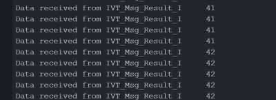

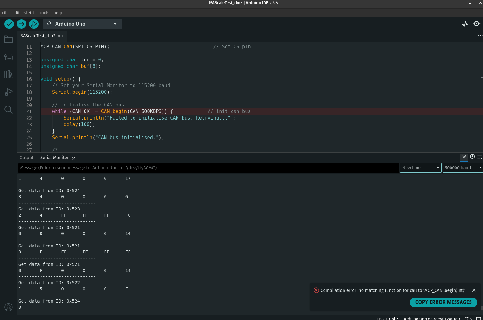

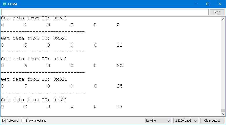

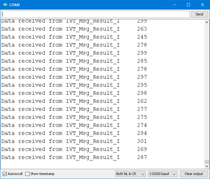

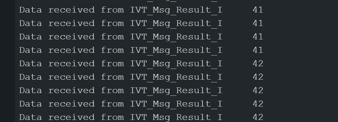

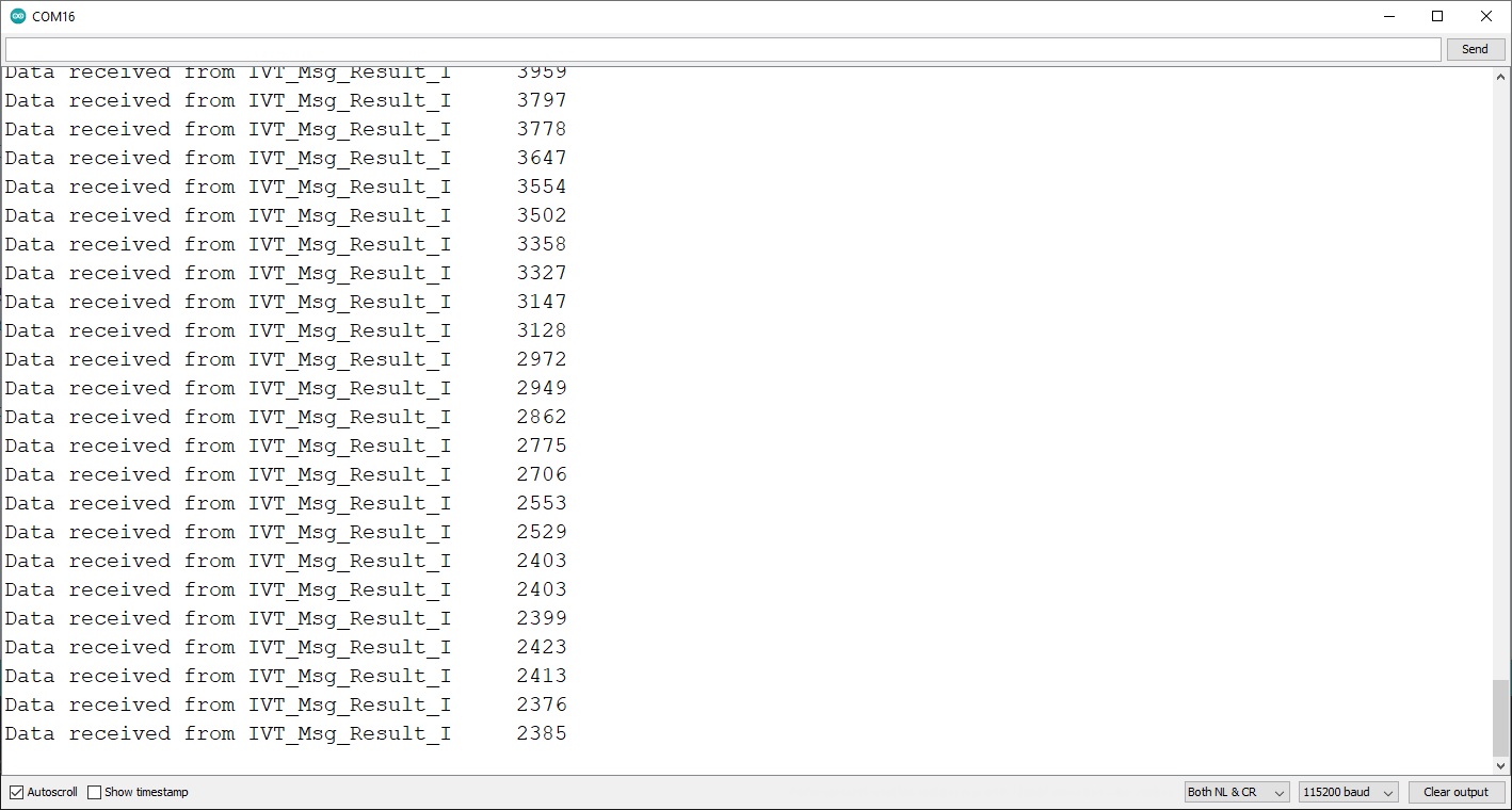

Progress Update... finally made some headway!
So I decided to try the Arduino Uno code off the Wiki on the Due I mean why not, it's a totally different microcontroller that uses totally different libraries, no reason for it not to work right?!
well with the SPI_CS_PIN changed from 10 to 9 and the datarate set to 500KBPS the CAN Bus Initialized and I was able to see actual Current values upwards to 3 amps which is exactly what my bench power supply read
So yes you can use the Uno CAN Bus Shield on a Due ... great now what?
Post by Gregski »
I realize all this is documented on the Wiki but I just like to have it all in one place for the next poor soul who comes along and encounters the same problems as I have, so this is the code to initialize the ISA shunt for the Arduino Uno (which appears to work with the Due as well) values in red have been changed from what the Wiki has (as dictated by newer versions of hardware/software)

oh my lord god, you just saved my life, YOU HAVE TO CONNECT THE CAN WIRES TO THE A CONNECTOR (PER THE VIDEO) NOT THE B CONNECTOR AS SHOWN HERE
GS450H Wiring overview V2.4.pdf
(947.8 KiB) Downloaded 402 times

now it's working, I don't understand why the code would not spit out an error if it had no ISA sensor connected on the other two pins and just kept saying Initialized

so my gauges are working now, here I only have the current connected to show the amps

With videos
Those are CAN0 and CAN1. You could also just switch them in the code. When I was having issues with my shunt, I tried both and ended up with the shunt on CAN1 and my other line on CAN0. It was easier than moving the pins in the connectors.
Don’t forget to uncomment out the Sensor.Voltage and Sensor.Amps lines in the code so you get those values on the web interface.

thanks so much, when I switch the code to
Can1.begin(CAN_BPS_500K);
it does not work when the ISA CAN wires are hooked up to the B Connector, do I have to reInitialize it on CAN1 ?
also it works on the A Connector whether I have:
Can0.begin(CAN_BPS_500K);
or
in the Sketch, I totally don't get it?

So those are initializing the different CAN buses. You need to have this agree:
Sensor.begin(0,500); //Start ISA object on CAN 0 at 500 kbps
Where 0 or 1 is the bus your shunt is connected to. (0,500) or (1,500)

PatrcioEV-ATX wrote: Sat Dec 11, 2021 2:55 amSo those are initializing the different CAN buses. You need to have this agree:
thank you for trying to help, this is like pushing a string
so
this works: Sensor.begin(0,500); //Start ISA object on CAN 0 at 500 kbps on the gray A Connector
this does NOT work: Sensor.begin(1,500); //Start ISA object on CAN 1 at 500 kbps on the black B Connector

I have two ISA sensors so I tried a second one just for the hell of it, I know it's dumb but hey you never know, and it acts exactly the same as the first only works on the gray A connector, does not work on the B connector
I eyeballed the hewk out of the B connector and the circuit board and nothing obvious jumps out at me like me forgetting to solder some pins or something like that

Gregski wrote: Sat Dec 11, 2021 6:29 am I have two ISA sensors so I tried a second one just for the hell of it, I know it's dumb but hey you never know, and it acts exactly the same as the first only works on the gray A connector, does not work on the B connector
Hmm.. I have my sensor hooked to pins 18 and 19 on connector B and running on CAN1. H/L pins are switched on the different connectors of course. I'm sure you have, but make sure your CAN begin and Sensor begin match in the code. Other than that, I'm out of suggestions.
or
2012 Nissan Leaf (sold)

PatrcioEV-ATX wrote: Sat Dec 11, 2021 3:04 pm H/L pins are switched on the different connectors of course.
darn it I was looking at Ver 1 pin out earlier
:x :x :x :x :x :x :x :x :x :x :x :x :x :x :x :x :x :x :x
