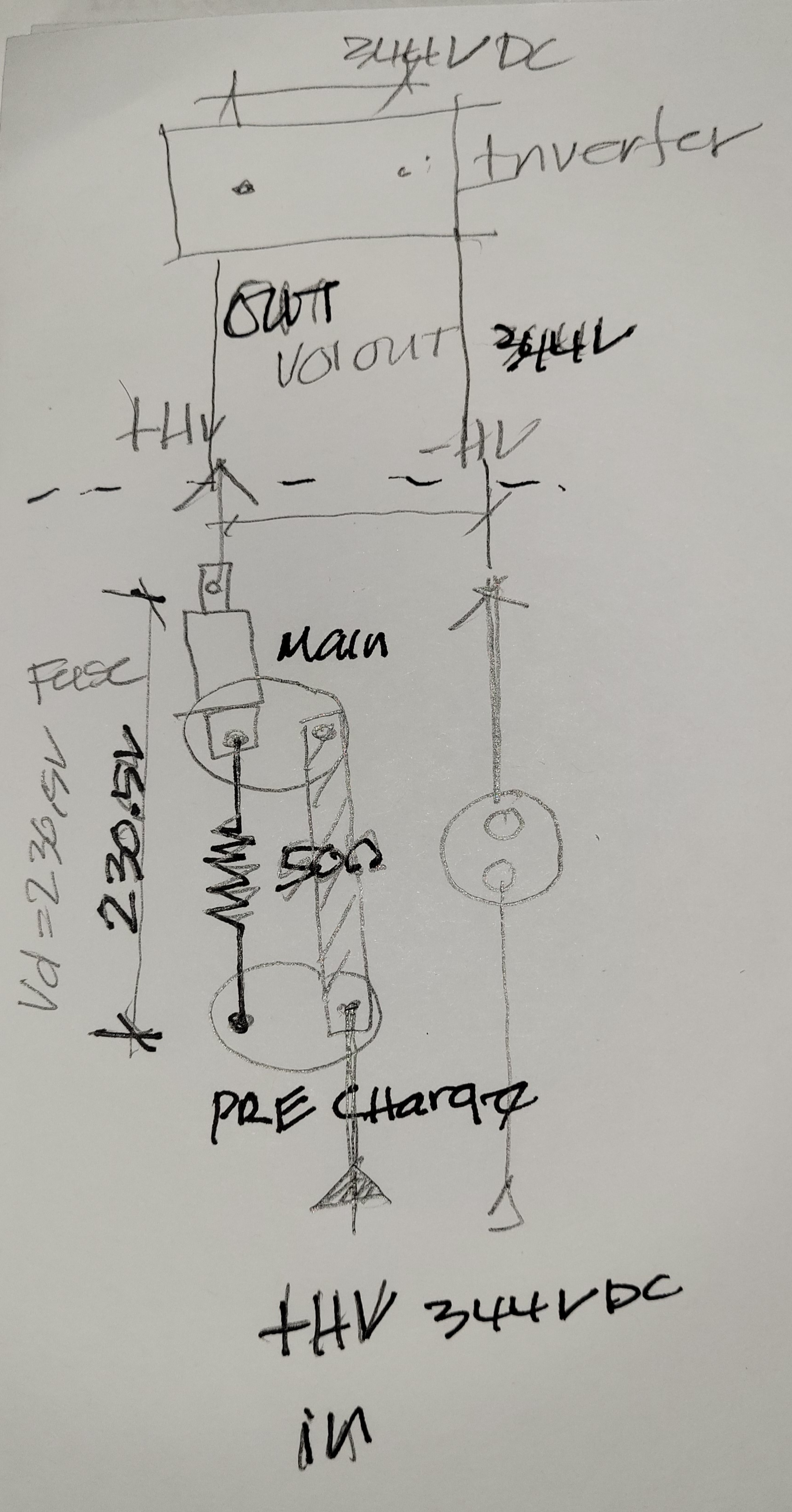

Here are the pictures of the inside of the inverter input HV
Any thing abnormal?
UDC=1.78V now

I see that the SDU HV cables have a small box connected to the + HV cable.
My cable doesn't have that I have my own HV Box and fuse. CAN THAT BE A PROBLEM WITH THE INVERTER.
See picture

No, you don't need that box. Connectors look fine too. Looks like it's the inverter then.
If you have contactors on do you get voltage at the inverter end of the cables?

Post by qmedia2651 »
Yes I do 344v
In the pic correction Vd is 230mv not 230.5v.
Input voltage =output voltage = 344vdc
Therfore this proves that the capacitors are changing .
After checking all voltage and continuity of IGBT conn 5
And continuity from pin 1 to R31 to Pin 11 on the STM32
My conclusion is that the 24 pin IBGT conn 5 ,pins are not connecting to the inverter pins.
Need part number for 24 IGBT conn 5 it's not on the bill of materials list.
Any one out there please advise 🙏
