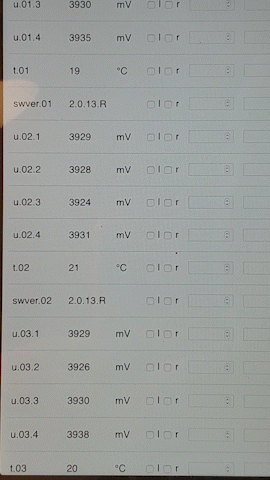

johu wrote: Tue Sep 21, 2021 6:03 pm Yes it could indeed loop forever if the voltage source is noisy because measured==expected is never hit
Johannes I managed to complete full calibration process. I get cell voltages reported and LEDs on the slaves are blinking really fast in sequence. However when I refresh the web interface every time the reported voltages are changing slightly by a few mV or sometimes up to 10 mV. This is especially visible if I leave the web interface on auto refresh. Is this normal and if not what could be the clues to resolve it? Does the first board need to have different diode than the rest of the boards? Thanks

Could it be the reference voltage not being stable enough? 10mV is pretty close to the 1mV accuracy aimed for on the first post though.

m.art.y wrote: Mon Nov 08, 2021 10:08 am Johannes I managed to complete full calibration process. I get cell voltages reported and LEDs on the slaves are blinking really fast in sequence. However when I refresh the web interface every time the reported voltages are changing slightly by a few mV or sometimes up to 10 mV. This is especially visible if I leave the web interface on auto refresh. Is this normal and if not what could be the clues to resolve it? Does the first board need to have different diode than the rest of the boards? Thanks
On the newest revision all boards have the same BOM. 10 mV is certainly too much fluctuation. Are you sampling just one board? If so, sampling itself distorts the readings and the problem would go away once you chain in more boards.

johu wrote: Sun Nov 14, 2021 6:27 pm On the newest revision all boards have the same BOM. 10 mV is certainly too much fluctuation.
Hi, how much fluctuation are you seeing on your boards - how much is normal? Why would it be that one cell fluctuates more than others on a slave - I've seen it on all 3 of my slaves. Are the slaves sensitive to the wire lengths that connect to the cells?
Also how are you achieving stable voltage reference please?

After watching this:
I wonder if the 3V / 2.5V reference for the differential range was a good choice... Maybe a shunt reference would make more sense? Can you check whether your 3V is stable? (IC3)

johu wrote: Sun Dec 05, 2021 10:19 pm Can you check whether your 3V is stable? (IC3)
Yes, the output looks stable and is ~2.5 V (slightly different on each board). This is what I get when I am sampling 3 slave boards. Actual voltages are between 3.932 and 3.930 V.

So I tried to discharge my cells while keeping the BMS on and the reported cell voltages followed and remained within about the same fluctuating 'error'. Johannes could it be that this fluctuation is caused by not accurate enough calibration? Or still not enough slave modules on the chain - I've got 3 wired in. Thanks

No, calibration would only affect the absolute values, not the jitter. I can compile a software later that has a configurable round-trip time or so, see if that helps.
