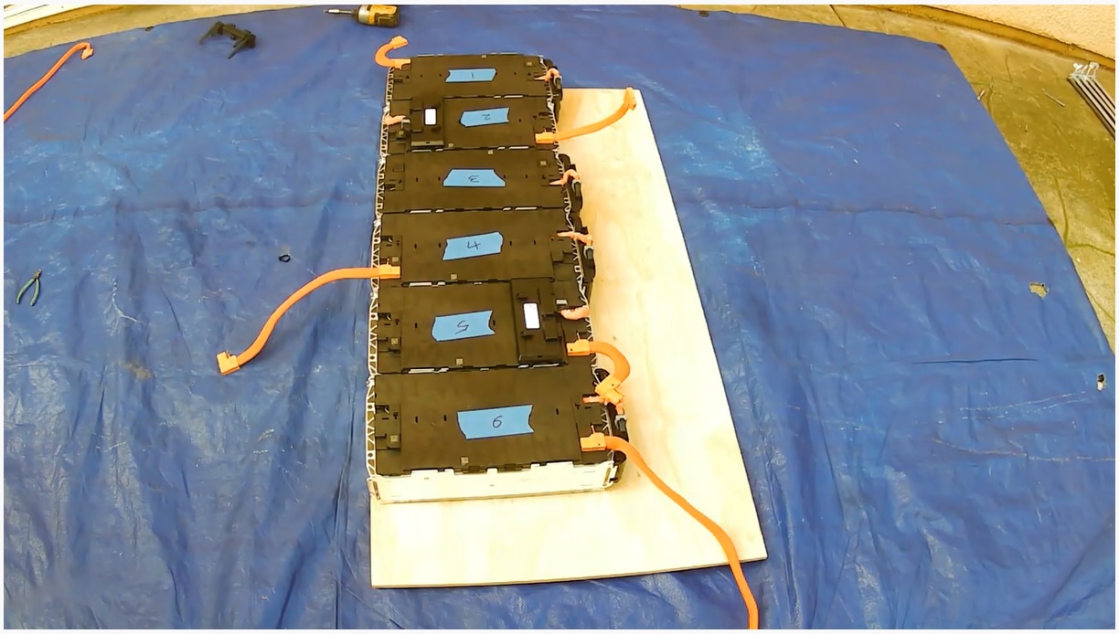

I wanted to share this for a size reference, this is a 2 foot by 4 foot piece of plywood, and it appears 9 cell modules will fit on top of it

throw some labels on it...
