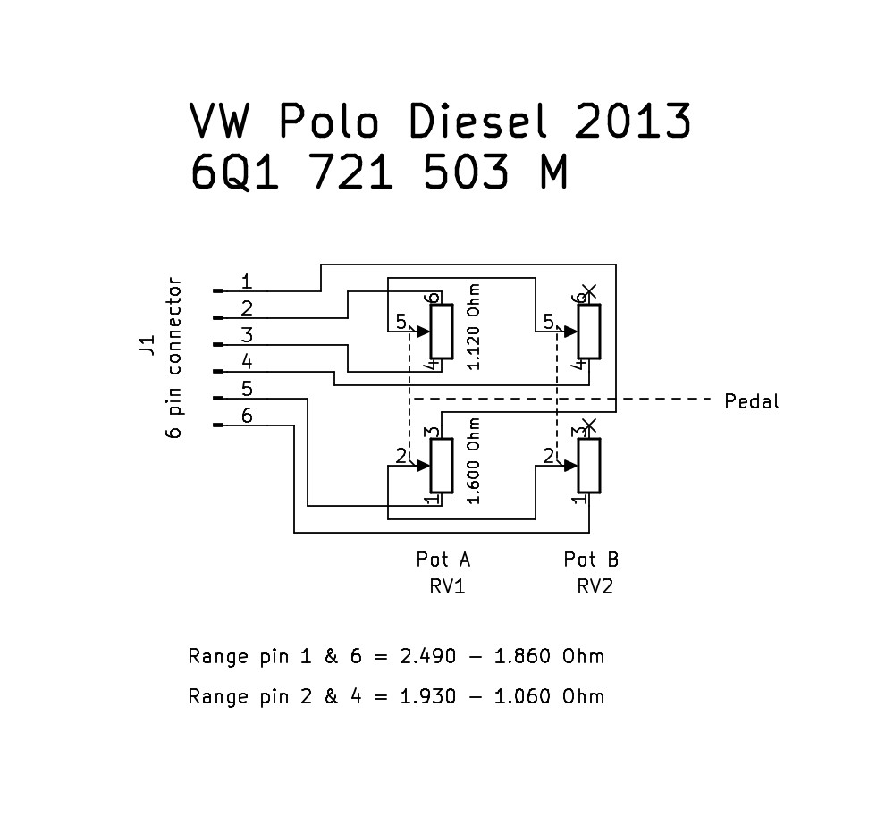

PaulHeystee wrote: Thu Dec 02, 2021 8:48 am Throtle pedal question: I bought a VW Polo diesel throtle pedal, I opended it and found that it looks like it is just two potentiometers.
Will this work?
That should work just fine.
You need to figure out which ones of the pins are the center taps of the potentiometer.
Then just wire 5V and GND to the other two pins of each potentiometer.
If you get 5V and GND mixed together, there should be no damage, but you need to get the direction right (that being an increasing voltage in function of percentage of throttle travel).
Keep in mind, that if you mix the center tap with either the 5V or GND, you risk damaging the 5V reference supply of the Zombie or damaging the throttle pedal (Assuming there is no short circuit protection).
Best to test this out with a multimeter set to measure ohms first. Pick a pair of pins until you find a pair that does *not* change when you press the pedal: then you have both ends of one potentiometer. Test from one of these to find another pin that does change - that is the wiper for that pot.
Repeat to find the second set.
Now you can safely hook it up to the VCU, the "end" pair go to 0V and 5V. You want to see both pot values increase when you press the pedal, so swap around that pair if not.
Can I still use this?
What signals does the Zombieveter want to see, just 0 to 5 volts?
Will this work?
Just wanted to share my findings on this pedal.
I did some measurements and came to these results.
