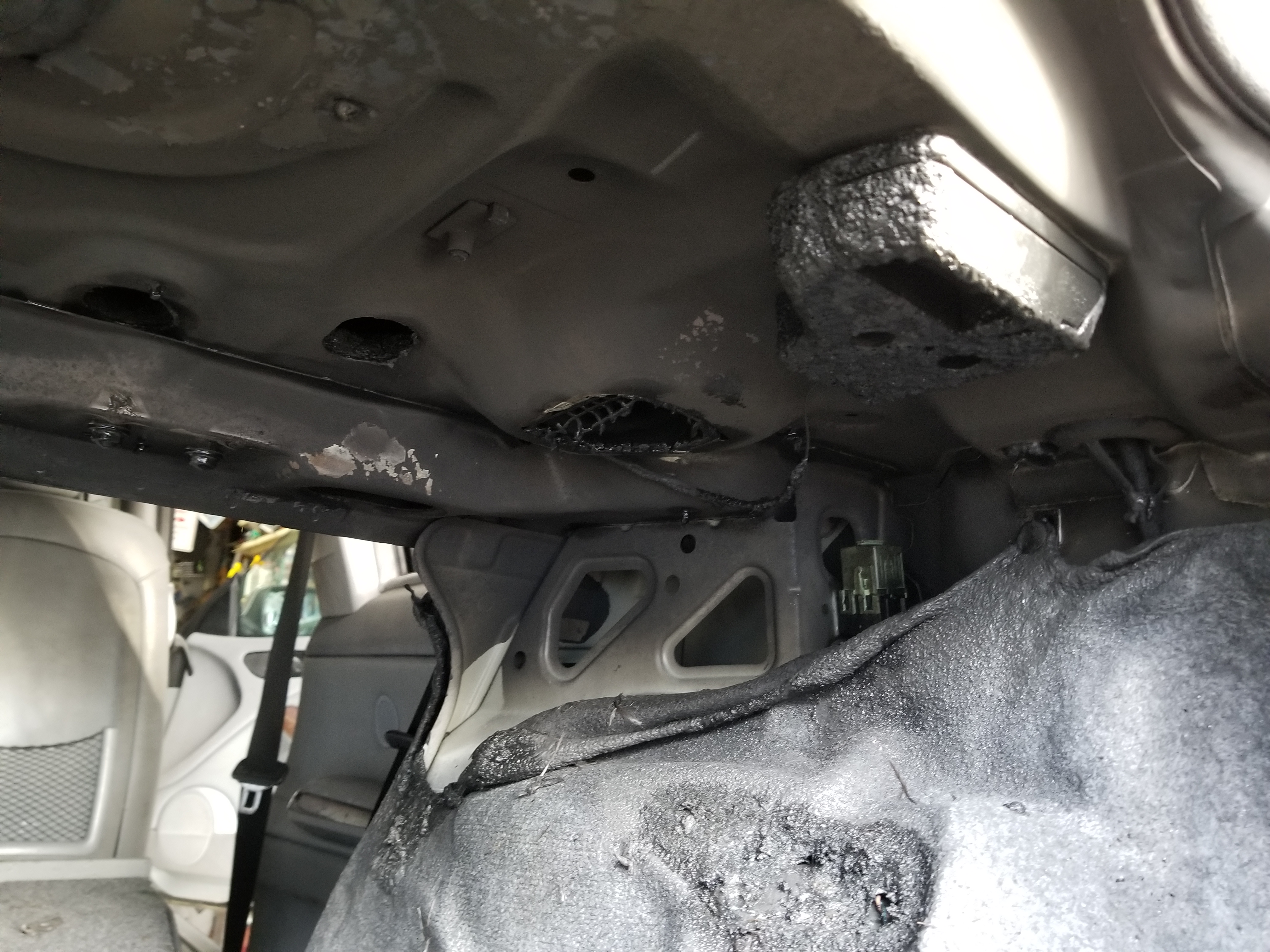

I wasn't going to post this because I feel like a totally idiot and should of caught my mistake.
But I'm sharing to the group so that my mistake wont happen to others.
Many of us are using the Chevy Volt battery for their conversions.
I would also say most of us (if not all) are using the battery not in the original configuration.
Which means new high voltage cables need to be made.
When I made up the high voltage cable I crimp the lug and then bent it 90 degrees down.
This would allow the cables to go straight down the side of the battery.
Then I was going to use the factory cover to enclose the battery.
Everything was going to plan.

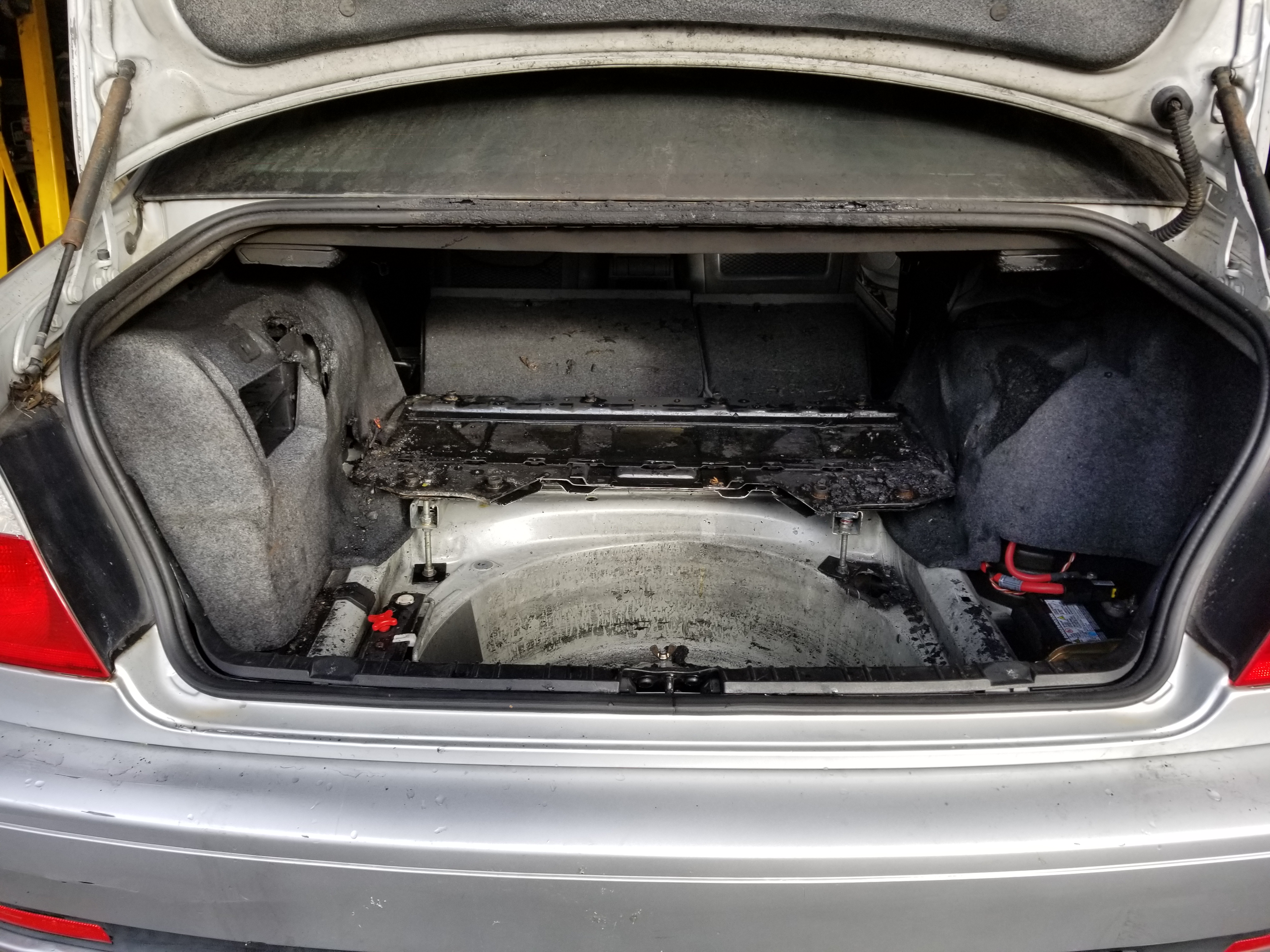

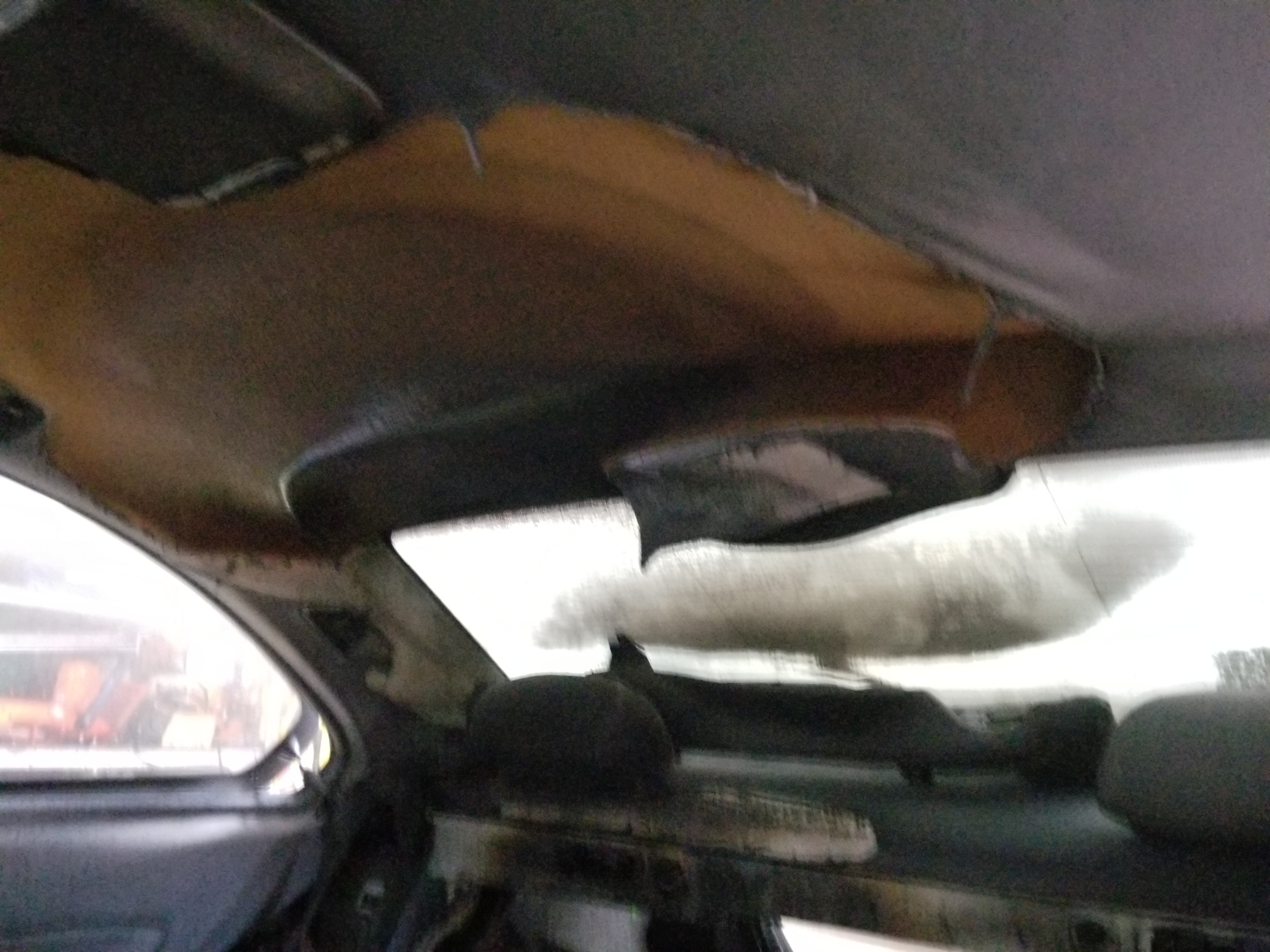

I was finishing installing the battery in the trunk "boot" area in my 2005 3 series. Then all the sudden FIRE SPARKS !!!

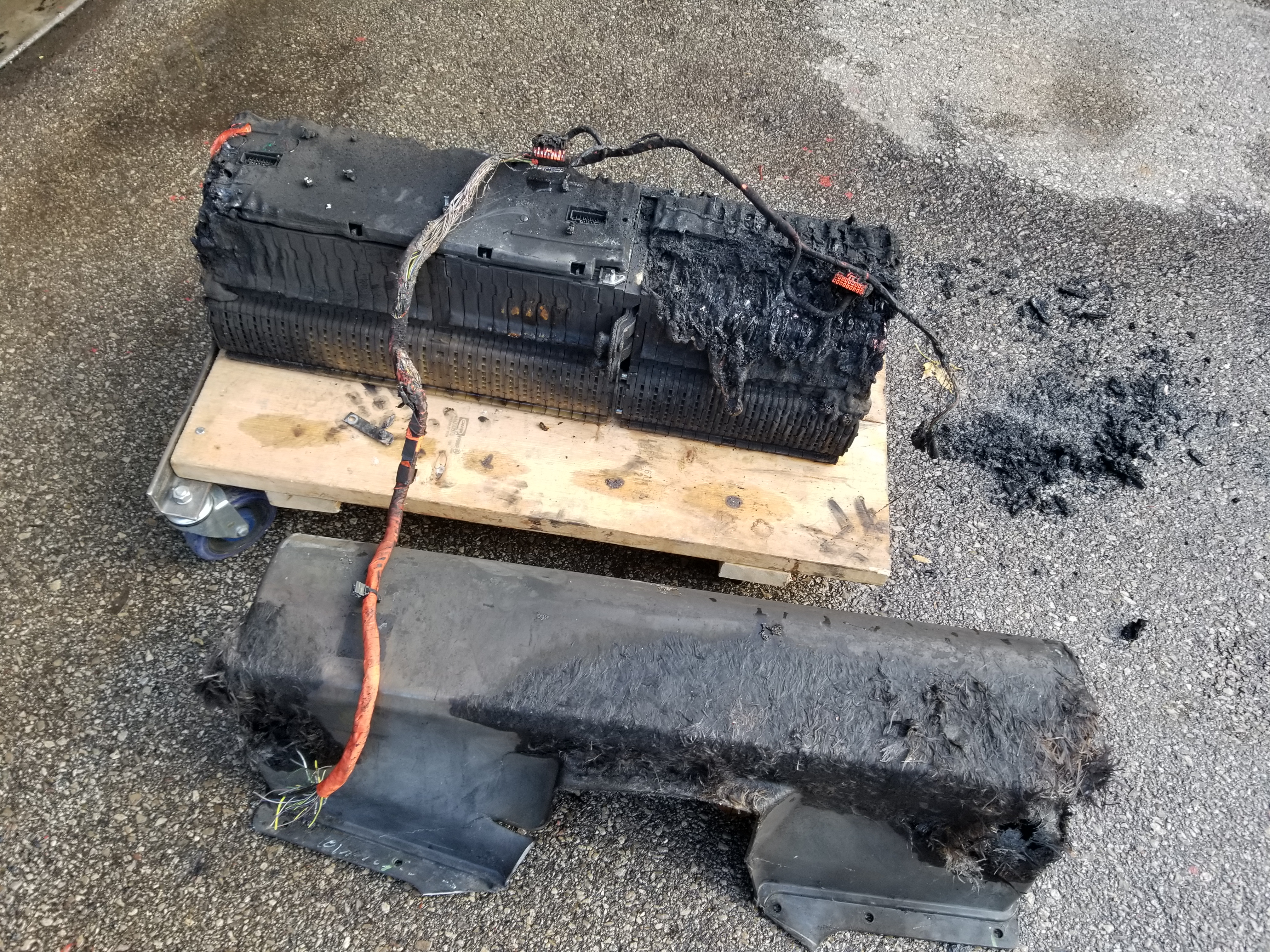

I couldn't remove the battery because it was already installed and there was no way of stopping the fire.
All I could do is grab the garden hose and spray away and wait till the battery lost its charge.
WHAT CAUSED THE FIRE ???

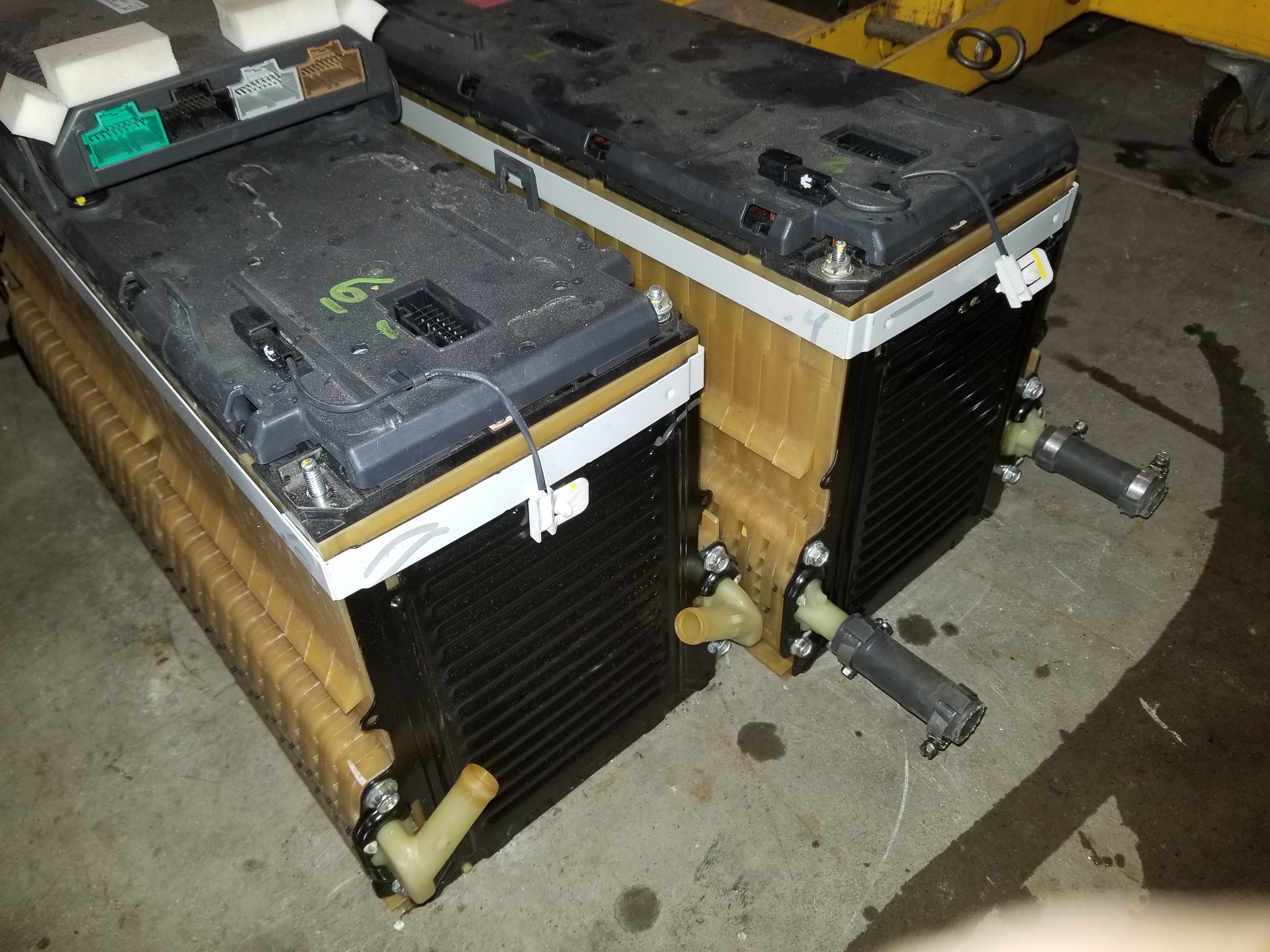

I never noticed it but there is a white band near the top of the battery. This band is made out of steel!
What happen was when I bent the crimps/lugs downward, they made contact with this band near the top of the battery.
Now nothing happen until I was jockeying the battery into place with the cover on it.
The crimps/lugs must of worn through the paint and made contact with the steel part of the band. this in turn caused a direct short circuit between the + and - of the battery!
That's when all hell broke loose!
Anyways the moral of the story be aware of the white ban and insulate the lugs as close as possible to the battery posts!

All is good, no one got hurt, just my ego.
Gonna have to replace pretty much all of the interior.
Not so much because of damage, its because I need get rid of the burnt smell.
I didn't consider heat shrink because the lug was short to being with,
Like I said I didn't even notice the band around the battery.
Heat shrink would've prevent this.
Even though this is bad it could've been much worse.
If this happen when no one was around, the entire garage would've gone up in smoke!

Do you have a thread or youtube videos on your car? I am sorry to hear and see what happened and it reminds me to be careful with my setup. I am working on a e36 sedan with the very same chevy batteries in the back though the full pack would not fit so im using it reconfigured to two parallel blocks of approximately 144v. Yours a newer 3 series but perhaps we could exchange notes on what has and has not worked for us. On my batteries i removed the steel band due to reconfig and replaced it with a adjustable fabric strap. Maybe thats not tight enough? I am not sure if the top band is key to keeping the batteries tight or its the four threaded rods in the base. I am not actually sure what the correct torque spec is for those rods I had to make up new ones. Because of strict rules in my country around battery placement I have put them all in the back. I am relocating the 12v battery to the front and hopefully the charger will go up the front too.
